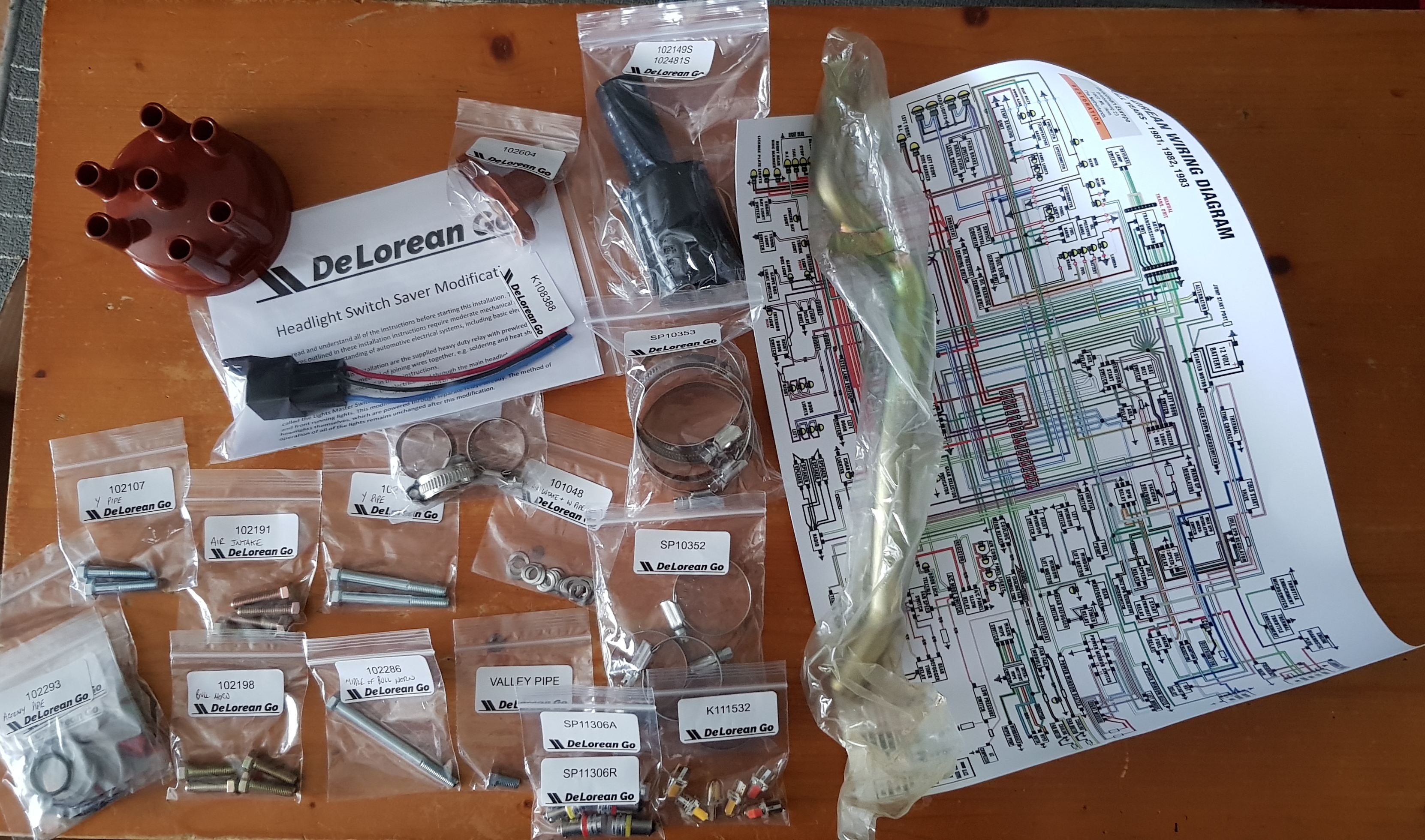

Hopefully i now have everything i could need whilst im in there. Im sure some will point out im missing something. I have mike ward approved spark plugs en route and already have the appropriate HT leads. The air intake O rings/gasket kit obtained as well as an agony pipe O ring and the ones under the Y pipe (which im hoping i wont have to disturb but you never know). I will be replacing the bolts for new too. Also went with silicone hoses for the back of the water pump and will very likely just change that heater pipe careless of the originals condition.
Of course the whole reason for going in there is to just change the distributor cap/rotar arm area buts its probably overdue to check the VOD anyway. No idea if the PO ever went in there and i know i never have.
A few other little bits and pieces bought too. Easy fixes so if ever i get frustrated i can change some LEDs and feel like ive accomplished something :lol:
The wiring diagram will need laminating too.
I have to admit, im not really looking forward to this but im sure i will be fine considering some of the jobs ive already done. Ive been soaking the bolts for a couple of days to help prevent snapping too and will take my time with those. Thats one scenario i dont want here.

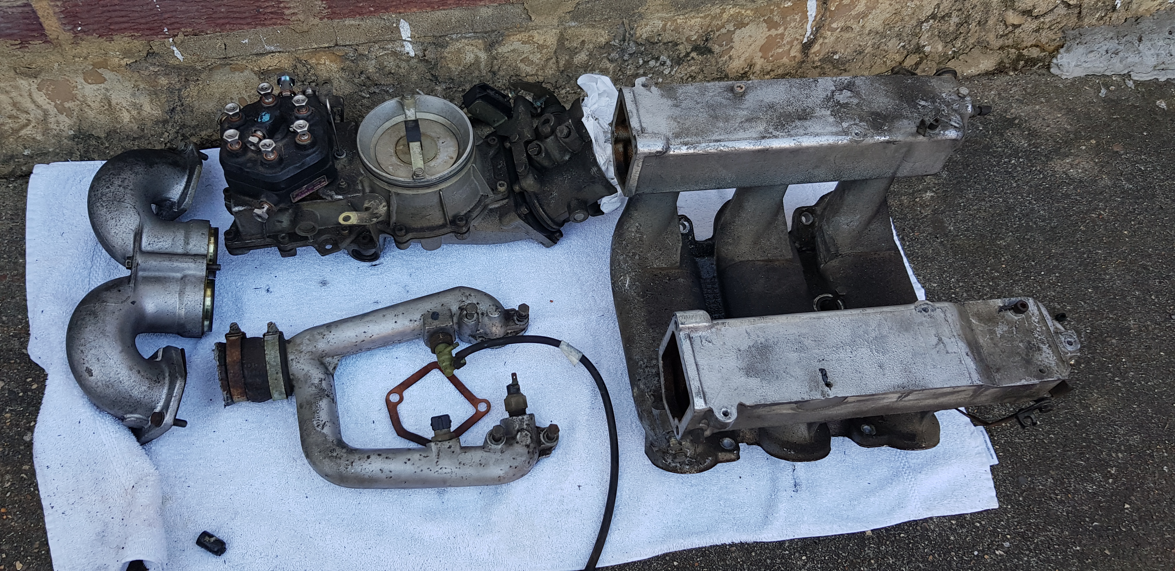

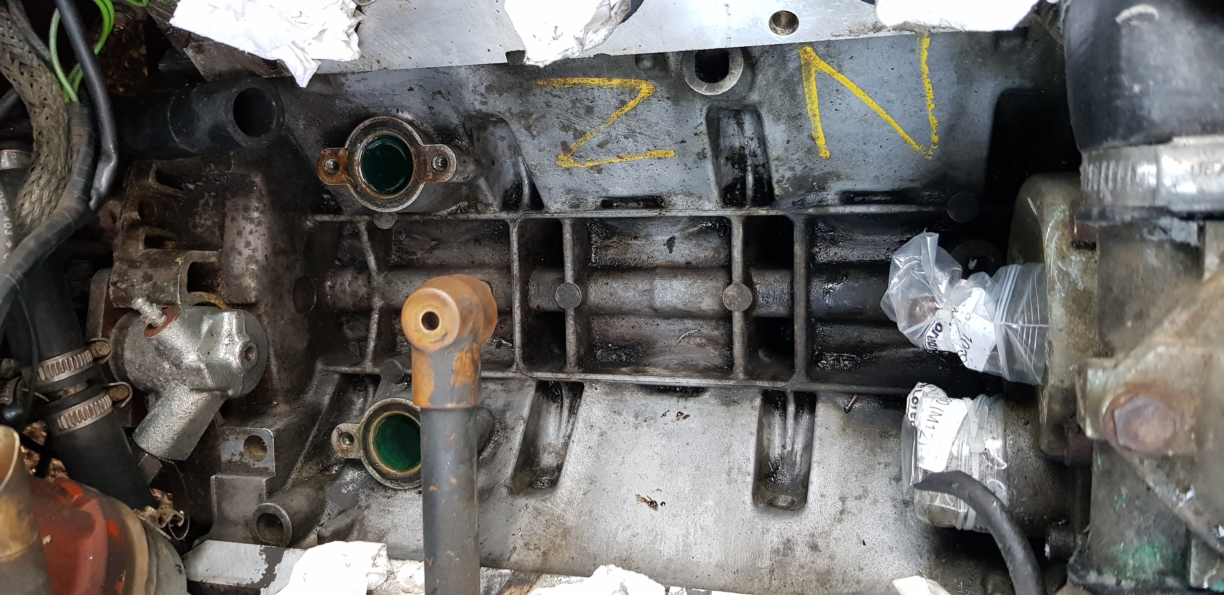

And so it has begun...
I can also report not a single snapped bolt :jzd: which all will be replaced

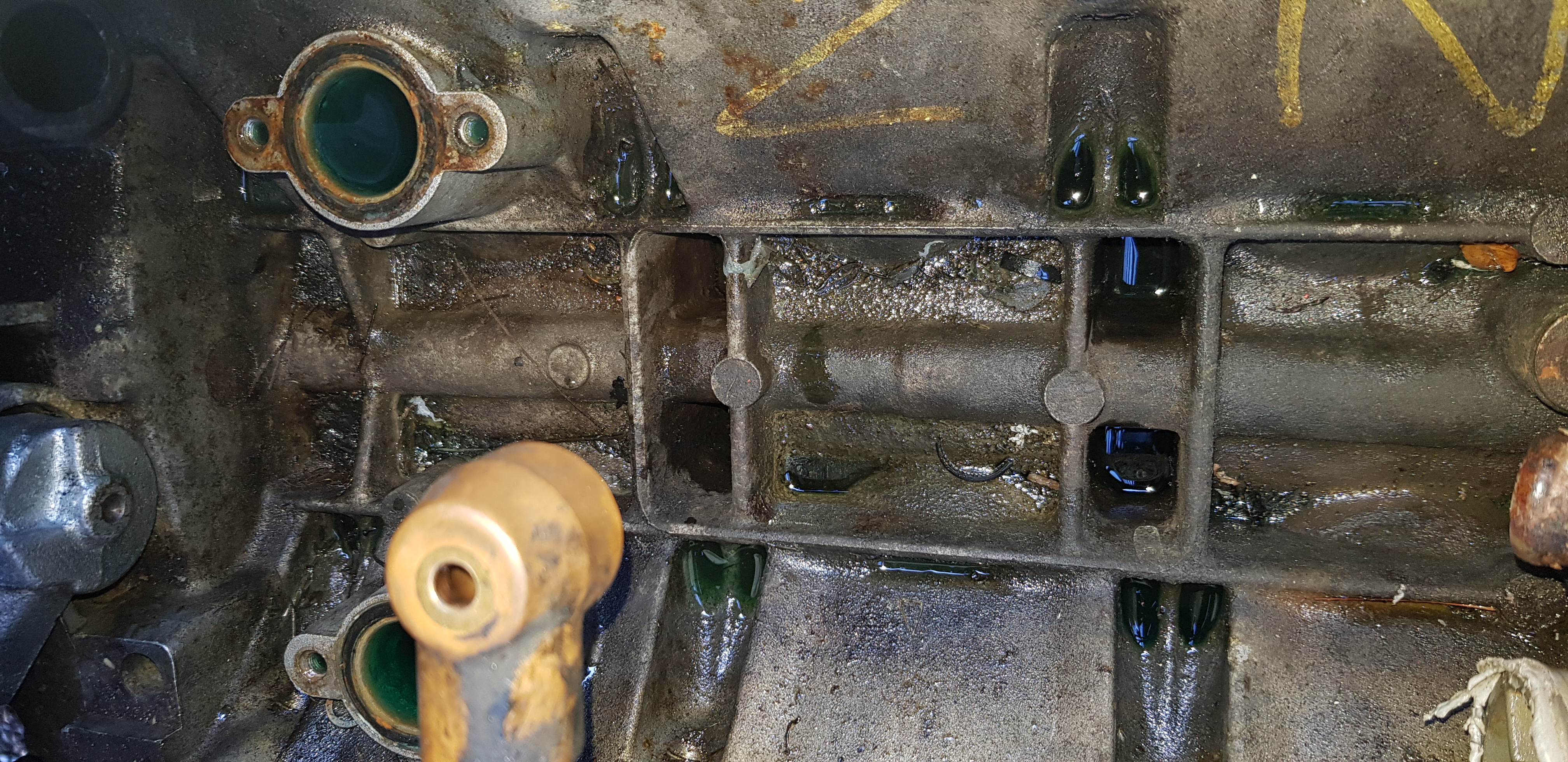

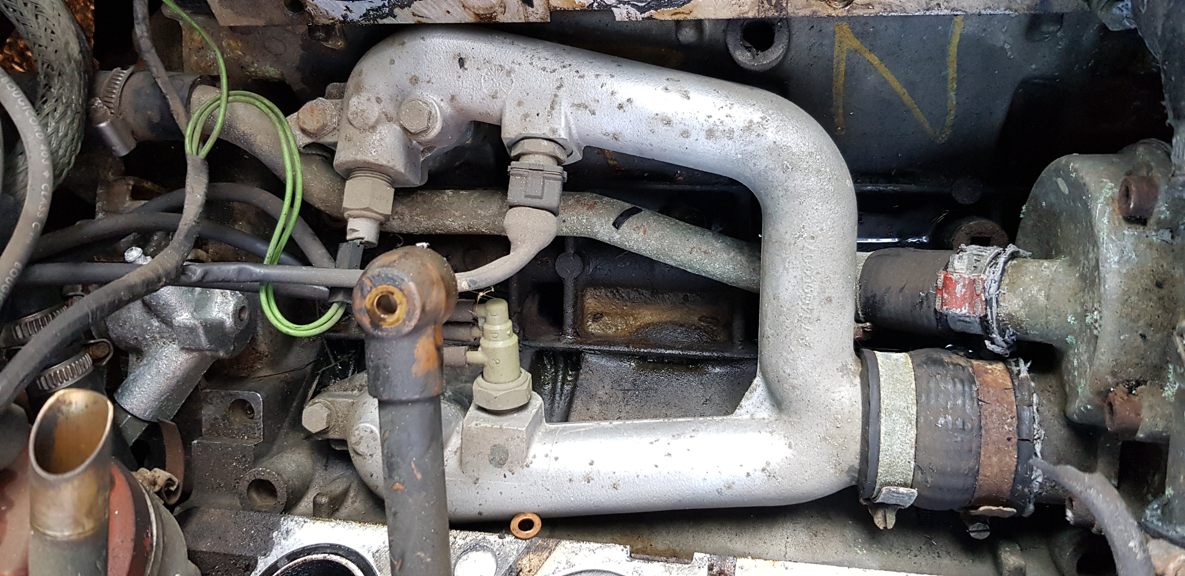

As it appeared after removing the Y and heater pipe and drained the overflow of coolant...
A quick clean before i lost daylight. I will be doing more and im still debating about painting the valley...
The parts will get a cleanup also. Ive already given the horn and air intake a spruse up and they wont need a coat of paint...

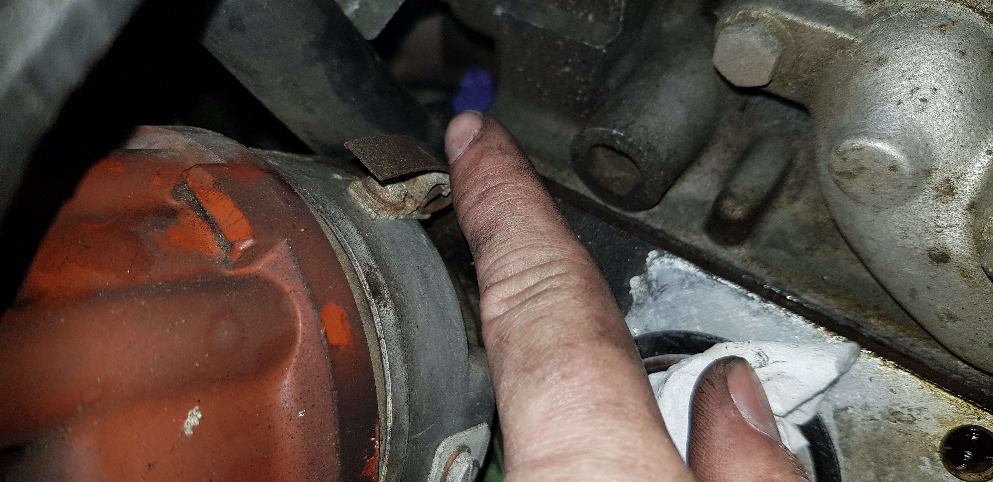

Now the whole reason for going in there. The distributor cap and i now know why i was occasionally getting starting issues. One of the clips has broken. Still, i will be changing the cap and rotar arm since ive gone to the hassle of all this.

Re: VIN 5219
Postby mec » Sun Mar 22, 2020 9:24 pm
looks good under there mate, looks like you caught them rubber hoses on the Y pipe just in time too

mec wrote:looks good under there mate, looks like you caught them rubber hoses on the Y pipe just in time too
I think it was actually leaking, not by much but yeah, i think youre right.
Thankfully arran has some clips so ive just bought them and will replace both. Tomorrow will just see the cleaning continue. I think ive been rather lucky and fortunate with this car considering i bought blind from bhcc
