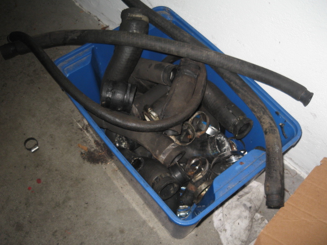

Postby RobvdVeer » Sat Feb 05, 2011 3:32 pm
Just a quick couple of pics:
spare hoses
ready for the operation, doctor.

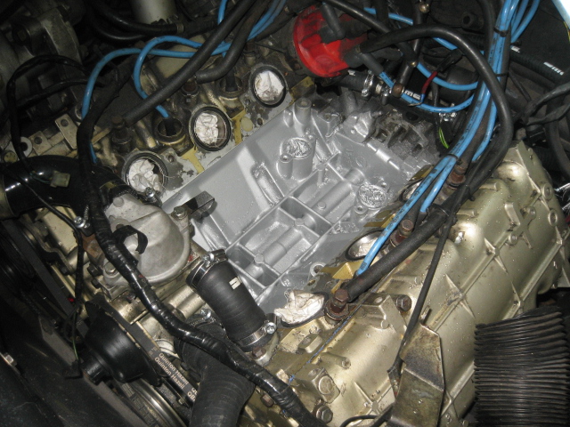

Postby RobvdVeer » Sat Feb 05, 2011 8:13 pm
Admin-bloke wrote:Looking good there Rob, sweet :D
Coming from you, that means a lot to me! I will be cleaning/painting the intake tomorrow to do some light work for a change! This is going to look good (he said in a very humble tone of voice).

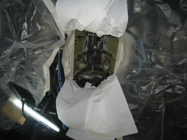

Postby RobvdVeer » Sun Feb 06, 2011 4:15 pm
Looks i might need another paint layer. The winds around here came through the door and blew around a lot of dust in my garage.
