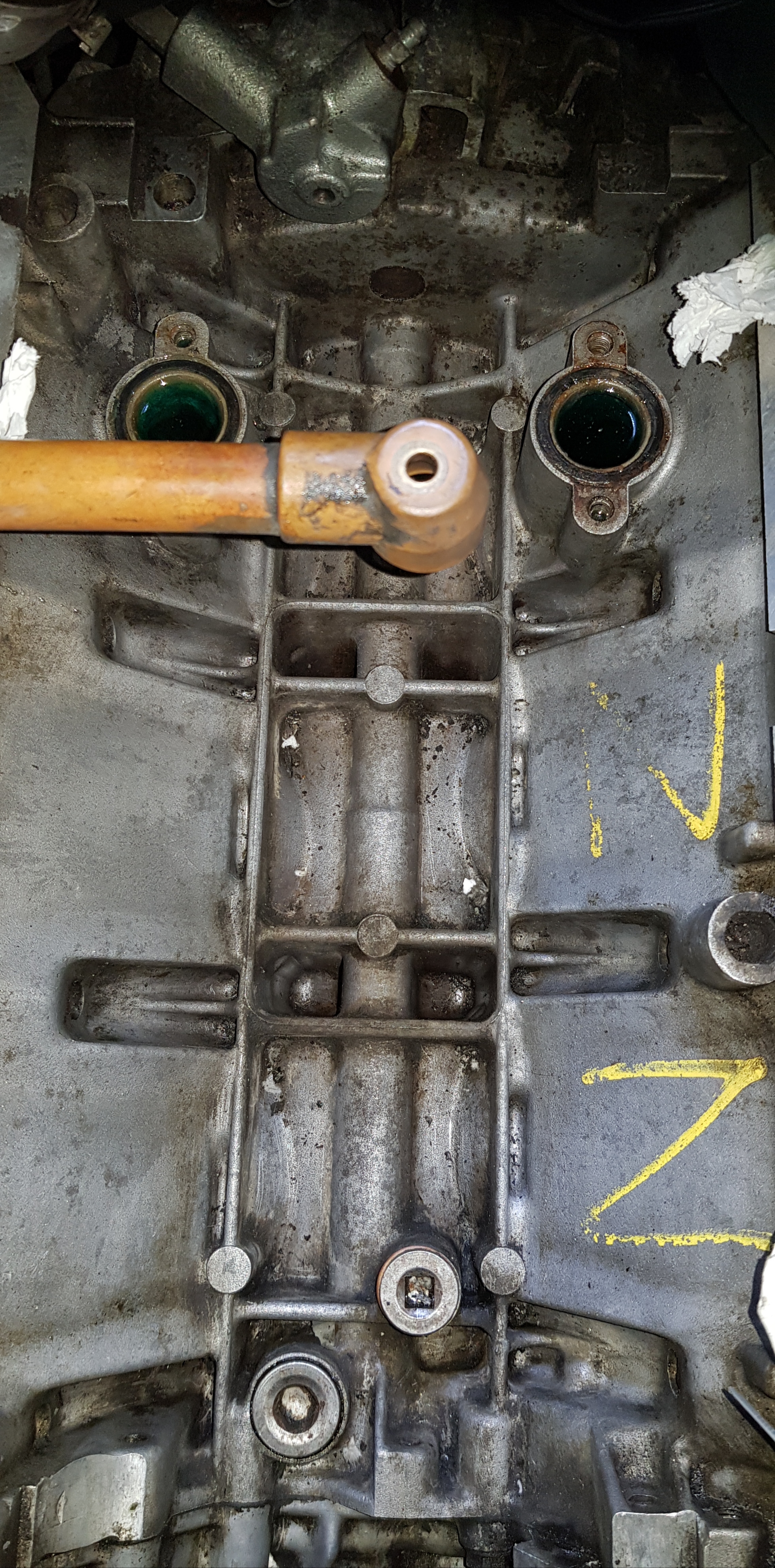

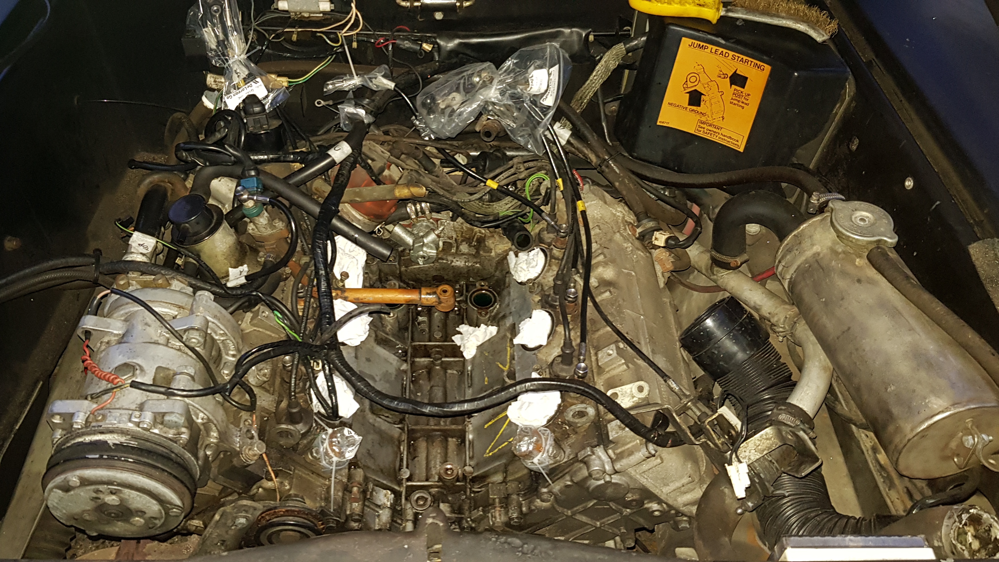

The valley is cleaning up nicely. Needs a little hoover but so far, so good. Still some crap to be cleaned. Its damn annoying to get into those cavities...
I decided the water pump will be addressed while im in here. Amazing how a tiny thing (was just gonna change the cap and rotar arm) turns into a big thing like an engine bay overhaul :lol:
It was all gonna need doing sooner or later anyway. It didnt look too bad but its one of those matters of when. I think ill buy a new pump and send this off to dave howarth to overhaul and keep as a spare. And again, no snapped bolts. I really should get a lottery ticket...

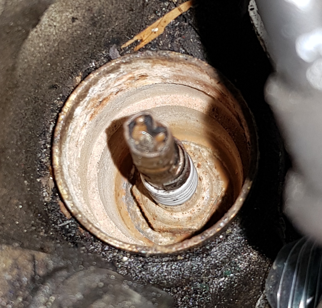

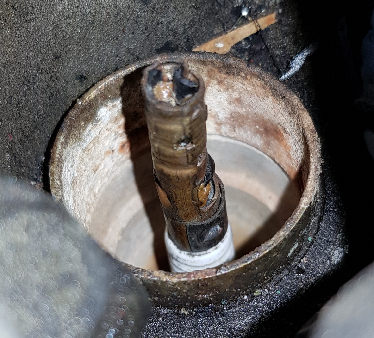

I had a look at the state of the spark plugs in their holes today (not removed them yet) and whilst 4 looked fine, 1 had white fuzz on it but the worst one was this. Part of the HT lead stayed put.

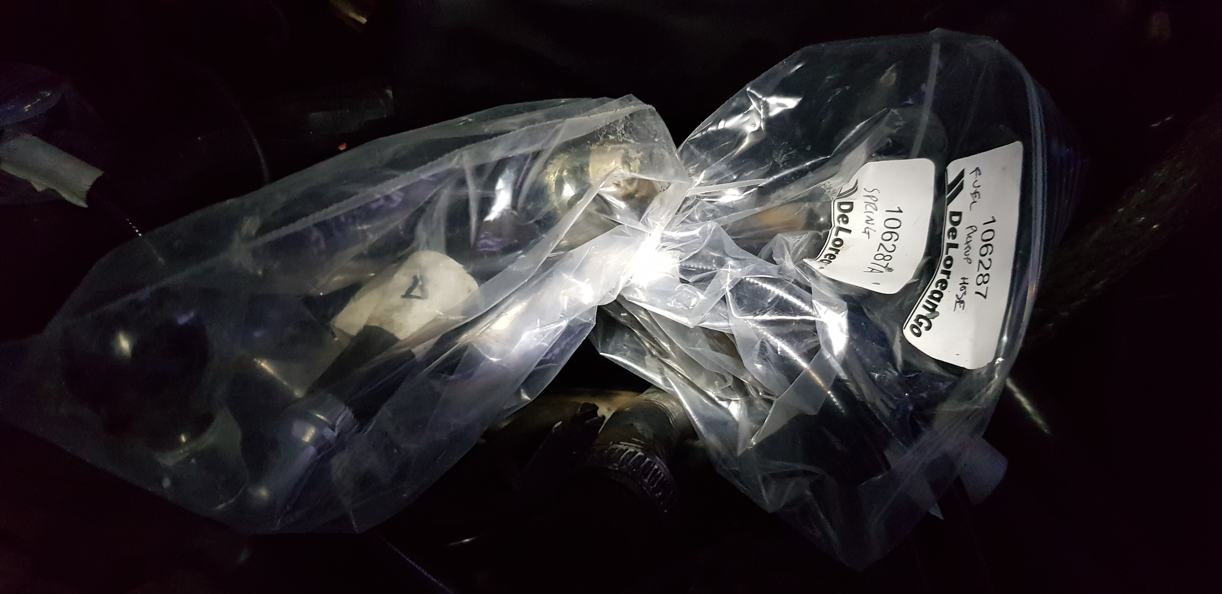

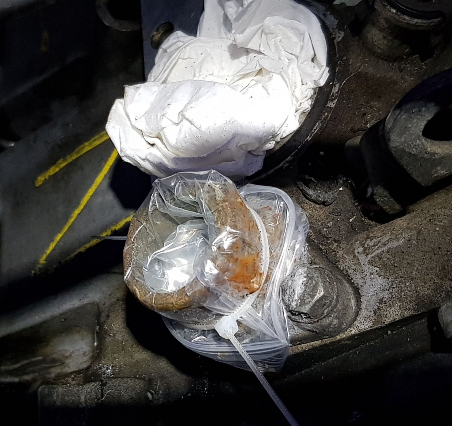

All those little bags your parts come in from Arran have come in handy. Ive used them to keep lines and the such sealed and free from debris
The state of the engine bay currently...
Im very much looking forward to seeing how much of an improvement all this work will make

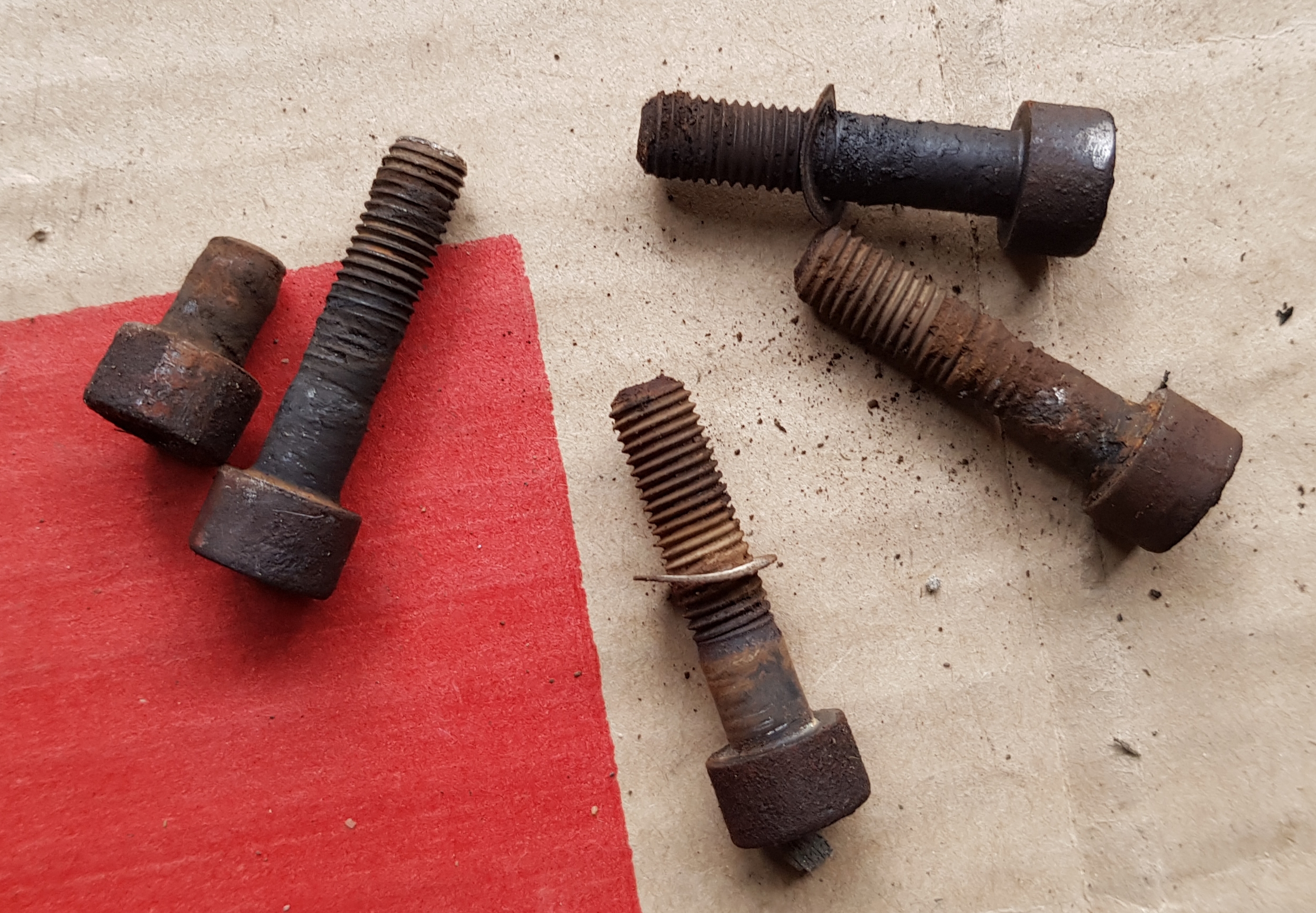

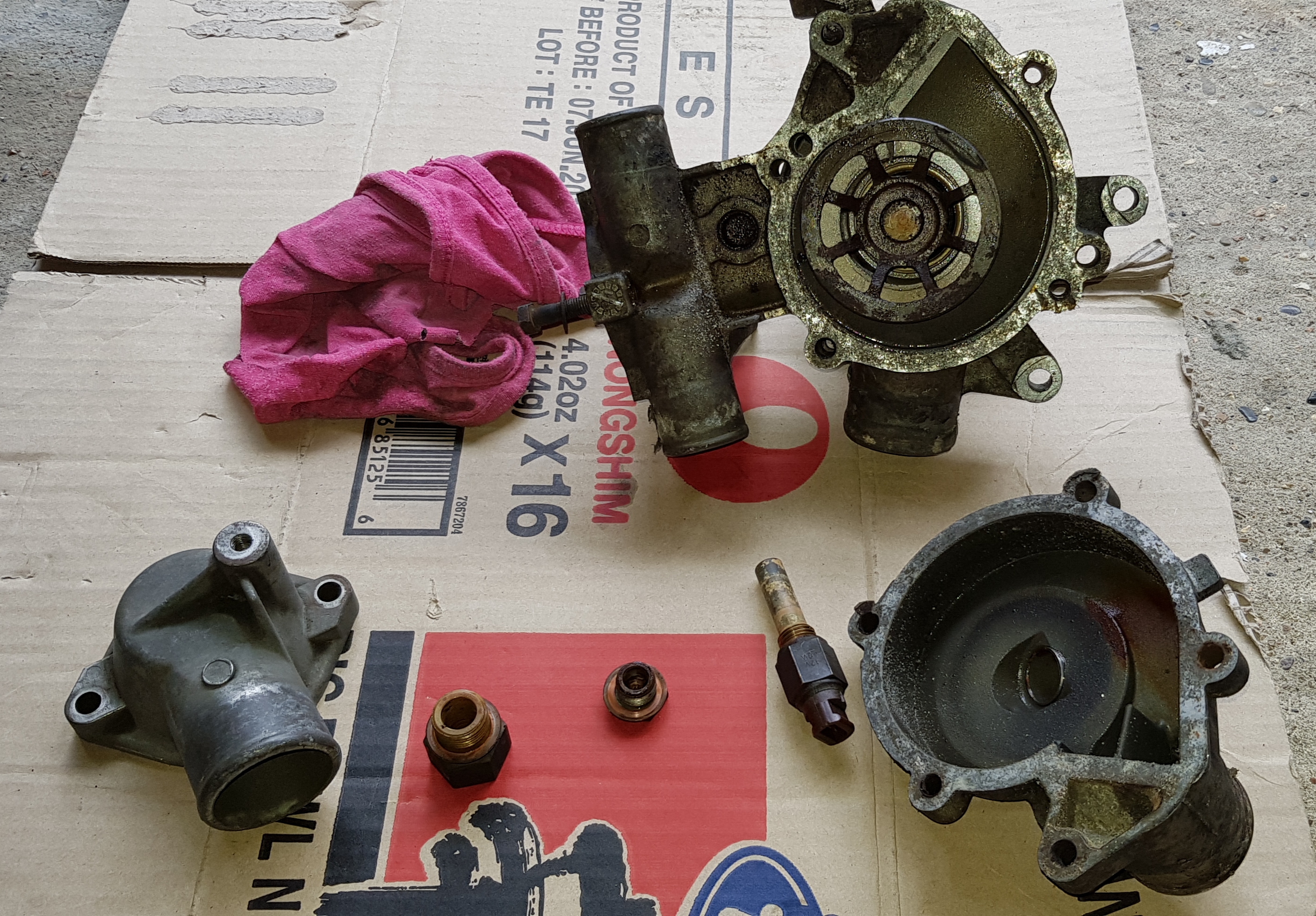

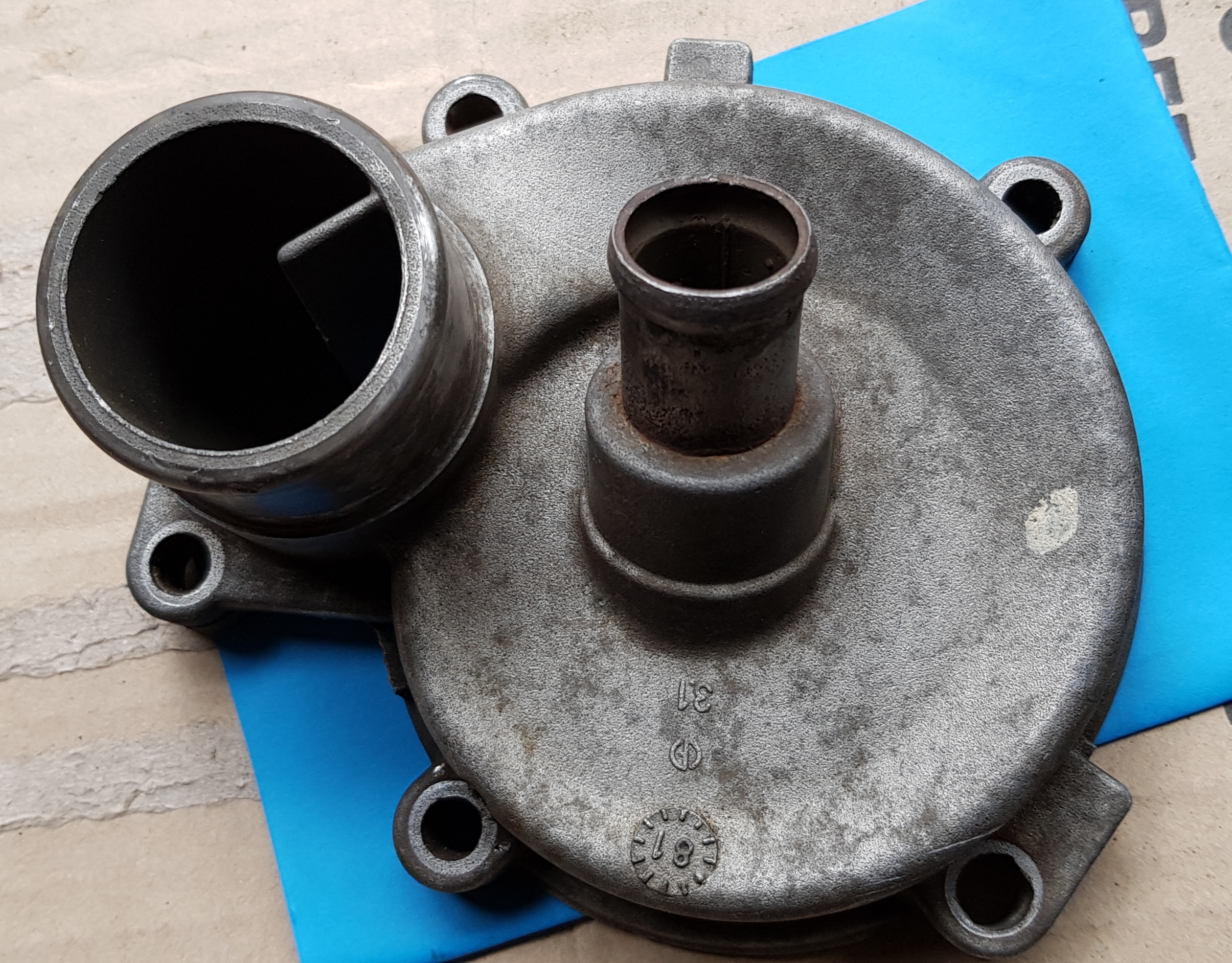

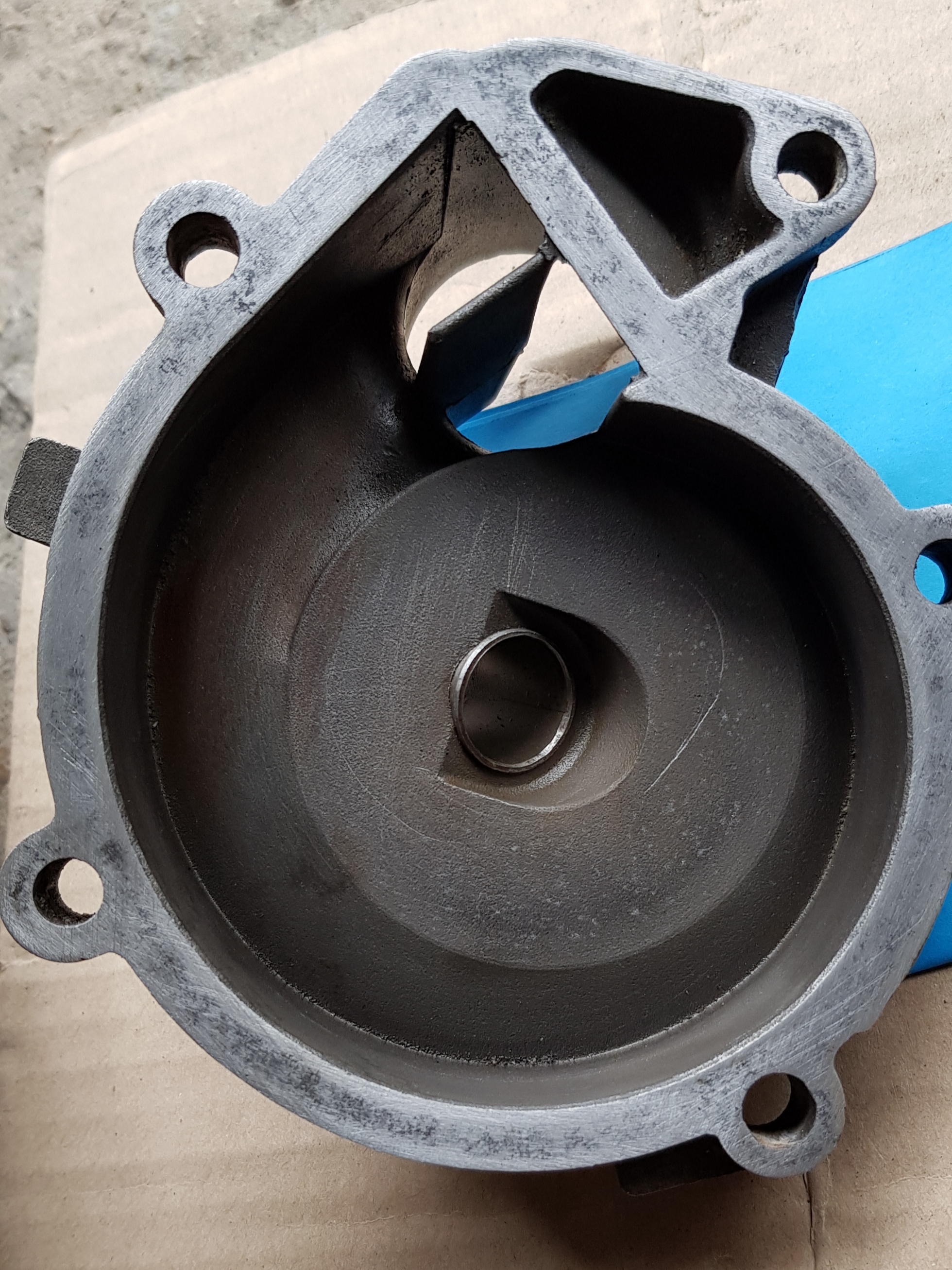

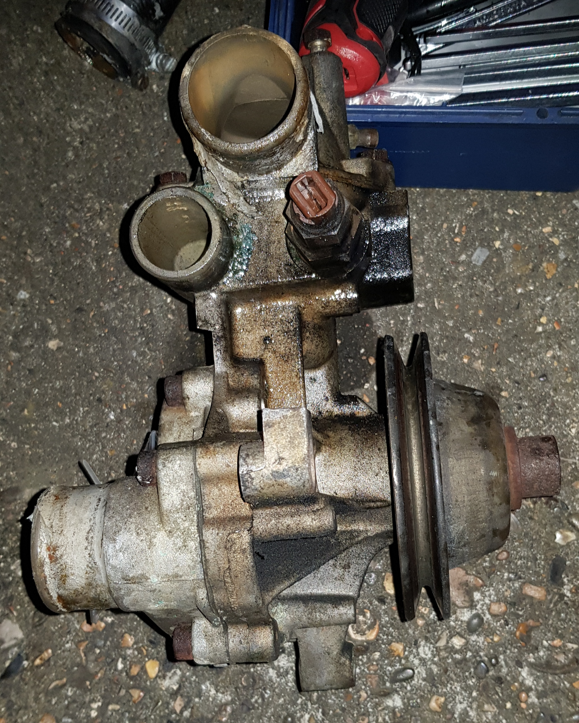

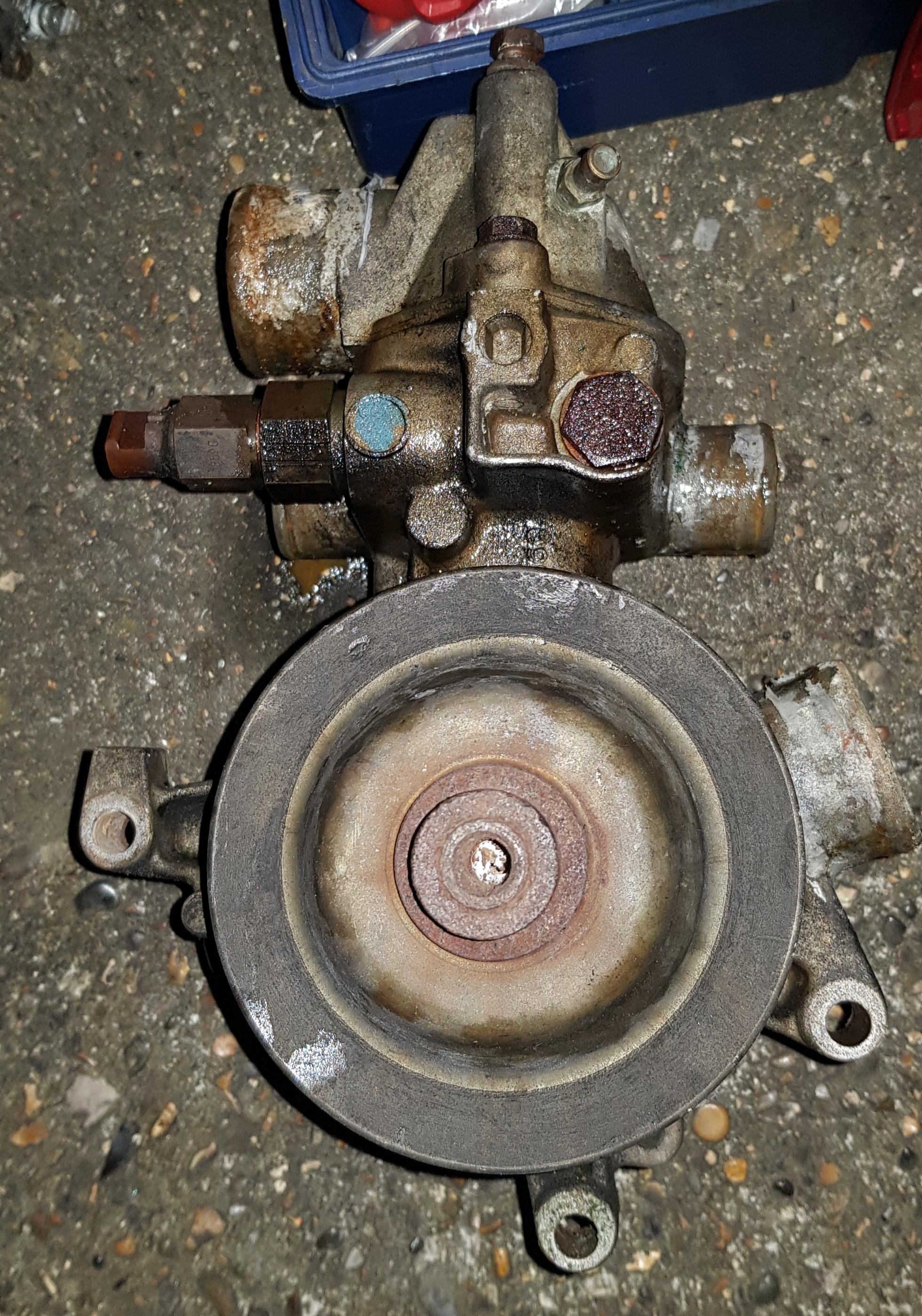

And so today saw my struggle with the pump back. And here is where I suffered one snapped bolt which considering the state of them, its hardly surprising but 1 out of 5 is pretty good going (i guess i was due a snap). I actually dont know if its worth refurbing the main pump body as I need to get the pulley off first, but i guess its still possible. Anyway, that can wait as i wanted the thermostat housing, pump back, the thermotime switch and its screw adapter off to go onto the new pump I will be buying soon.
The backing plate screws. Rusted to hell

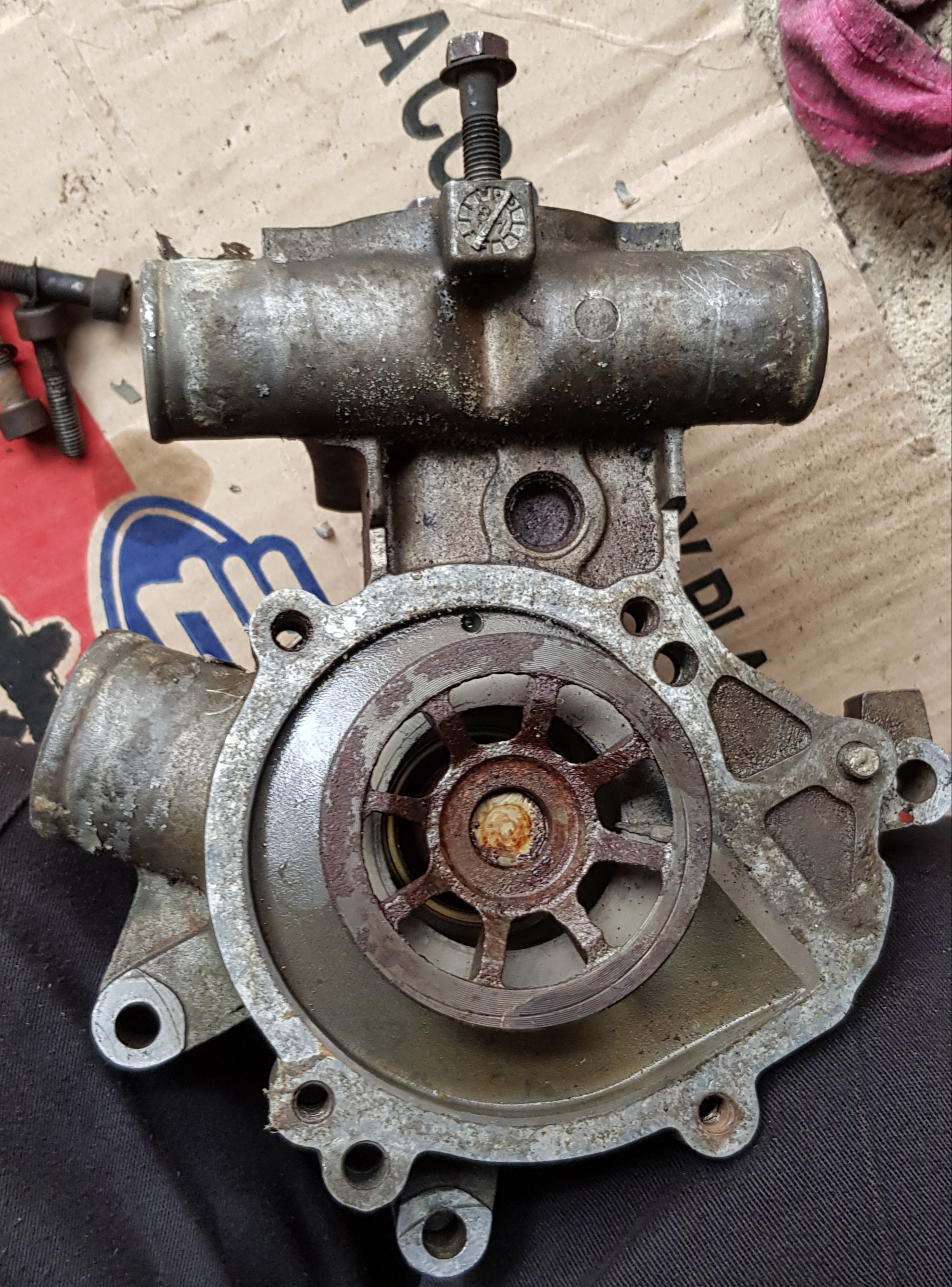

The inside of the water pump. Bit crappy...
The back scrubbed up nicely...

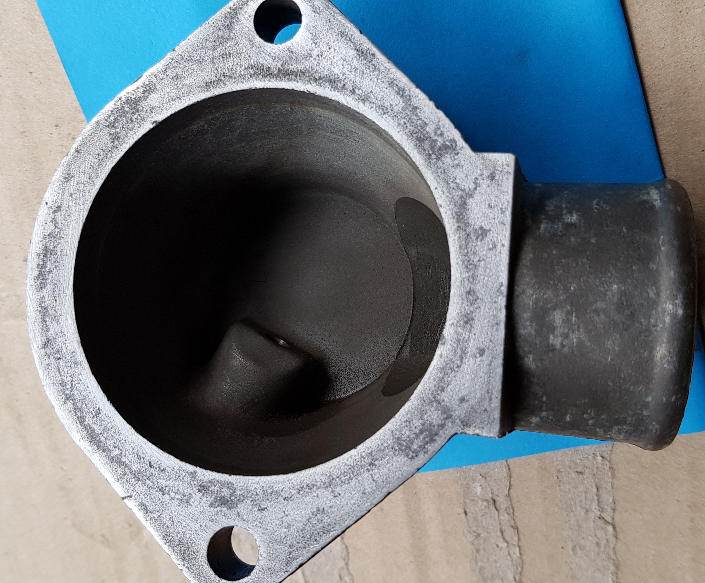

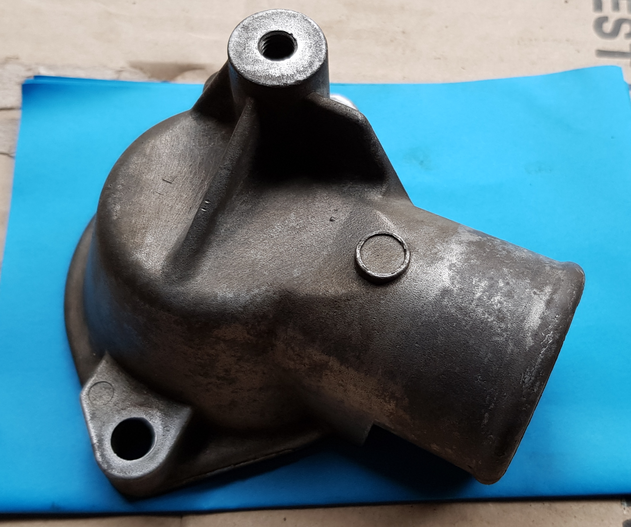

The thermostat housing also scrubs up a treat...

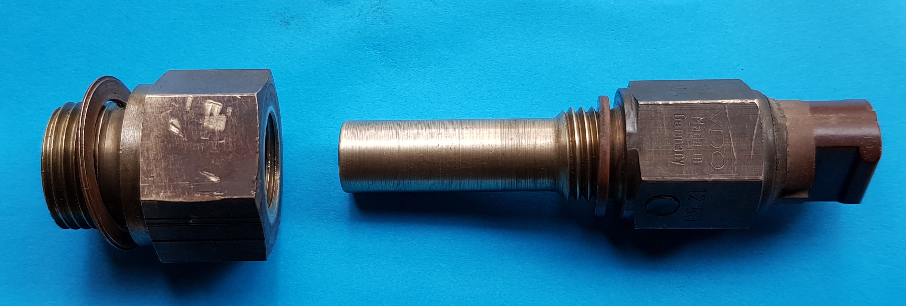

Thermotime switch and adapter cleaned ready for the new pump. Needs new washers though.
I also took a look at one of the AC pulleys and I can see why it seized now but since i dont even have a condenser, this can wait.

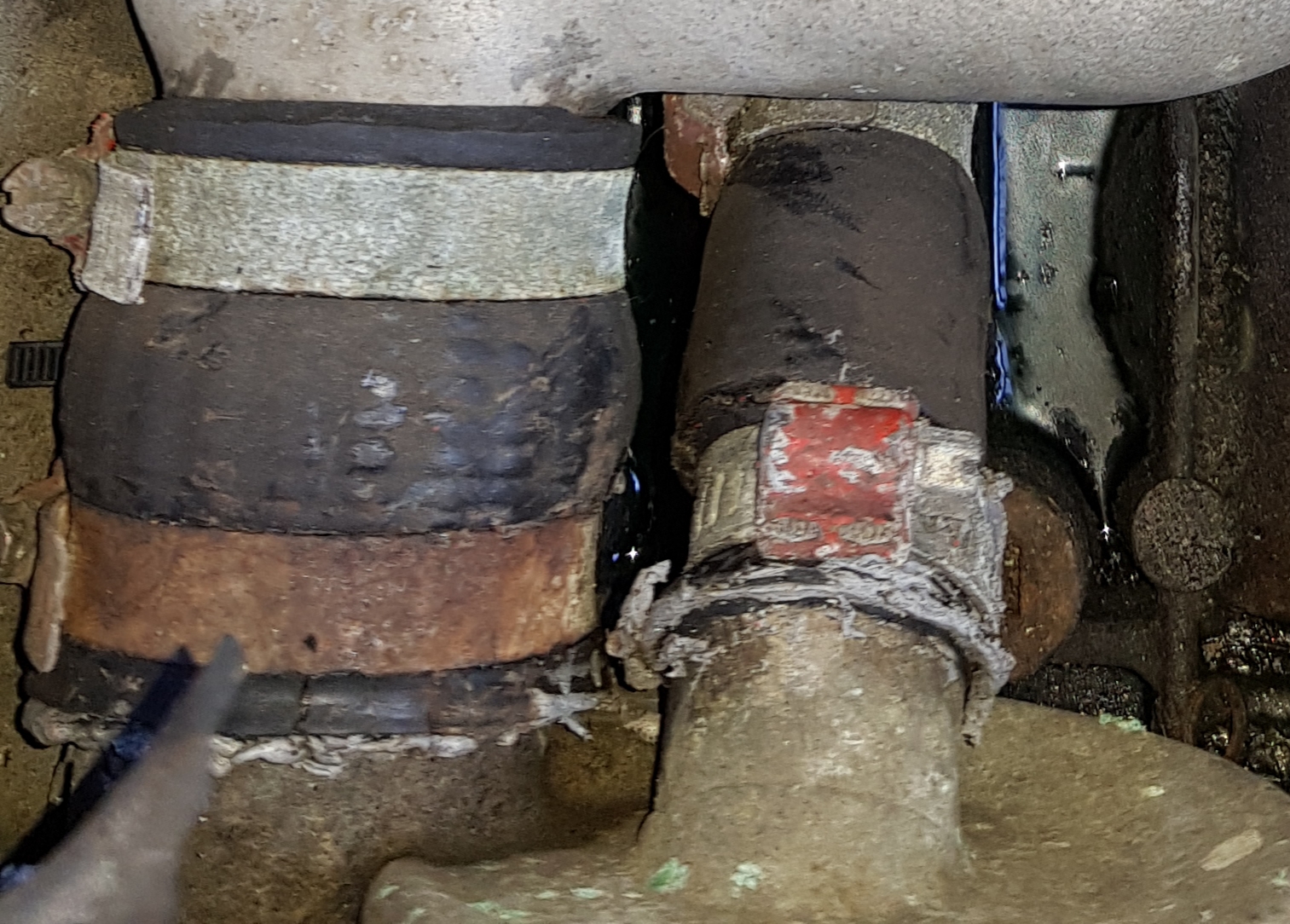

Im now inclined to believe the PO has gone into the valley at some point up to the removal of the air intake (may also explain why none of my bolts snapped). My first clue was they had used some sort of sealant on the hoses that connect to the pump as can be seen here...
That sealant gunk was on every hose that connects to the pump. Clearly they were concerned enough about the VOD to do this. It still appears that a leak had started from one of these hoses. No idea which one and its all getting swapped for silicone ones.

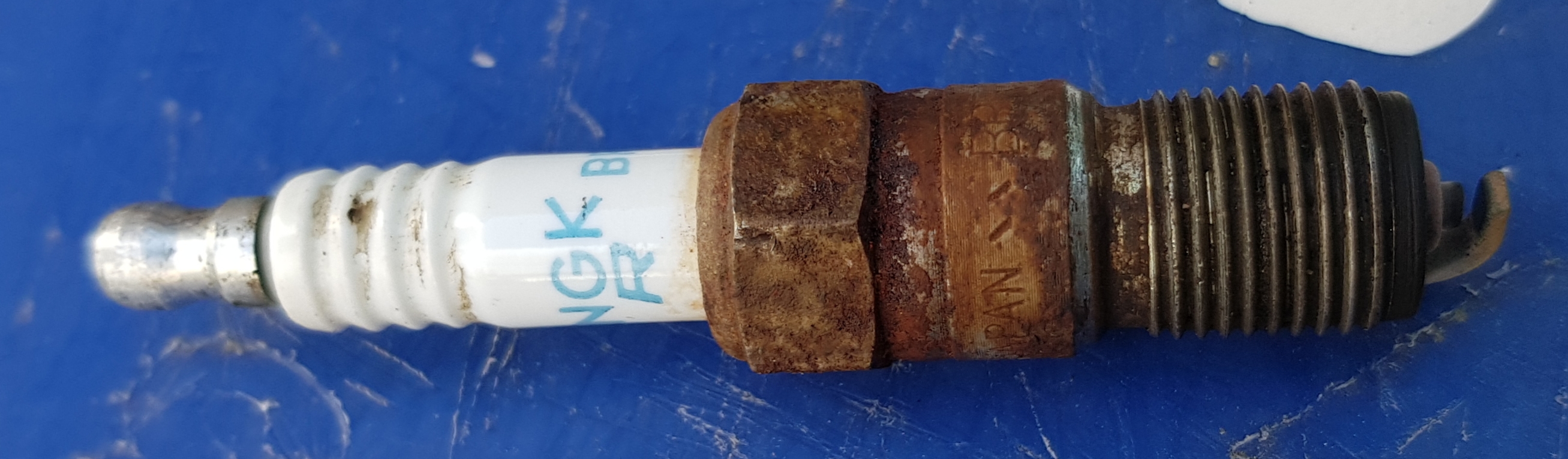

My next clue was when I pulled the spark plugs. They werent bosch but NGKs...
So all the plugs have now been loosened ready for the new ones. Im going with Mike W's advice and using a slightly different model of NGKs.
