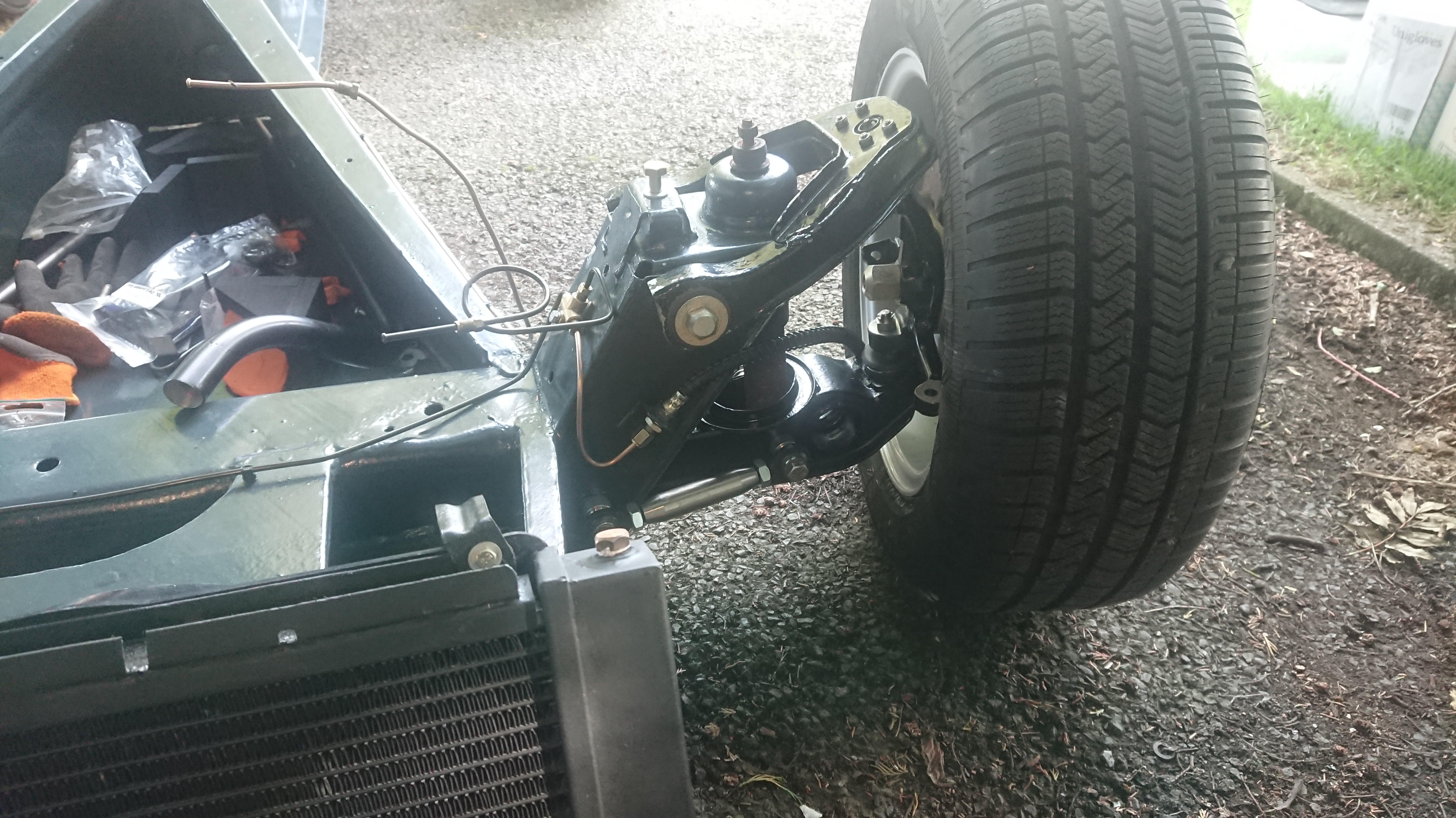

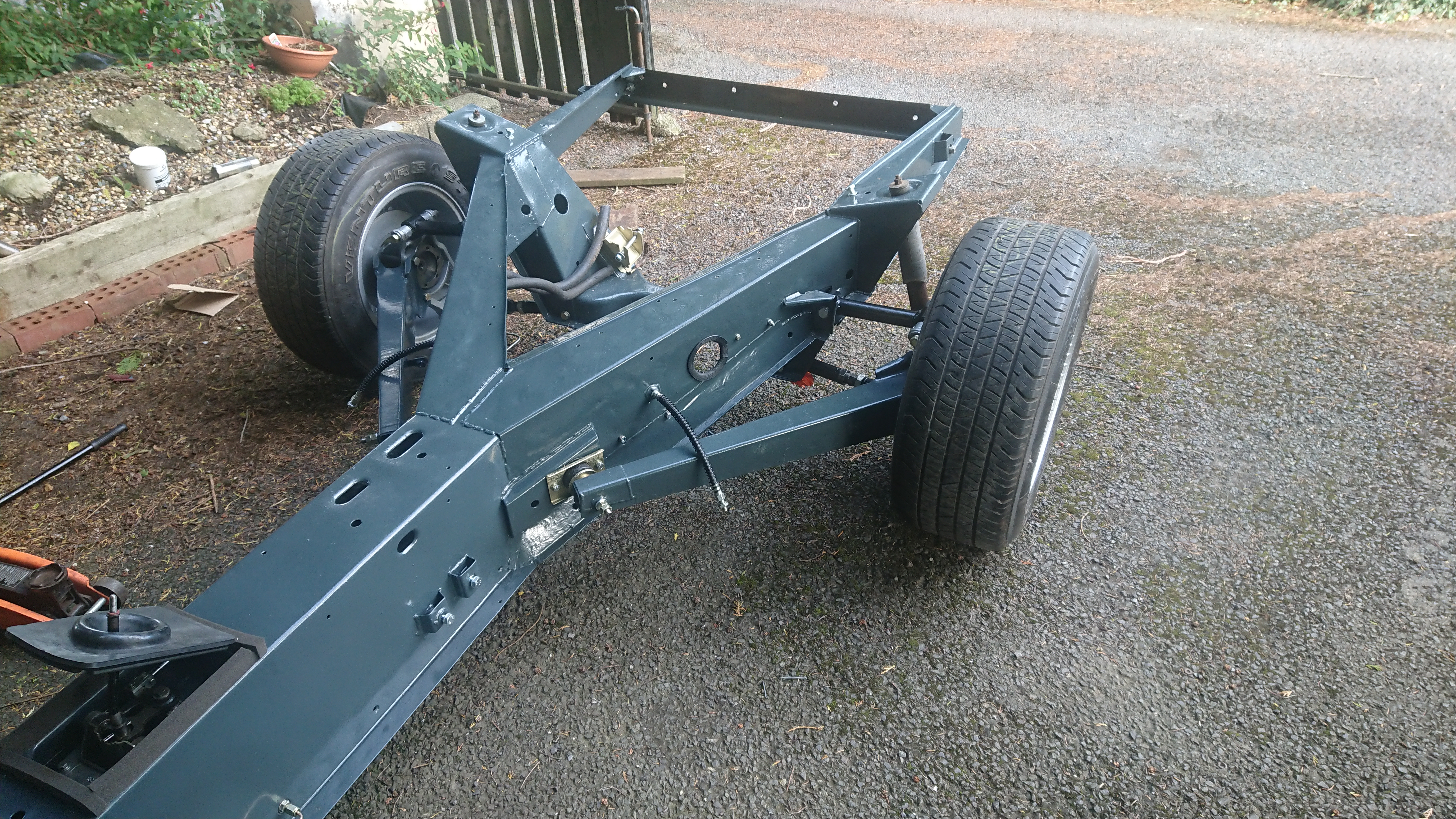

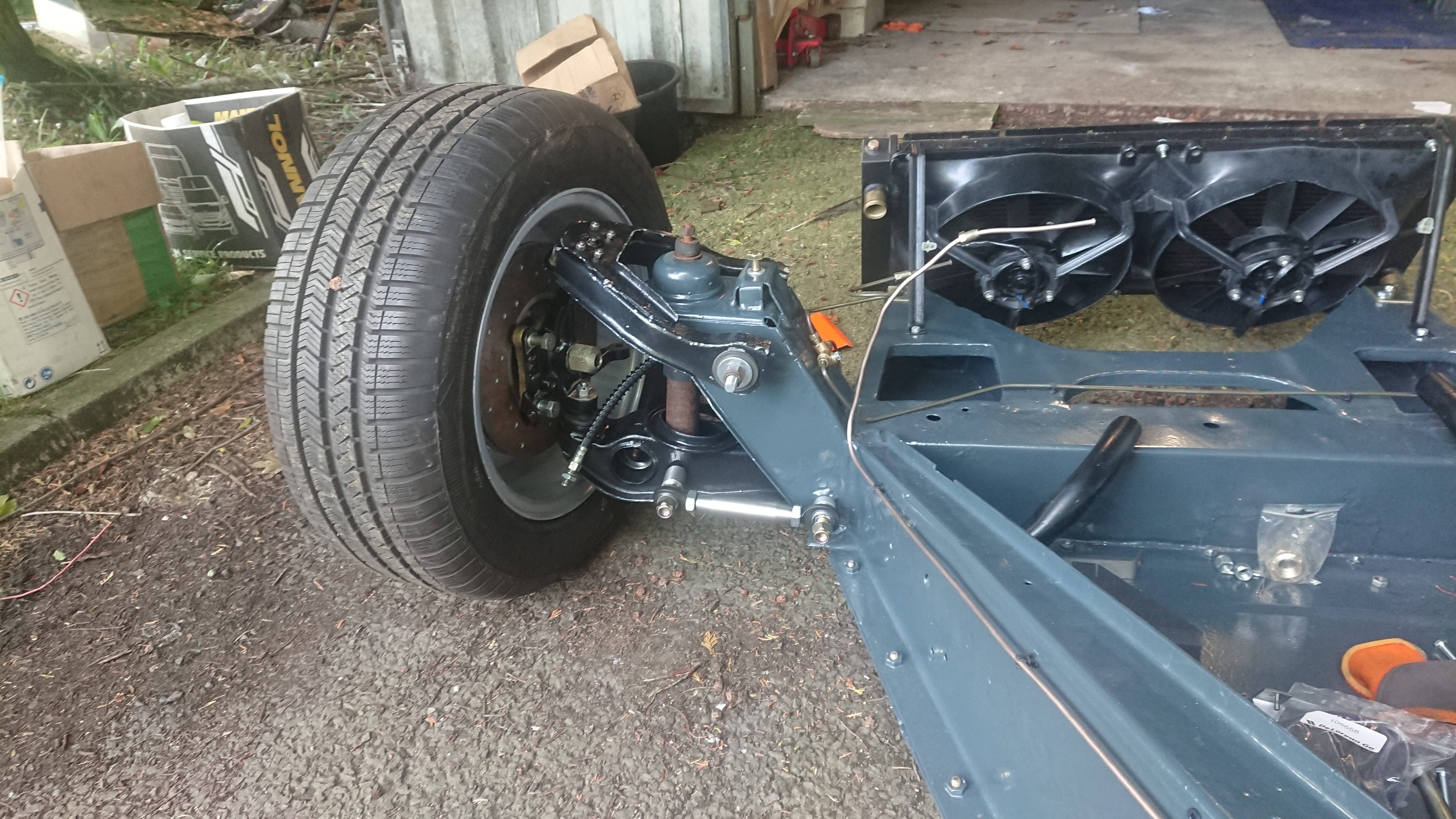

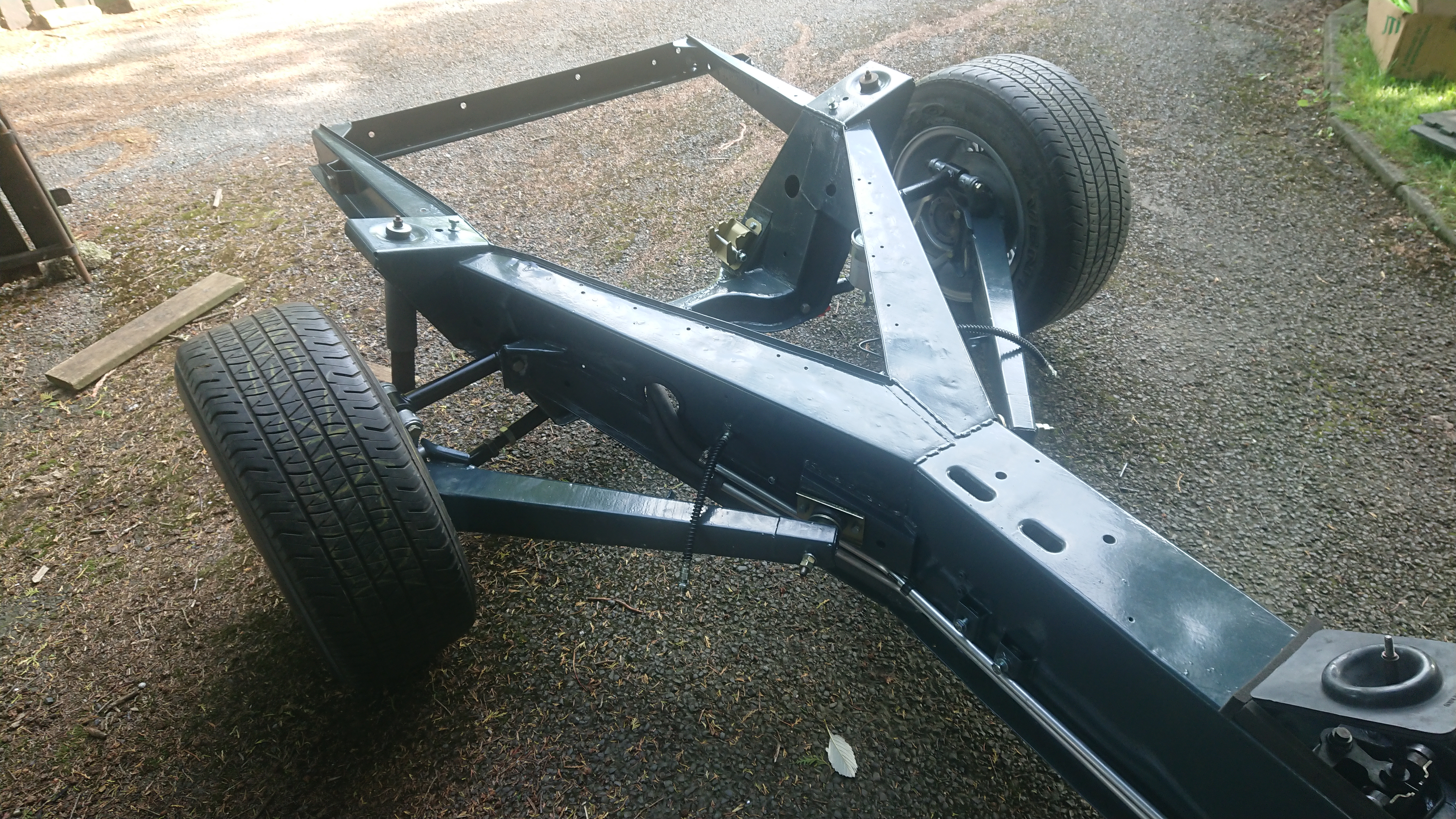

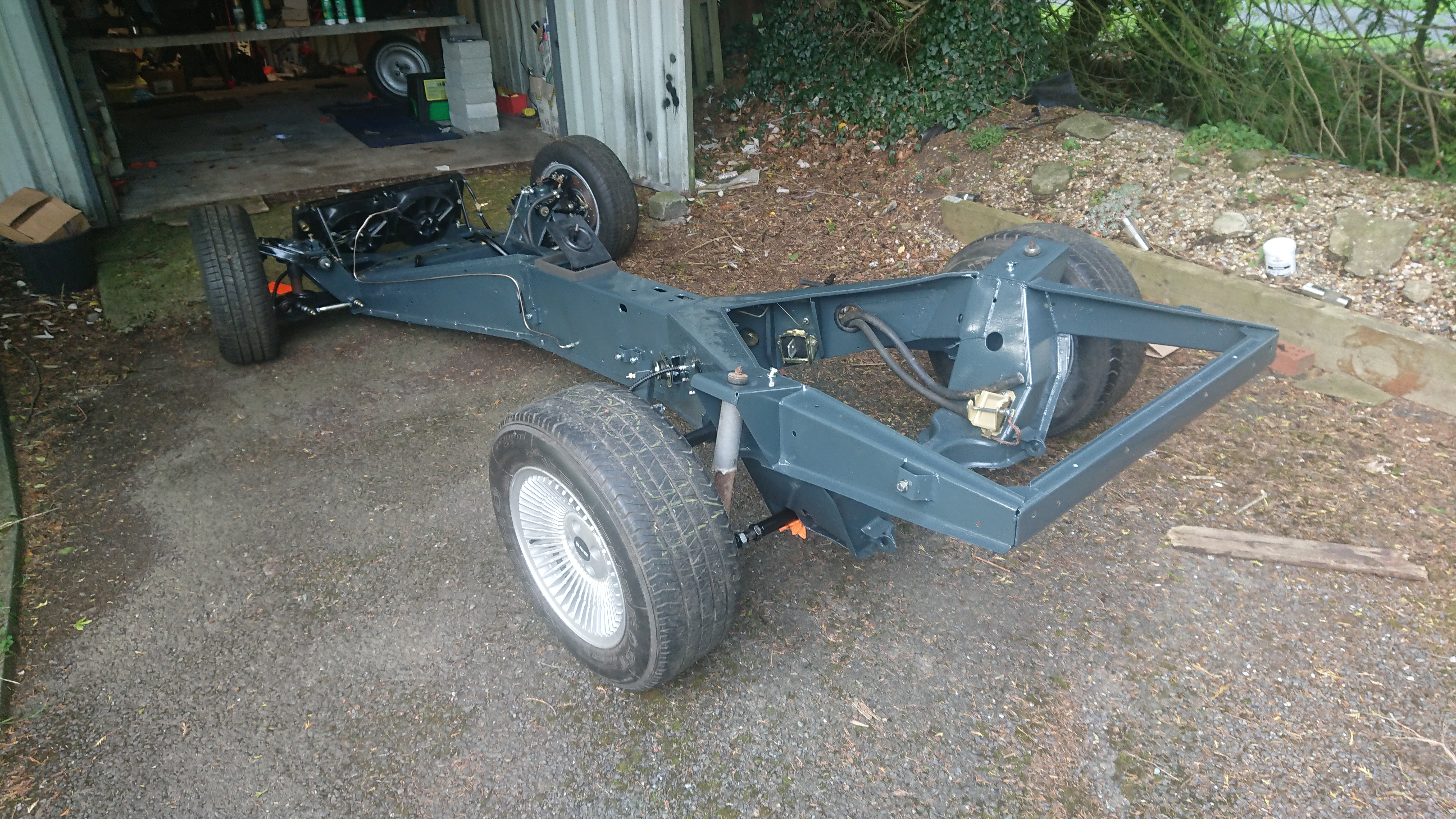

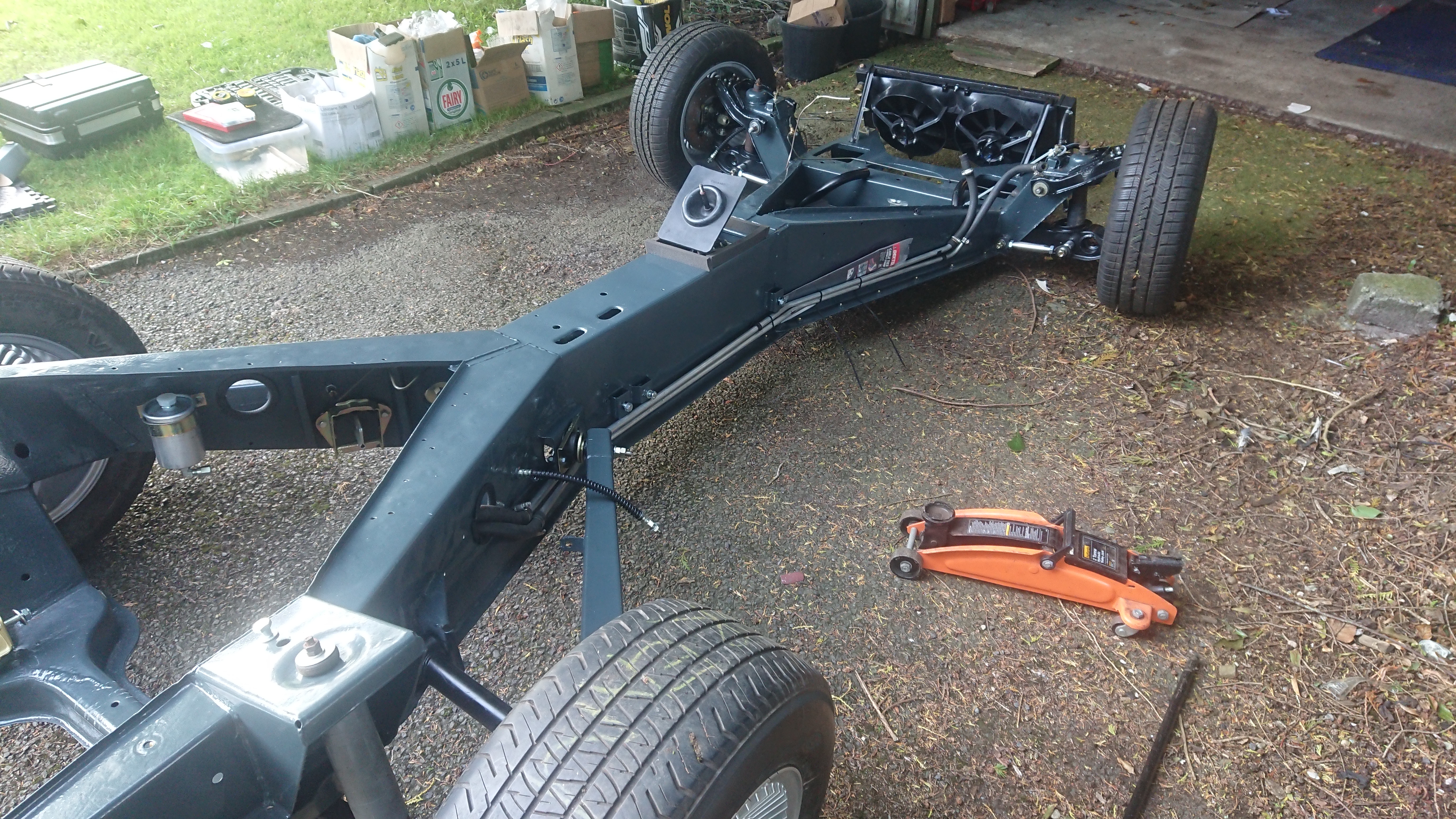

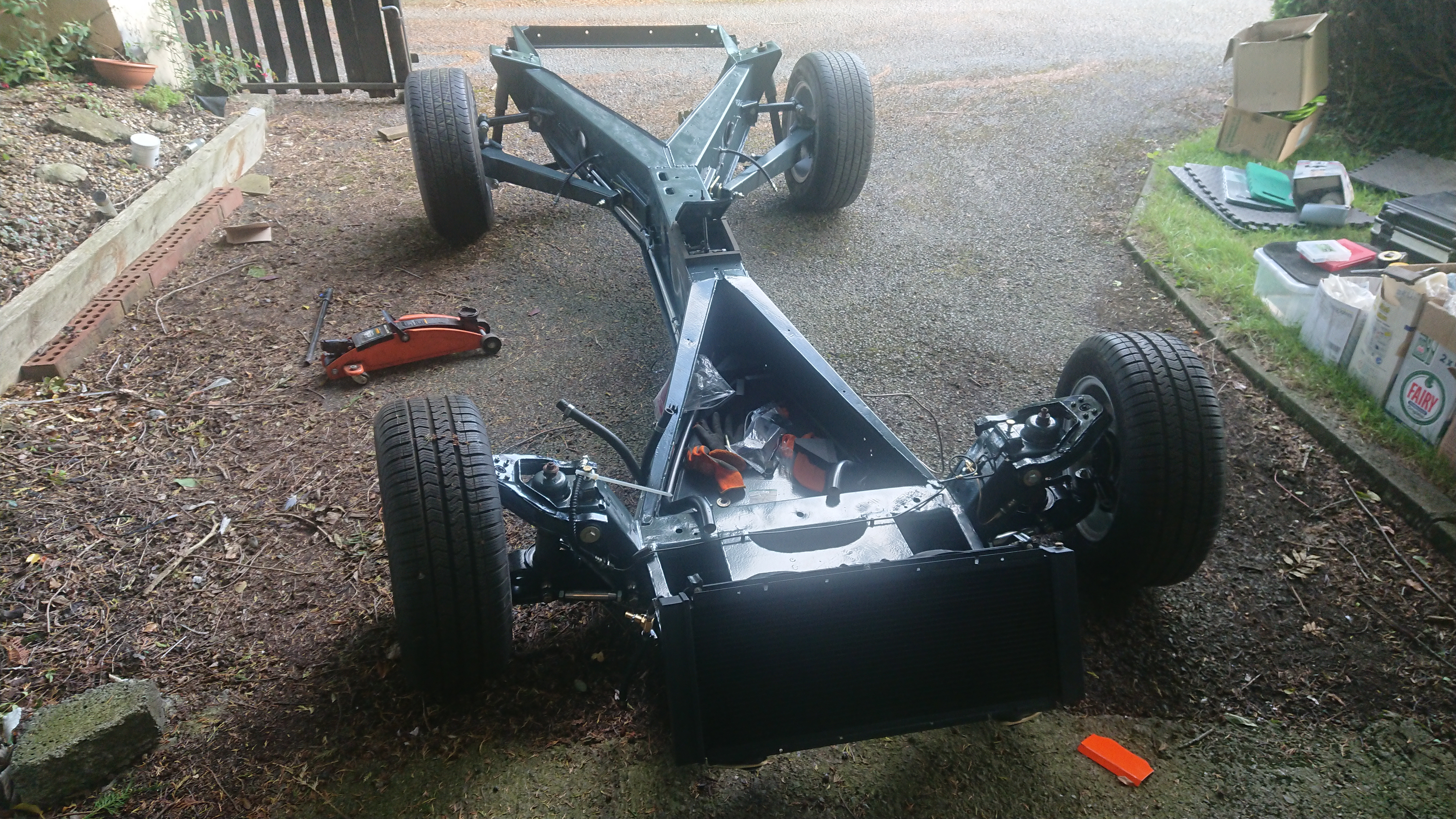

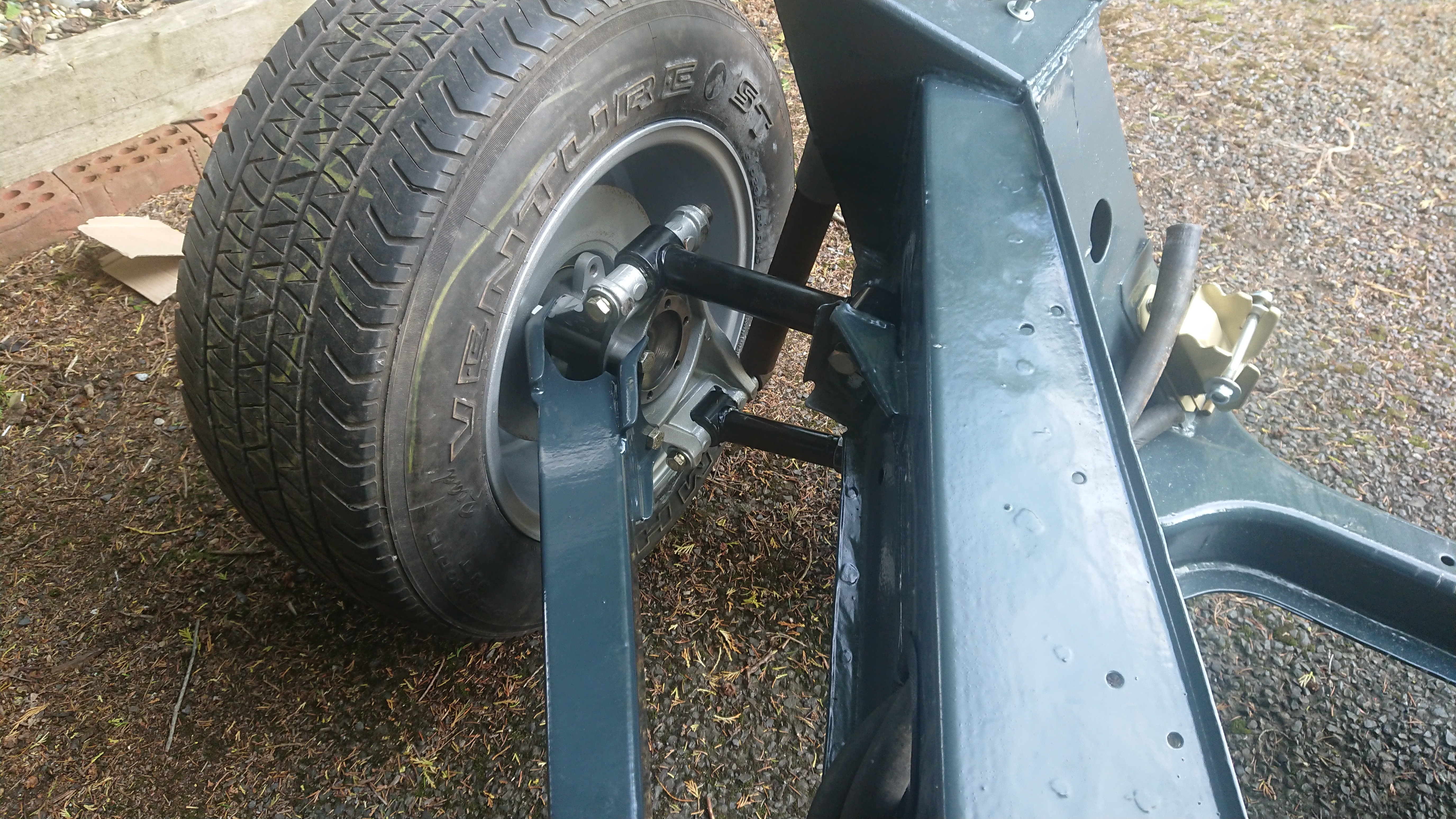

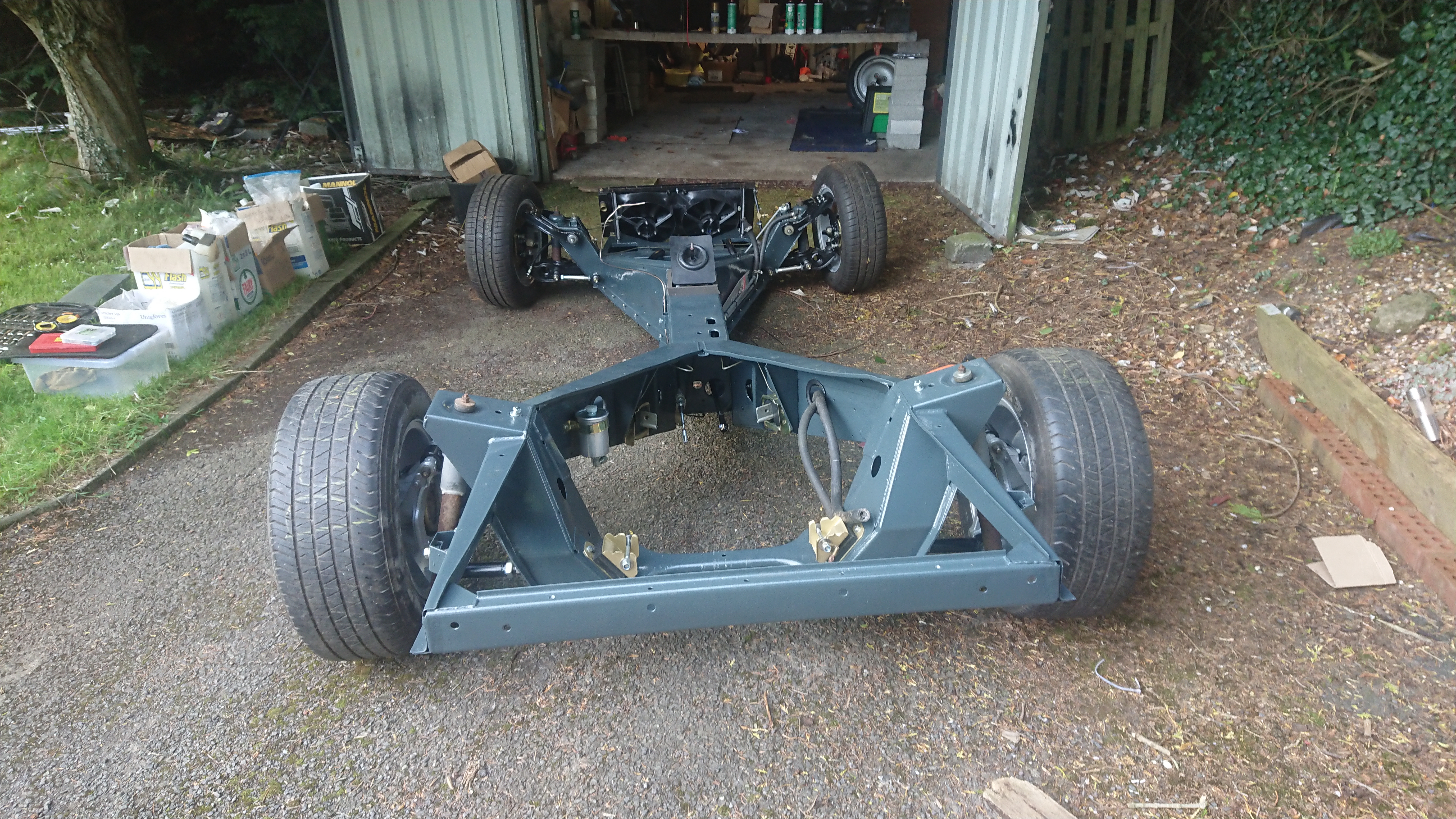

With some fantastic trojan help from Thomas we got some great movement forward, she s now back on her 4 wheels instead of the dollies. Helps an awful lot moving the chassis around and in and out of the garage.
We fitted the original shocks just to have it completed a bit more but will be changing these next for new ones. A couple of them are a bit past it to say the least lol.
Onwards and upwards hopefully :think:

Postby Admin-bloke » Fri Feb 23, 2024 8:59 am
That's looking superb :)

Postby Domi » Sat Feb 24, 2024 12:31 pm
Really nice job :)

Postby cis6409 » Mon Feb 26, 2024 3:25 pm
Thanks guys, hopefully can make some more good progress now with a few more parts to get :thumbsup:

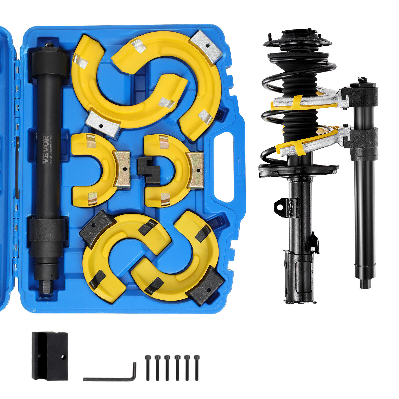

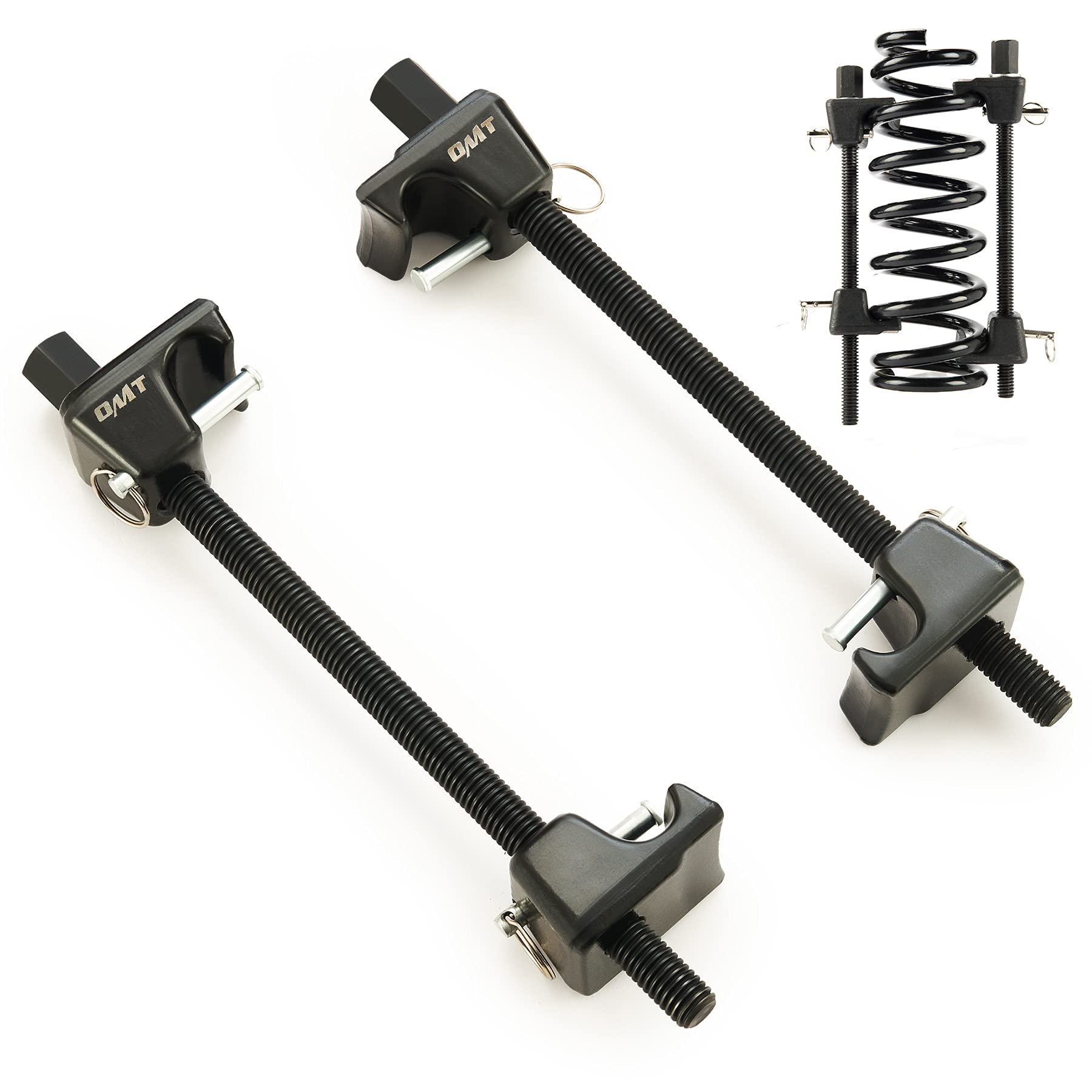

Does anyone know what the best options for spring compressors for installing lowering springs. Front and rear.
I can get my hands on the 'normal' spring compressors like these :

But is there better, safer options everyone uses?
I assume the hard part is getting them evenly spaced with the strut tower on the frame being in the way alot especially on the fronts ?

Postby Derfel » Mon Mar 04, 2024 4:54 pm
I tried those spring compressors and found them to be a bit dodgy to say the least. I ended up investing in the following from ebay which made the job a lot safer and they are not that expensive. ( I removed the plastic sleeves to make sure that the spring was properly seated in place before starting the compression)

Postby cis6409 » Mon May 20, 2024 2:28 pm
Picked up a set of them, they worked excellent delighted to say.
so much safer than the claw types

Postby Derfel » Tue May 21, 2024 3:24 pm
Glad you managed to sort out the springs and remain in one piece!
