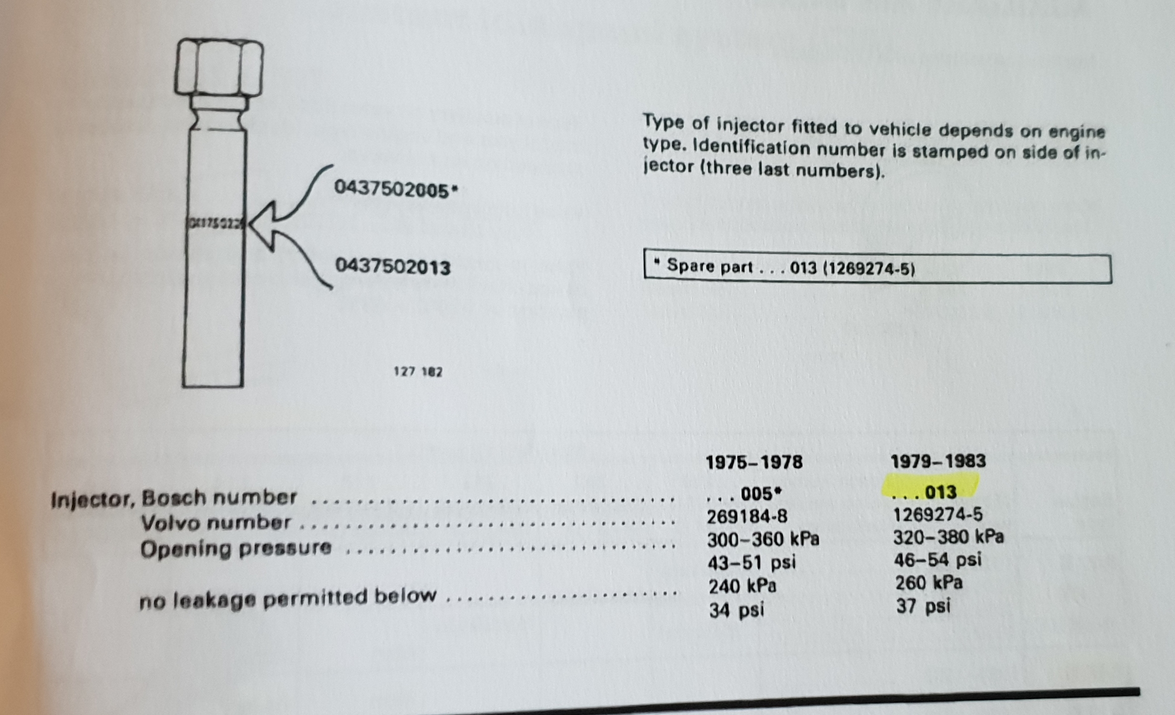

My opening pressure seems to be spot on, so the next step will be to crank the fuel pressure down a notch.
From the Volvo manual

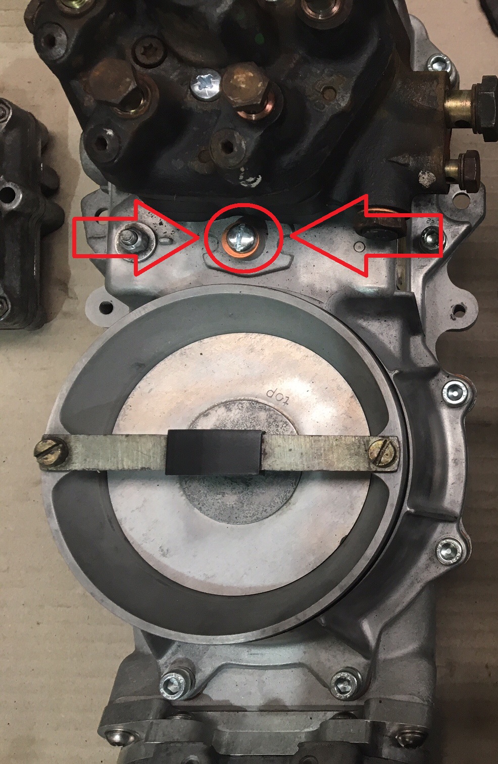

Postby MikeWard » Fri Nov 02, 2018 2:41 pm
The fuel mixture is adjusted via the threaded hole circled in the below image, using a 3mm allen key. Turn it anti clockwise until the injectors stop dribbling.

To do a full mixture setup the engine will need to be warm and you will need to use an exhaust gas analyser, set the mixture to 2% CO.

:Thanks everyone, as I said; it finally sunk in...
I have so many spares that I took the liberty of dissecting one one extra fuel metering unit that I had laying around. And then the mysteries of fuel mixture settings revealed themselves to be super simple.
I'm no longer afraid of turning that 3mm allen :D :shifty:
