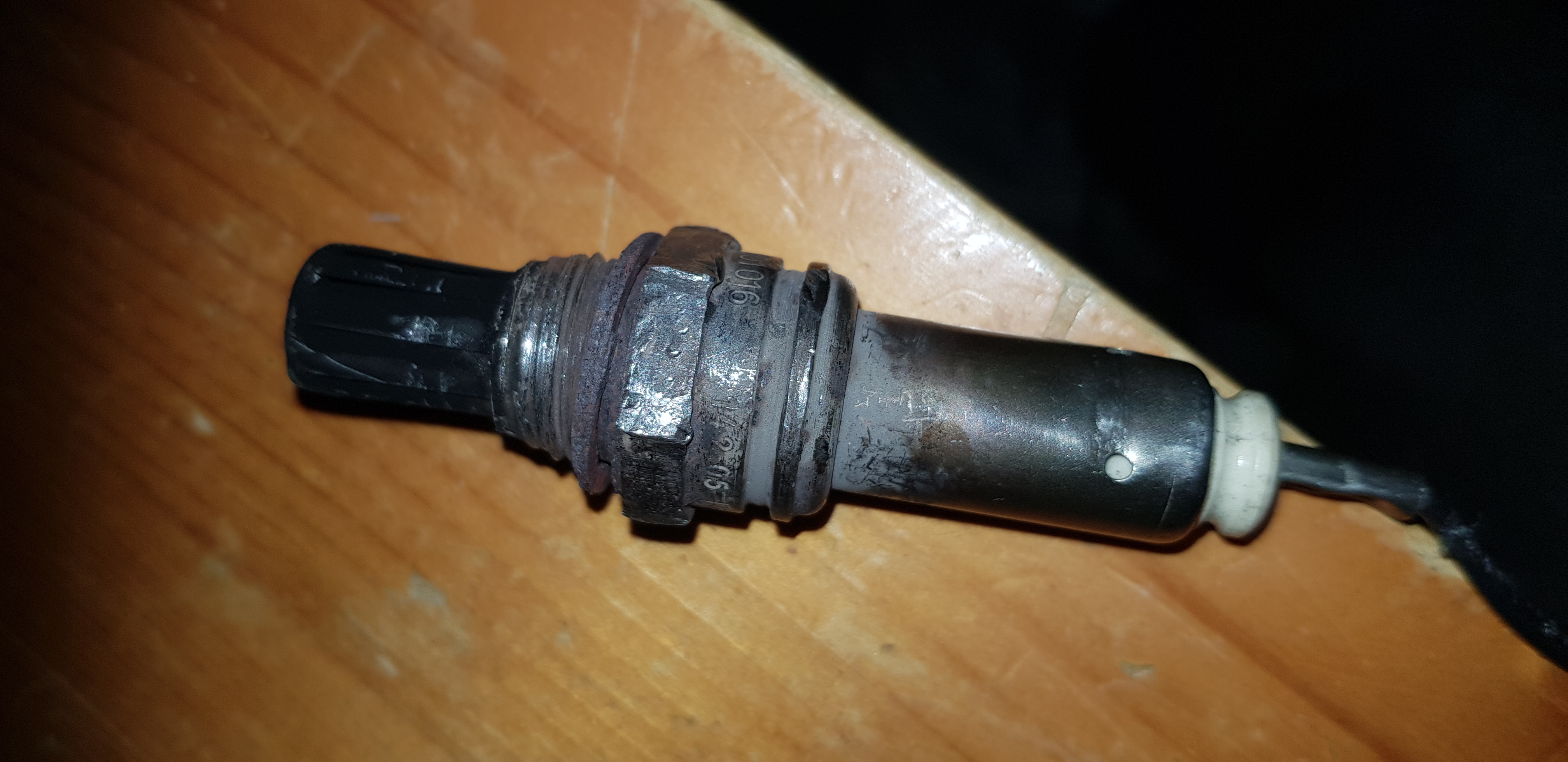

Next i wanted to set the air/fuel mixture as i cant tell if its rich or lean. I think its about right but my idle is now at 1000rpm. So i went to use a dwell meter and i got nothing from it really. Disconnected the 02 sensor and i had a reading of about 11 to 15 and it wasn't really doing much. I did get the 53 if i pressed that switch by the throttle.
So i decided that i needed to swap the 02 sensor once and for all. Well the bastard came out and the new one is in nice and tight (although its not in quite as far as the original and the washer can still be spun but its now damn tight so im leaving it as that. Its in enough as far as i can see).
The original all nice and sooty
So thats where im at and have yet to check the dwell and test drive. Im still getting some popping noises but its far less than before and occasional. Im wondering if maybe i have an exhaust leak perhaps :think: im also wondering if the NGK spark plugs im using dont agree with the car. Ive been reading that some owners have problems with them. I may switch them to the bosch ones i have if the problems persist.

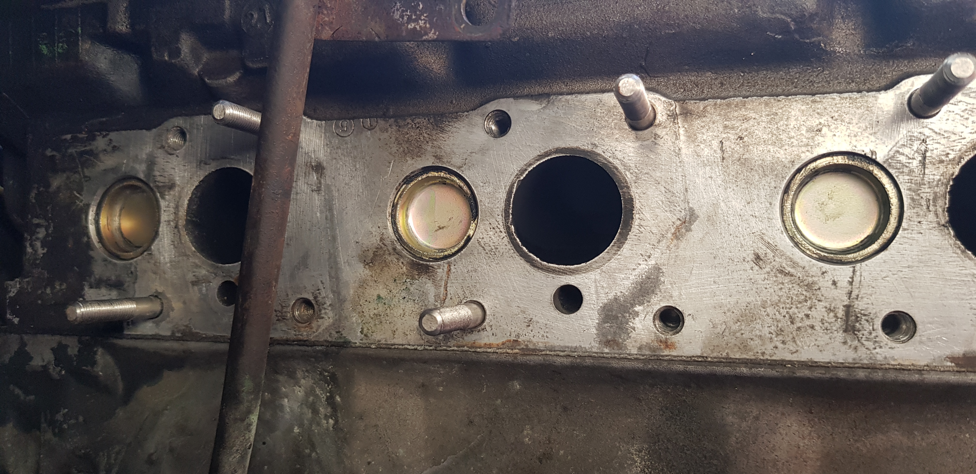

Ive been keeping some of you up to date regarding my car. Since last post i have put in the freeflow DGo exhaust (what a sound), changed a few core plugs, changed the injectors, done the roof box bolt down, refoamed the door cards, and fitted new window motors.
I had an exhaust leak which i believe contributed to the groogy acceleration. The grog is still present with the new exhaust but its much less than before and im inclined to think the timing is slightly off (since i did change the cap and rotar). Its the only other thing i can think of as im still getting the odd pops and bang. Mike will kindly look into the timing for me if the October meet still goes ahead.

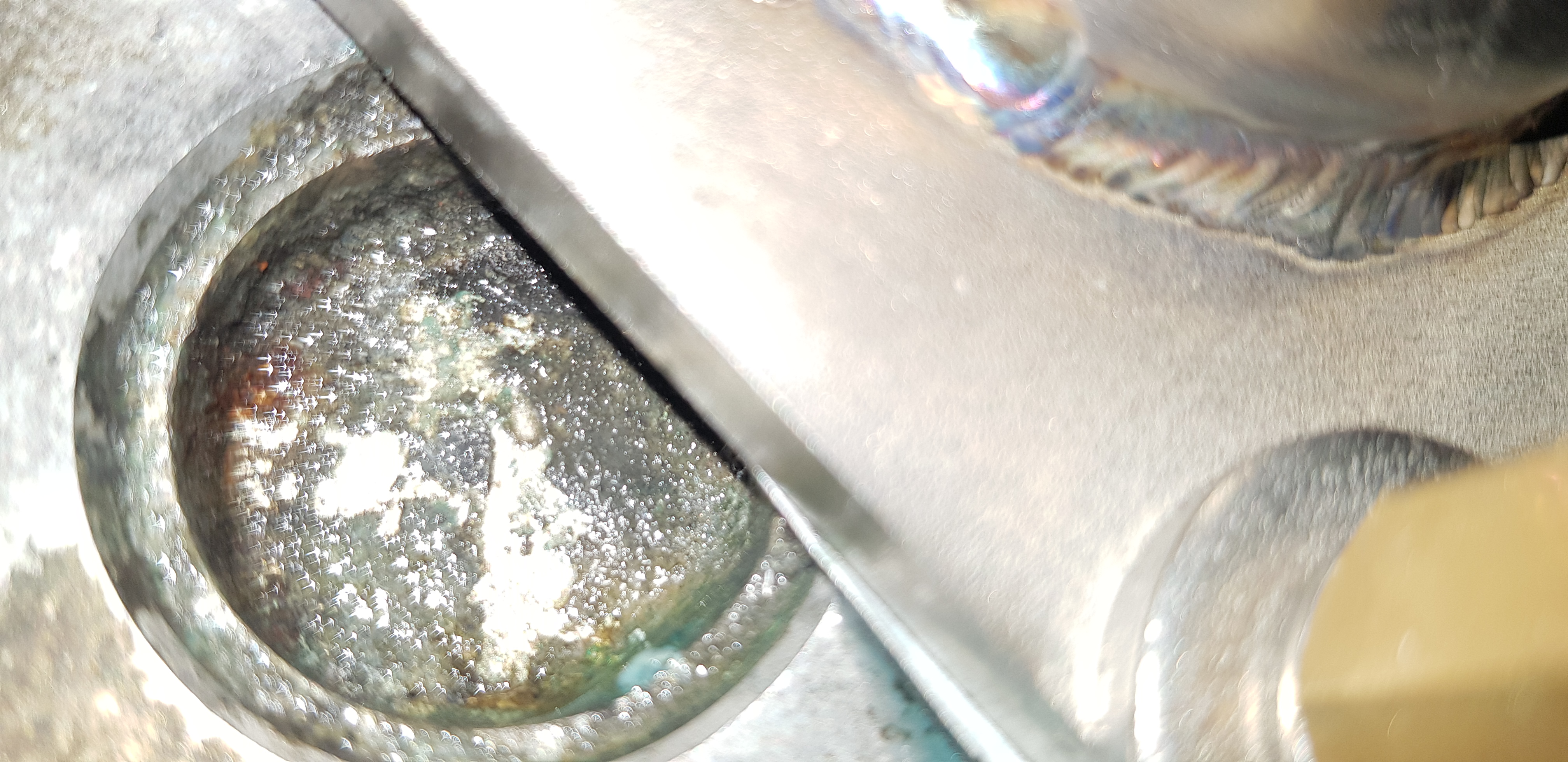

I had a leaky core plug so i had to take the exhaust headers off and decided to change all 3 on that side. No more leaks.

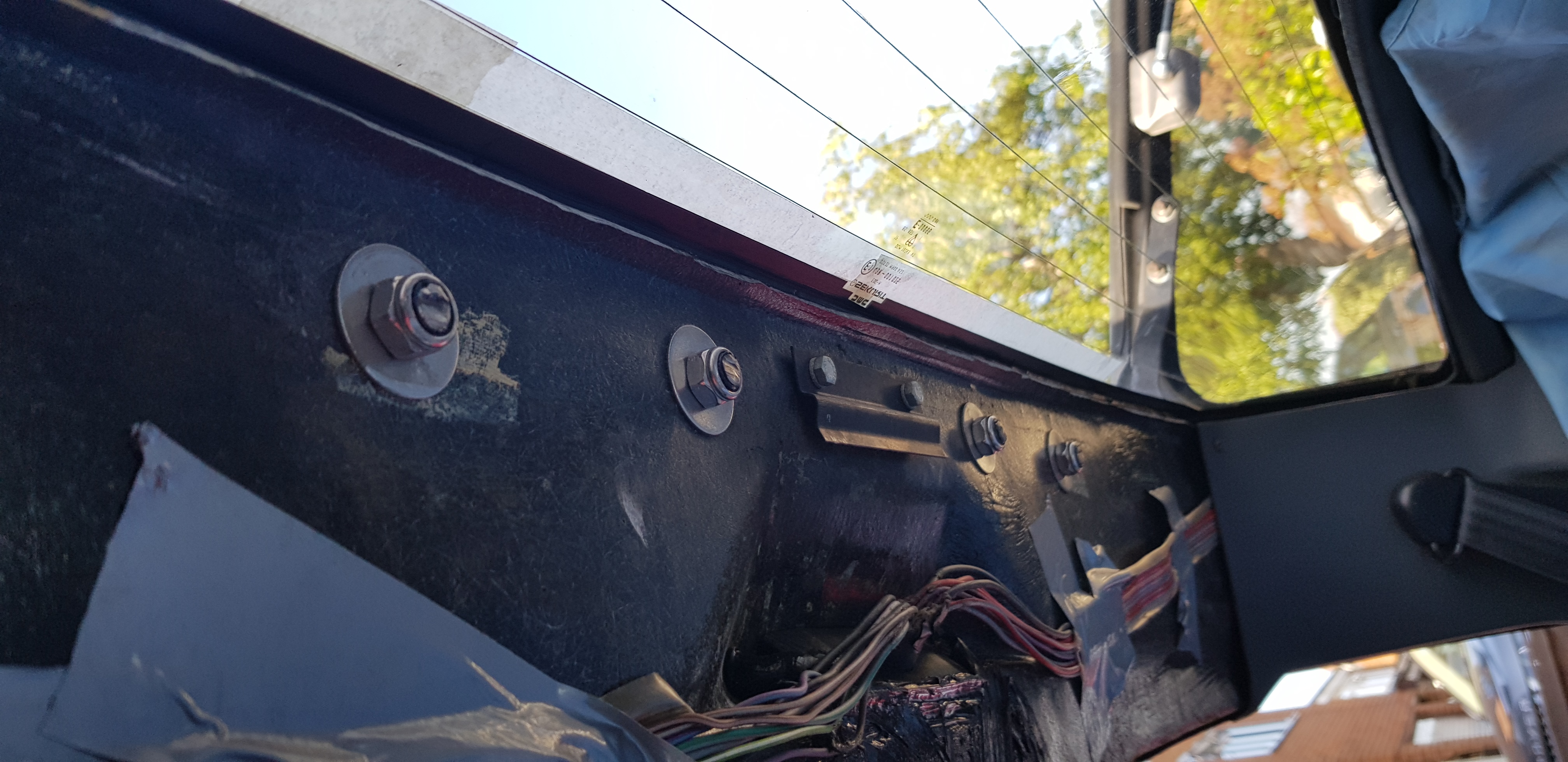

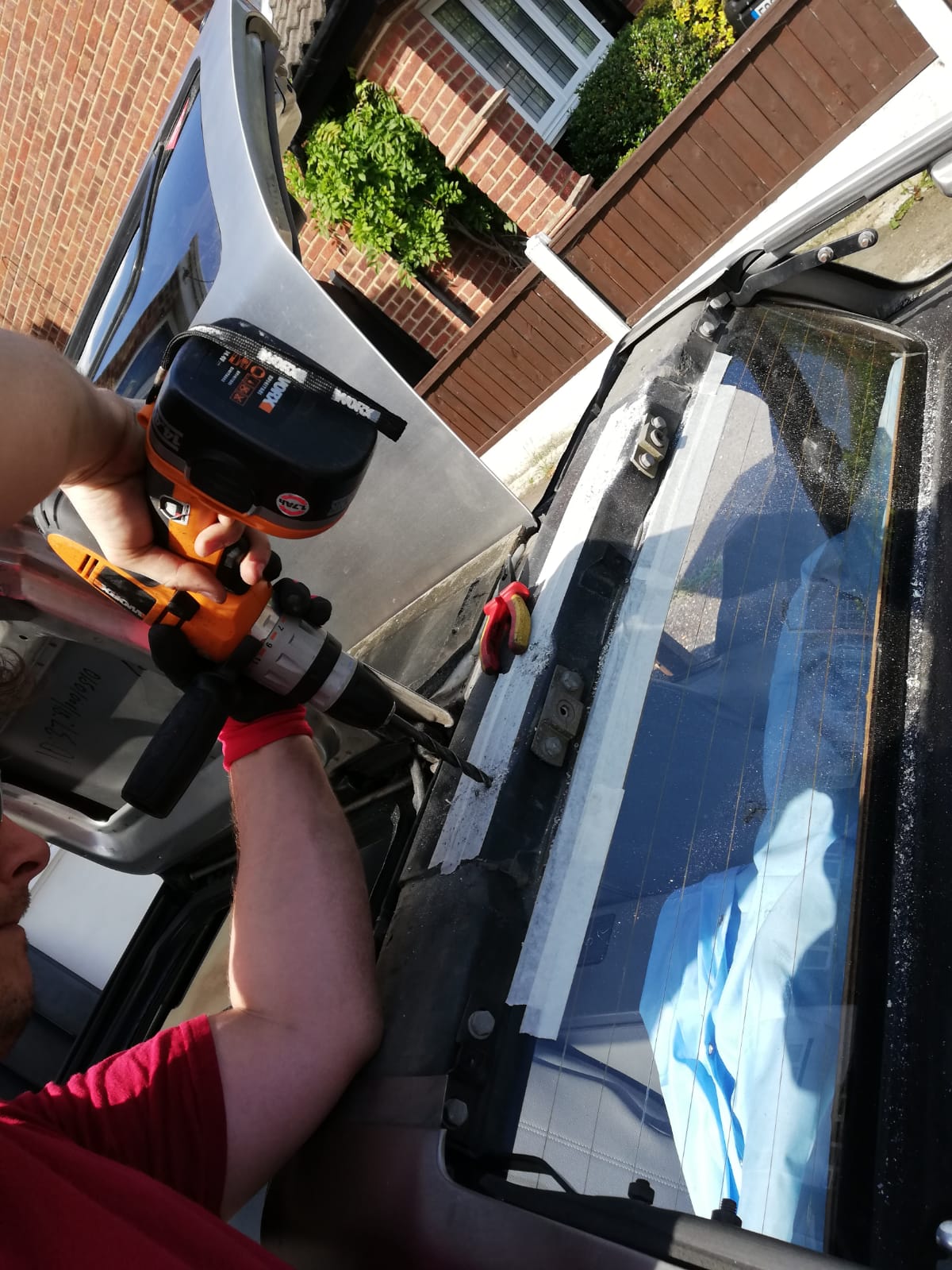

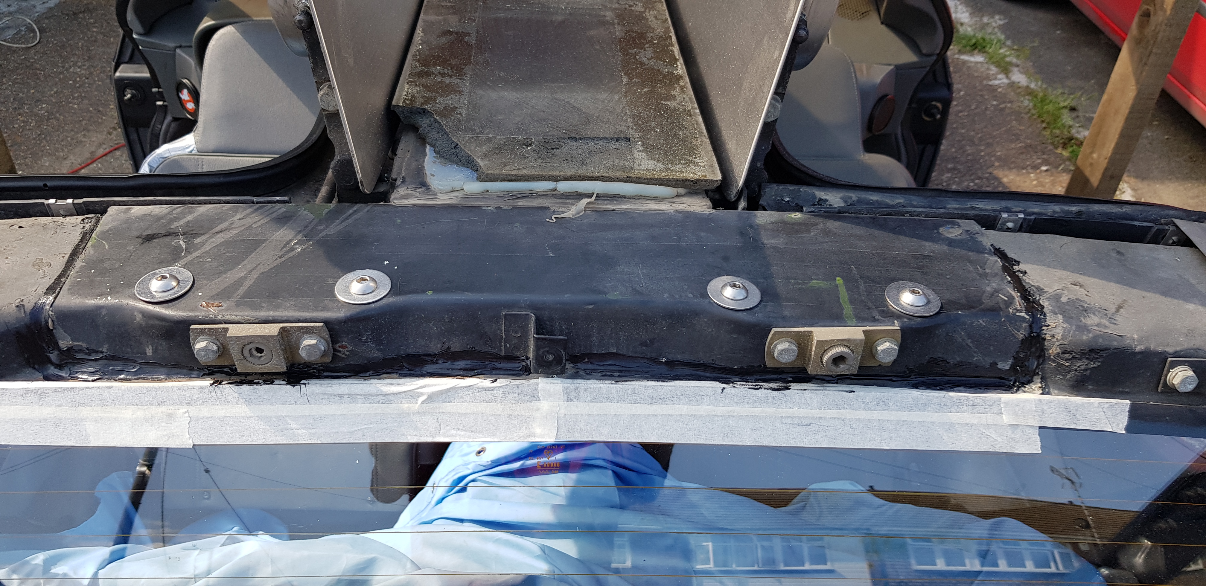

Roof box bolt down was kinda nervy but was a simple job in the end. Kept the torsion bars in. I just removed the struts and propped the doors open as much as possible. It worked. It was preventative maintenance and i will be doing the lower strut reinforcement soon.

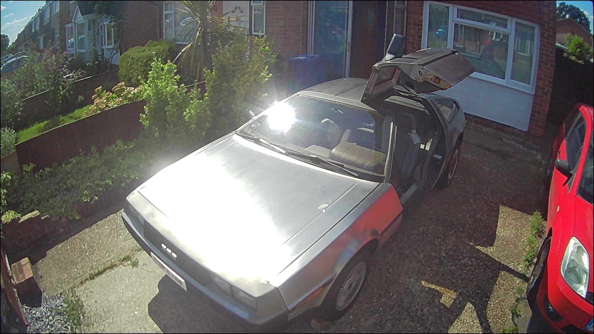

So the car is now literally going back on the road tomorrow as i just got insurance through adrian flux for 6000 miles. Just the road tax to sort, tank to fill up, lourves to put back on and another bleed of the coolant system and its ready to go for a good run/clearout. People at work really want to see it even though theyve all taken the mickey.
