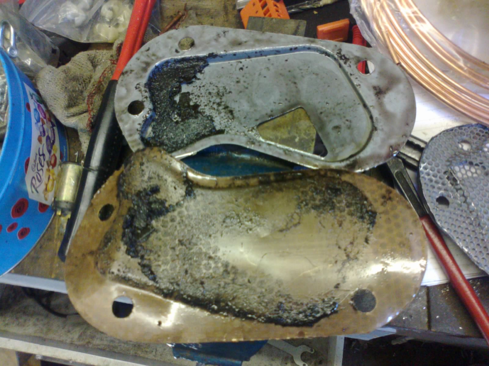

OK had another bite at the car this morning. Took off the sump and removed the filter.
Once I got it split it looked like the attached picture. Once it was all refitted I was able to drive the car up and down the driveway. Success. There is a shuddering noise though which is possibly the brakes binding a bit. Haven't moved it more than a few feet but at least it moves!!!!!!!!!!!!!!!!!!!!!!

Great news, you reckon that the filter was clogged all this time causing the problem?
Re: Project 2456- Matthew Nickels, Lisburn, NI
Postby Admin-bloke » Sat Jun 18, 2011 5:54 pm
I am shocked to see how much crap is in there !
