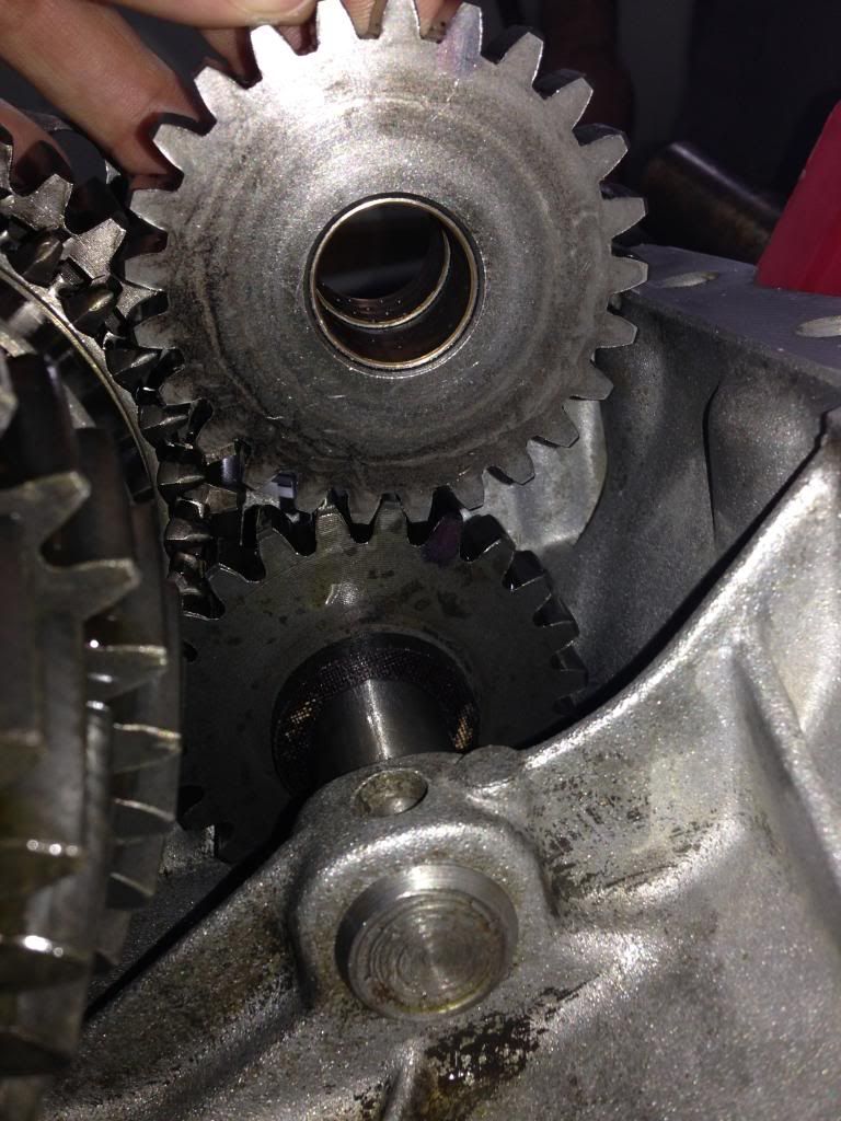

First off let me say that I received my parts from Ed, only to find out that there are several types of reverse gears. Mine has 23 teeth and Ed's replacement had 34 shorter teeth.
Damn:(
QUESTION!
SO WHAT IS THE MANUAL TRANS UN! code of the Delorean transmissions??

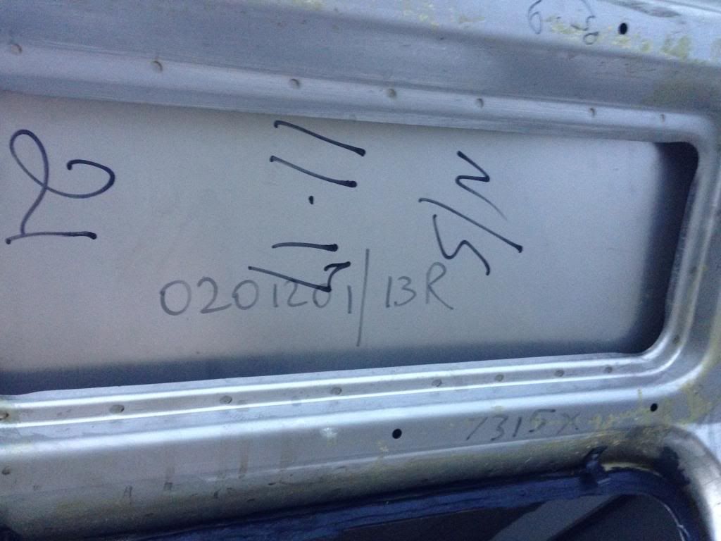

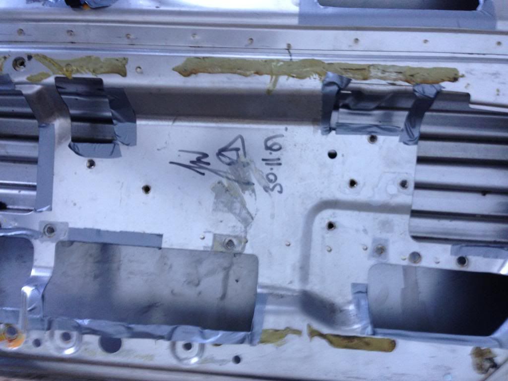

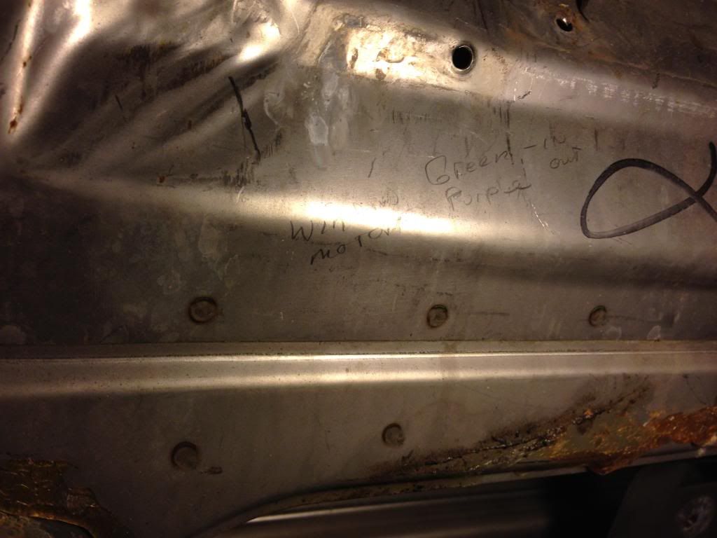

Some cave art

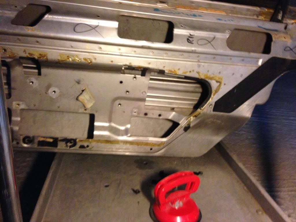

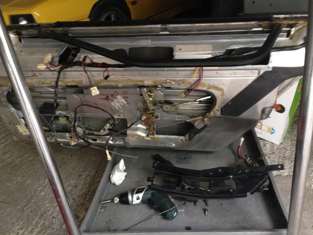

And started cleaning my old door out for its guts...

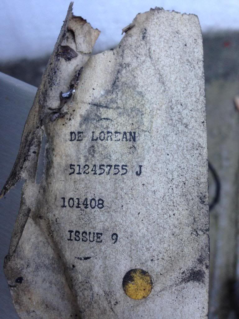

Found that little tag in my door.
And funny enough, the old PAX door replacement had ALSO little fish drawn on to it. (like my rear bumper did. My vin is 5992 and the door is 7k something) I am figuring there was a Pisces in that assembly line.
Pisces are known to use the fish outline on their cars, on jewelry etc.
Along with that wiring foot note

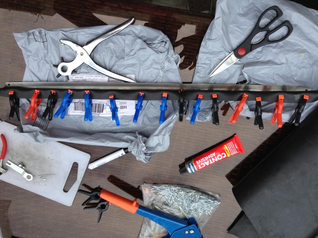

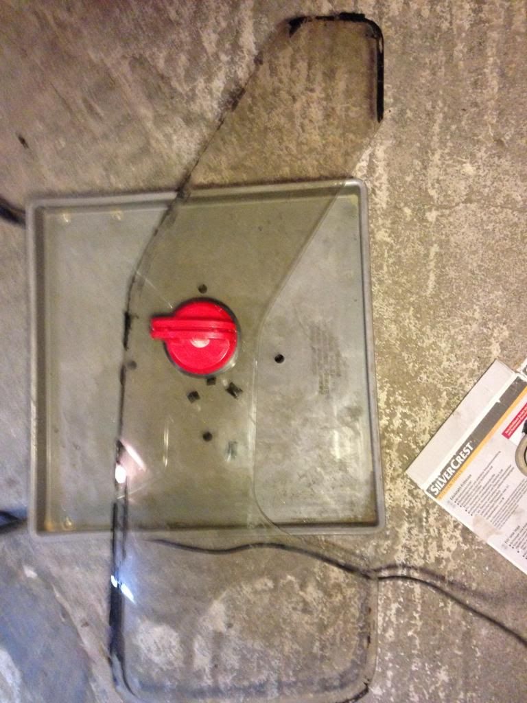

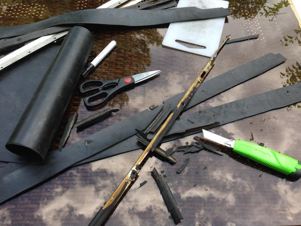

Sat down and created my own top and bottom door weather stripping. Removed the old and cut out fresh stripes.
And assembled
Finally did the delicate and hard work of detaching the fixed glass.

If your guy is not available (and I hope he gets better soon) this company might be able to help :
http://www.gtoracing.co.uk
They might be able to advise if you have them the casing number and/or description of the parts required. I wouldn't be able to help as I have the more advanced knee friendly "mighty auto"
Good luck

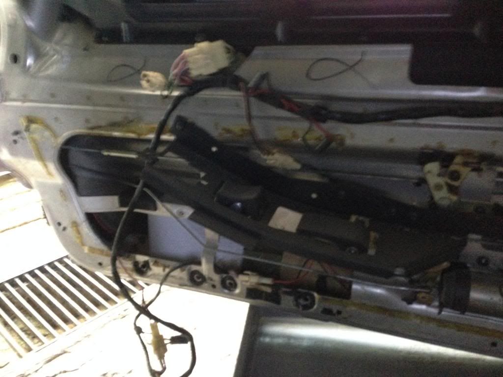

Postby ALEXAKOS » Wed Jun 04, 2014 6:23 pm
Worked a bit more on that PAX door today.

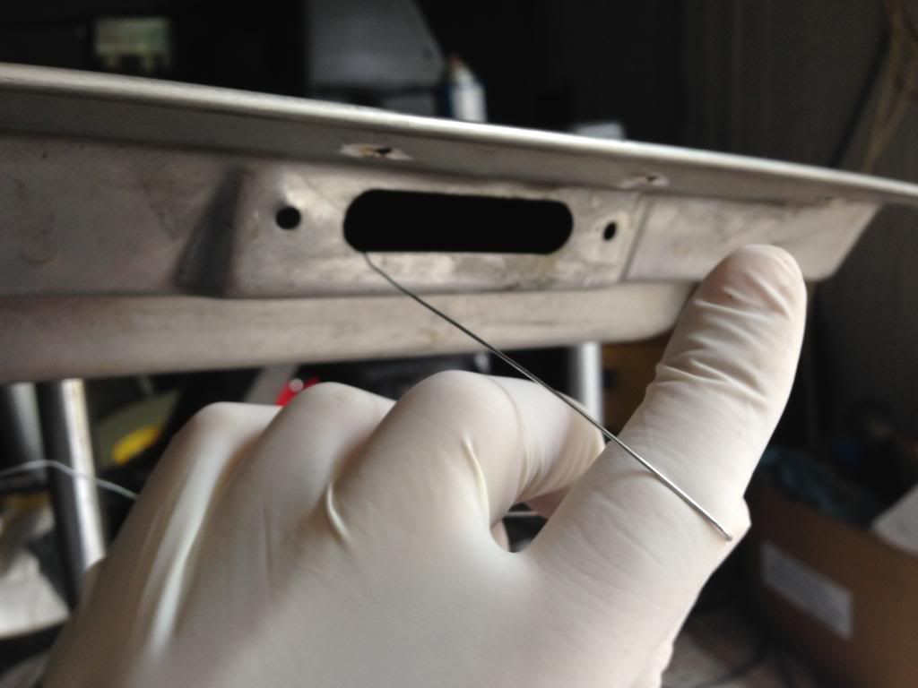

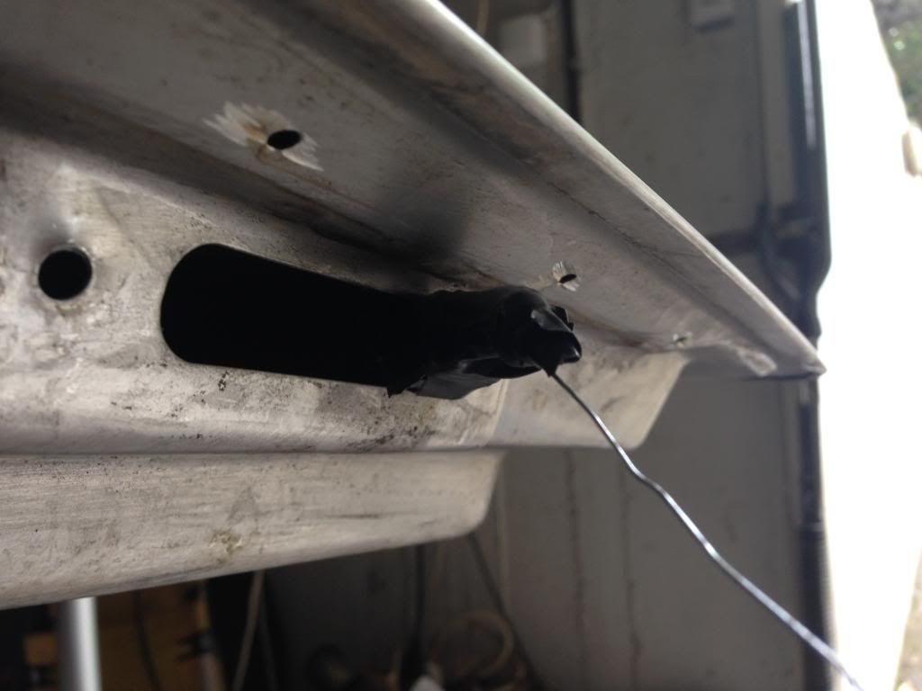

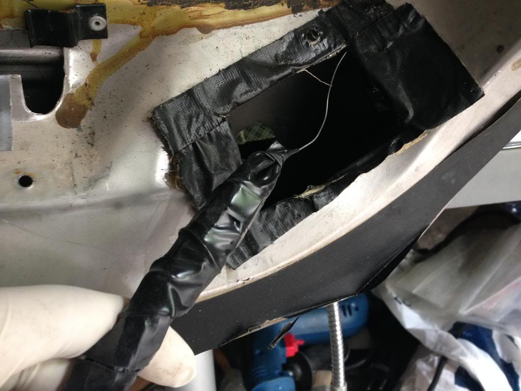

Pulled the wiring harness through the channel. I thought that would be a bitch but thankfully it got in easier than I had pulled it out!!
A tiny wire helped it a lot!!
The thin wire lets its self follow the curves of the channel easily
twisted and taped it around the harness pushing on one side and pulling on the other
And there it is... Pickabooo!!!

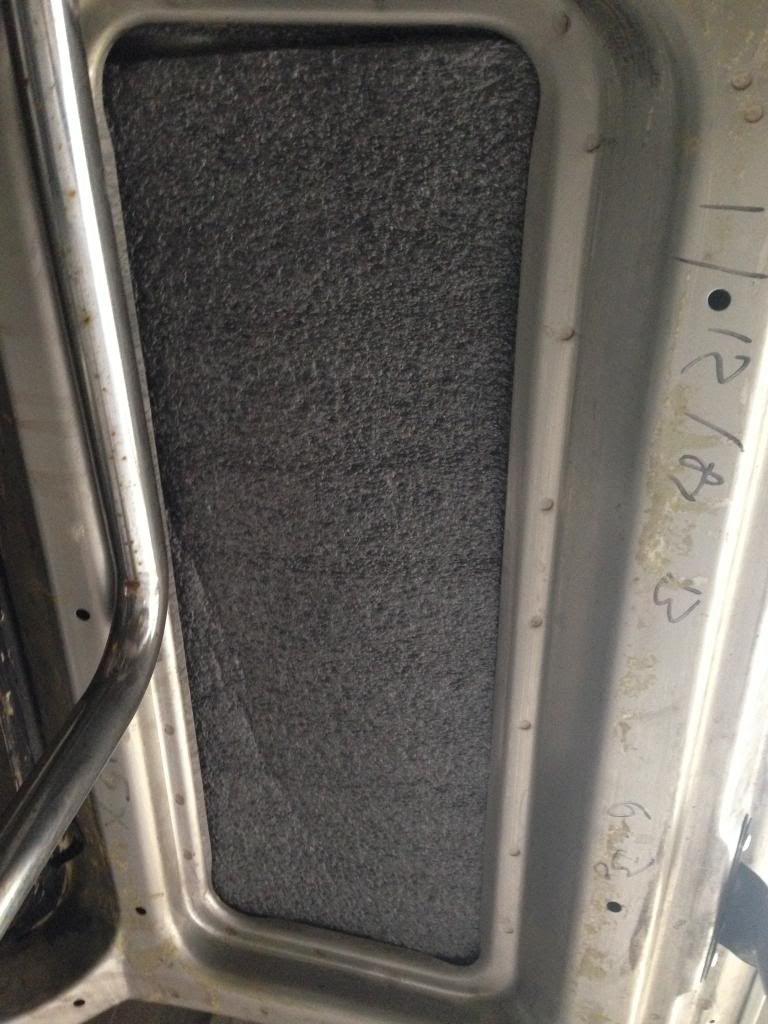

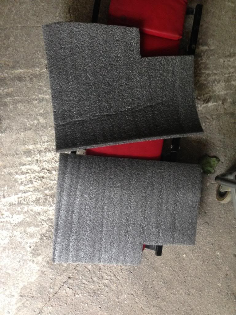

Finally I cut a couple of heat shield styrofoam sheets about 2 cm thick...
and placed them into the head sink gap of the door. That should keep some of the high temperatures of Greece off my head.
The good thing about it is that you can pull it out anytime you want to.. but i wouldn't see why one would need access to that compartment.
