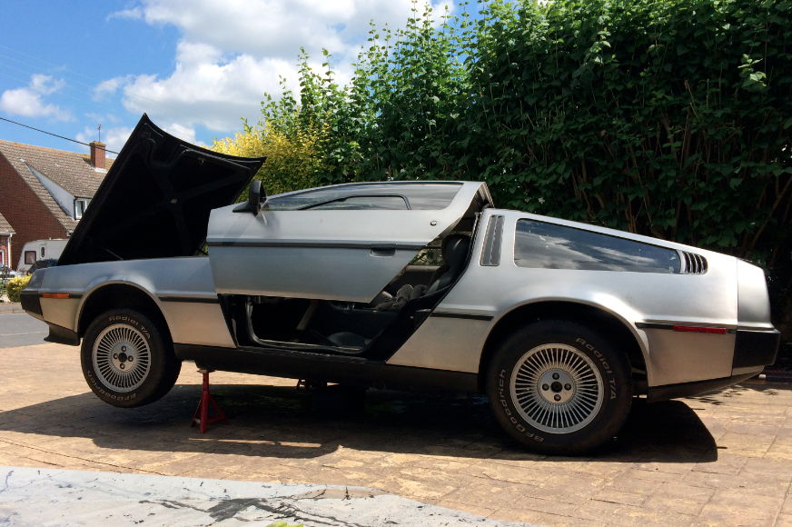

Postby Dan 6511 » Tue Jul 01, 2014 10:02 pm

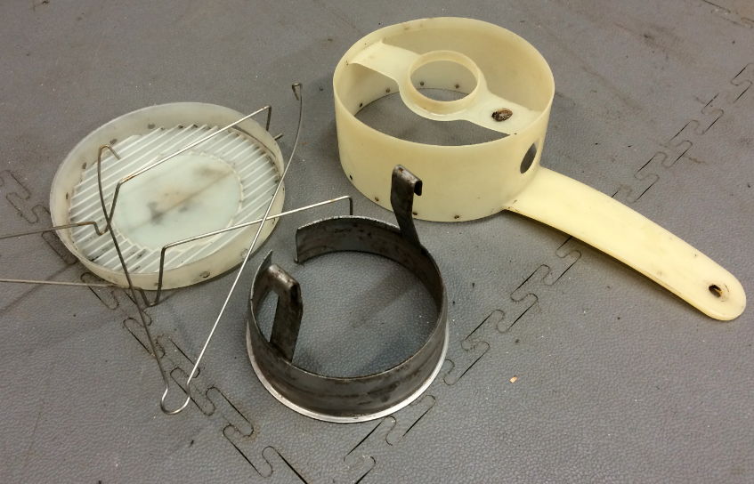

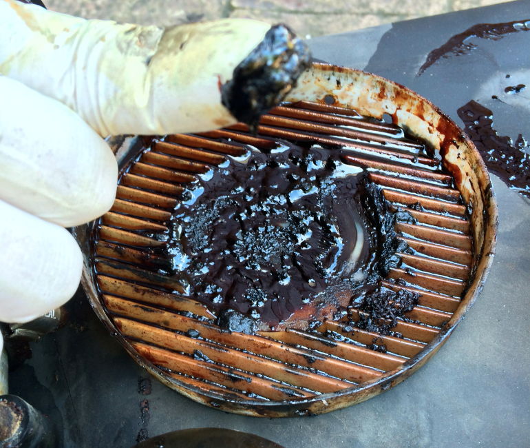

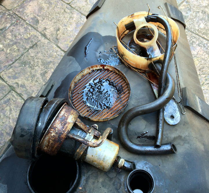

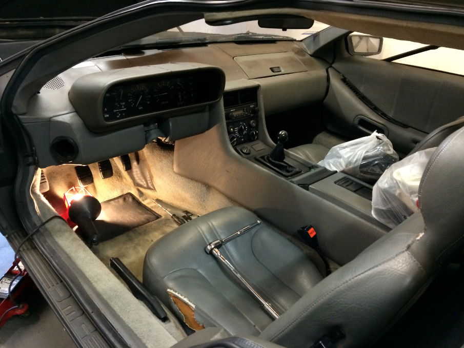

Well I finally had some time on the new Delorean. Dragged it out of the garage and removed the fuel tank. Inside was totally gummed up with a thick tar which I believe is the ethanol in the US fuel melting the rubber pipe and boot. Also note the floppy doors.
The parts cleaned up ok, and the fuel pump actually works now after reversing the polarity back and forth a few times to free it off.

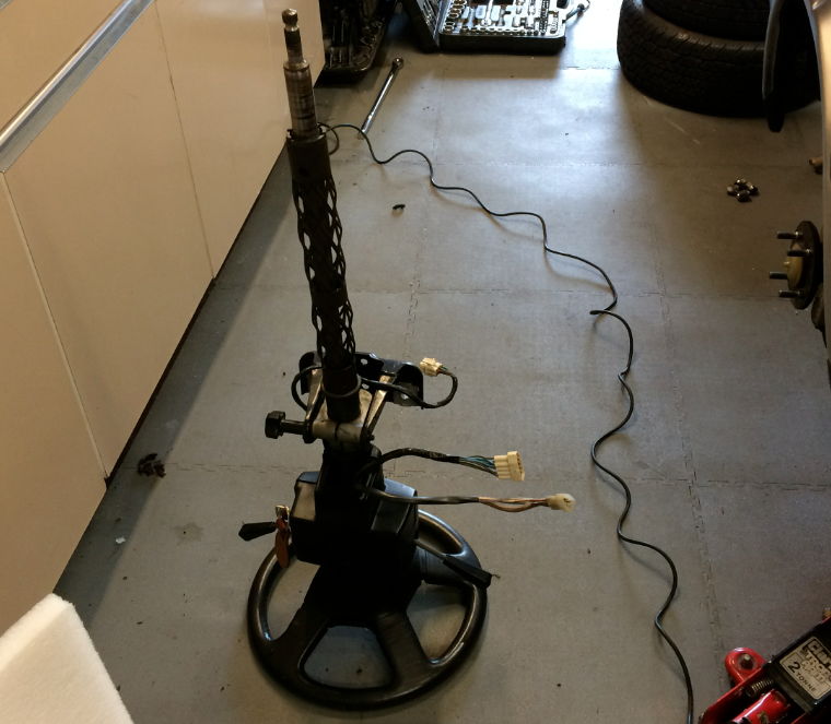

The steering column bush was non existent, so I have fitted a new one:

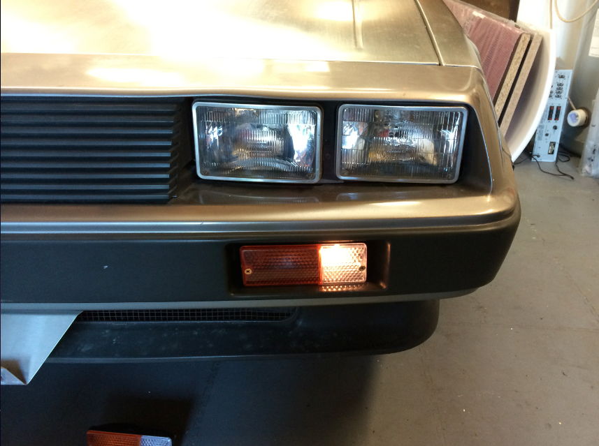

Lada lights fitted for the MOT only, then will put the stock lights back in ;) No wiring modifications needed, other than having to add a fog light :)

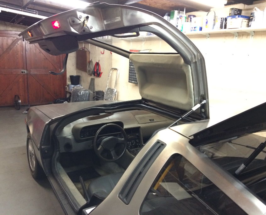

New struts fitted all round. The doors wouldn't close with the new struts fitted as the torsion bars were too tight! I had to back them off 2 splines :shock: All working perfectly now though, and the doors actually shut nicely!
