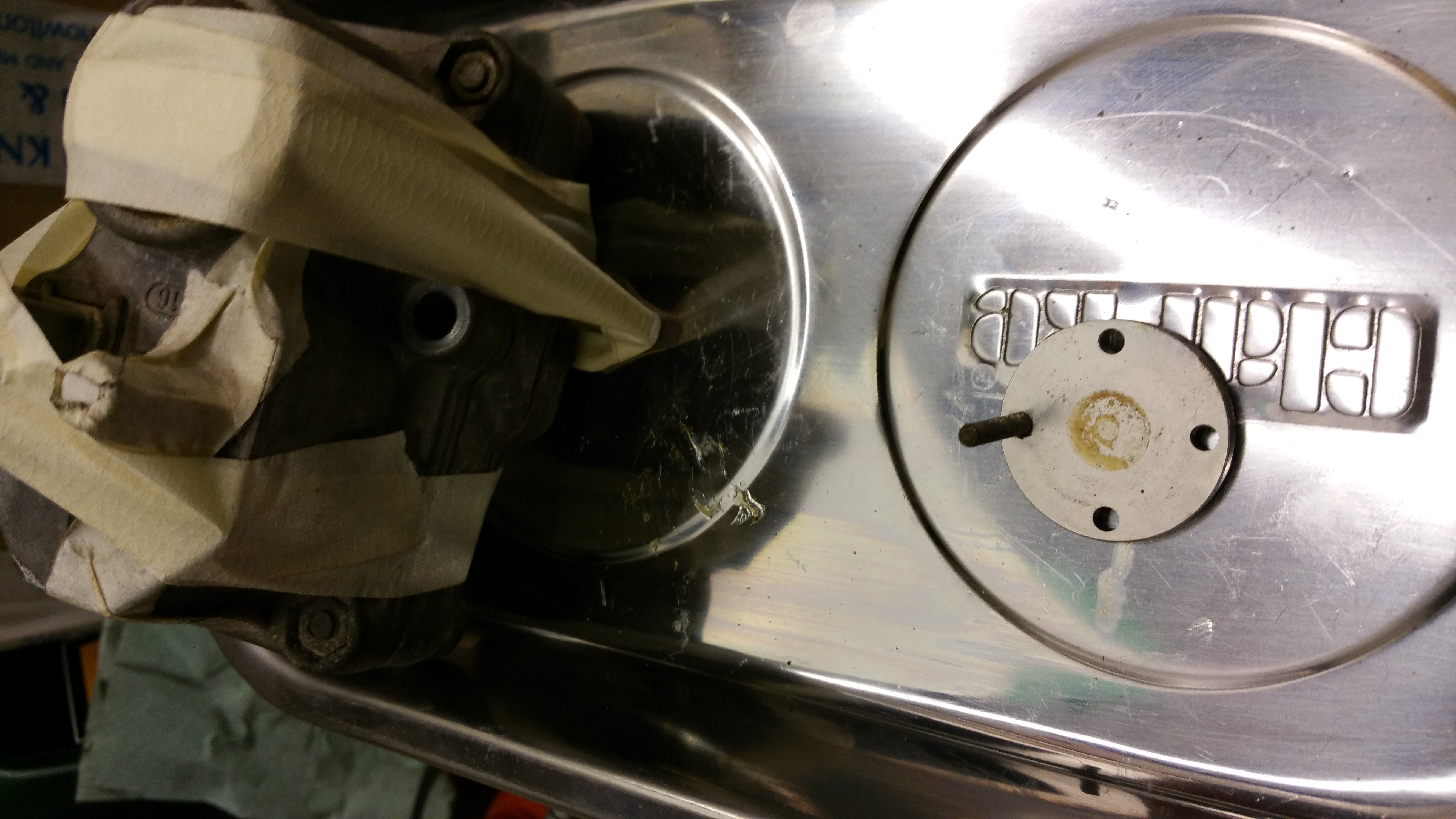

Postby Admin-bloke » Thu Oct 22, 2015 10:06 pm
Mike W and I did a fuel pressure on Andy's car at the popular October Tec event:
viewtopic.php?f=32&t=4759&start=120
Unfortunately the Control Pressure was wrong.
So Andy, I've just overhauled your CPR:
Inside clean after blowing out with an airline and Carburetor cleaner :)

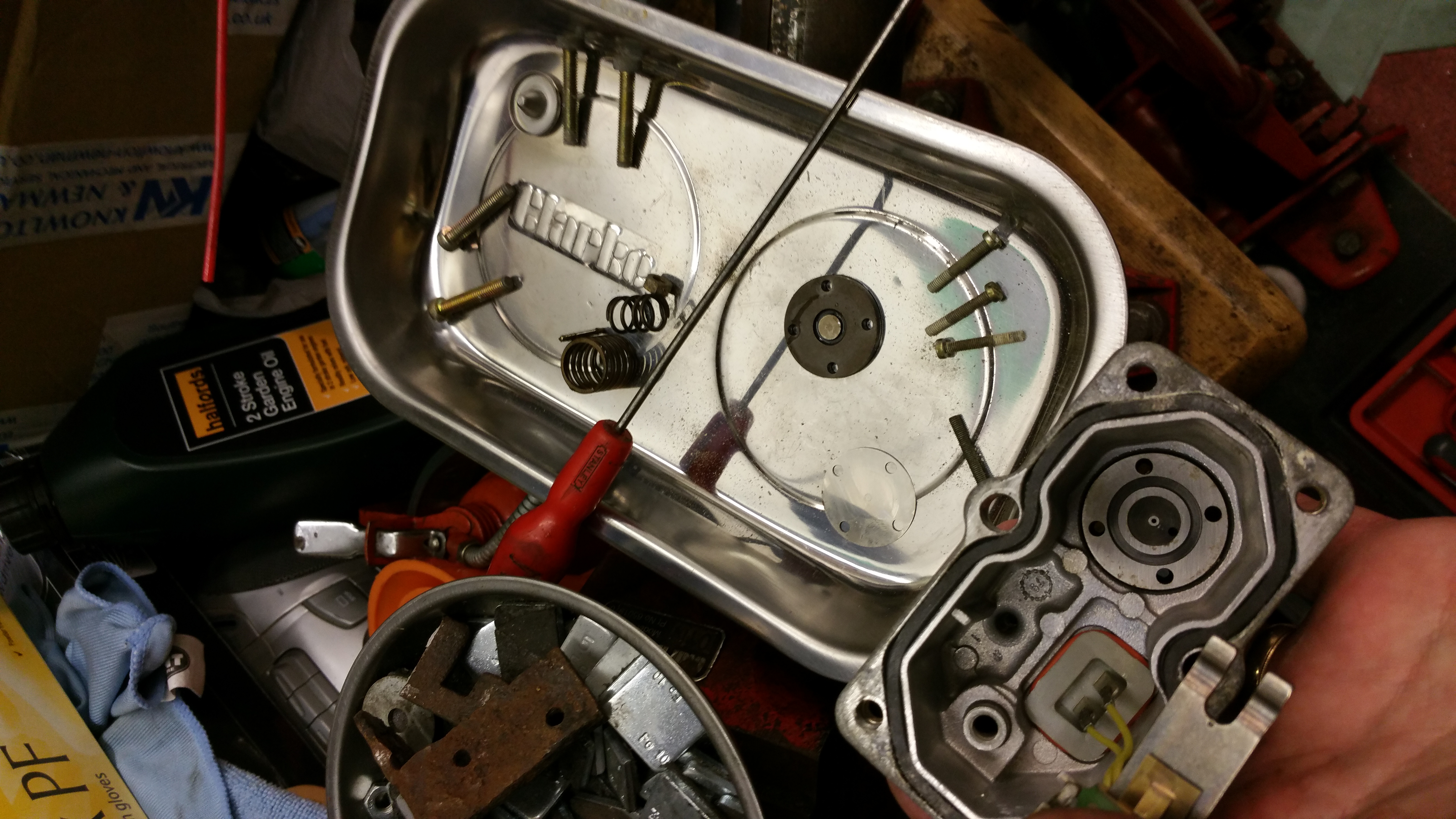

Postby Admin-bloke » Thu Oct 22, 2015 10:09 pm
Rusty diaphragm. Explains why the filter was also brown and rusty causing constricted flow :)
