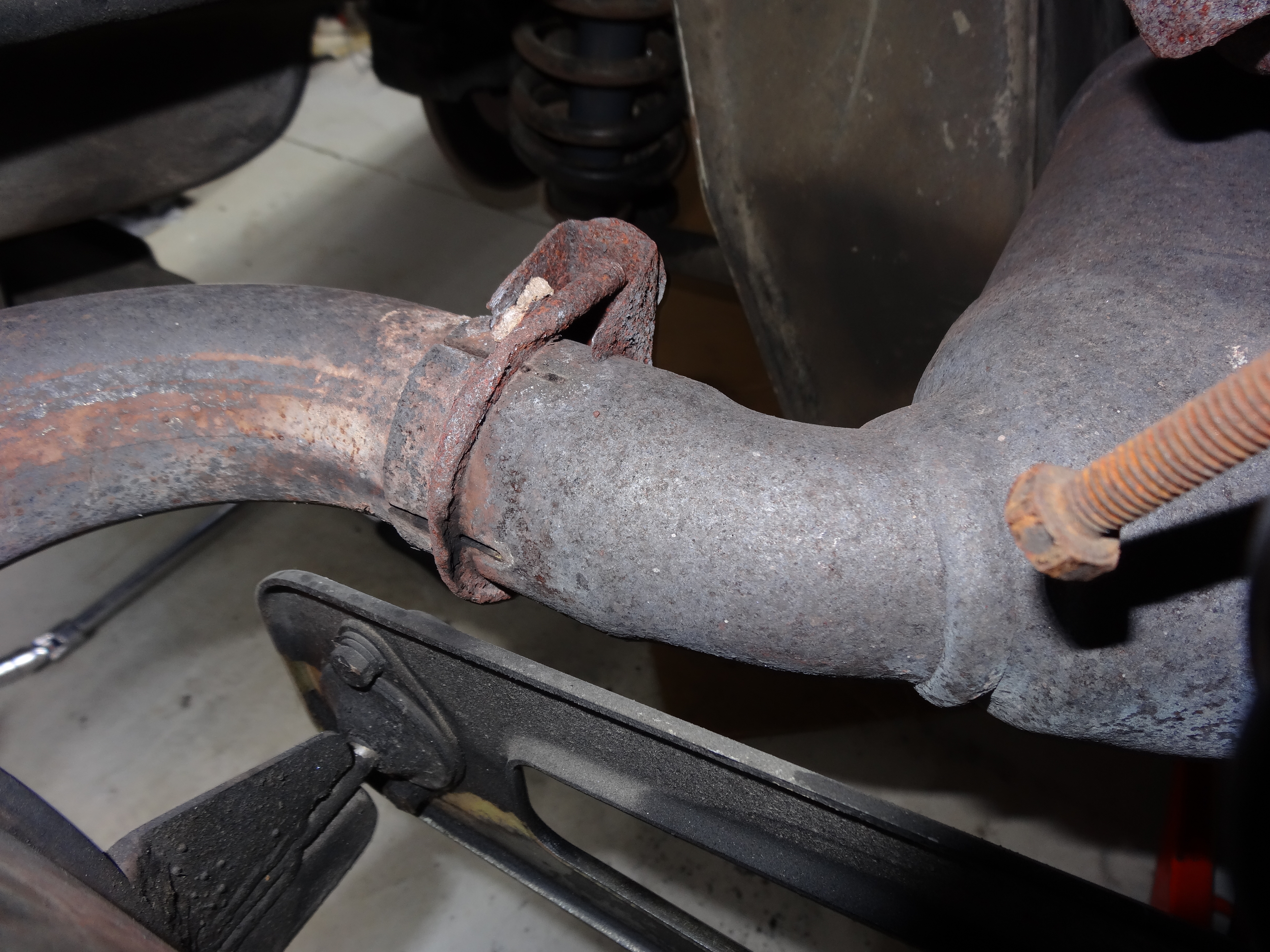

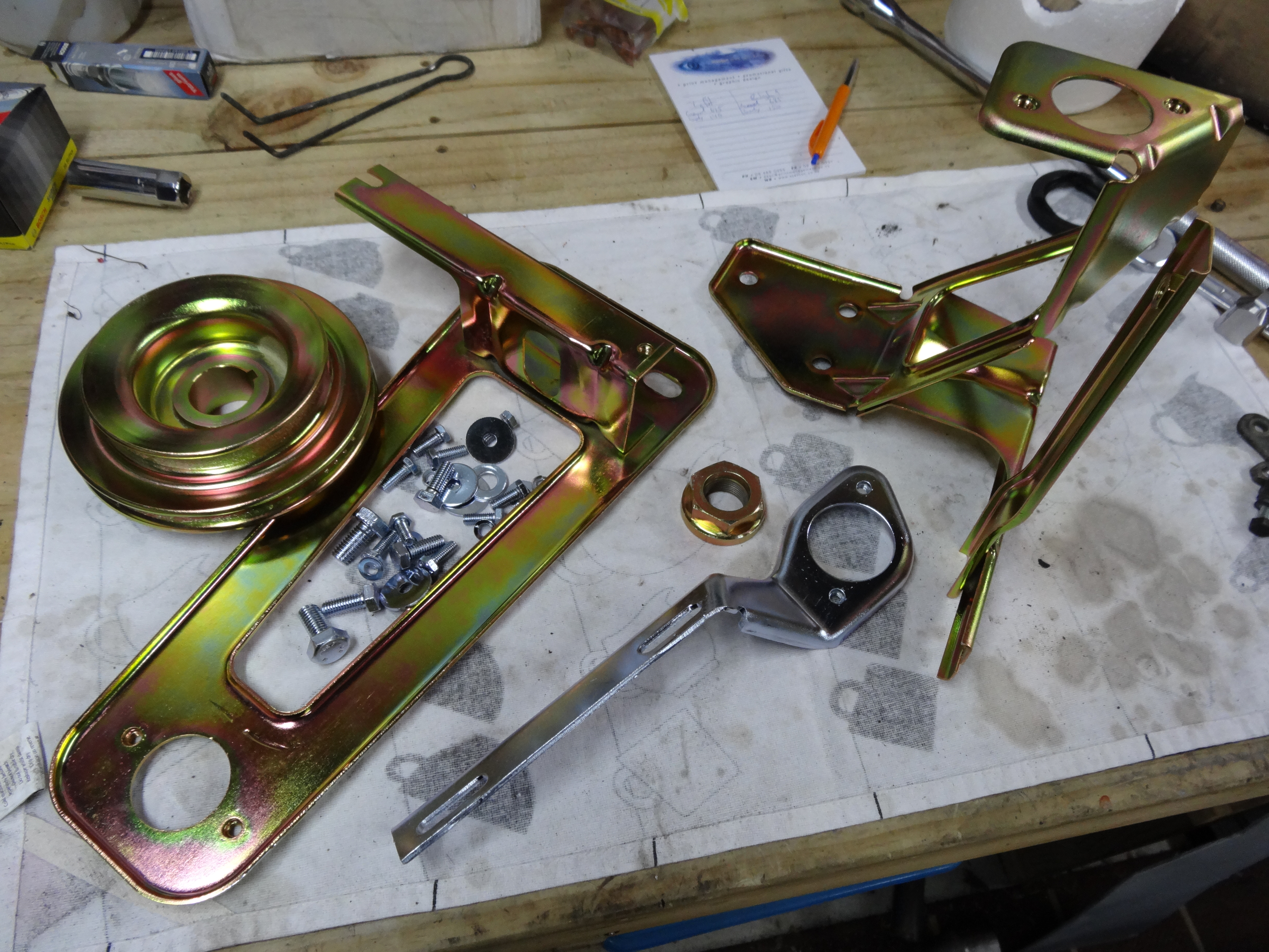

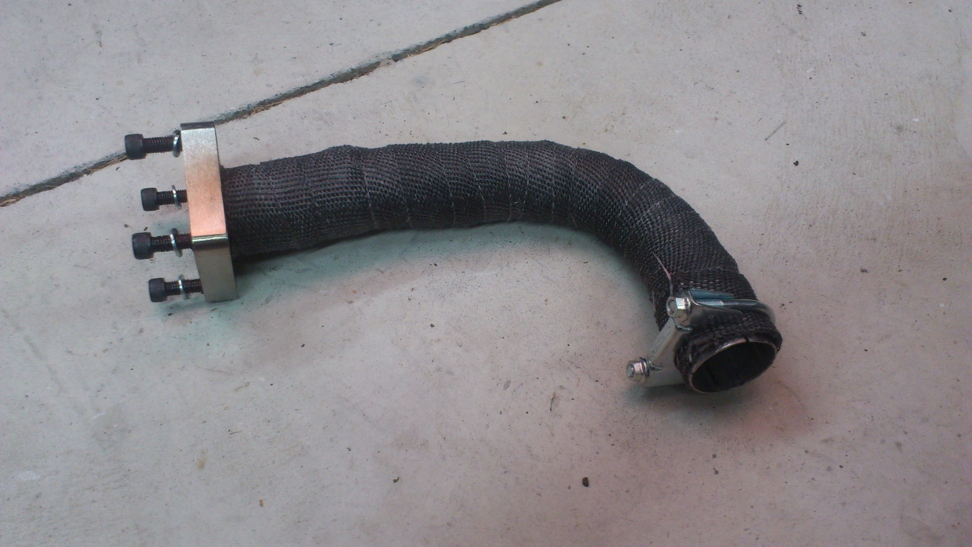

Postby gary290 » Thu Jun 16, 2016 10:14 pm

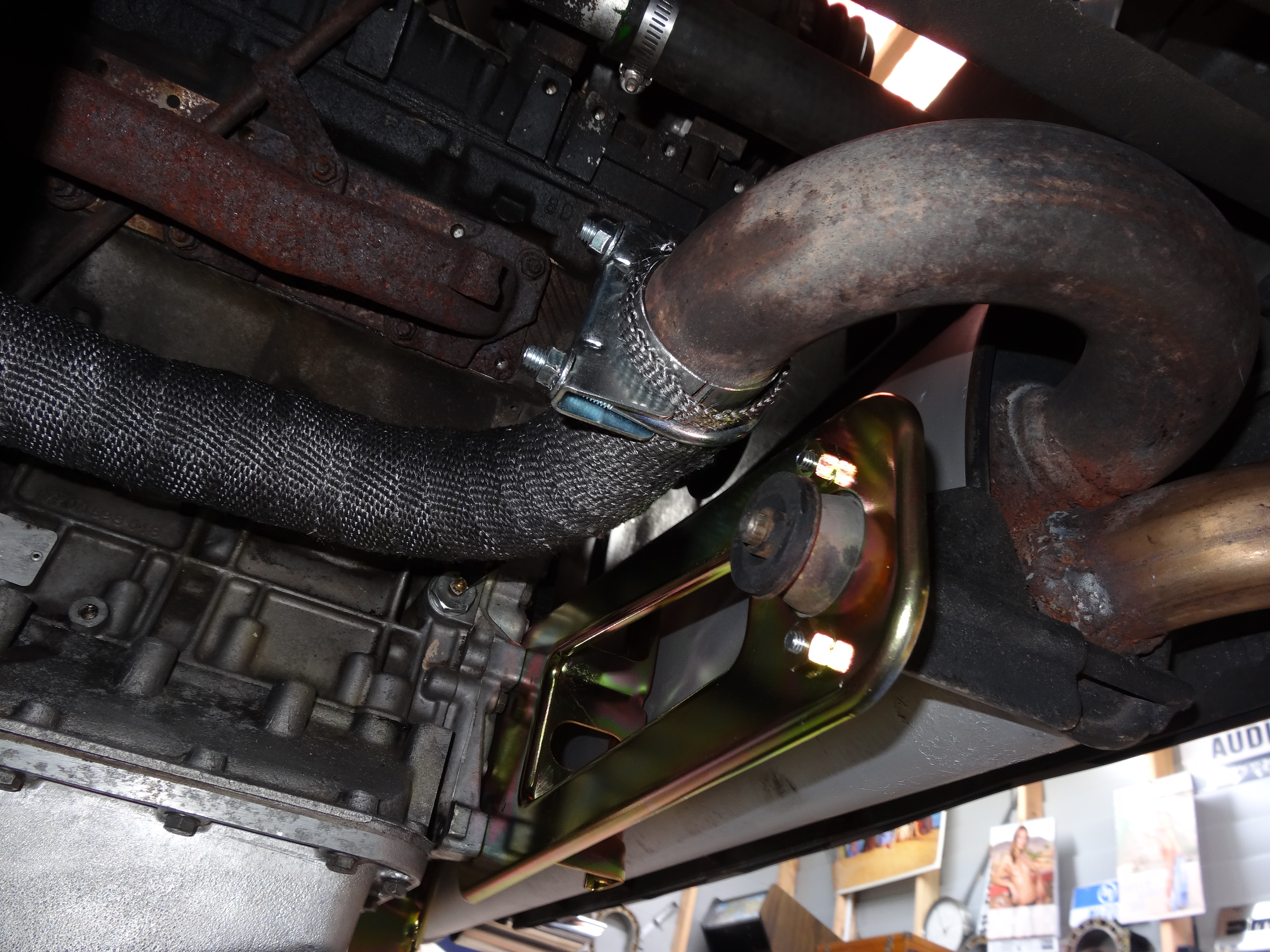

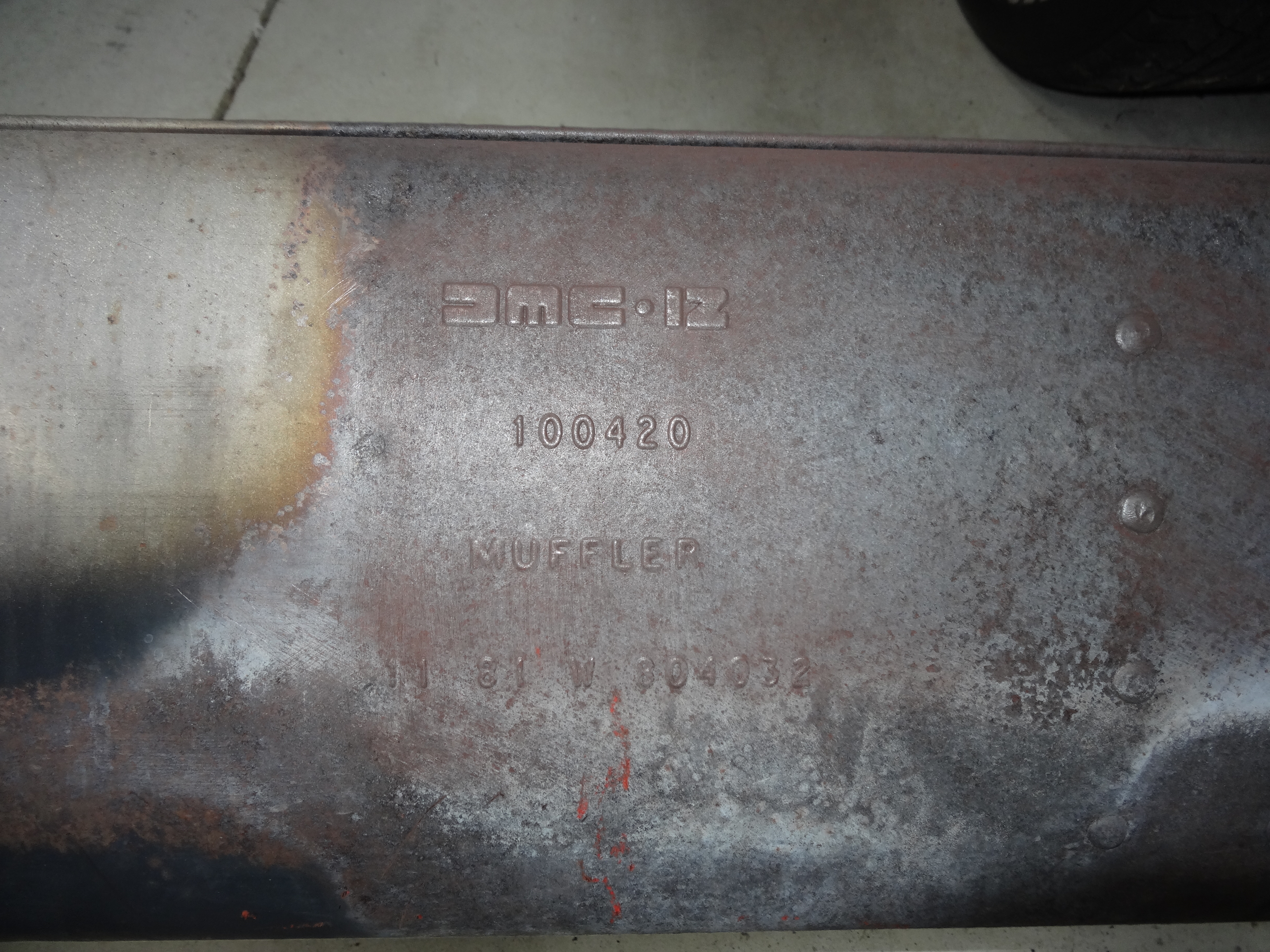

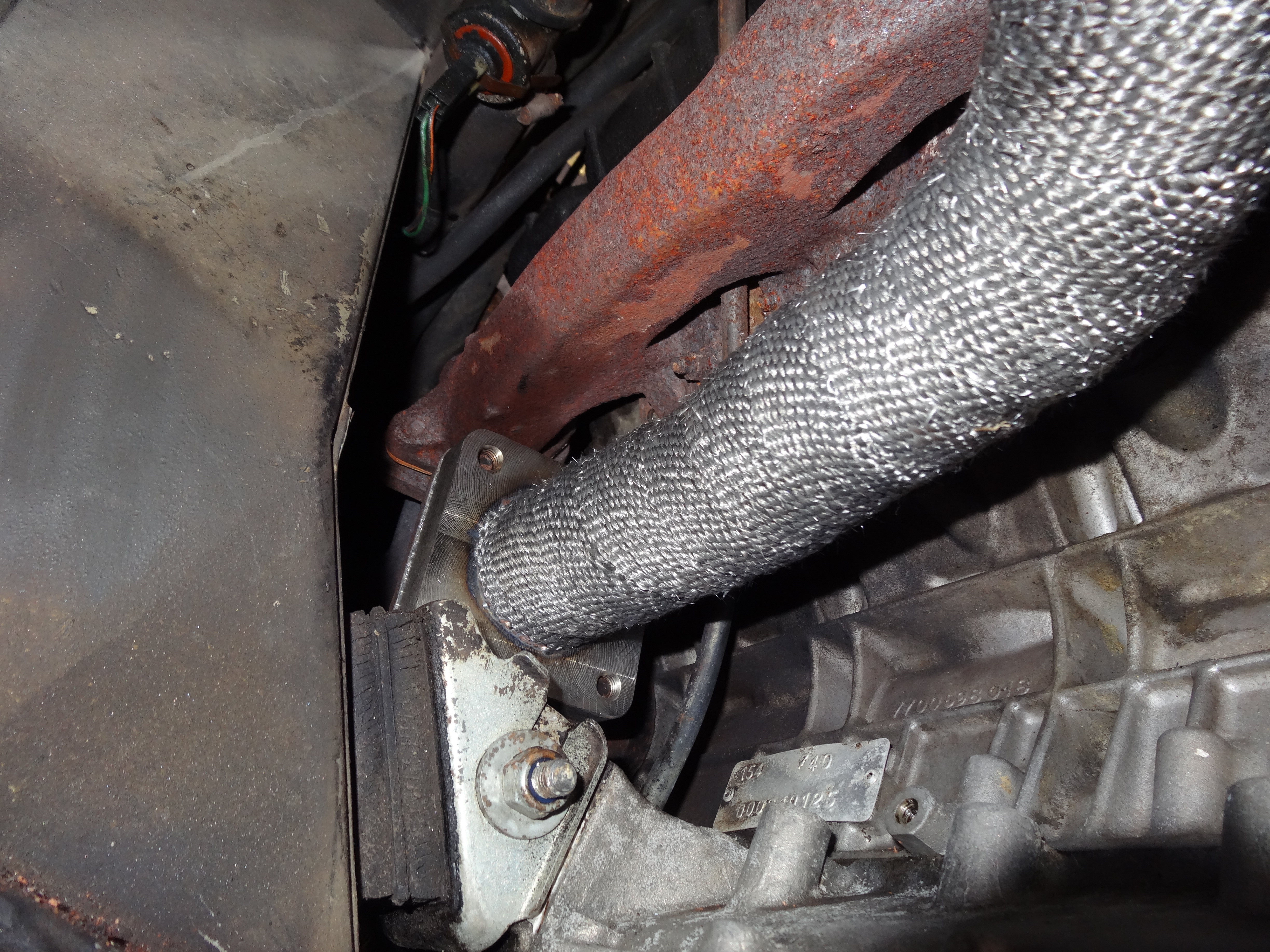

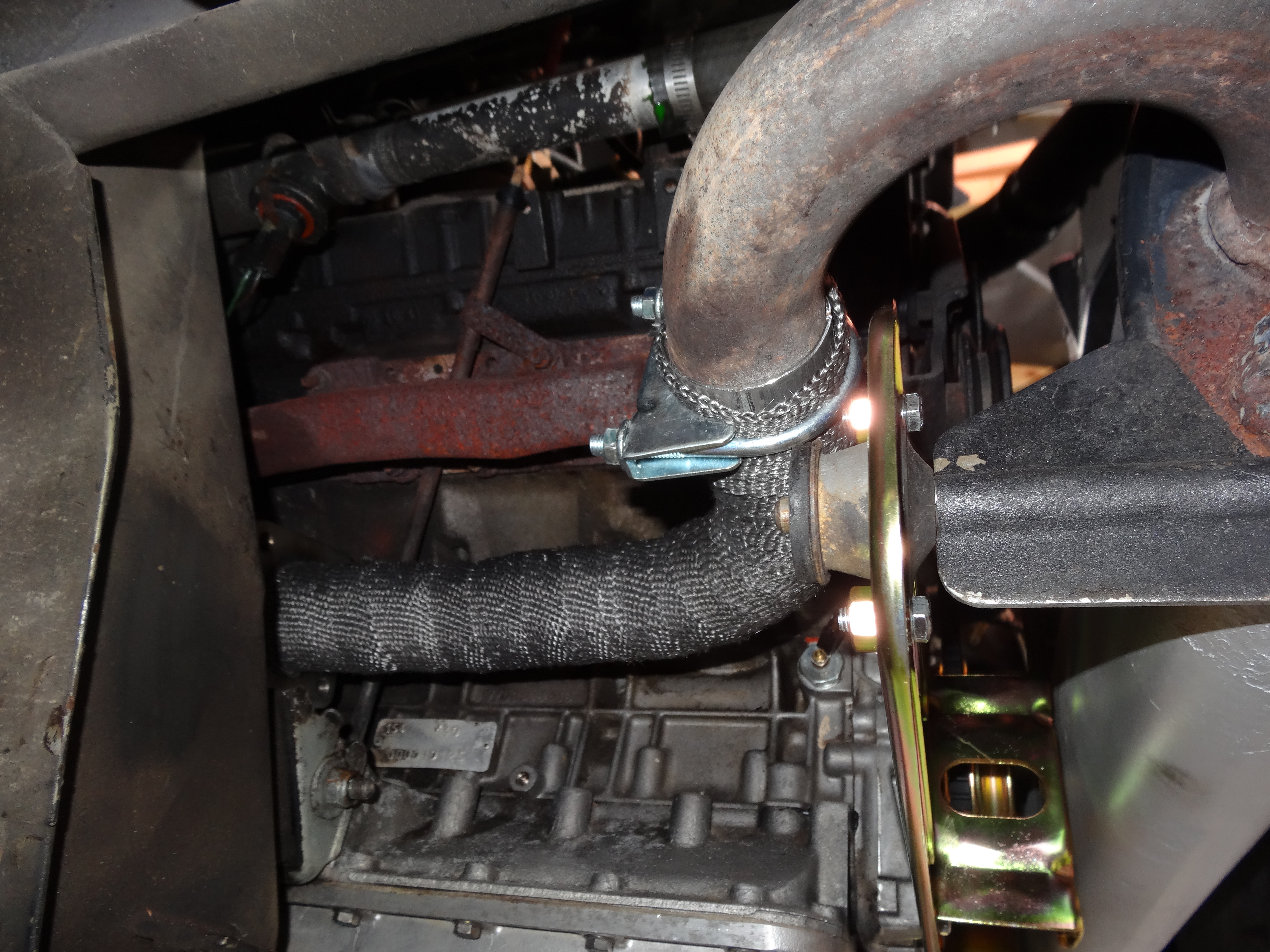

the exhaust clamp has seen better days so instead of changing it i decided to get rid of the cat all together
and the muffler is original
made up the de-cat pipe and gave the muffler a bit of paint

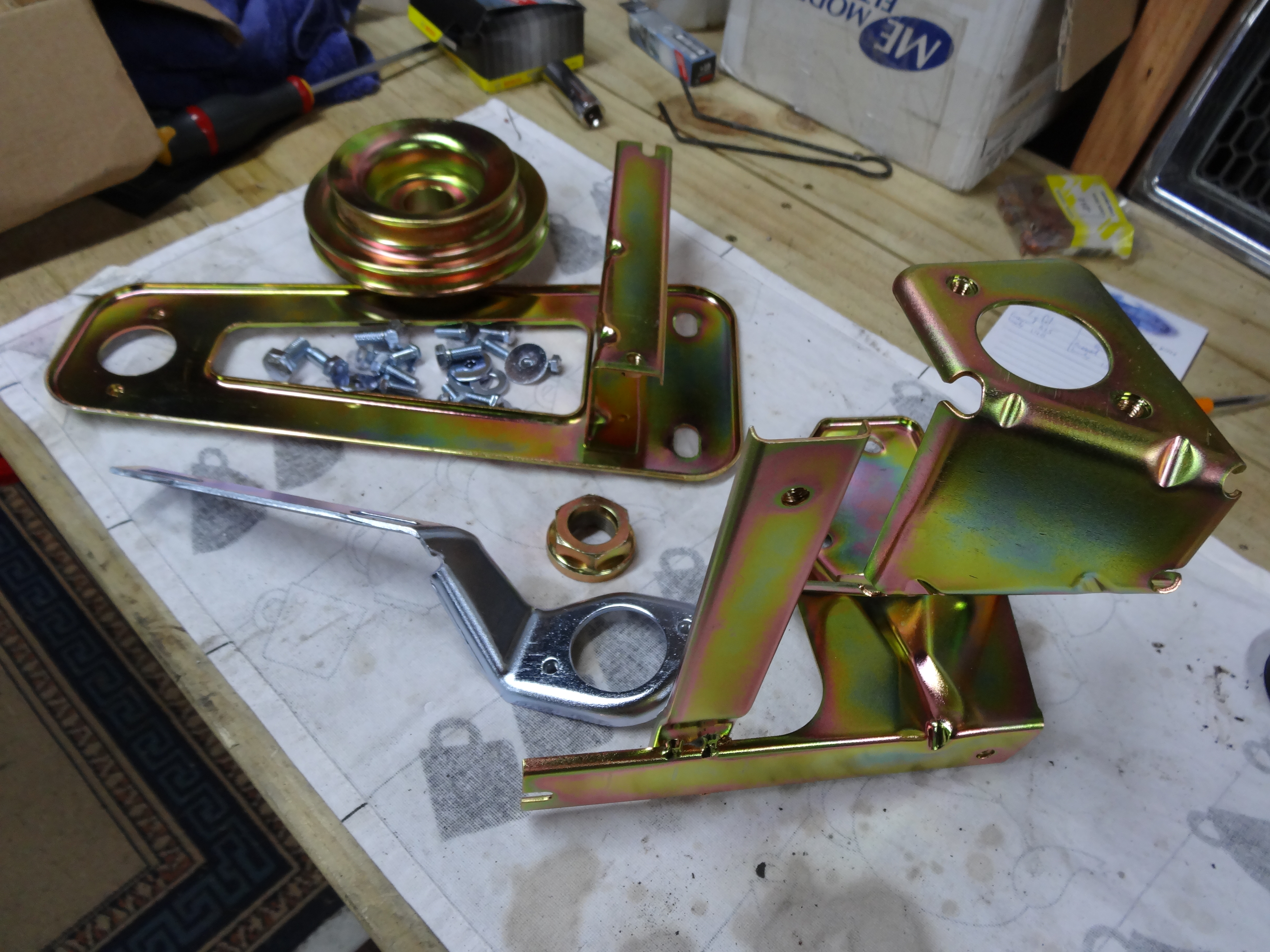

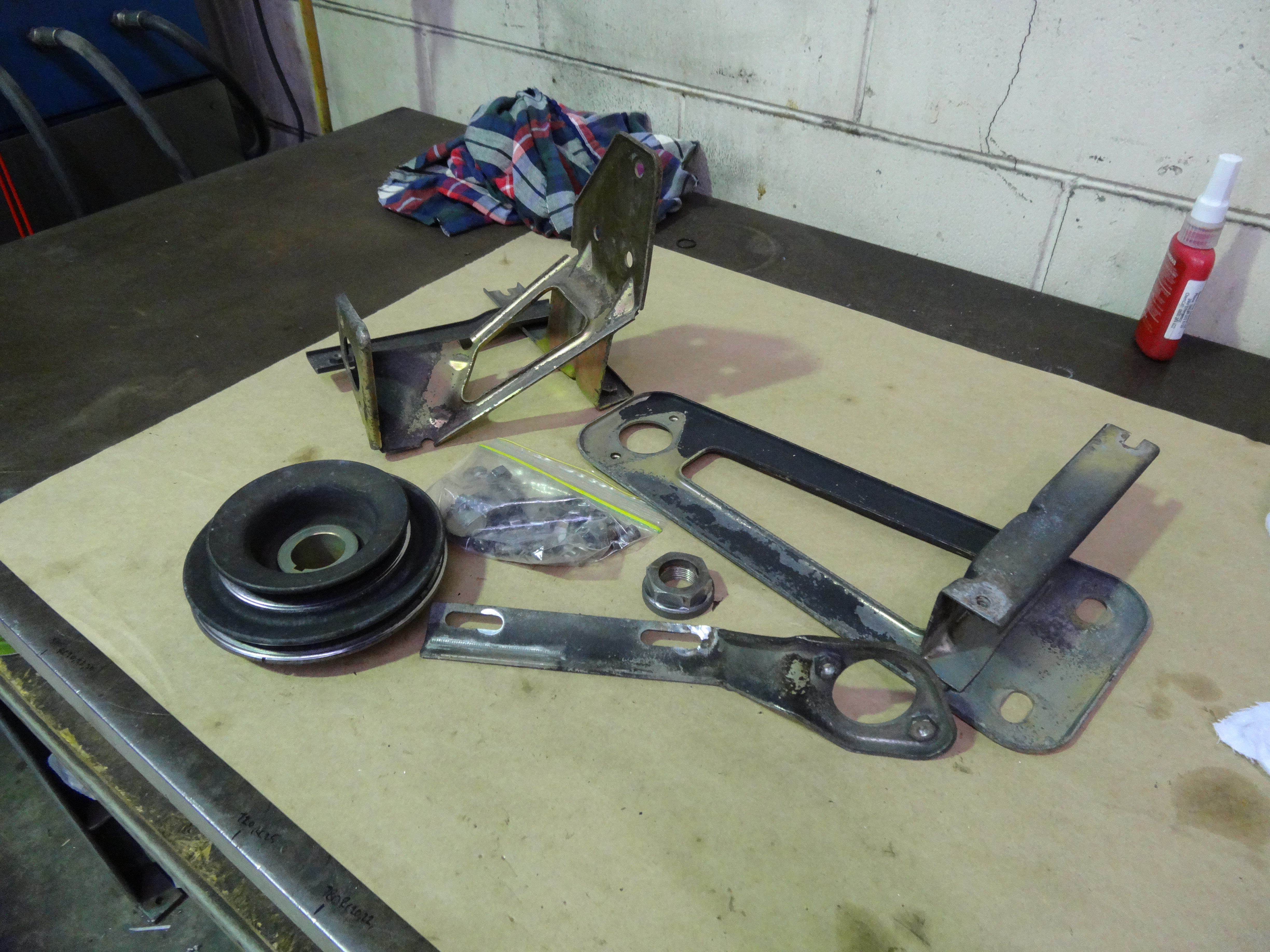

while i had the muffler out i couldn't help myself so had the brackets and pulley replated and replaced the pulley main seal as that was leaking,
the pulley nut is a bastard to get off, 35mm socket and impact gun did the trick after a while
