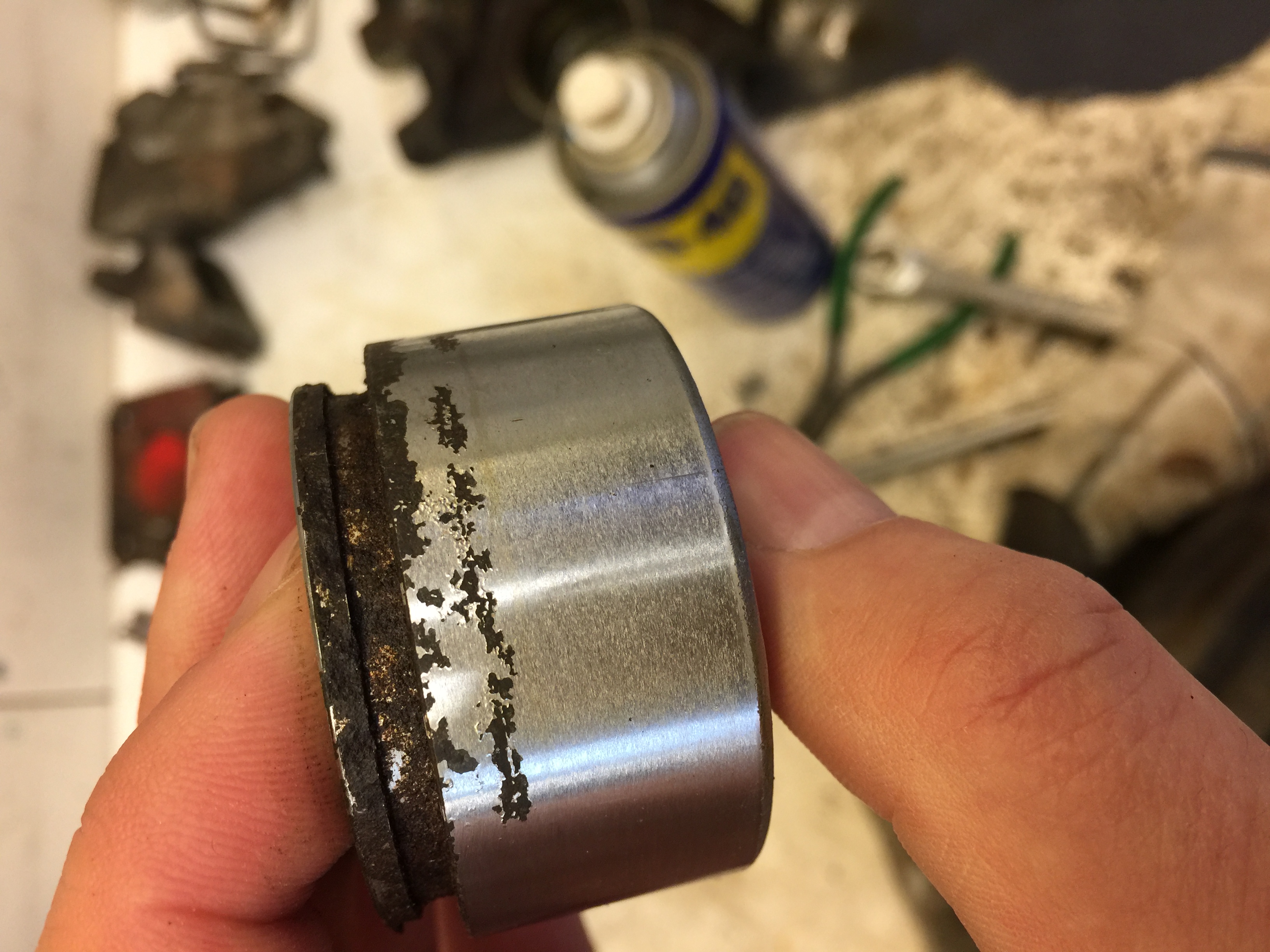

Postby gruffalo » Mon Aug 21, 2017 6:37 pm
I'm gonna let 5063 age with dignity, so I'll reuse whatever I can. Not buy everything new because the original part is old.
This one, however, will be replaced ...
Fail

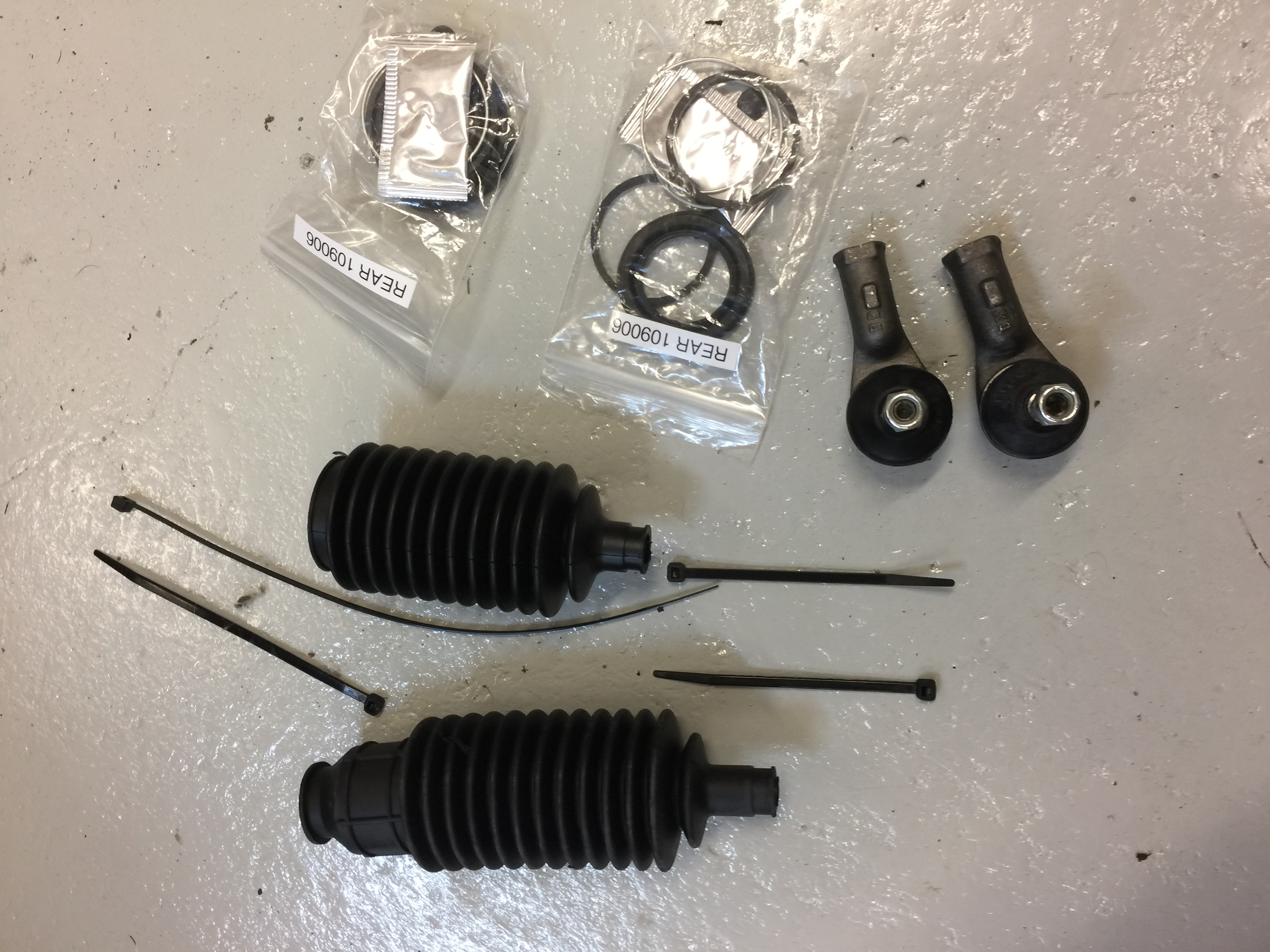

Postby gruffalo » Thu Aug 24, 2017 7:15 pm
Got some new parts in today. That'll keep me busy tonight (and then some... if everything goes as normal)
