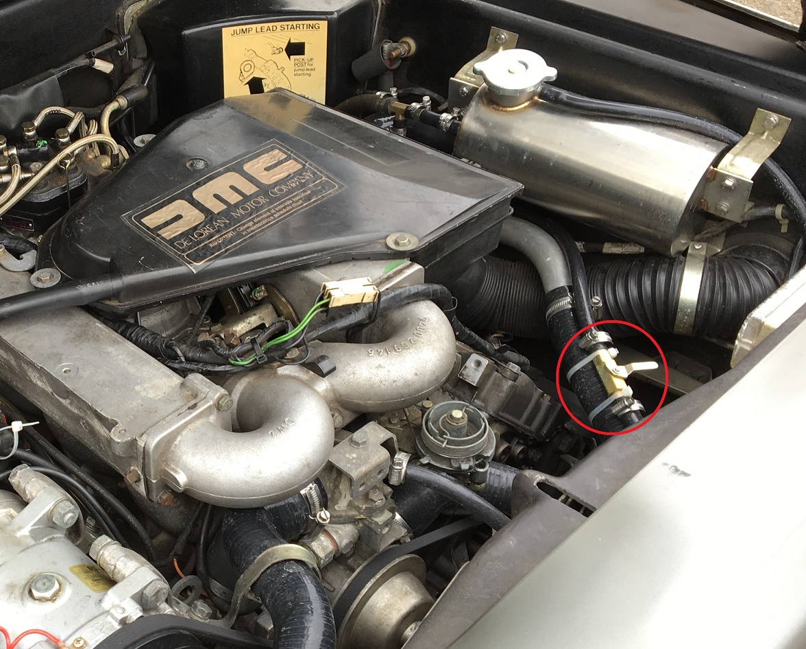

One note re the self bleeder, you may want to consider installing a shut off valve to turn the bleed function off, as it can mask other engine issues if left running indefinitely.
Re: vin 11477 - Finally I am an owner
Postby TristanC » Mon Apr 30, 2018 12:45 pm
Thanks Mike ,
I’ve seen that shut off on a few of these kits. I’ll certainly be adding one in before I finish up.
Thanks for the info.
