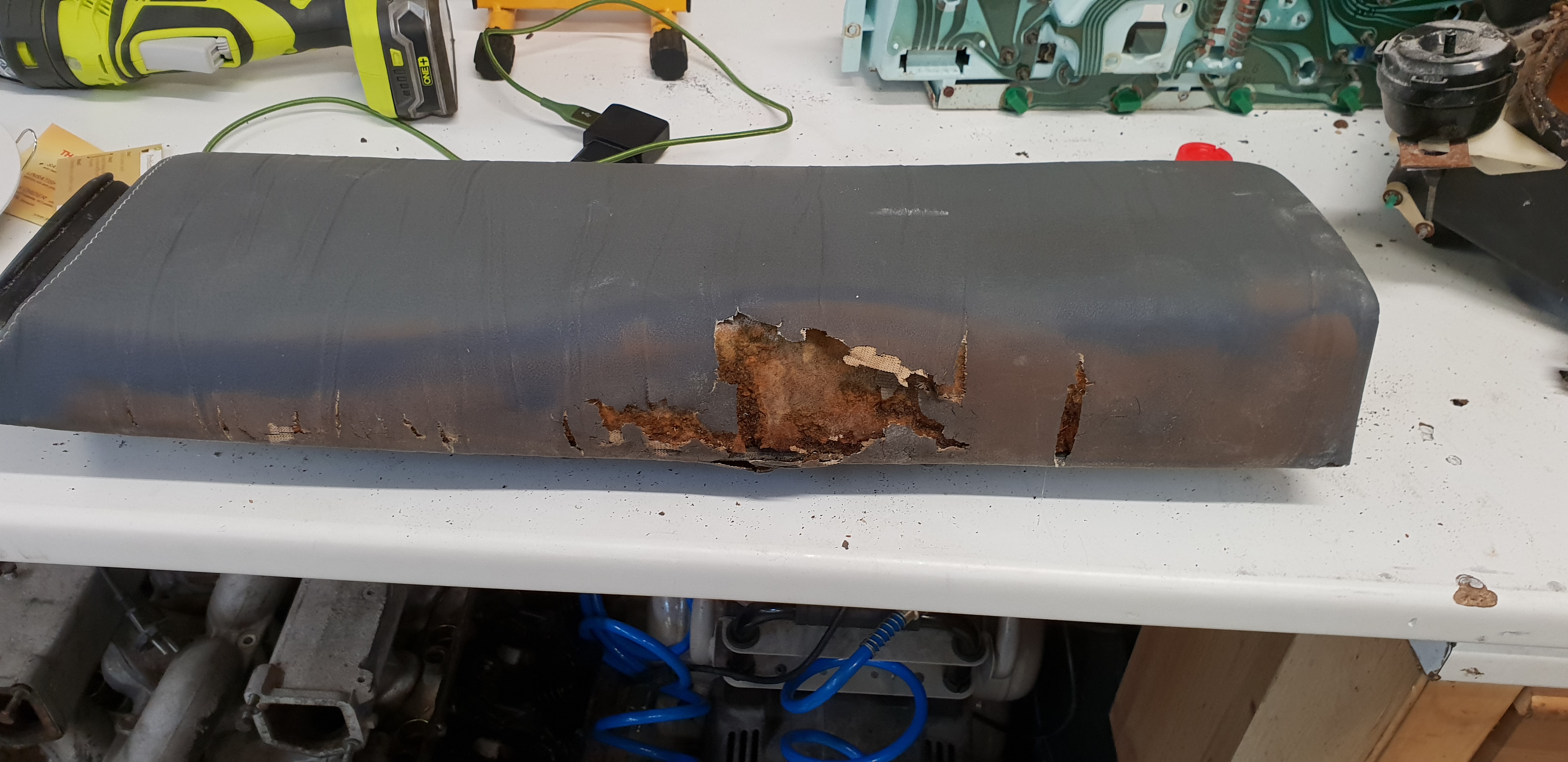

I'm clueless regarding how to fix the knee pad. Is there a replacement vinyl piece that I can get?

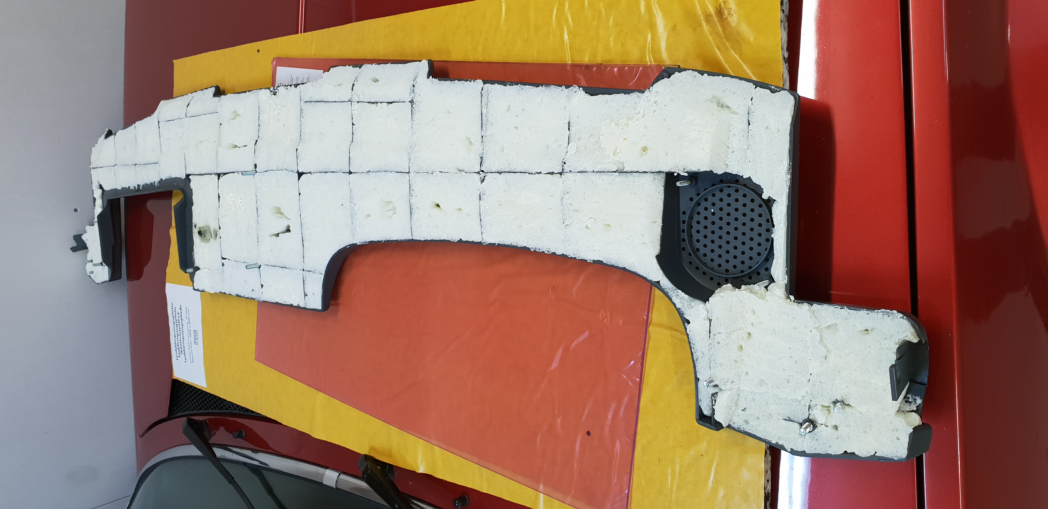

I'm considering adding some dampening rubber and then foam into the square openings on the back side.

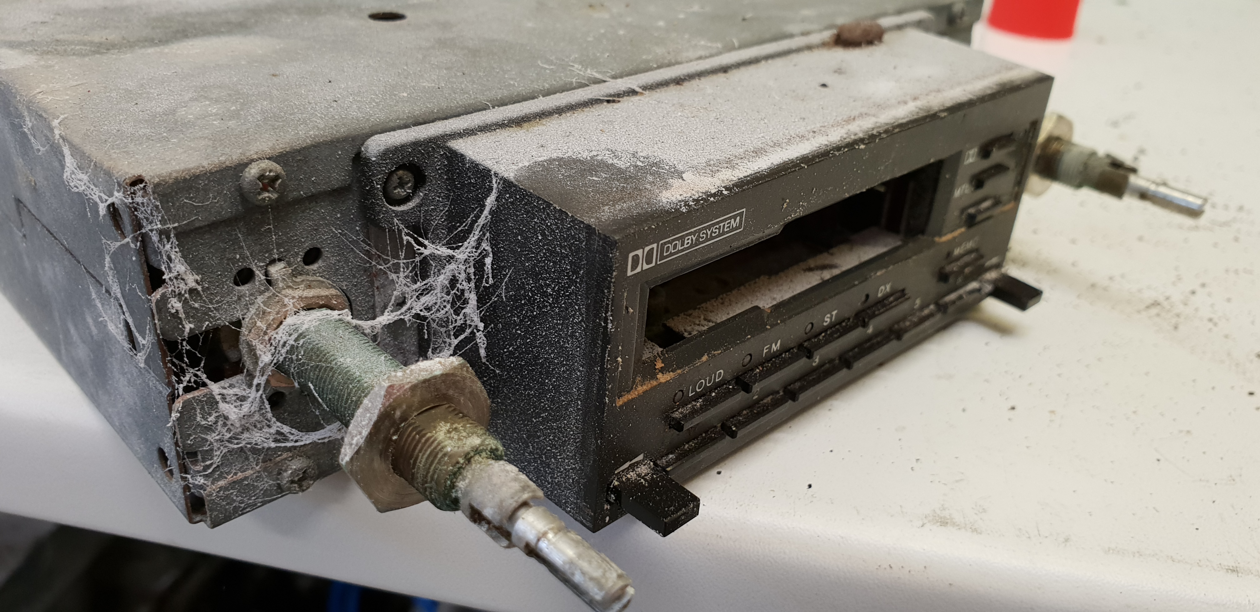

The craig stereo appears to be lost. I'm gonna install a bluetooth amplifier and stream music from my phone.

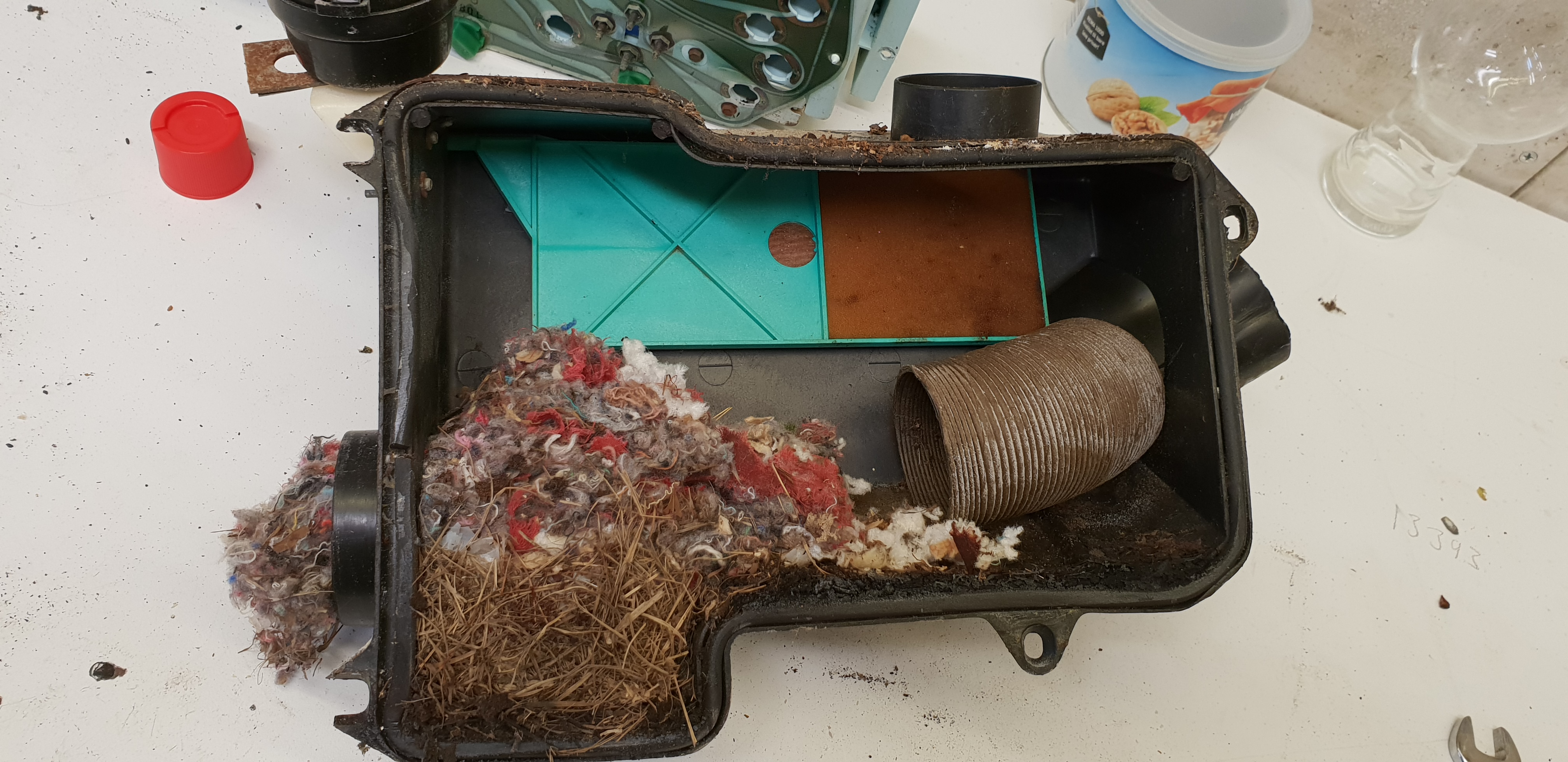

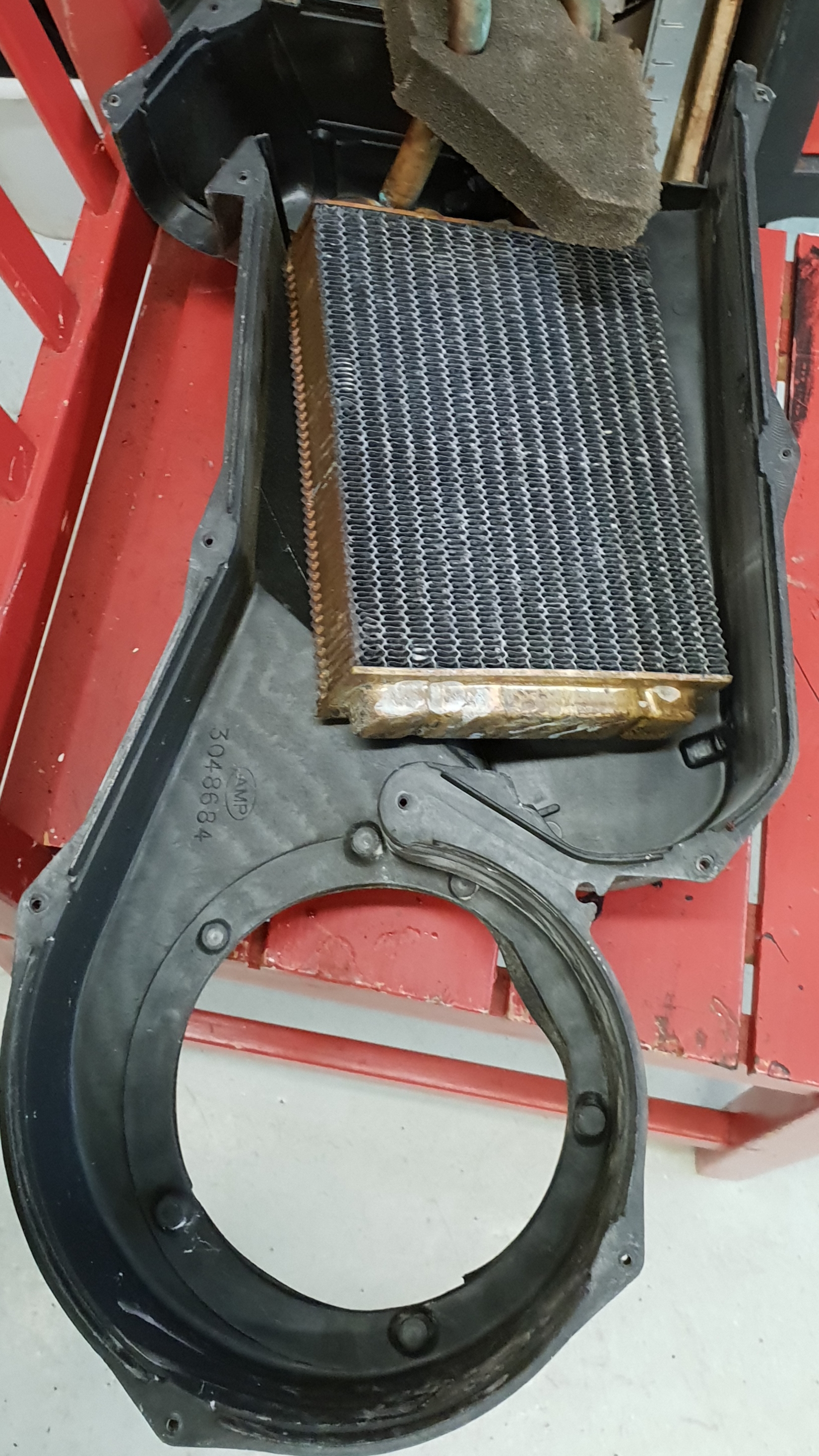

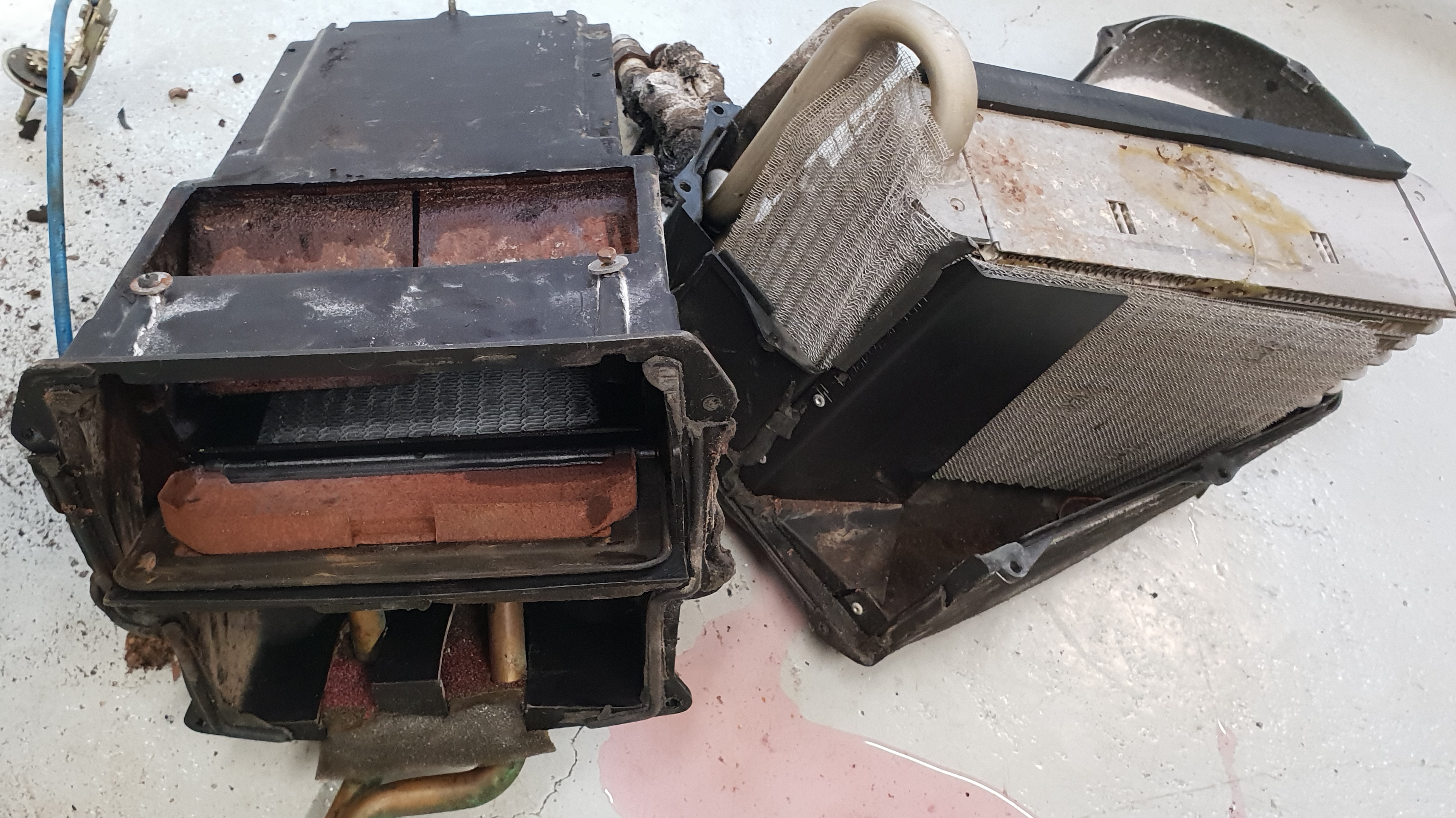

At last the hvac unit is out. Is there a way to disassemble it? Parts are rusty, and hardly anything moves. And I need to make sure no mouse droppings are hidden there.

Postby BABIS » Tue Nov 13, 2018 10:03 pm
gruffalo wrote:At last the hvac unit is out. Is there a way to disassemble it? Parts are rusty, and hardly anything moves. And I need to make sure no mouse droppings are hidden there.
I wrote an "how-to" on the italian forum, I hope that google translate will help you :lol:

Re: Vin 5063
Postby gruffalo » Tue Nov 13, 2018 11:42 pm

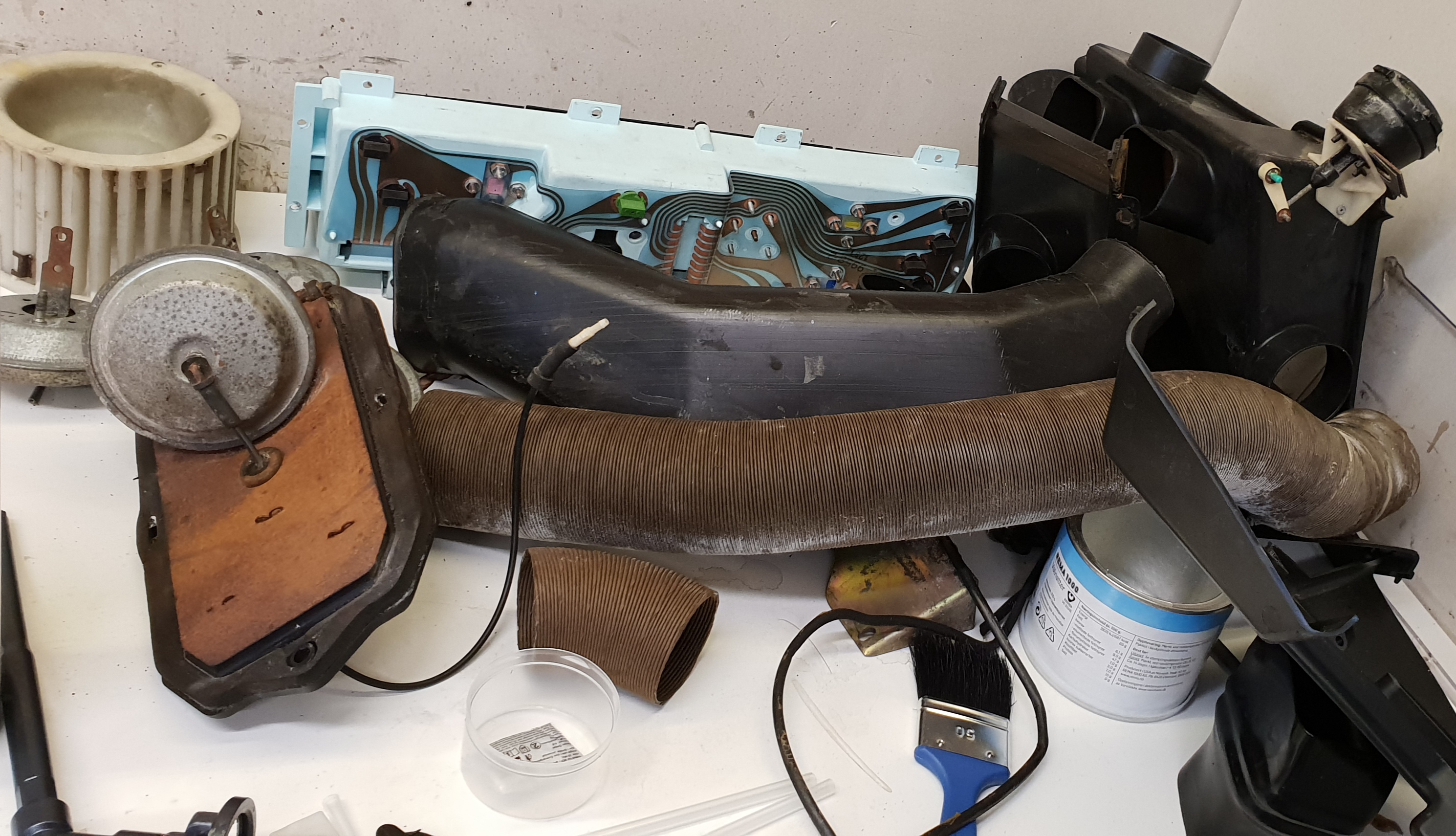

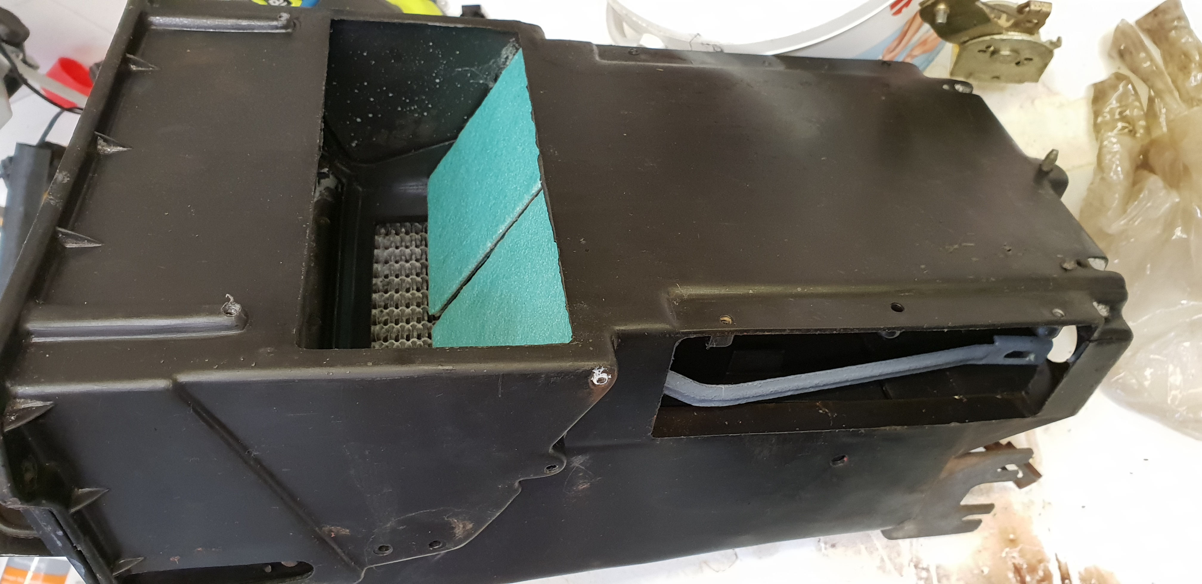

Thanks a million! My Italian is a bit rusty, but the photos speak for themselves. I can tell I'm missing a lot of foam.
I got the hvac unit disassembled and cleaned up. The vacuum units tested all ok. So I'm basically ready for assembly.

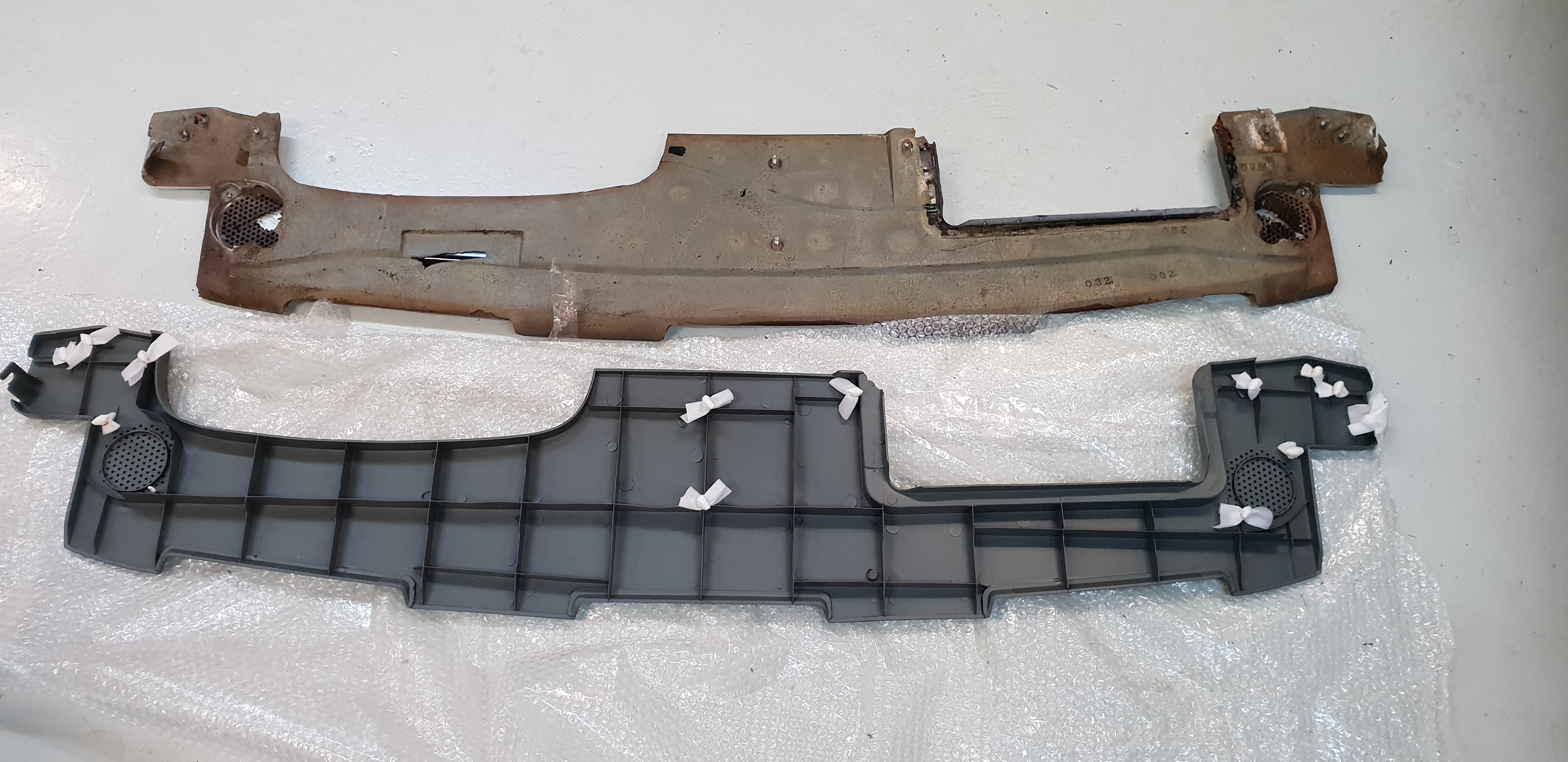

Got some work done on my dashboard upgrade as well. It will be heavier and has a lot more torsional rigidity. I have no idea what it'll do to the final result, but it's my only customization so far.
Core appears to be in great shape
Ready to go back together

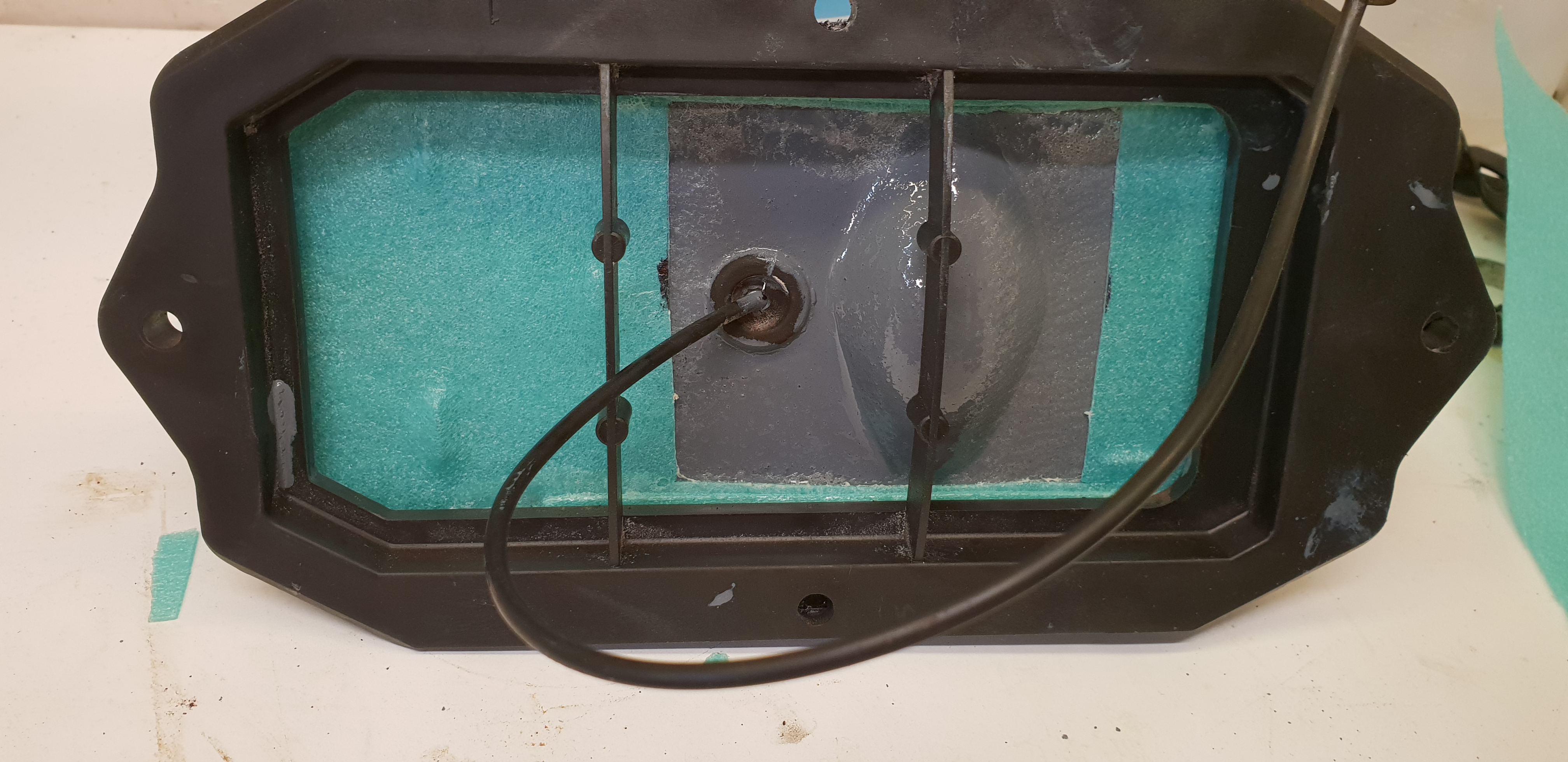

I've cleaned up all the hvac parts, and hit the rusty bits with prep and two coats of por 15. New foam was added too, and I'm now test fitting everything prior to finally assembly.
Some of the details here aren't among my proudest moments, but it'll have to do.
I'm officially on my final stretch of assembly! I also have a lead on how to fix the a-pillars. More to come on that subject.

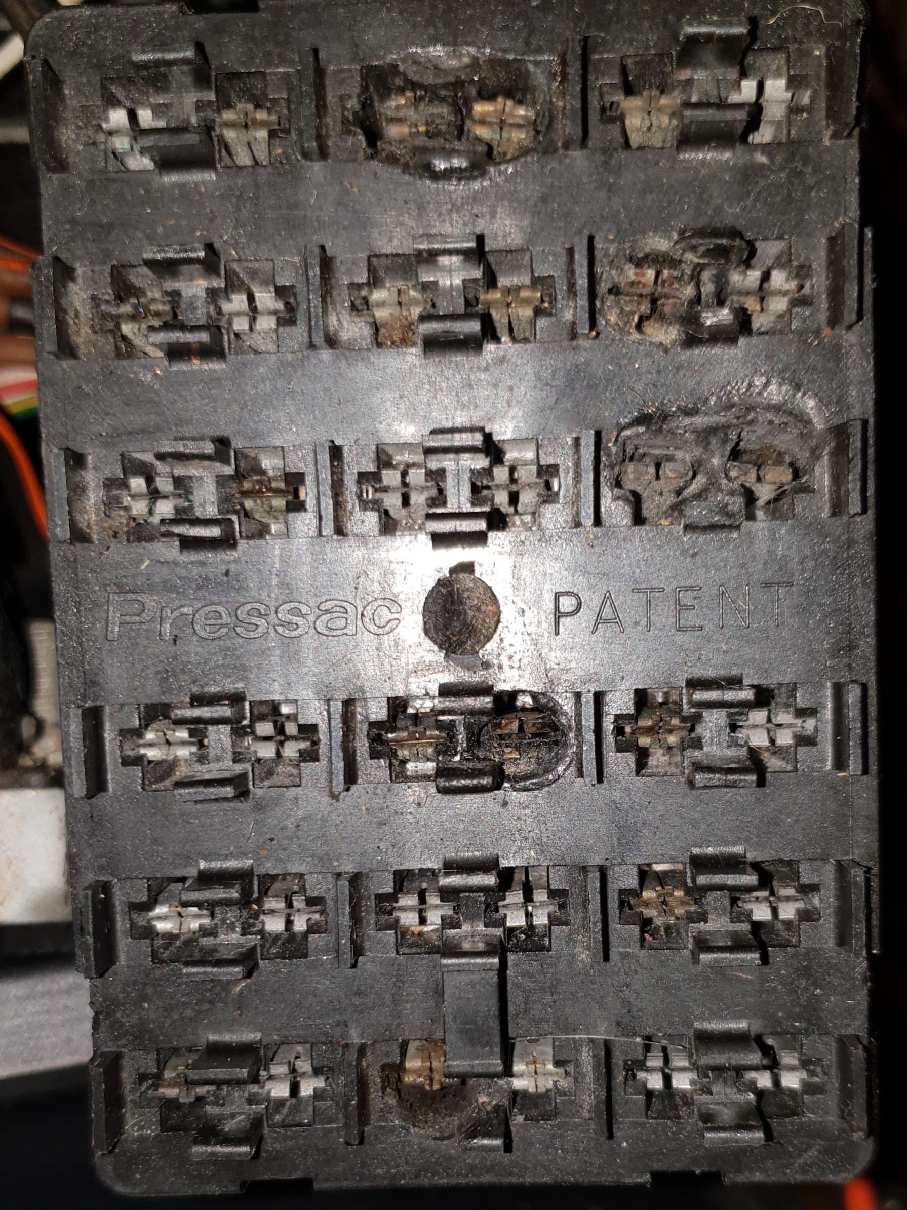

Now I'm building my courage to get on with the fuse box. All terminals except maybe one or two are burnt or corroded. I suspect that the wire cores are corroded too, so I need to treat it with some acidic substance to clear the corrosion off . 36 wires to clean and solder. It's gonna take a while.
No less than 5 fuses had melted the surrounding plastic...

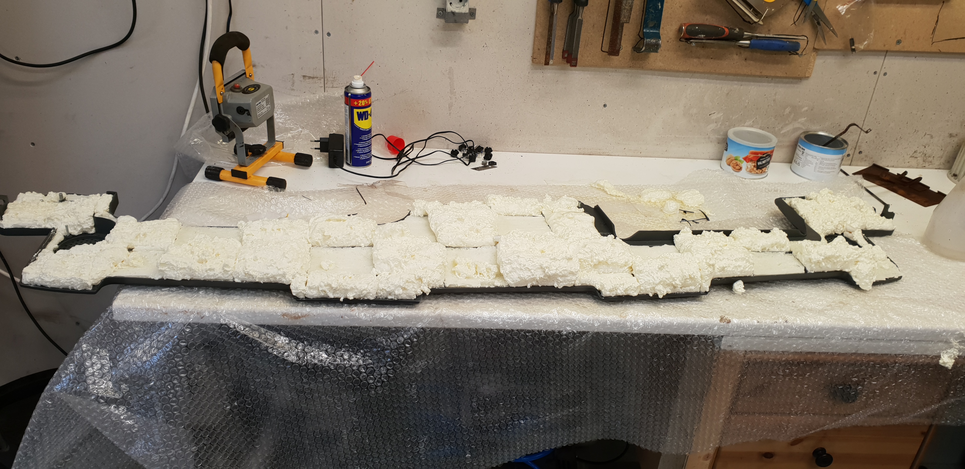

Dash is done, though.
Due for replacement
Dash, filled with sound dampening rubber mat and foam

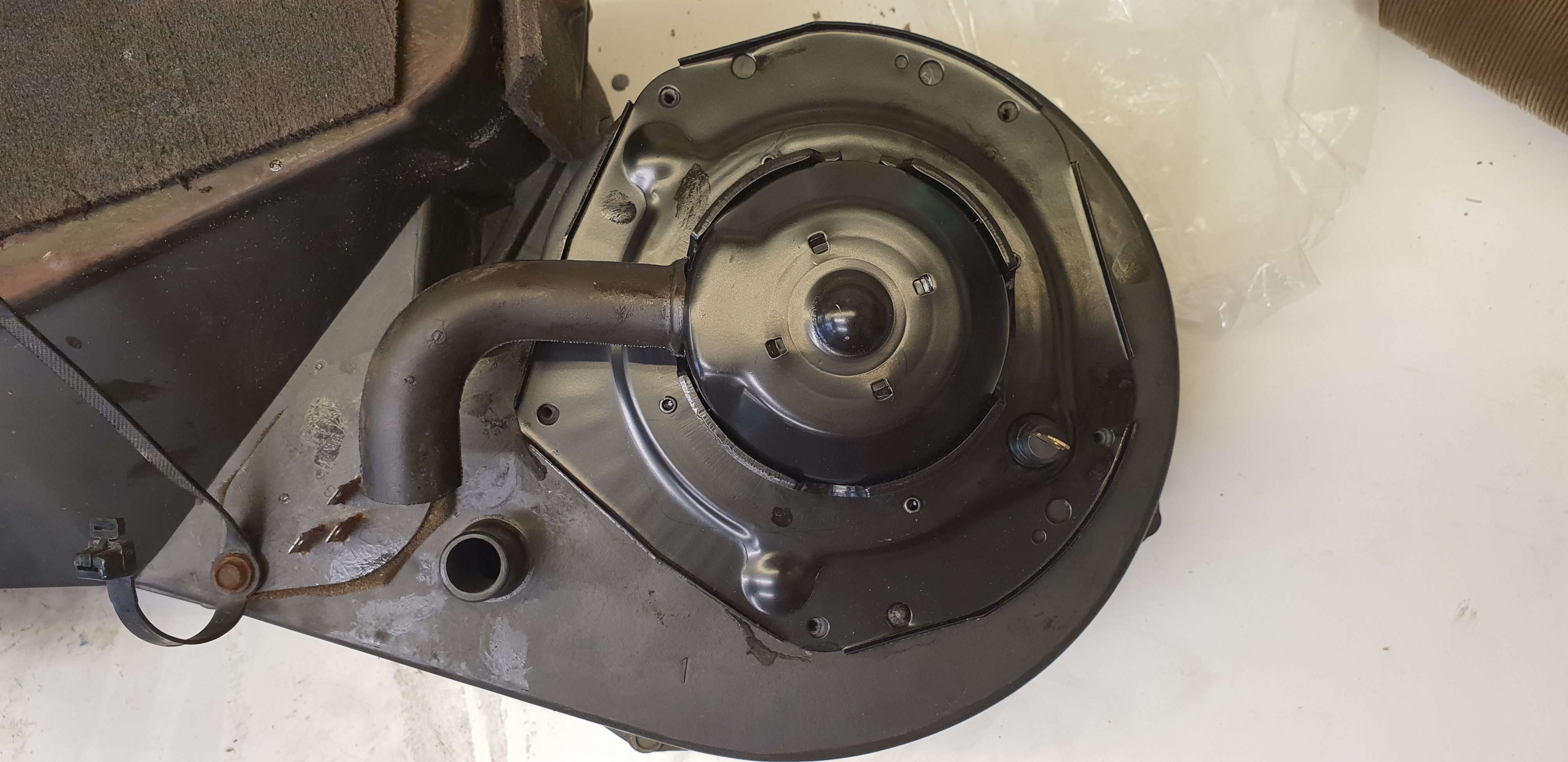

What am I doing wrong here? Isn't that hose supposed to go to the fan motor?
Strange...
gruffalo
Posts: 256
Location: Norway
VIN #: 5063
Re: Vin 5063
Postby arranj » Tue Nov 27, 2018 1:08 am
Not if the fan motor is new.... The fan hole is in a different place. Just leave it off and block the hole. (Or make a longer hose if you want - but there is a danger of getting water in the motor if you do)
Re: Vin 5063
Postby gruffalo » Tue Nov 27, 2018 3:06 pm
Thanks, Arran. That makes sense. And probably explains what killed my old motor :D
