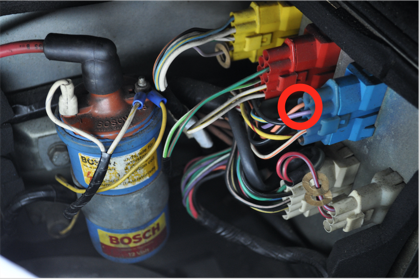

Postby Domi » Wed Aug 23, 2017 7:30 pm
The dwell is connected to earth and to the orange wire here:
Ok, I will try to connect the lambda wire to a negative point and will the result.

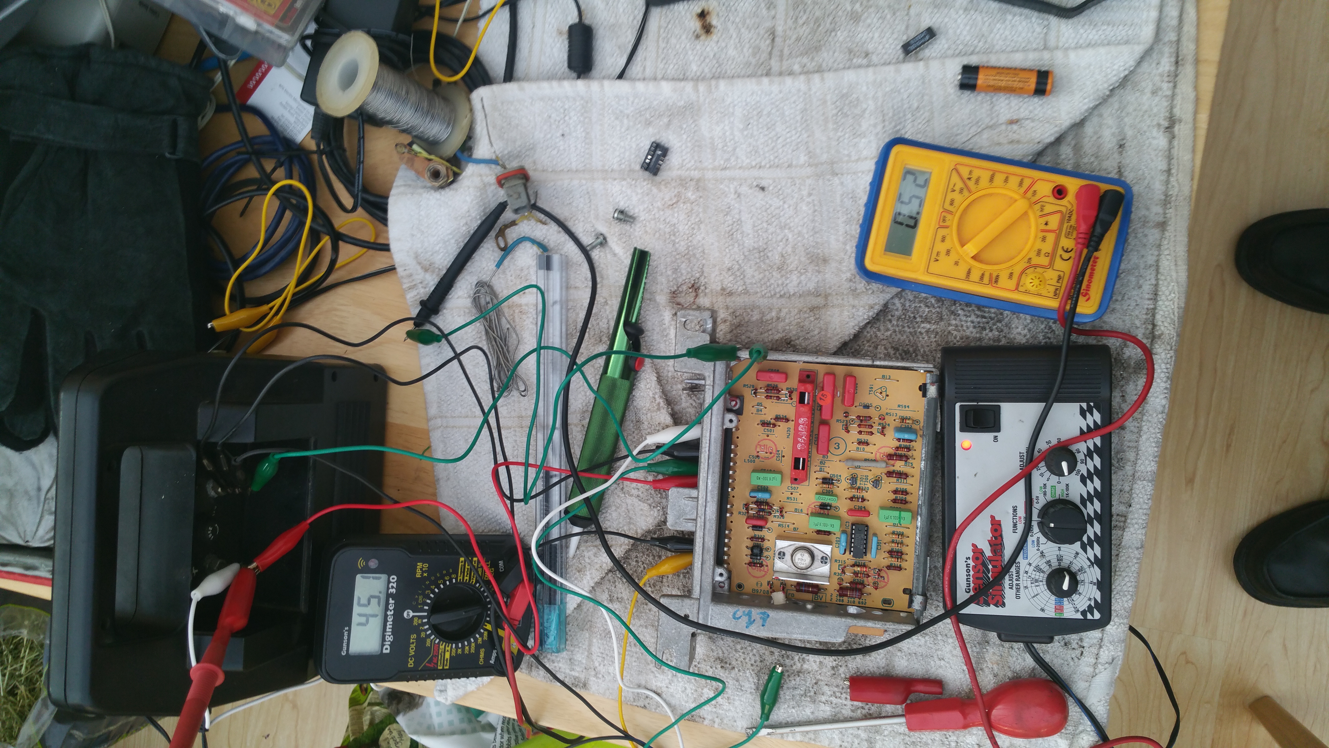

You can do the test workout the engine running by removing the fuel pump relay and then applying 12v to the yellow/red wire (87b) using a wire link to the brown cable (30). This would energise the lambda relay and operate the fuel computer etc. ;)
The fuel computer can be fixed 9 times out of 10 too:
I need to get out more. ...

Otherwise sounds like a bad cpu if it's not oscillating or the full throttle microwswitch doesn't make the dwell go to a steady 54 , Nick sorted mine and it's running better than ever !

Admin-bloke wrote:First try and disconnect the oxygen sensor electrical connection at the blue write to the fuel computer. Take the blue wire that the oxygen sensor should connect to and connect this to a known earthpoint, like the battery negative post. The dwell reading on your metre should read 10-15 degrees.
I have connected the blue wire that should be connect to the Lambda sensor to a negative point, and it doesn't change anything.
