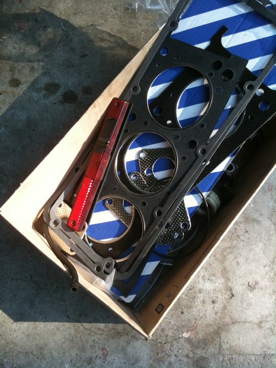

I think I need a holiday :D :D :D :D
I even taped the screws to the marker. :oops:
box of spare parts
Postby Dan 6511 » Mon Apr 18, 2011 11:07 pm
Wooops!! But we all make mistakes like this... :oops:
Postby bozzzydmc » Tue Apr 19, 2011 7:55 am
Lol Rob .. So it was you that stole it ! :)
Can you remember why you took it off ?
Postby RobvdVeer » Tue Apr 19, 2011 9:37 am
bozzzy wrote:Lol Rob .. So it was you that stole it ! :)
Back in November or something, I was working on the door strut brackets. I had to loosen the rear quarter panels. First thing I did was remove the louvre and the right side marker. The quarter panel never came off as there was sufficient room to put the new bracket in. So the marker was off the car for at least 5 months.. :oops:
Postby bozzzydmc » Tue Apr 19, 2011 4:34 pm
Lol !
Well at least you haven't bought a new one eh :)
Mike
Postby RobvdVeer » Tue Apr 19, 2011 6:21 pm
bozzzy wrote:Lol !
Mike
I hope i didnt....
