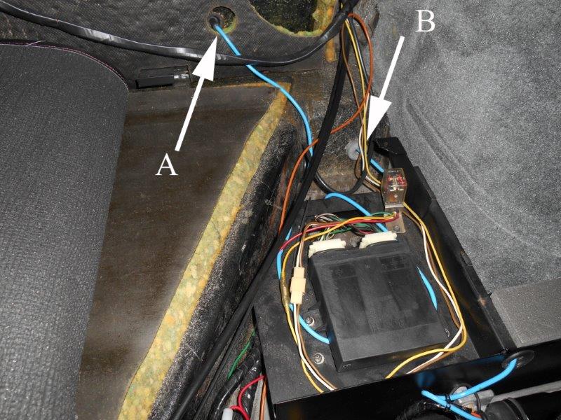

Postby Domi » Sun Sep 03, 2017 5:08 pm
Here is a picture:
I have two blue wire A & B
A = It goes to the unit under the ECU from the engine compartment.
B = It goes to the computer inside the small luggage compartment from the Lambda sensor which I use to connect to earth.
Posts: 1004
Postby Admin-bloke » Sun Sep 03, 2017 5:12 pm
Use B, the one that goes to the fuel ecu
Postby Domi » Sun Sep 03, 2017 5:17 pm
Ok, so that's the one I use to connect it to earth in my video.
Same earth that my Dwell plug. (brown wire)
