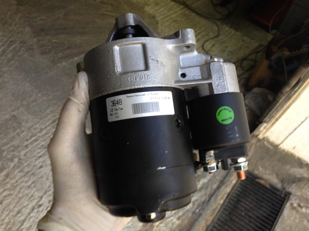

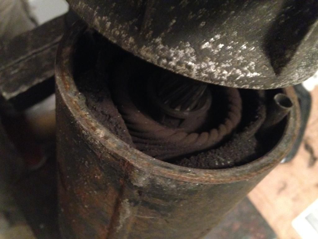

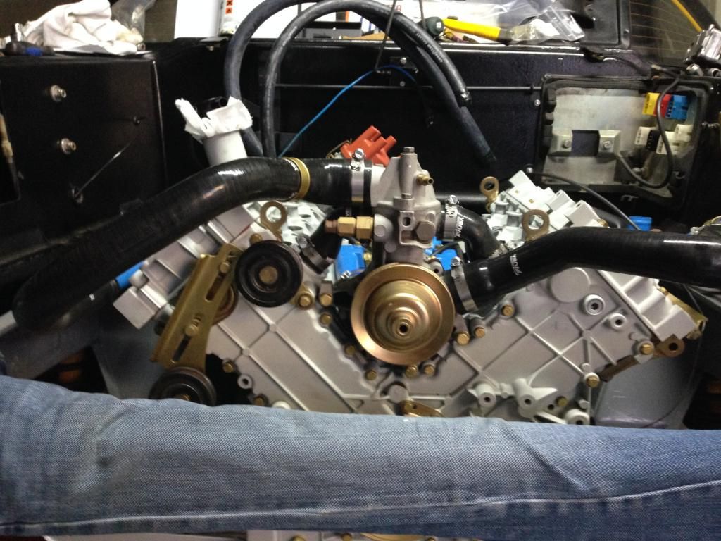

Tried to fix the stater.... But no chance! :(
Found a lighter smaller and more powerful replacement.

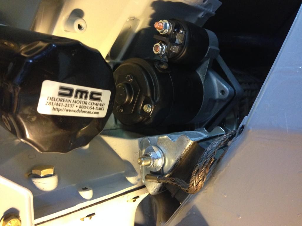

Did some scouting! Found out that the delorean stater is the same used on the more recent RENAULT 91-96 espace and safrane. valeo type d9 e 200
Perfect fit! Added oil fllter and oil pressure module.
On to....

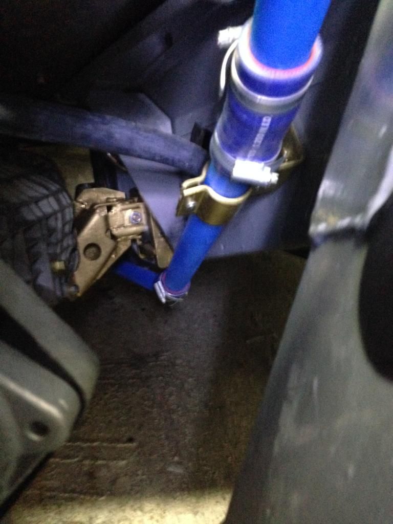

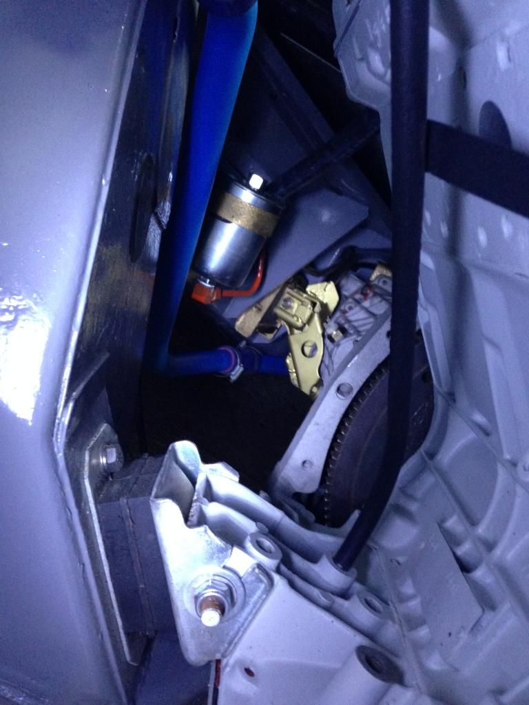

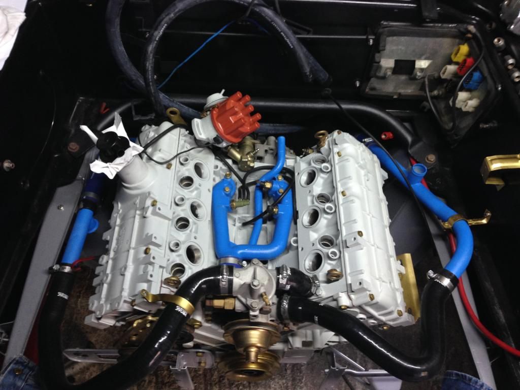

Laid out my blue piping..
RH
LH
Installed the water pump with all around silicone piping

Postby jamesrguk » Mon Aug 18, 2014 11:13 pm
What did you paint your engine with? I have my engine out of the car, steam cleaning it next week and was thinking about smartening it up before it goes back in.
