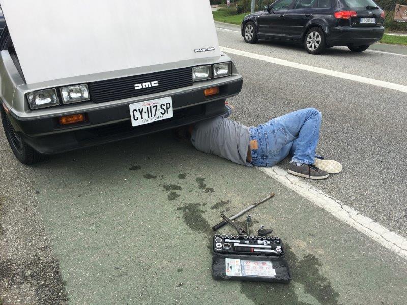

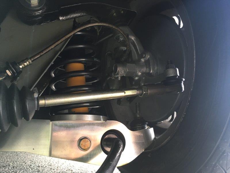

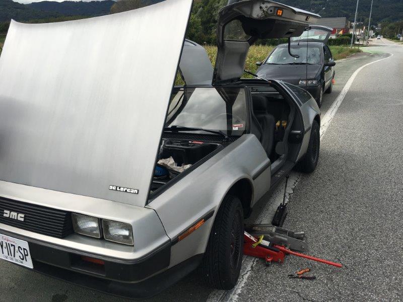

Postby Domi » Sun Sep 10, 2017 4:40 pm
Decided to go for a ride to see how my idle goes, was fine all the week without moving.
Unfortunately, after a few minutes driving something else happened...

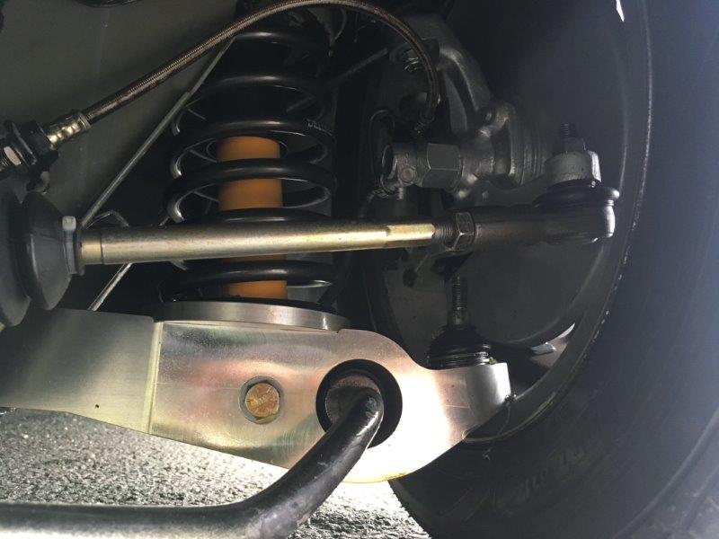

I hear a loud noise on the front and was almost unable to move the steering wheels.
Finally I pull over on the road to see any damage.

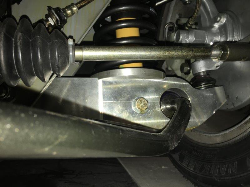

I lost a nut on my lower arms which were brand new from Midwest.
Unfortunately, the nut isn't drilled and is just a lock-nut which moved away.
I checked the other side and is almost unscrew too, amazing!
So, like I wasn't too far away from home, my wife brought me some tool to repair the car.
I think it damage the steering rack (which was brand new from Ed) like I was unable to turn the steering wheels properly.
Anyway, needless to say I'm a little bit disappointed. I spent two years working on the car and now I'm a little bit tired.
Here are a few pictures...
