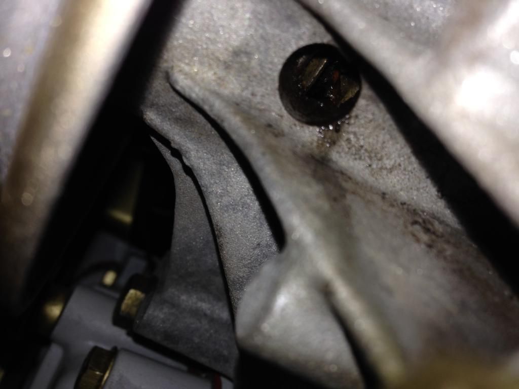

Filled up my system with coolant.... And there was some dripping going on right behind the water pump pulley coming from that whole........
Does this mean I refurbished the pump for nothing??? :(
Or is it common at the fill up to have some drops until it settles?

Postby ALEXAKOS » Mon Aug 25, 2014 10:04 am
one step forward...two steps back...:(
After having the timing cover removed to correct the timing sequence..... I Filled her up with antifreeze and there it was... My worries that it would drip.
The dripping came from the classic leak whole behind the pulley right under side.
The whole pump refurbishment was for nothing,.
PLUS I had to re drain the coolant, remove the Kjet and the intake manifold.
Back to square two!

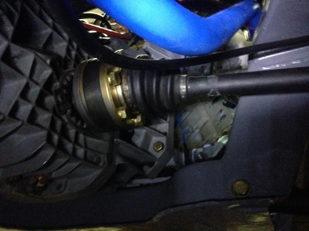

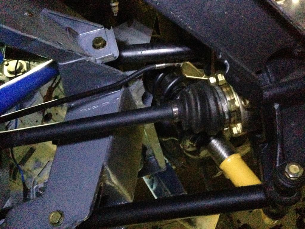

waiting for my water pump to arrive, I installed the drive axles.
Remember how I had fully refurbished them with fresh grease, sandblasted and powder coated the shaft and put it all together?
This was them puppies back when I took em off
Now...

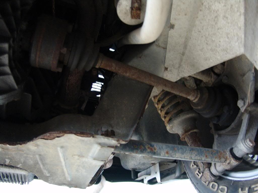

This is what the place down there looked like before I even bought it...

Postby A Van » Tue Sep 02, 2014 6:23 pm
Well done for tracking down the family, I know Barrie Willa was trying to contact him.
Nice work on the axles
