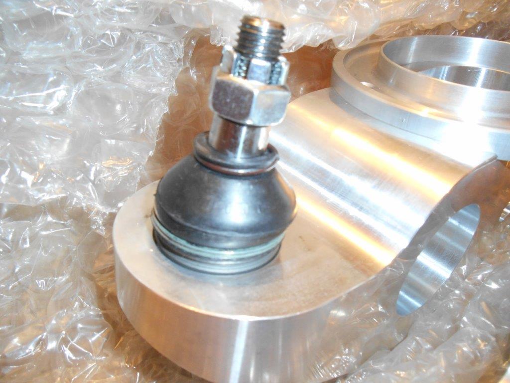

Nevertheless, when I take a look at these old pic here:
viewtopic.php?f=41&t=84&p=71221#p71221
Seems there is no marking on rubber?

Postby arranj » Mon Sep 11, 2017 7:26 pm
There is always something :) - it might be printed on. You will need a very bright light to see it though... it won't be easy when it's on the car.

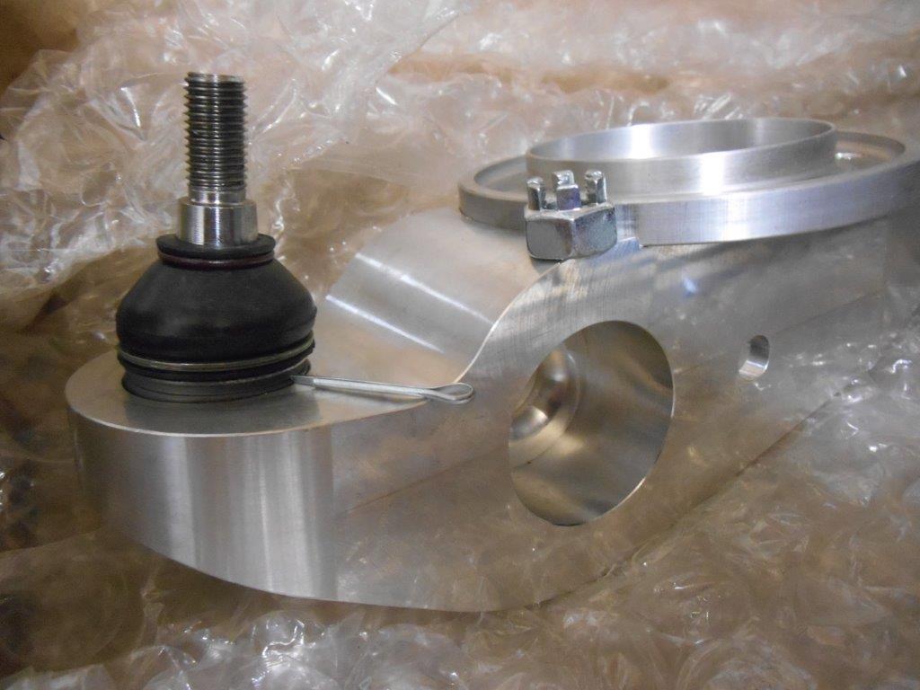

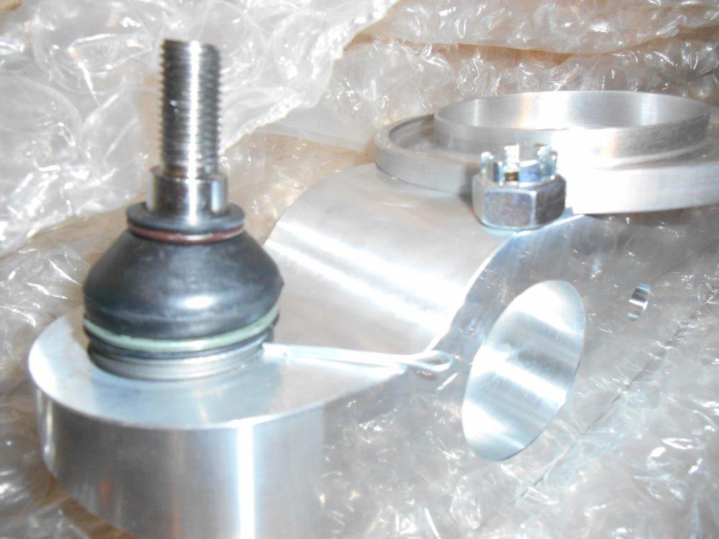

Postby Domi » Mon Sep 11, 2017 7:30 pm
No need to wait, I have some pic before it was on the car:
I'm sorry but I can't see anything?

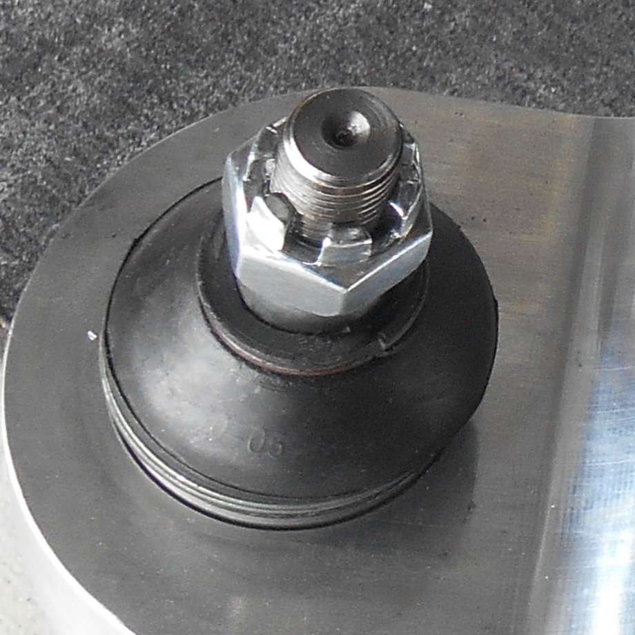

Postby Domi » Mon Sep 11, 2017 7:35 pm
Wait, maybe here when you zoom:
Sans titre-1.jpg (482.45 KiB) Viewed 3558 times
Because of the flash we can't see it properly.
I will take better pic soon

Postby arranj » Mon Sep 11, 2017 8:10 pm
OK - well it certainly isn't from the UK, and isn't one of the DMCH old ones, that's for sure. What would be interesting to see is how much thread is above the nut, if there is some way of seeing that on the other one when it is still installed? We can try to work out from that if the nut it bottoming out on the threads perhaps.

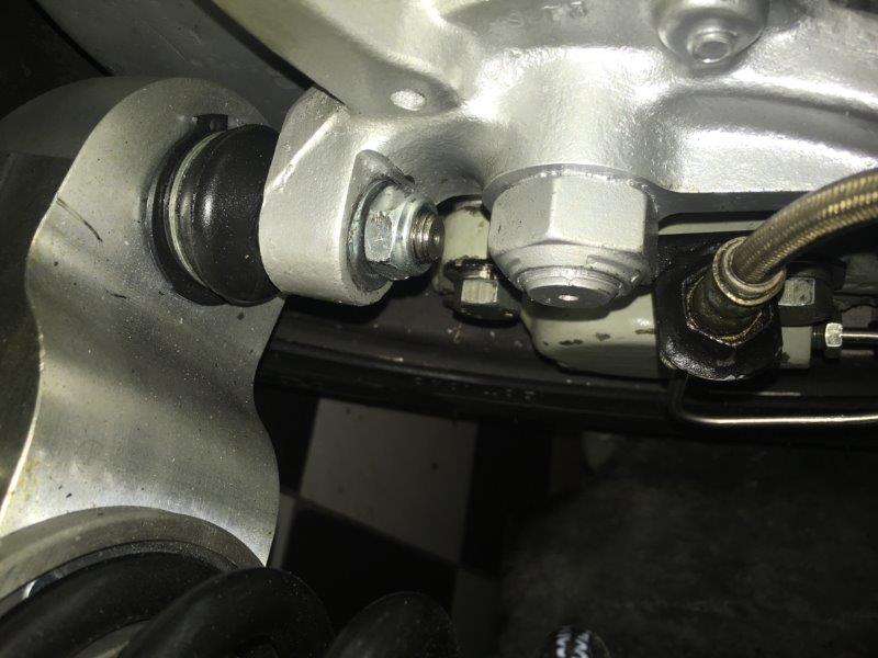

Postby Domi » Mon Sep 11, 2017 8:20 pm
I'll take a pic on the other side.
No I didn't undo the the Nylock, just put it once and leave it.

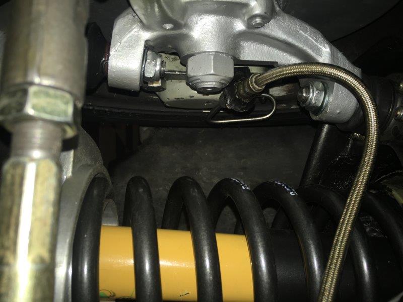

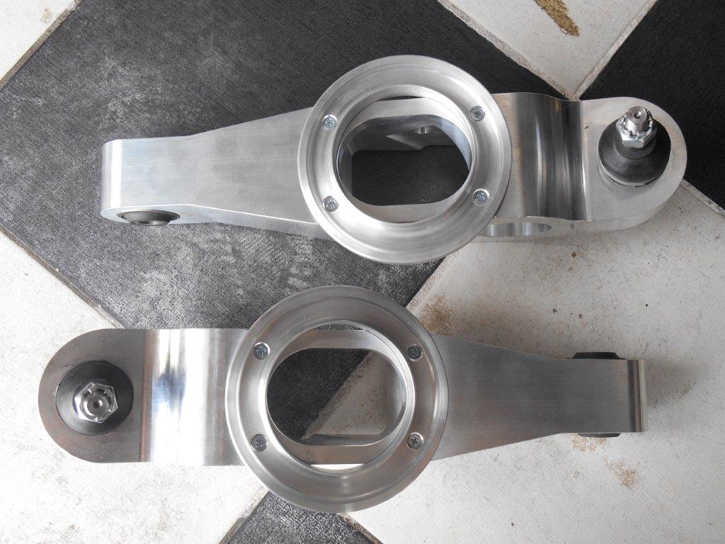

Postby Domi » Mon Sep 11, 2017 8:28 pm
Here they are
Posts: 1004
Postby arranj » Mon Sep 11, 2017 8:50 pm
Why the washer? What size was it? Is it stainless? There is a chance you could have fouled the taper, or if it's stainless it could have shattered...?
There shouldn't be a washer there.
Also that doesn't look like it is tightened up.. not enough thread showing.
Postby Domi » Mon Sep 11, 2017 8:52 pm
Yes stainless washer, I thought it was good, looks like I made a mistake, when I see its shape now :(
Posts: 1004
