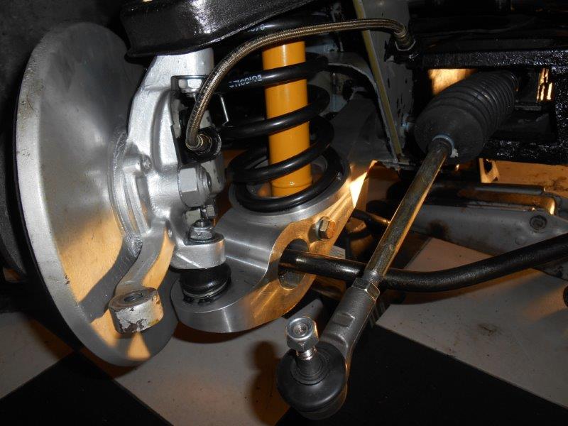

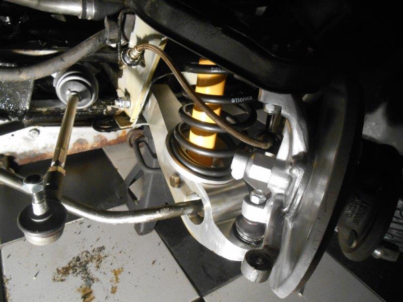

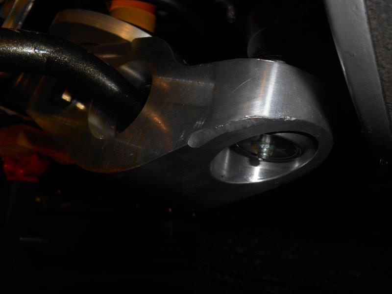

Postby Domi » Tue Sep 12, 2017 7:56 pm
Get ready for another hours of fun under the car :roll:
Fortunately, the damage on the lower arm are minor
Posts: 1004
