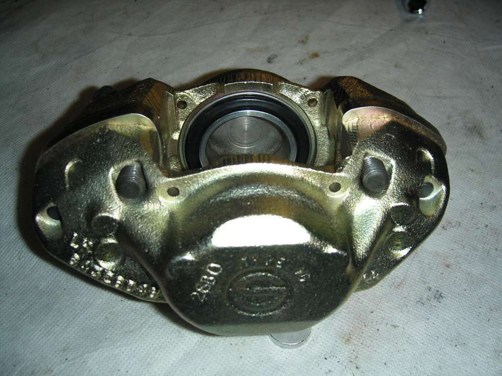

got as far as i can with the calipers just now. Inserted new stainless caliper pistons with new seals obviously:
steering column is going in next.

Postby dmc4087 » Fri May 07, 2010 2:08 pm
Those calipers look the business mate, well done

Postby InoX » Fri May 07, 2010 2:18 pm
cheers mate. I think i might live to regret painting them what with likely contact with brake fluid, etc.

Postby Admin-bloke » Fri May 07, 2010 4:54 pm
They look fantastic !

Re: Project 3193
Postby bozzzydmc » Fri May 07, 2010 11:17 pm
Blimey Dave they look great !!
Who plated them for you ??

Postby Chriss » Sat May 08, 2010 10:55 am
I did the same with 16327 all 4 calipers including handbrake, Had them re plated then new stainless pistons from Hervey and seal kits :)

Postby InoX » Sat May 08, 2010 11:14 am
aye
you've got a spacer in there, too - are you running vented discs?

Postby Chriss » Sat May 08, 2010 11:16 am
yep, 16327 is running vented discs at the front :D
