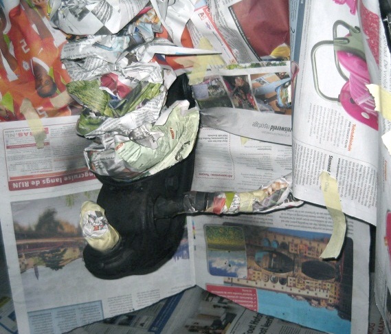

Postby RobvdVeer » Wed Sep 16, 2009 5:36 pm
Paint is almost dry and ready for inspection! Sorry about the poor quality of the pictures. I had to use a flash. In real life it looks much better. I'll put up some new pictures in daylight tomorrow to show the result.

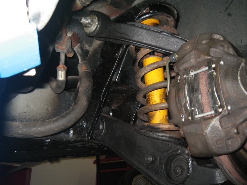

Postby RobvdVeer » Fri Sep 18, 2009 4:35 pm
Just popped in to say that the front suspension is reassembled. No pictures, no details.
The only problem I had was the the upper balljoint kept spinning while fastening the castle nut. Greased the nut, and put some friction on the hub; that finally did the trick.
I put the wheels back on and remove the jackstands. The car is finally back on all fours!

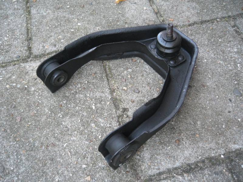

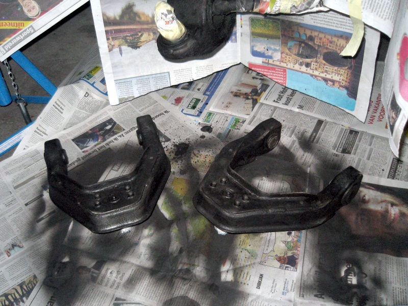

Postby RobvdVeer » Fri Sep 18, 2009 7:09 pm
Some pictures
Painted upper wishbone
DeLorean APK 037.JPG (261.29 KiB) Viewed 6017 times
Final result
DeLorean APK 030.JPG (162.12 KiB) Viewed 6017 times

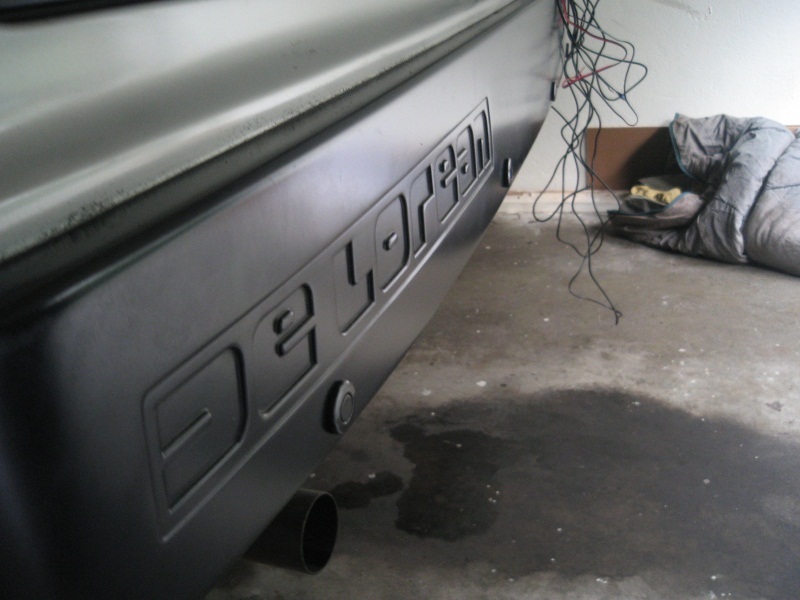

Postby RobvdVeer » Fri Sep 18, 2009 7:12 pm
And the rear facia can be removed within an hour, although the workshop manual says nothing about disconnecting any wiring! PS you can really see one of the mufflers very well now
DeLorean APK 044.JPG (123.52 KiB) Viewed 6017 times
Also note that the bumper is very soft..
DeLorean APK 046.JPG (173.07 KiB) Viewed 6017 times

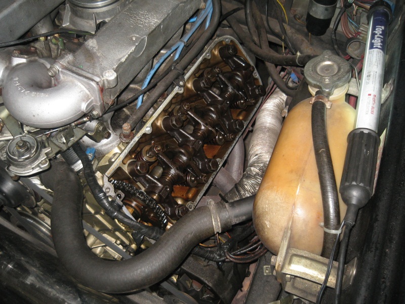

Postby RobvdVeer » Sat Sep 19, 2009 5:02 pm

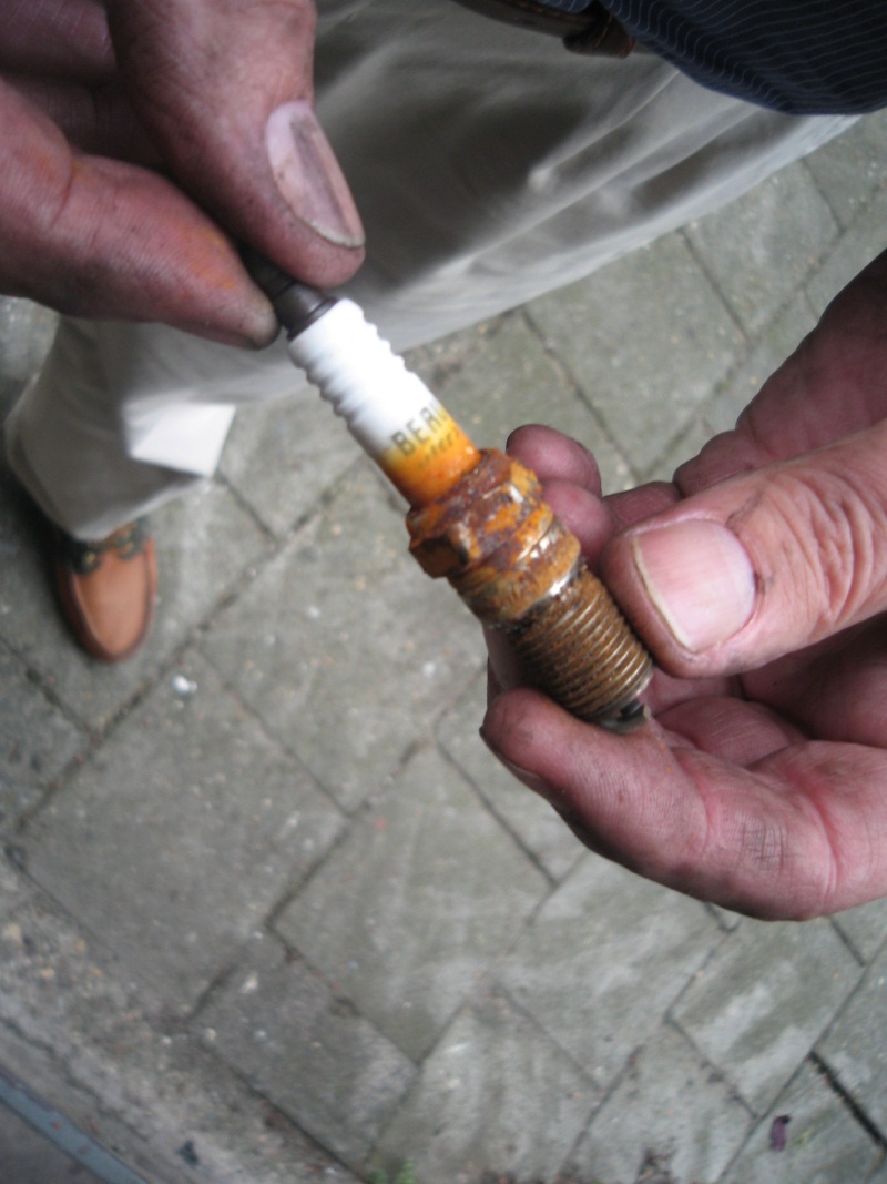

Another day of hard labour completed.
- Replaced right side valve cover gasket
- Inspected and cleaned all the spark plugs. Found out that one of the spark leads was not sitting properly in the socket
- Cleaned a good bit of the engine in the hope that the oil leak in the valve cover is fixed now.
- Cleaned/inspected engine bay wiring
- Touched up minor paint damage on the engine cover
- Installed backup warning system in rear facia (yes I drilled holes - forgot to take pictures of the holes unfortunately)
- Reattached rear facia
Tomorrow I plan to finish the wiring and screw the lights back in.

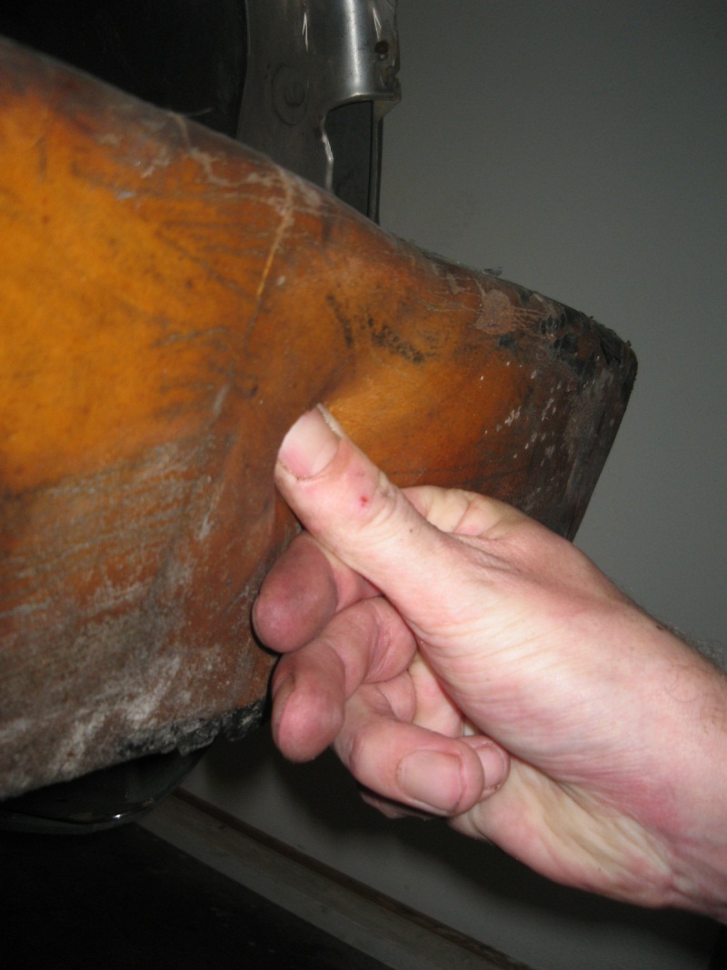

DeLorean Kleppendeksel 002.jpg (209.77 KiB) Viewed 6011 times
DeLorean Kleppendeksel 012.jpg (187.23 KiB) Viewed 6011 times

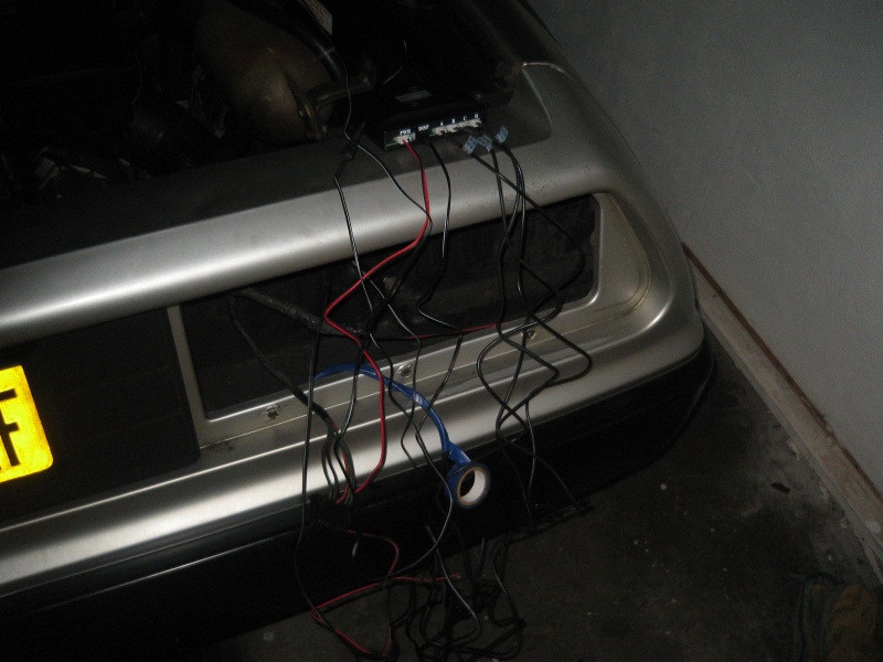

Postby RobvdVeer » Sat Sep 19, 2009 5:57 pm
Wires are still a mess:
DeLorean park assist 001.JPG (121.28 KiB) Viewed 6009 times
Closeup of the park sensors
DeLorean park assist 007.JPG (118.82 KiB) Viewed 6009 times
