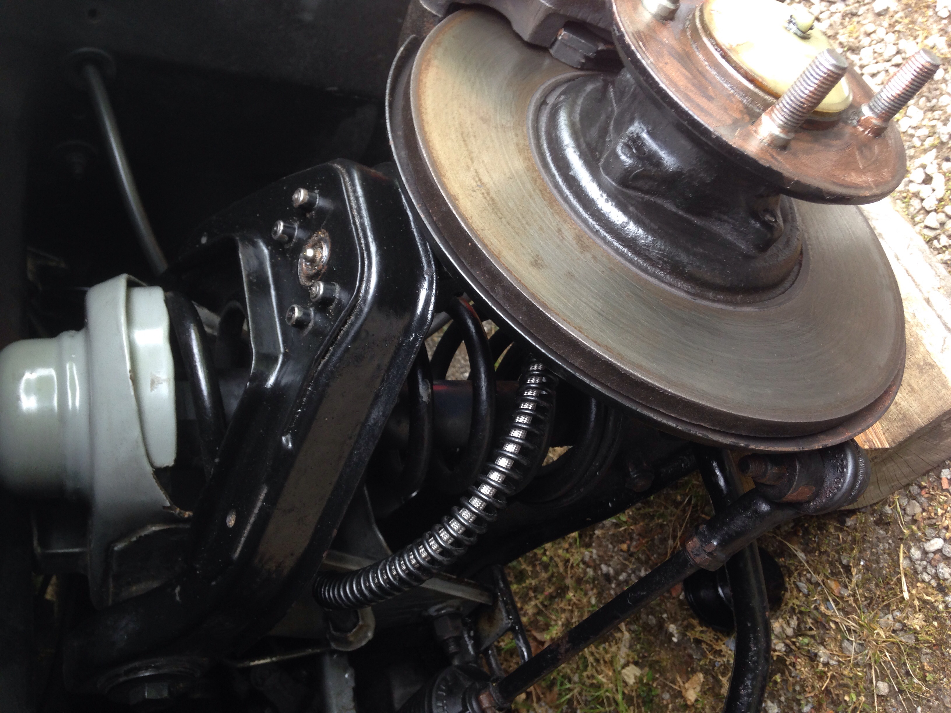

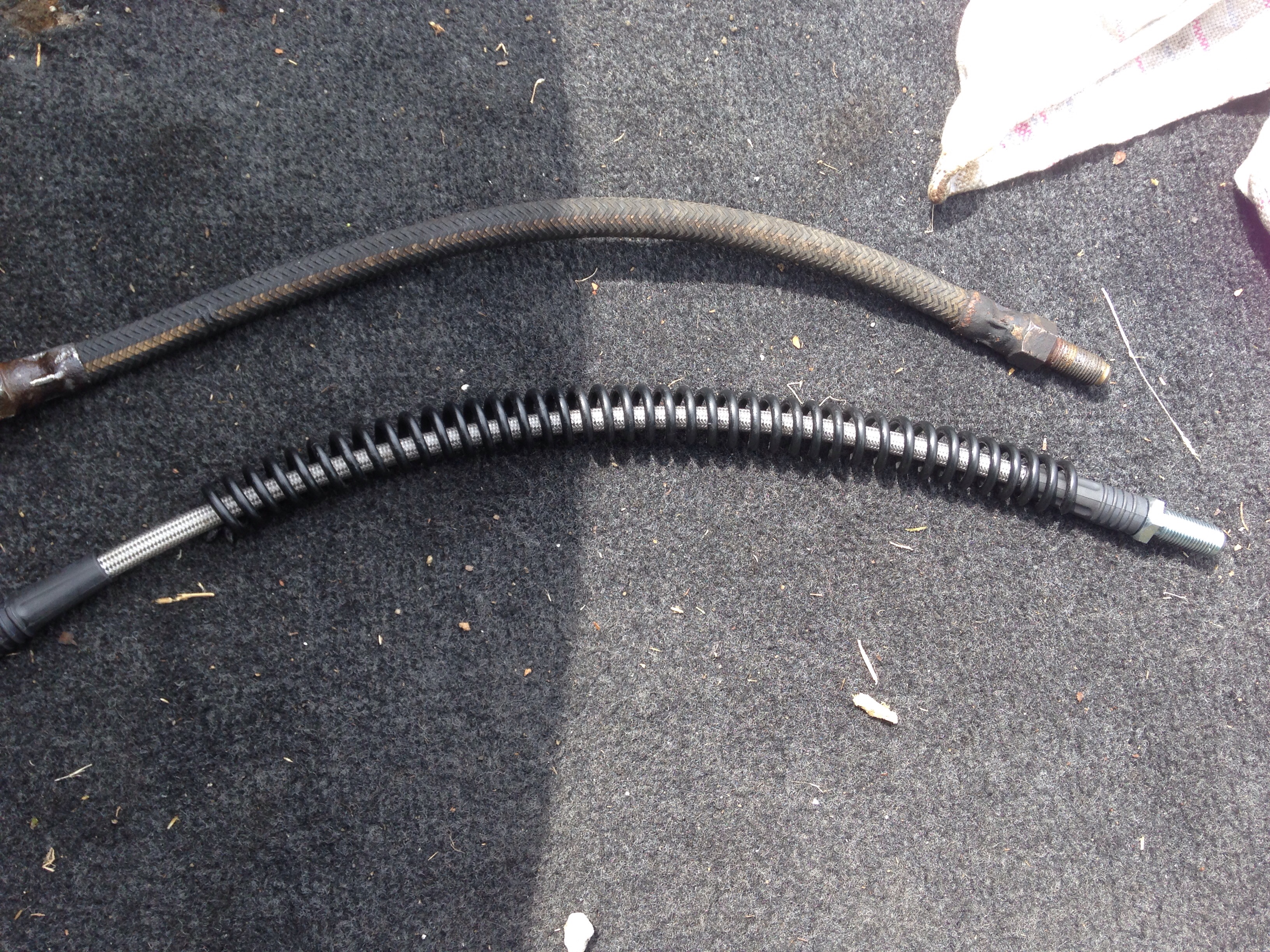

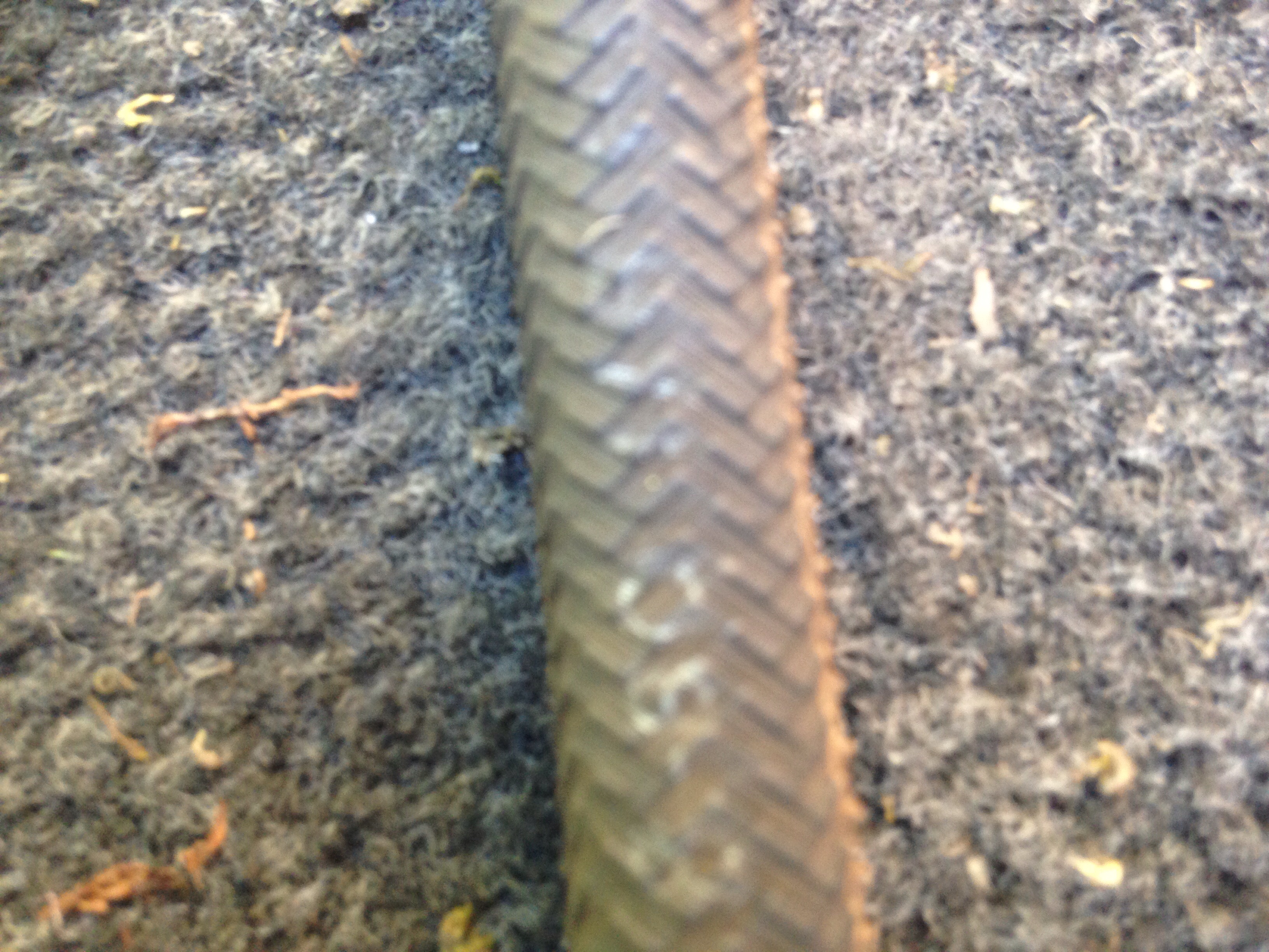

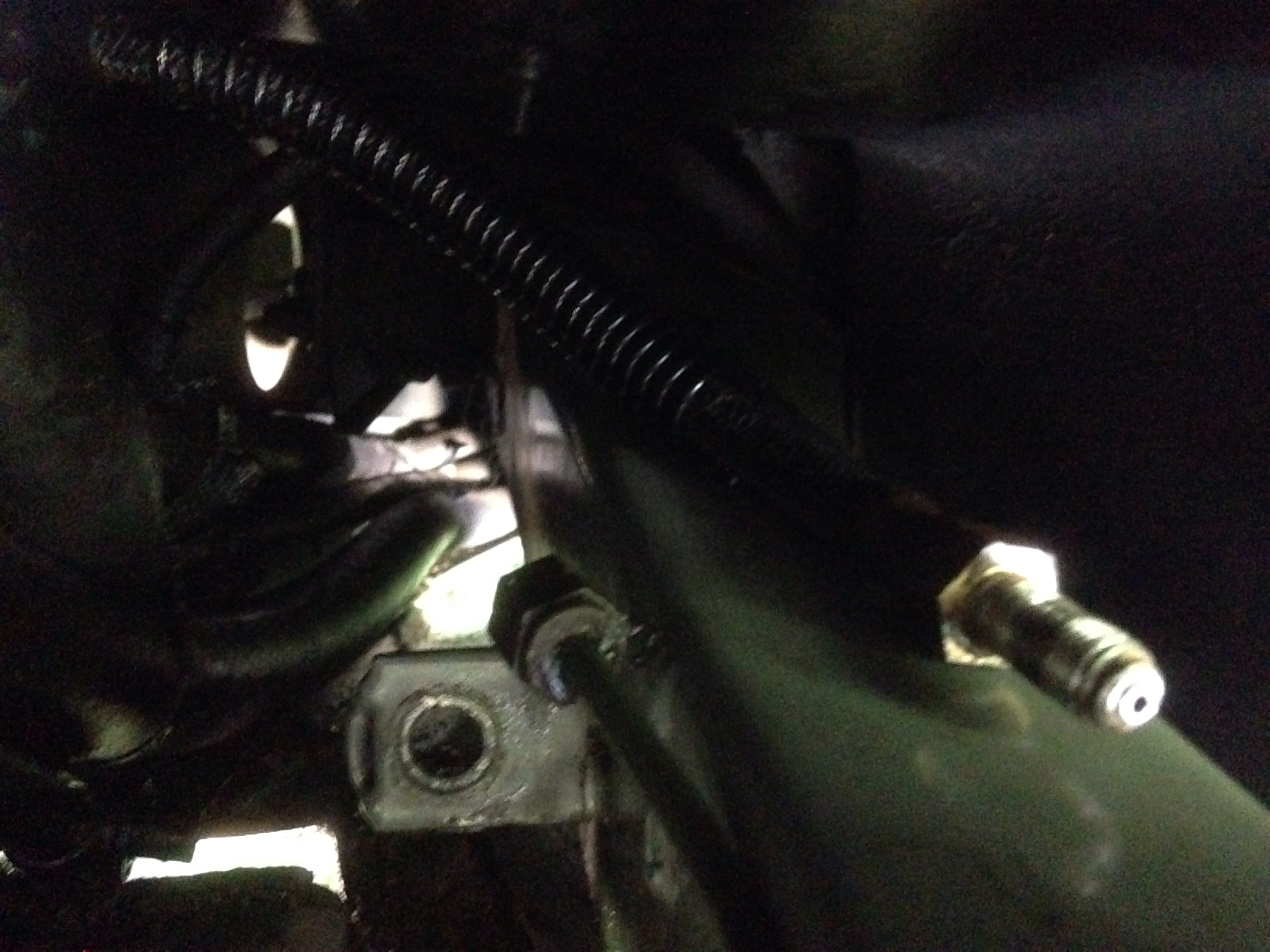

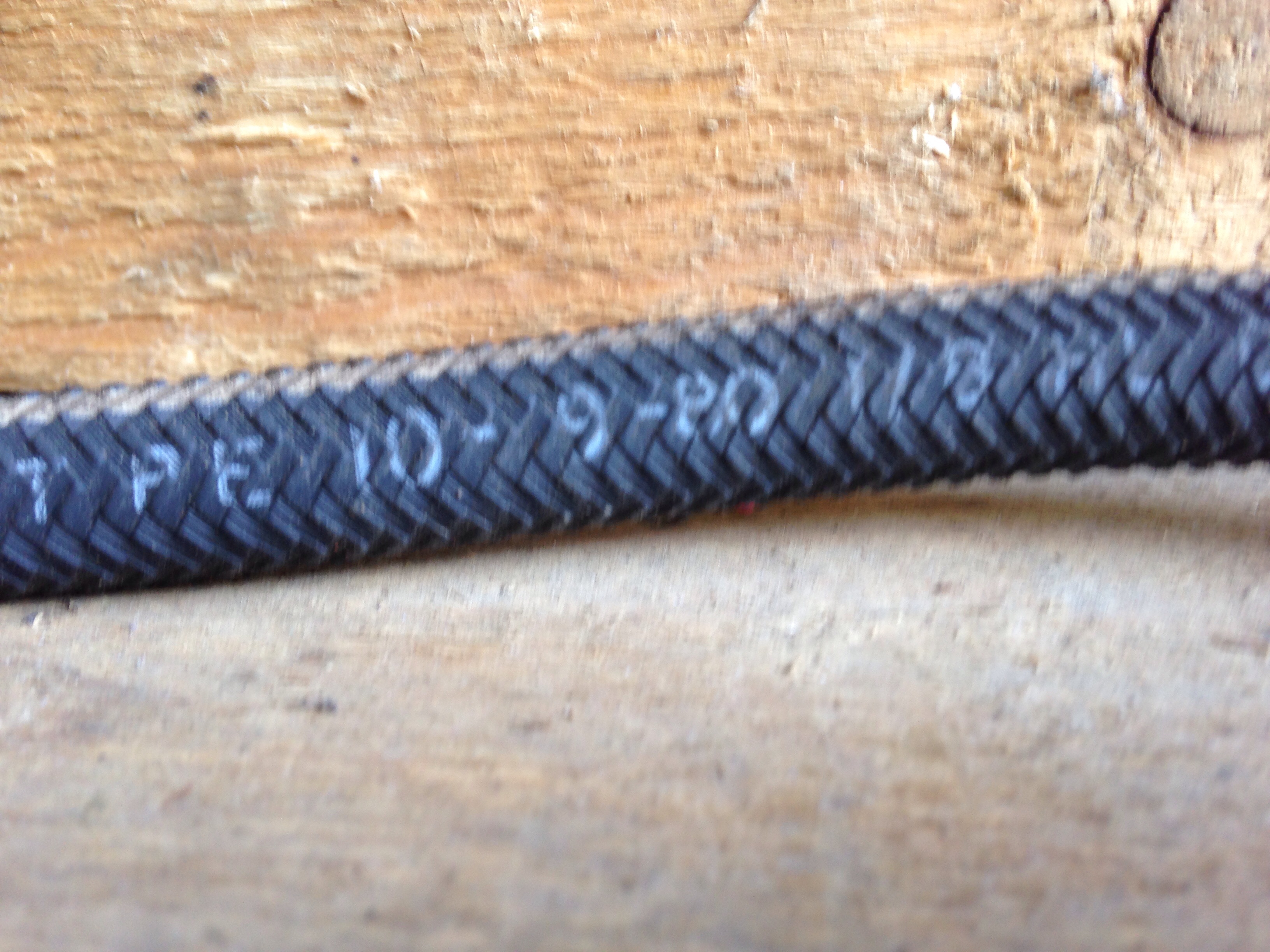

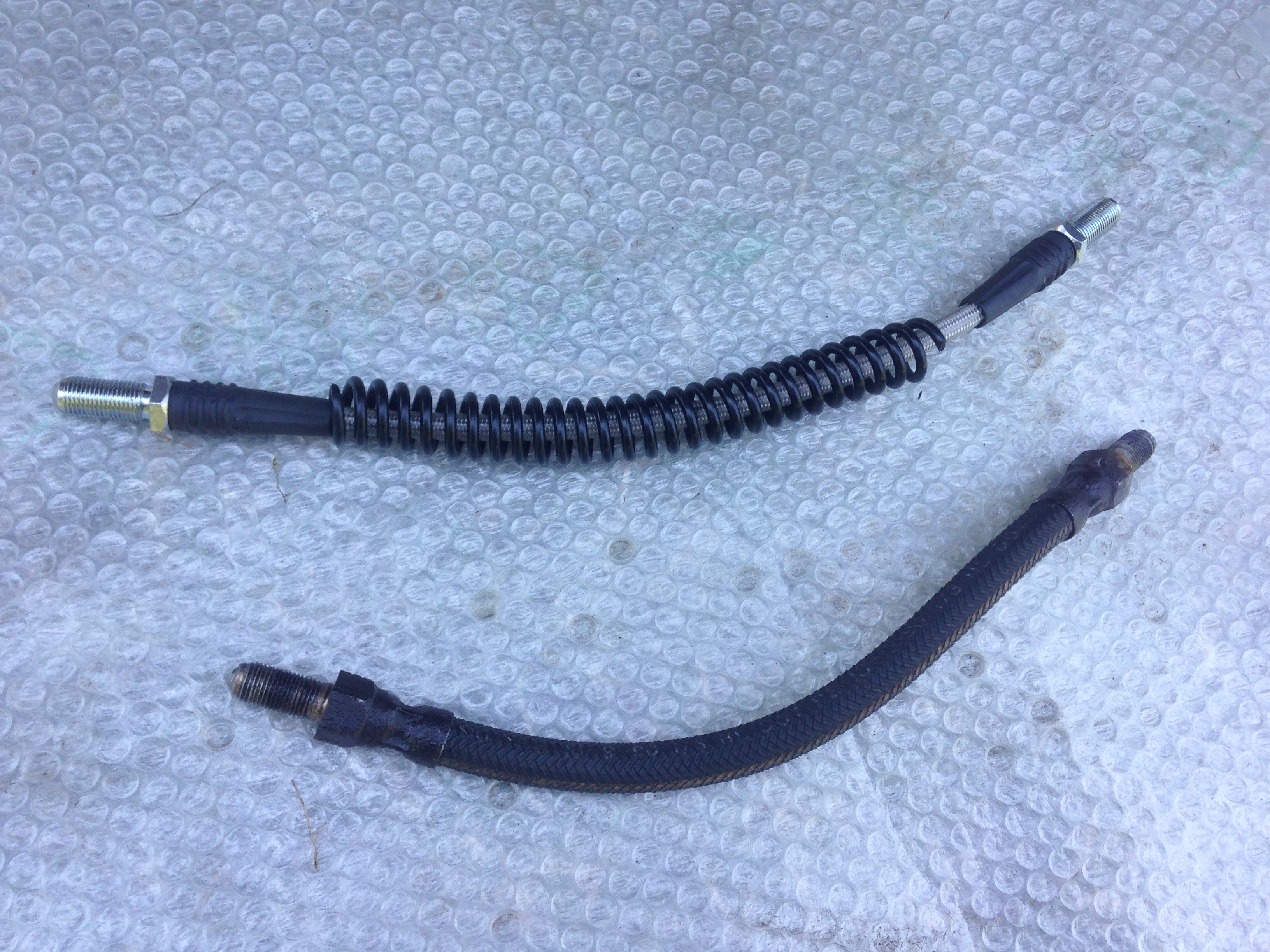

More work done...new stainless steel flex brake hoses... Gearbox oil changed....Old brake pipes dated 8/80 ... Think they were due for replacement ! :shock:.... Things coming along nicely ... Rear hoses to replace next... And coolant change...and 569 is ready for mot..

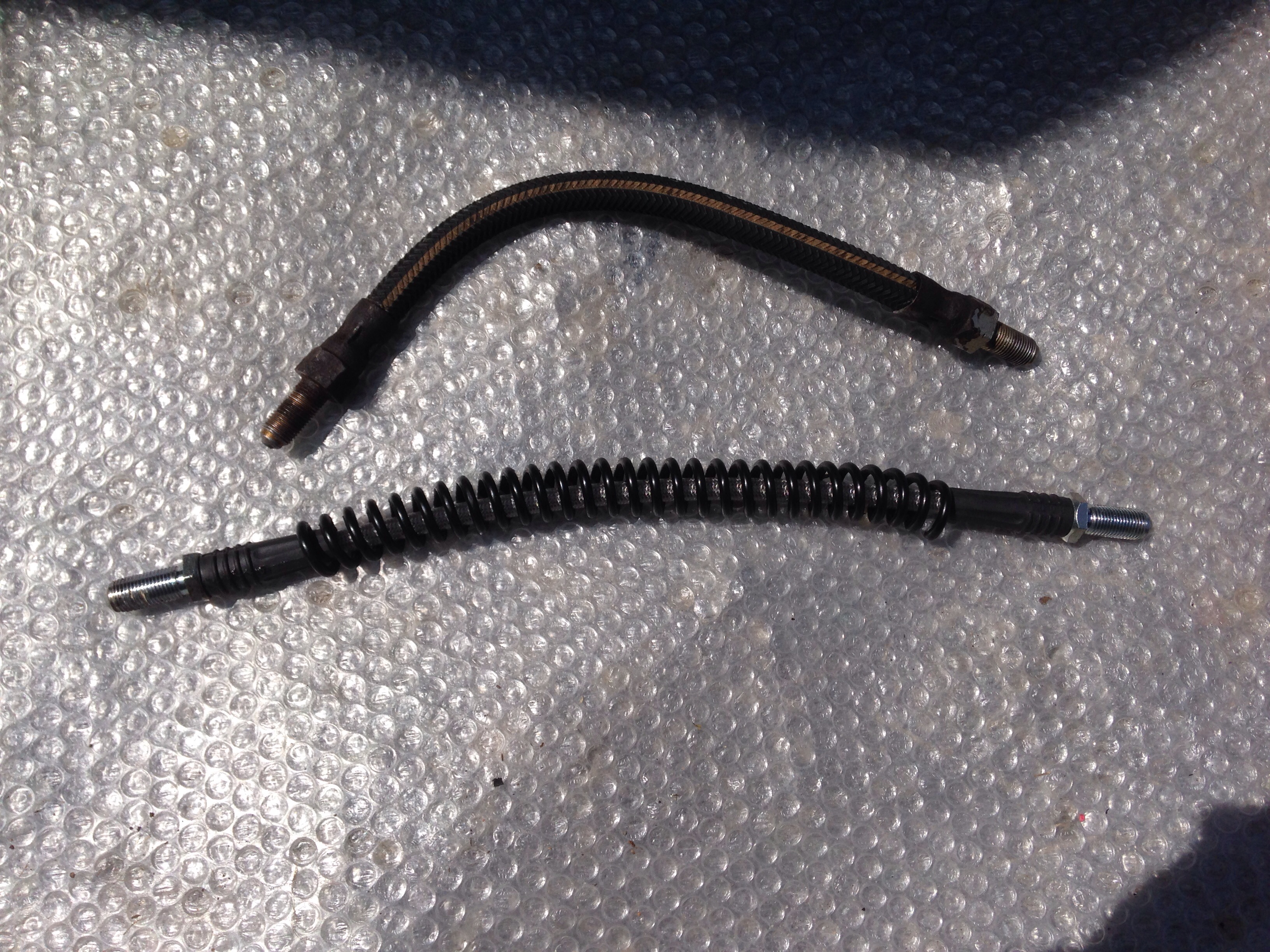

Postby Dukes Of Hammond » Sun Jul 05, 2015 7:34 pm

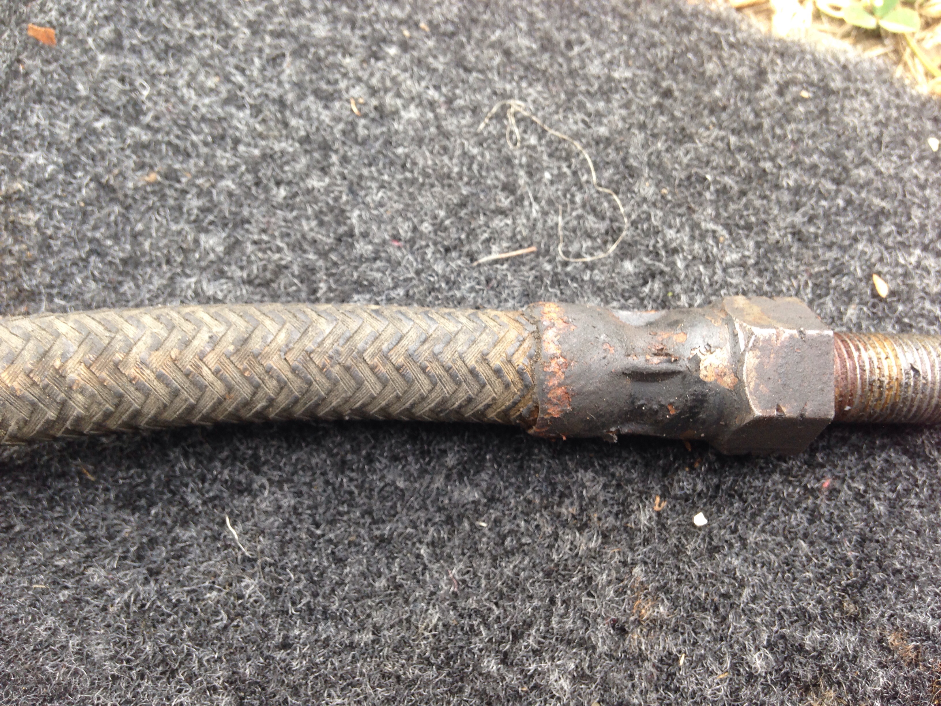

Well that's o/s/r brake hose changed ... Again original 8/1980 dated hoses... Biggest thing I noticed was that the internals of the old hoses has reduced the flow of fluid considerably compared to the new ones... That just leaves n/s/r for next weekend , I'm changing coolant right after MOT as I believe a run then a change with fresh would be the best idea...

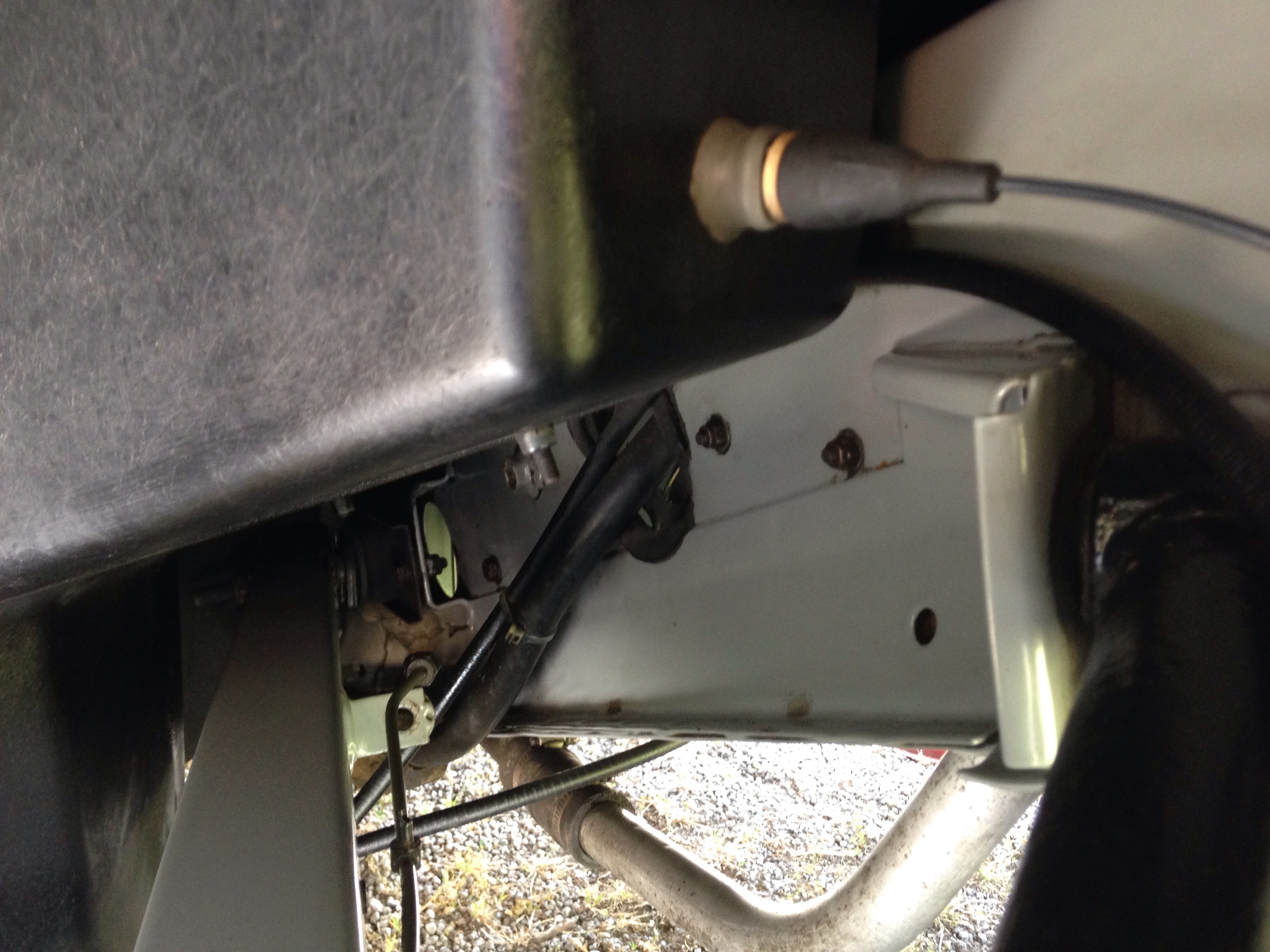

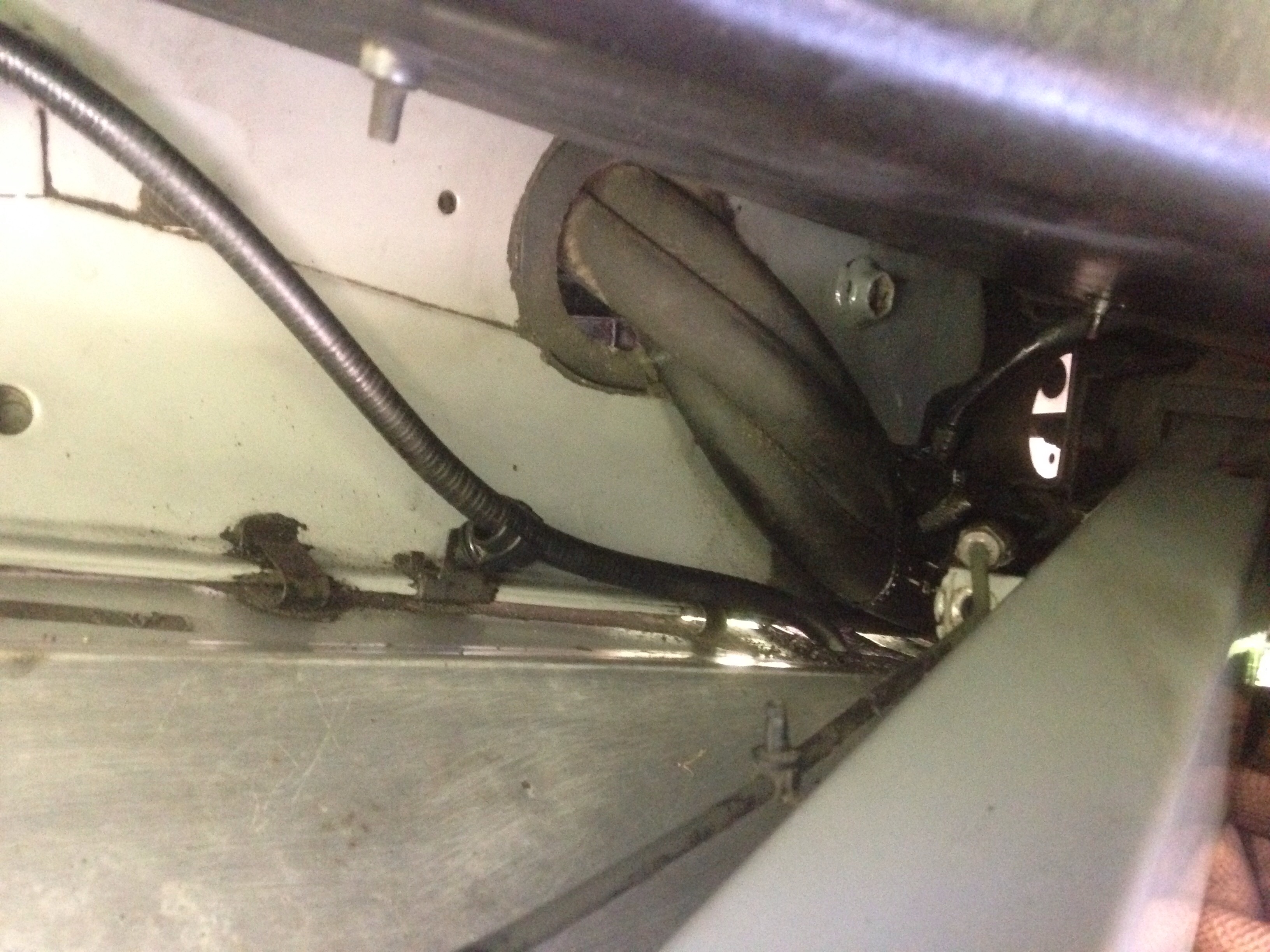

Postby Dukes Of Hammond » Sun Jul 05, 2015 7:39 pm
:shock: Replacing rear hoses are defiantly a harder job than the fronts... That's for sure!!

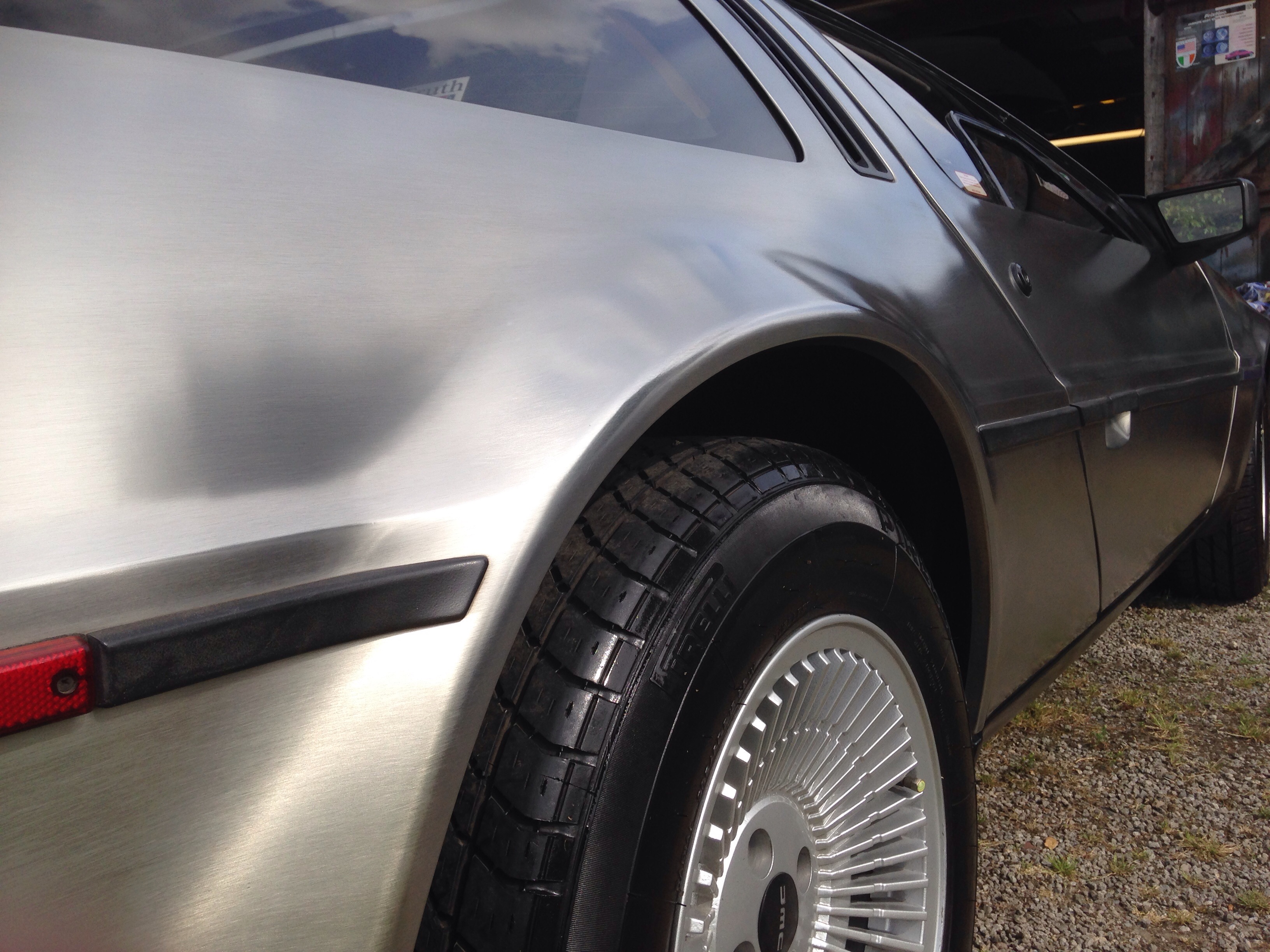

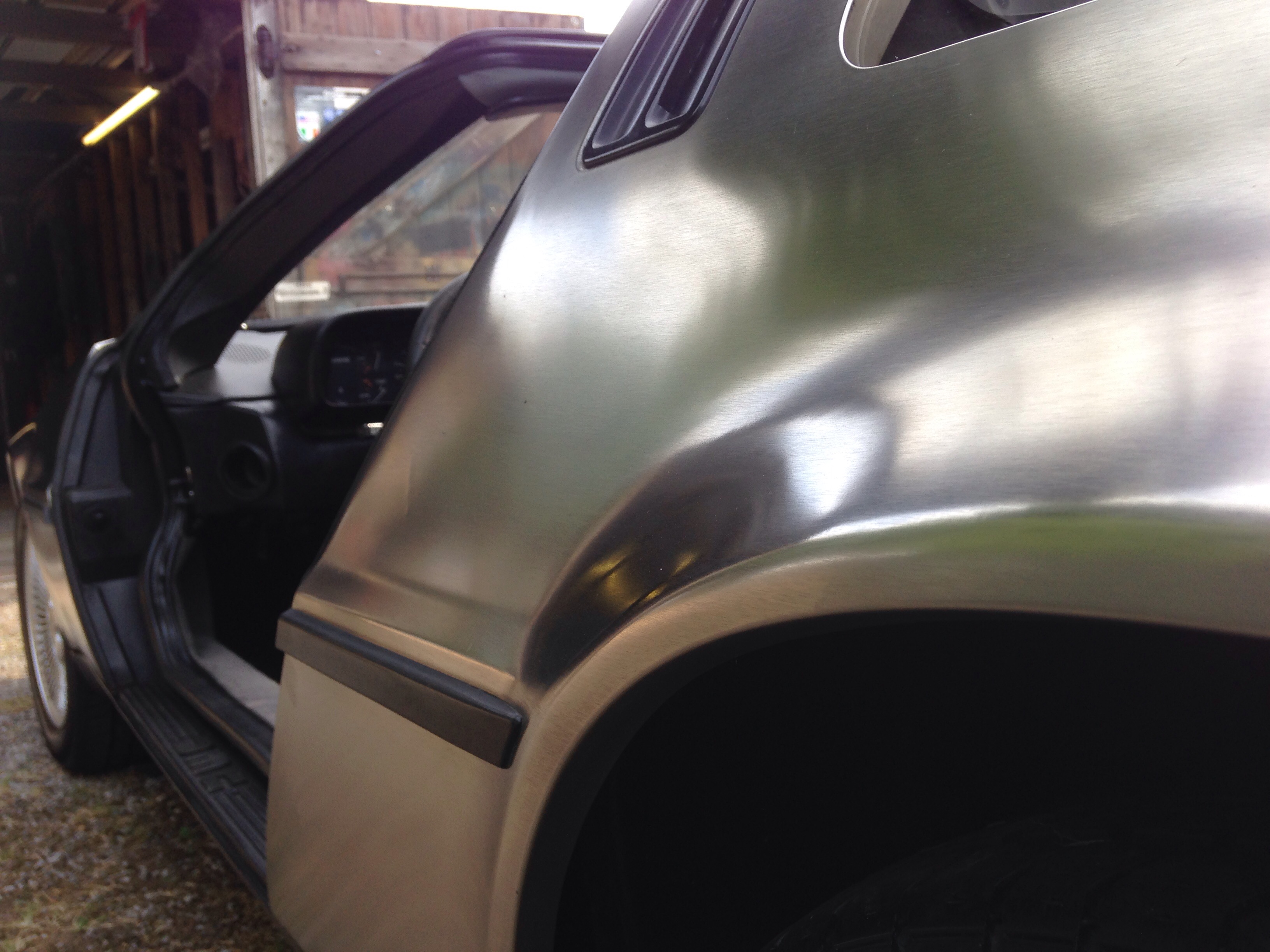

The stainless looks amazing...how on earth did you get it looking like that!?
