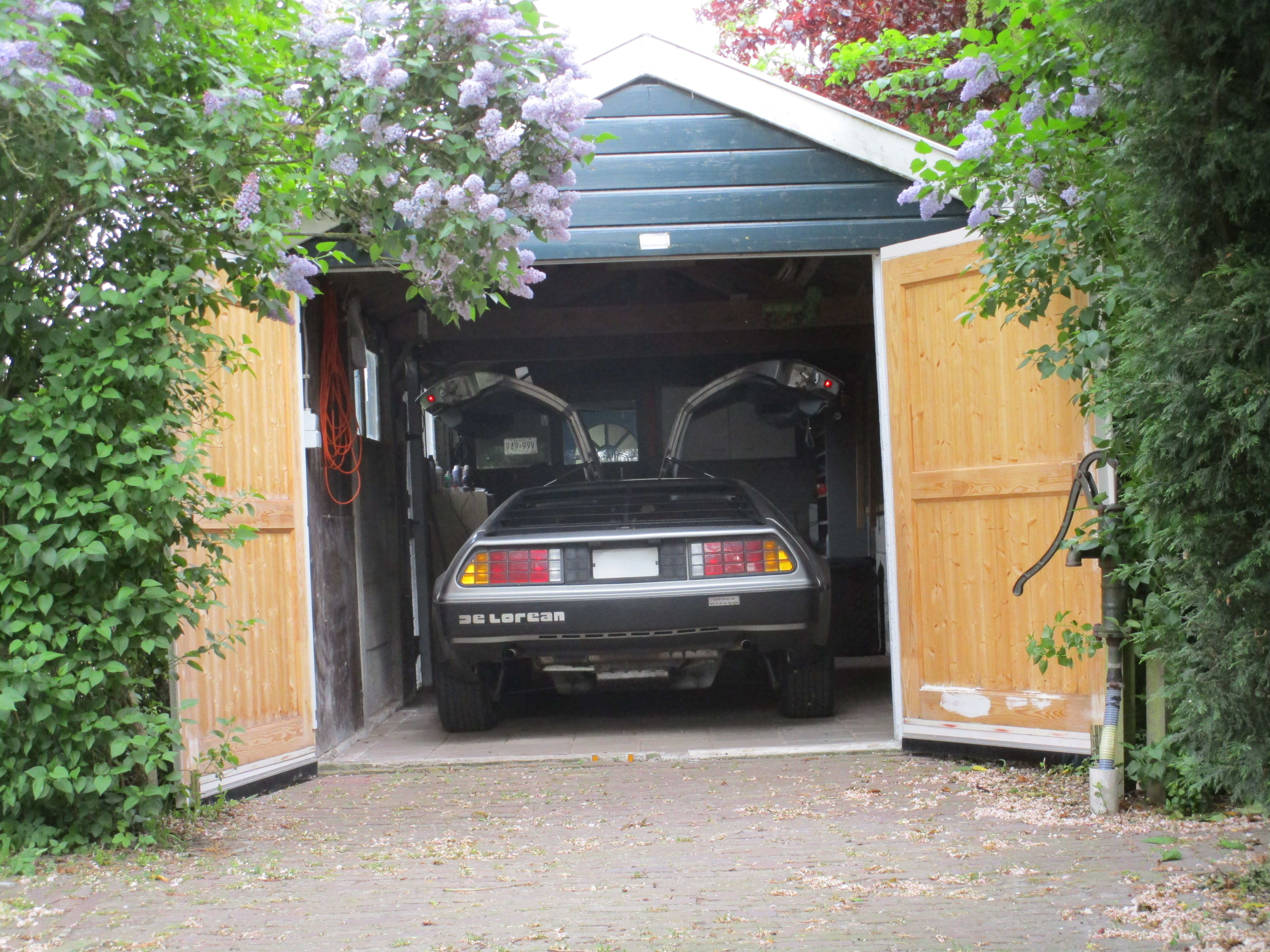

Have the car at my house now. Have a shed in my garden and made bigger doors in it so i can park the D inside.
This is just for the summer. Have insulated shed at my parents place for winter storage.
