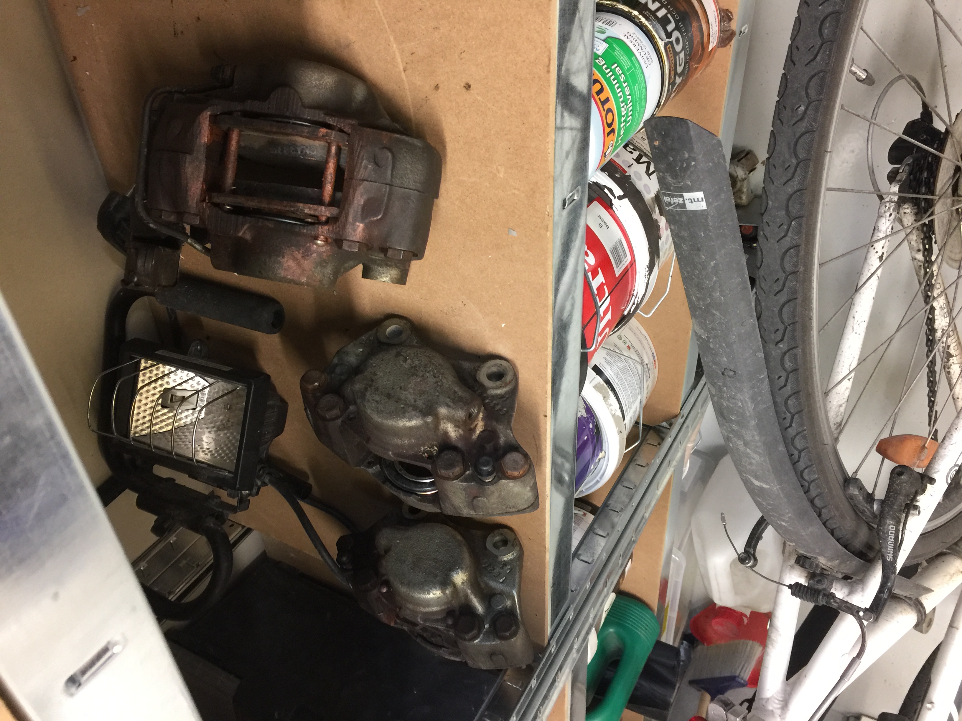

Postby gruffalo » Thu Aug 24, 2017 10:07 pm

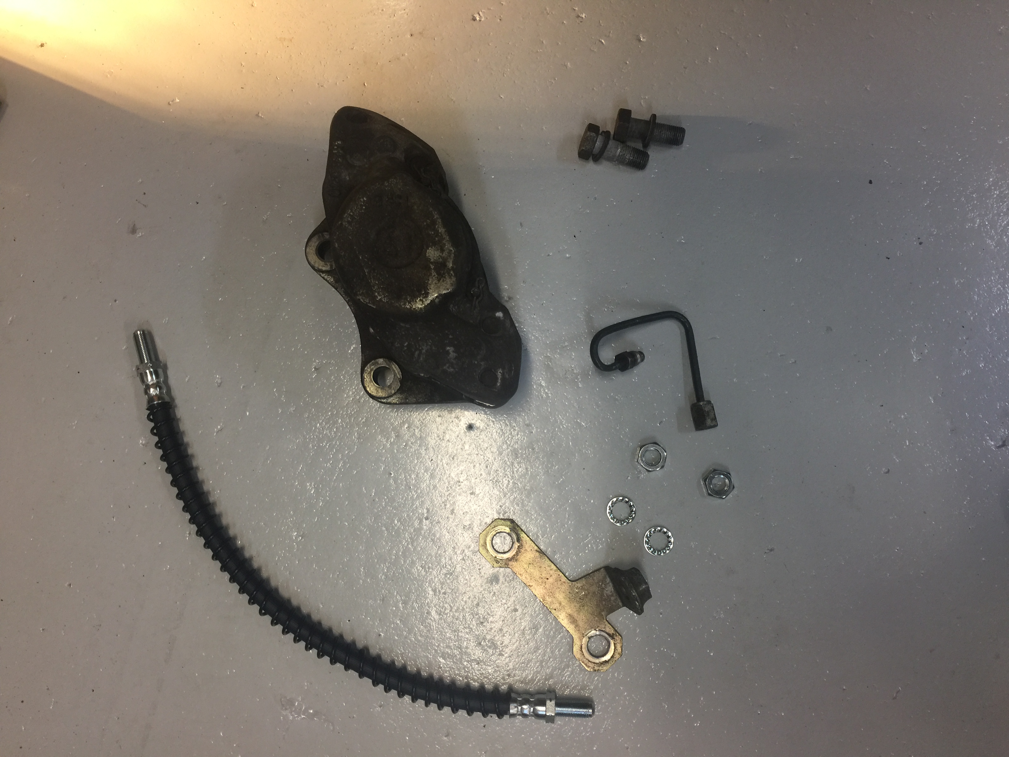

Got some work done today
Tie rod end and boot installed
One more caliper done

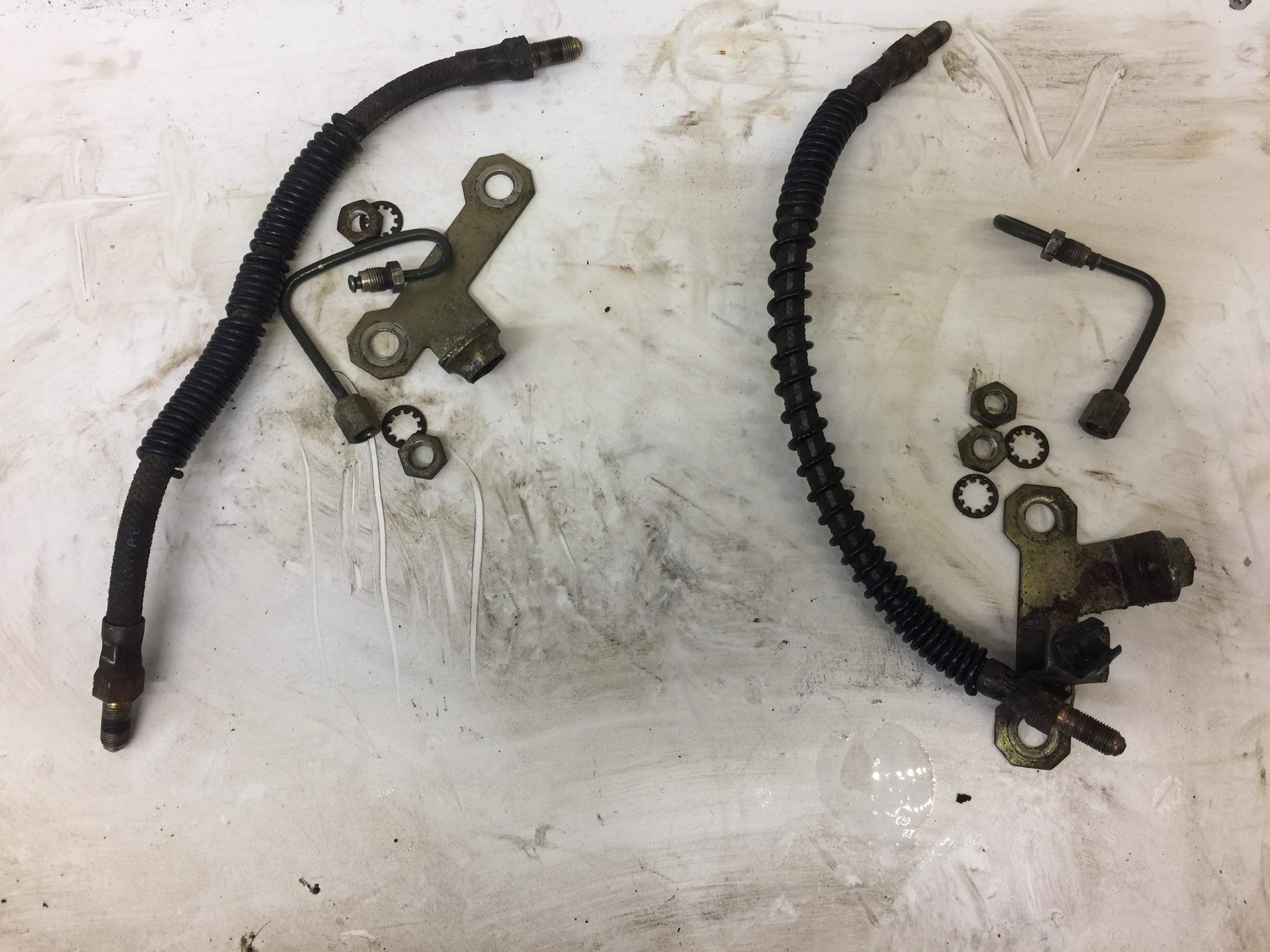

Postby Delta Delorean » Fri Aug 25, 2017 8:10 am
Make sure to replace those old flex brake lines! The old ones on my D would expand when braking hard, so not much brake action going on. The club sells a nice set of stainless.

Postby InoX » Fri Aug 25, 2017 9:39 am
how do you get the calipers to float like that are they magnetic? :P

Postby gruffalo » Fri Aug 25, 2017 1:33 pm
Delta Delorean wrote:Make sure to replace those old flex brake lines! The old ones on my D would expand when braking hard, so not much brake action going on. The club sells a nice set of stainless.
I'm a bit of a Scrooge, but still, new flex brake lines are in the mail. Also, soft fuel lines will be replaced, I don't want to use my fire extinguisher...

Re: Vin 5063
Postby gruffalo » Fri Aug 25, 2017 1:34 pm
InoX wrote:how do you get the calipers to float like that are they magnetic? :P
No, not magnetic. It's just plain old magic :D

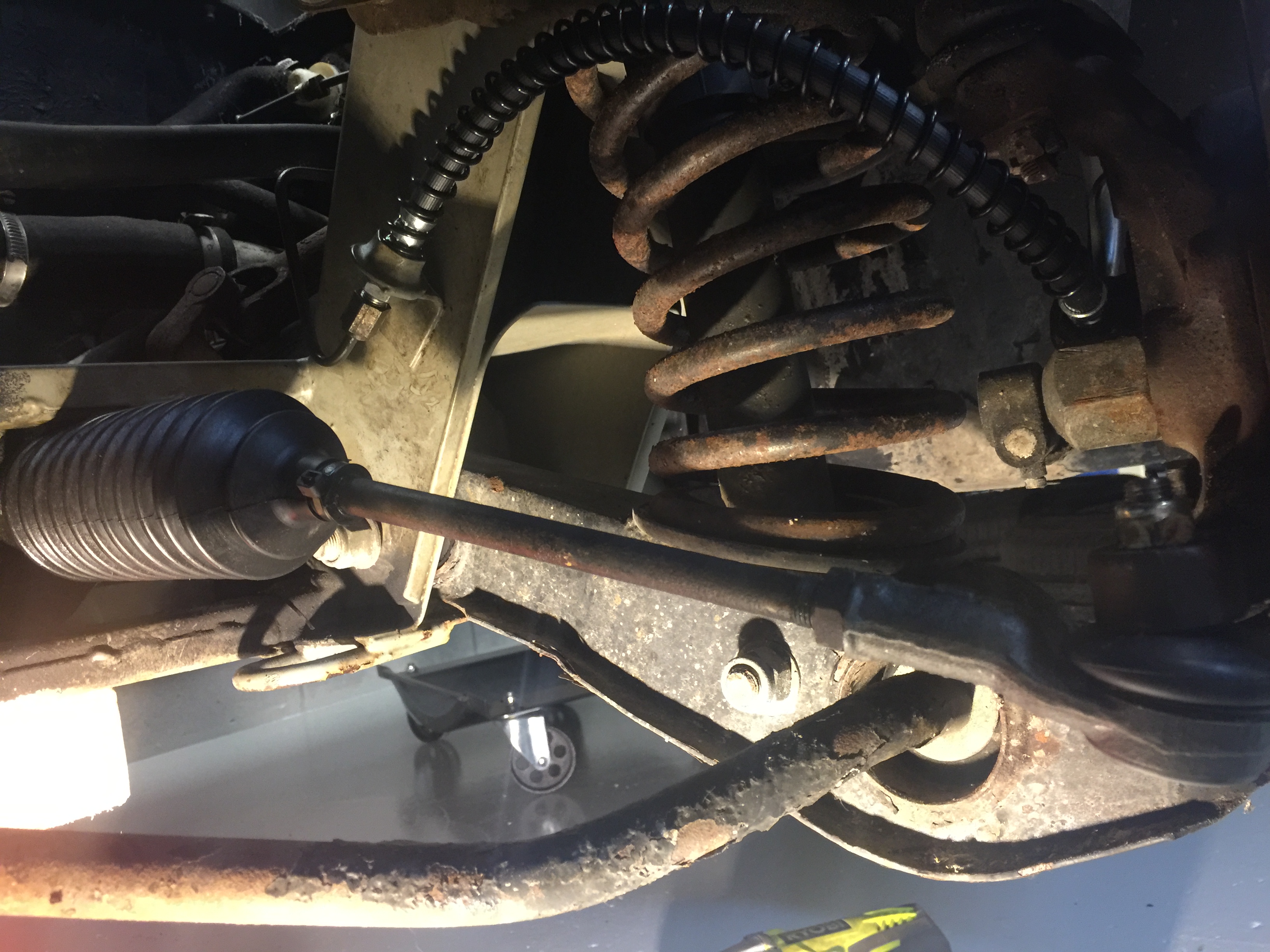

Postby gruffalo » Mon Aug 28, 2017 9:25 pm

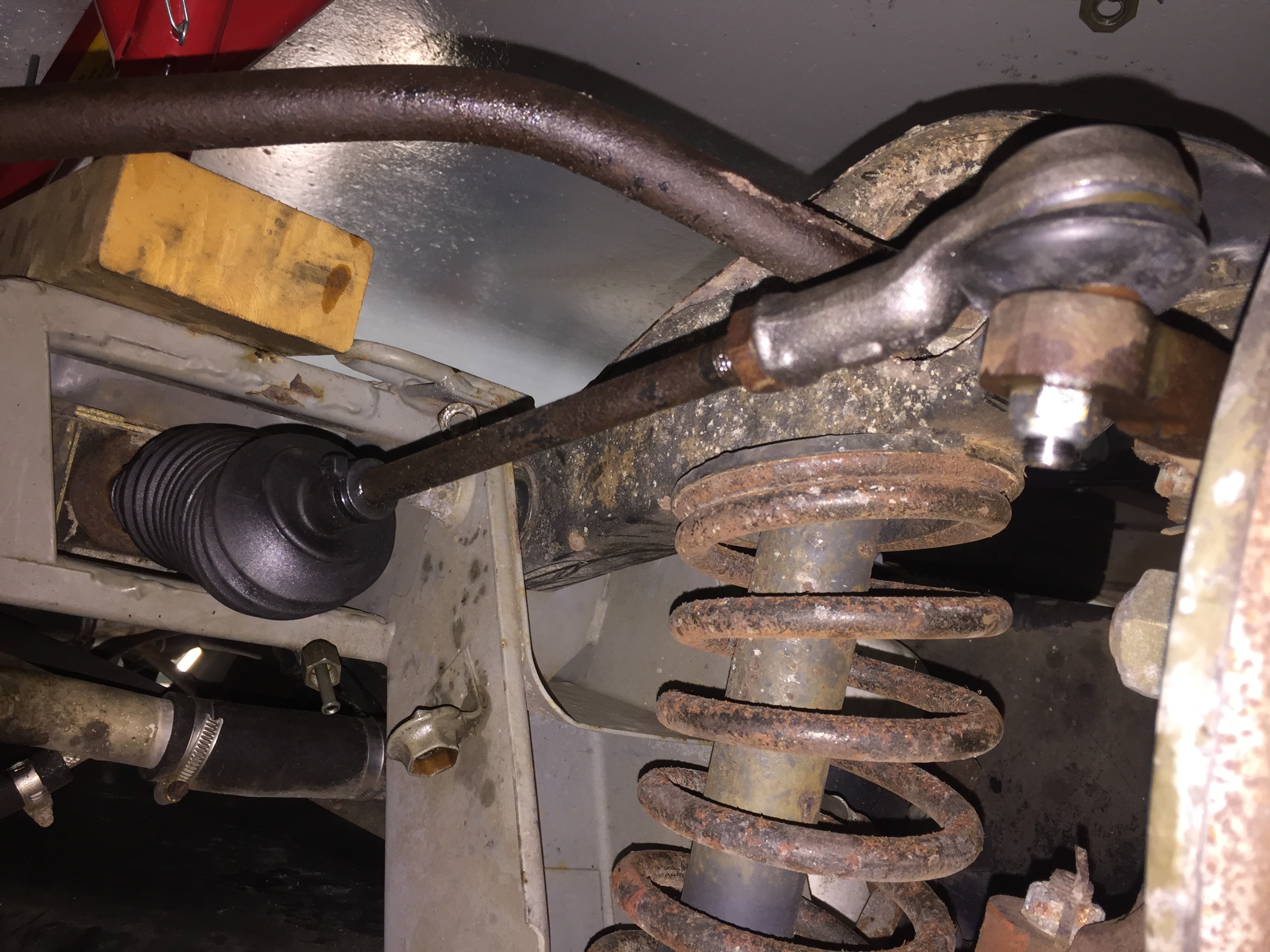

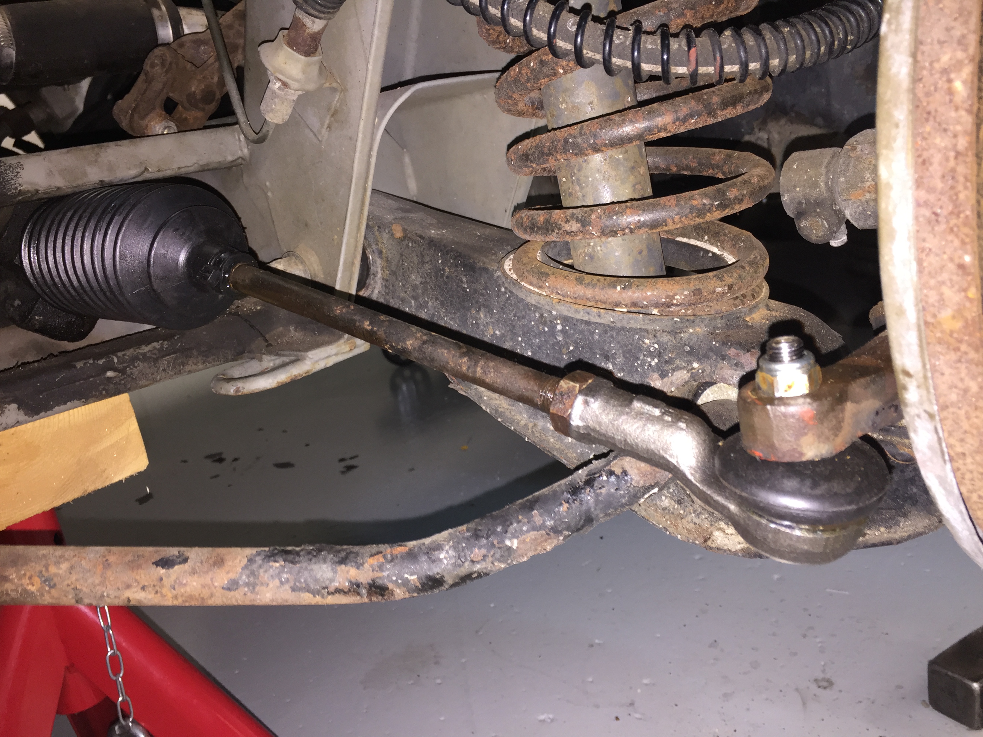

The boot for the steering rack was really hard to install on the passenger side. I used a hacked soda can to bridge the gap and get it over the end of the rack. Spent a lot of time there.
I also got the second tie rod end installed, and the brake hoses removed. They appear flawless. Not even superficial micro cracks were found upon close inspection.
They will still be replaced.
Hoses carry their age really well
Pass side boot and tie rod end

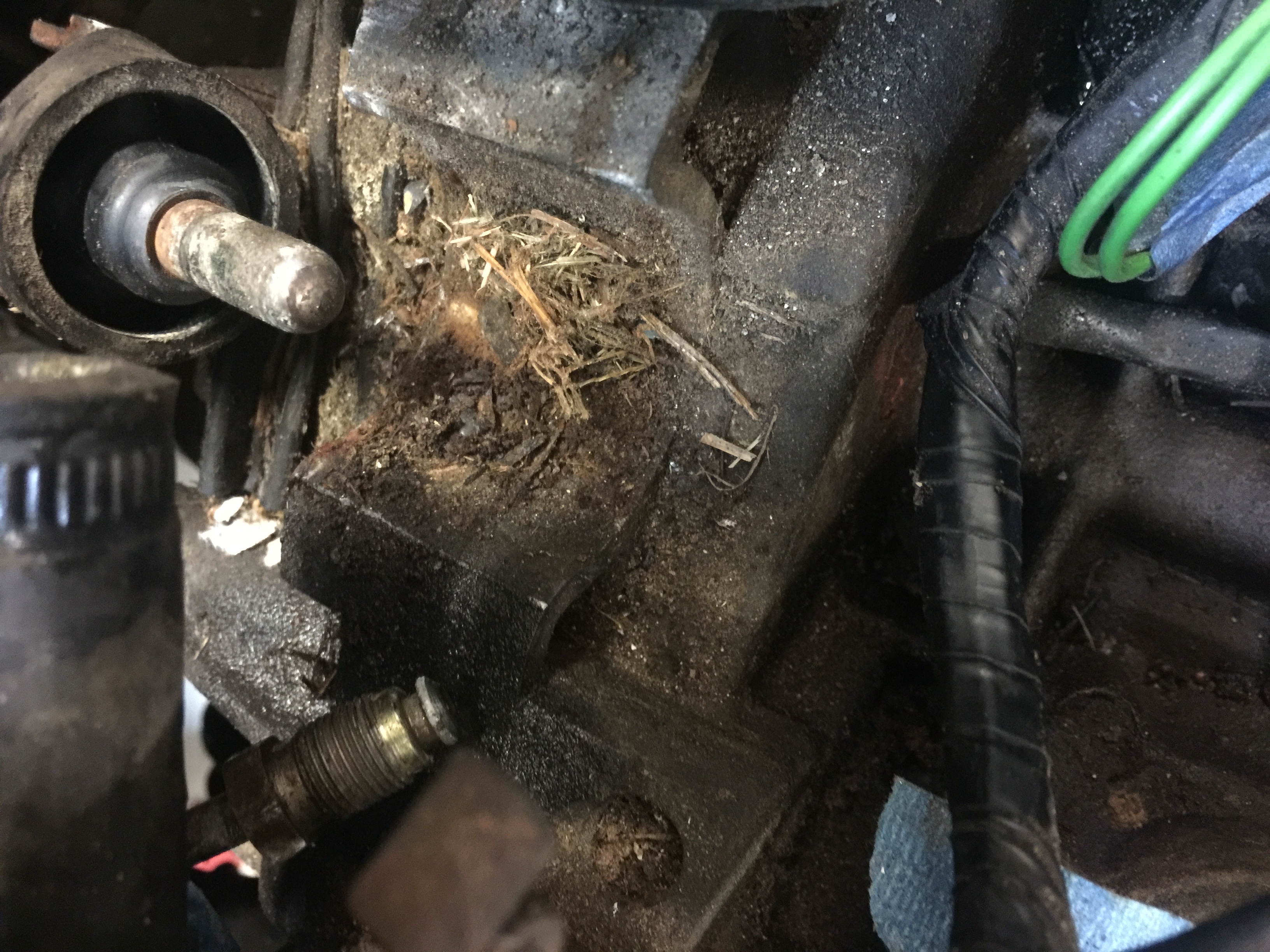

Postby gruffalo » Tue Aug 29, 2017 10:12 pm

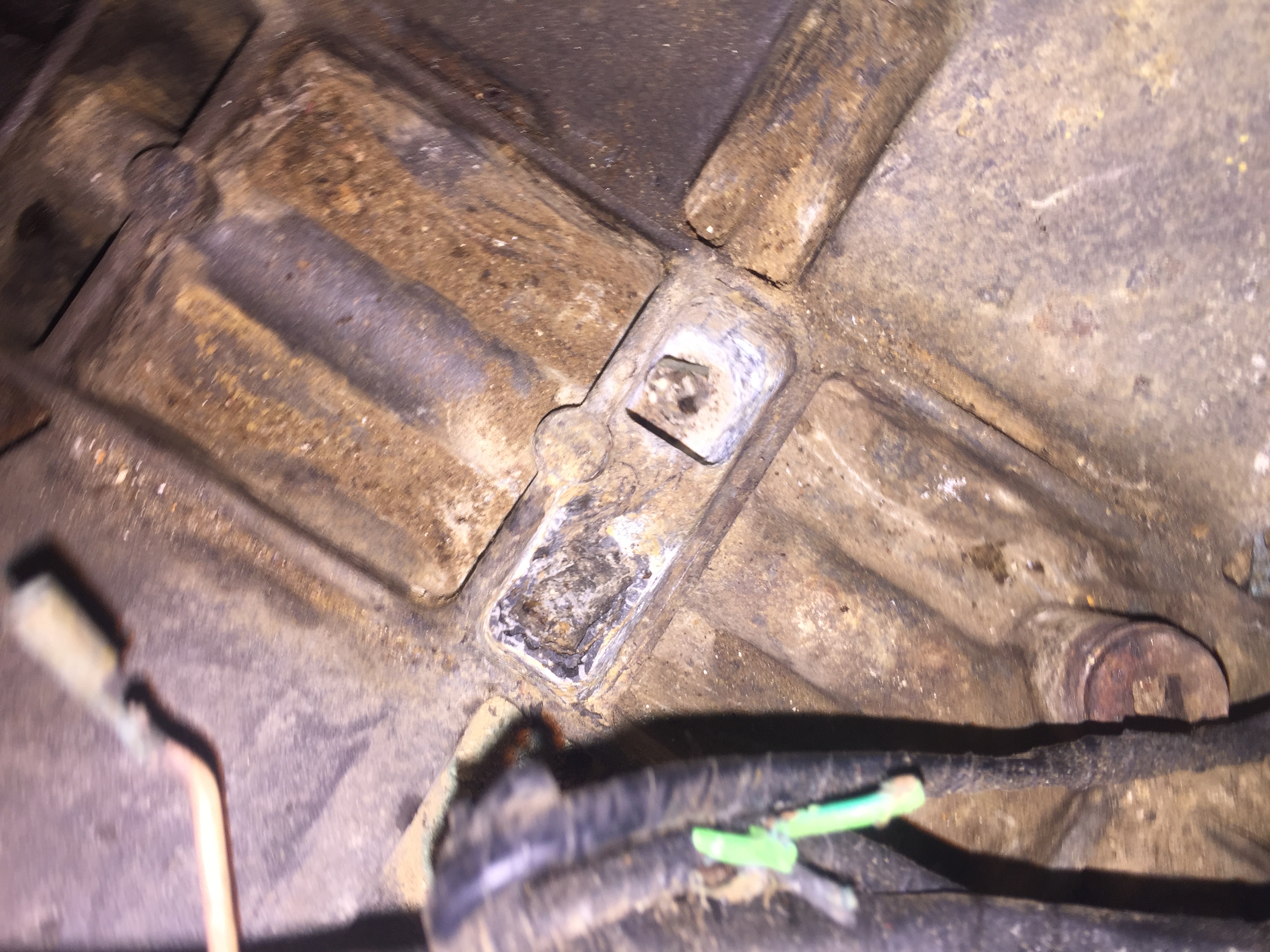

Pulled the clutch slave today, decided to give the master a try as it is. I already have a new slave, so that will be installed regardless.
Also did some tidying in the engine bay.
The block appears to be repaired. That's not great, but we'll just have to see how it works.
Block repair
Mess

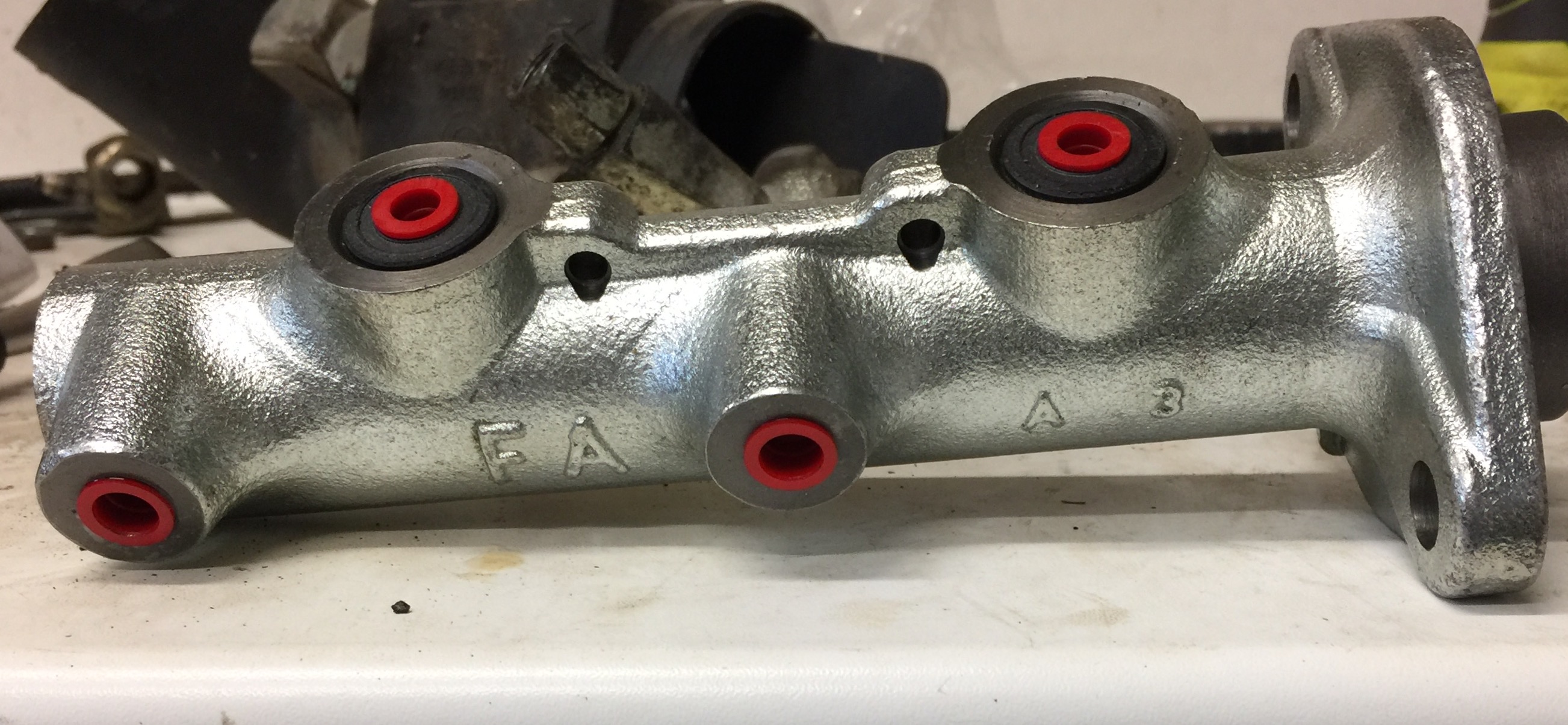

Postby gruffalo » Wed Aug 30, 2017 8:01 pm
New parts arrived today! Brake MC, 50/50 Saab unit.
Almost ready to get the brakes buttoned up, but I need to verify the health of the parking brake cables first.
Hopefully a couple of nights away from completing brakes and clutch. Looking forward to new adventures with the fuel system.
And finally the ultimate adventure: digging into the engine bay :)
Shiny new

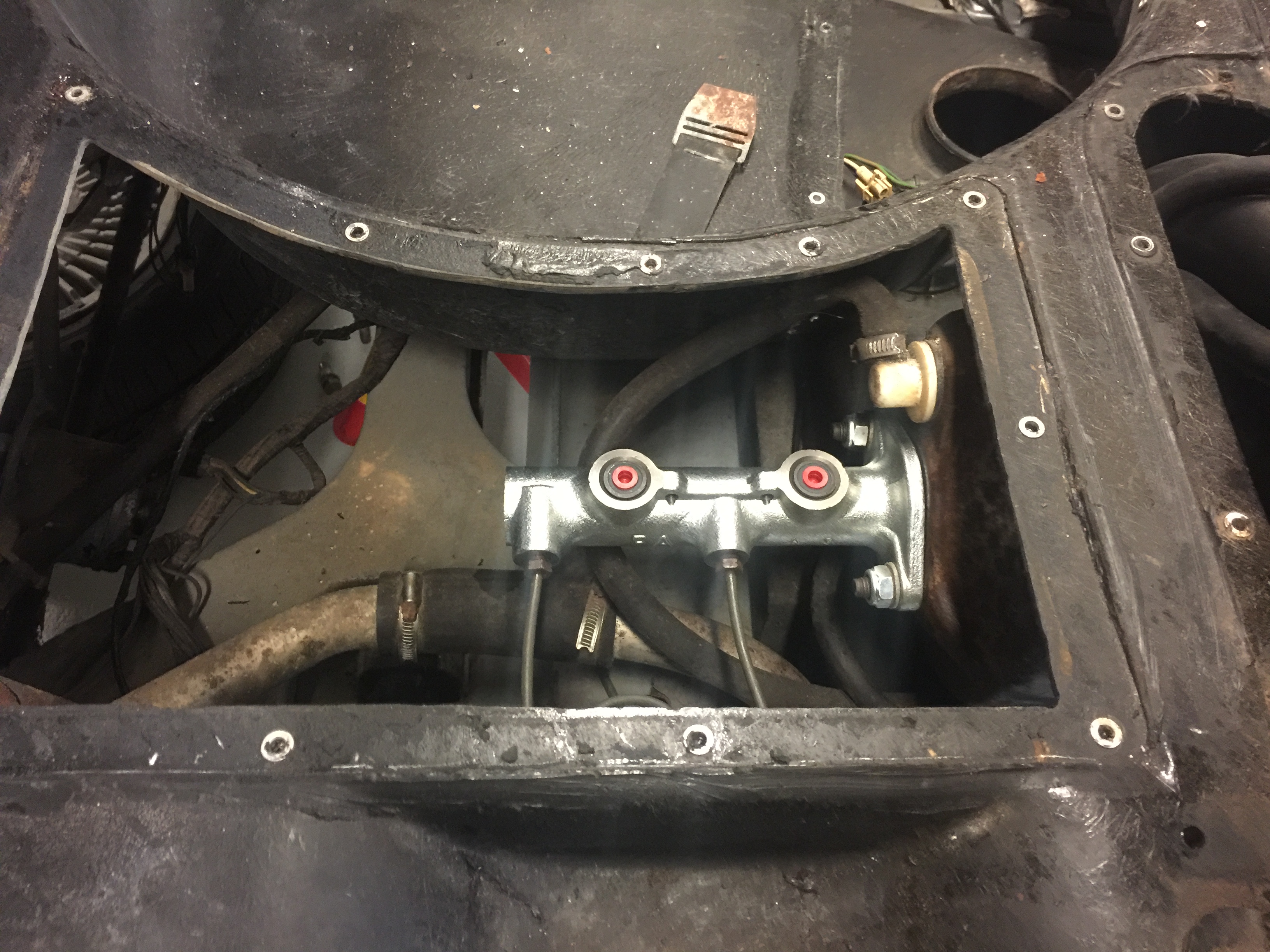

Postby gruffalo » Thu Aug 31, 2017 9:41 pm
A short work session tonight. Got the whole left front corner finished. Installed the brake MC and cleaned the booster and that whole general area. Also installed pads and prepared the other front caliper, so it is only a five minute job to finish that as well.
Got the new flex lines today, along with the new piston for one of the rear calipers. Installed it but I'm still waiting for the dust seal on that one.
I would like to clean out the brake fluid reservoir better. I tried using acetone but not all the gunk dissolved. Any suggestions?
MC bar reservoir installed
Done
Ready to go back in

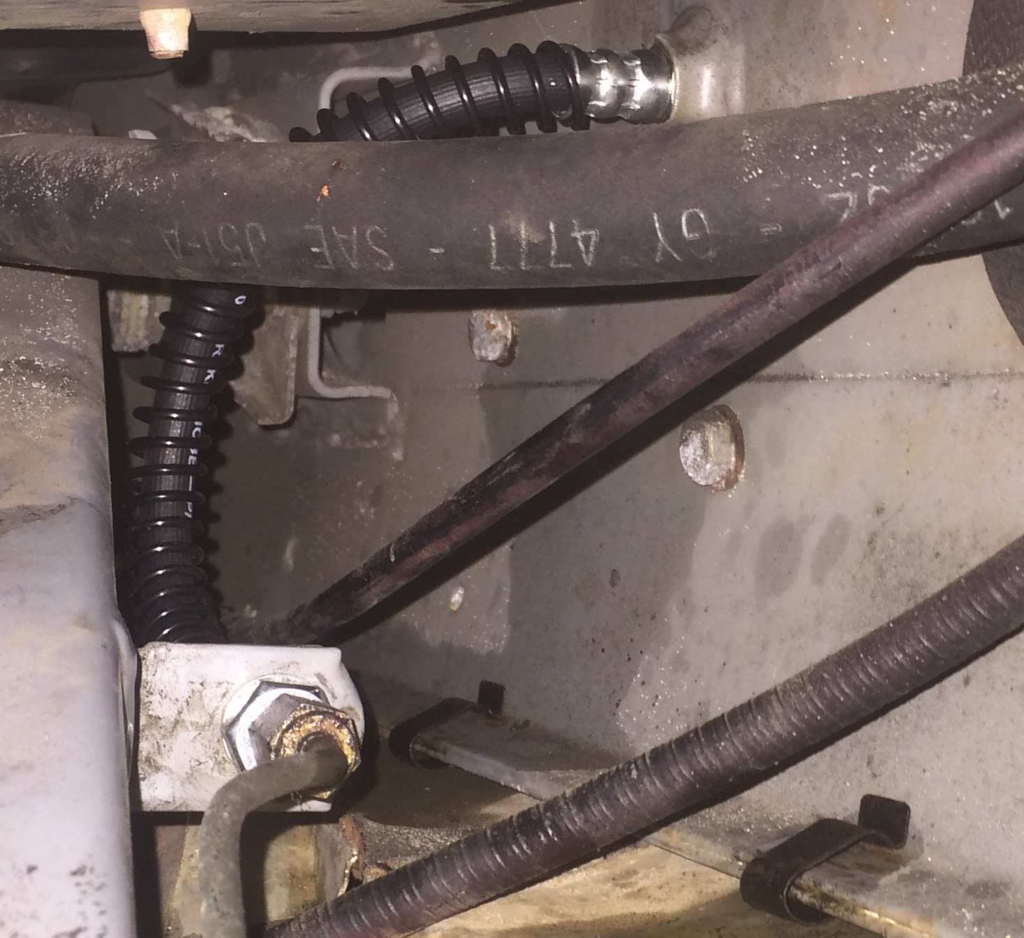

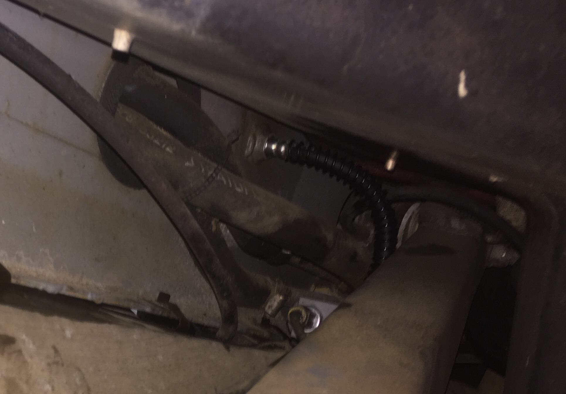

Postby gruffalo » Mon Sep 04, 2017 9:57 pm
Not much to see here. Trying to stay disciplined and do one thing at a time. Replaced the rear brake hoses. Again, the old ones looked perfect and unaffected by age. Let's say it wasn't completely useless...
I'm super excited to get started on the engine, but I'll stick to plan: brakes and clutch first. I'll need at least one more night to get them done.
I noticed the plywood sheet behind the seats looks bad, maybe I'll make a new one. Anyone else done that?
Left side, everything went smoothly
Right side
