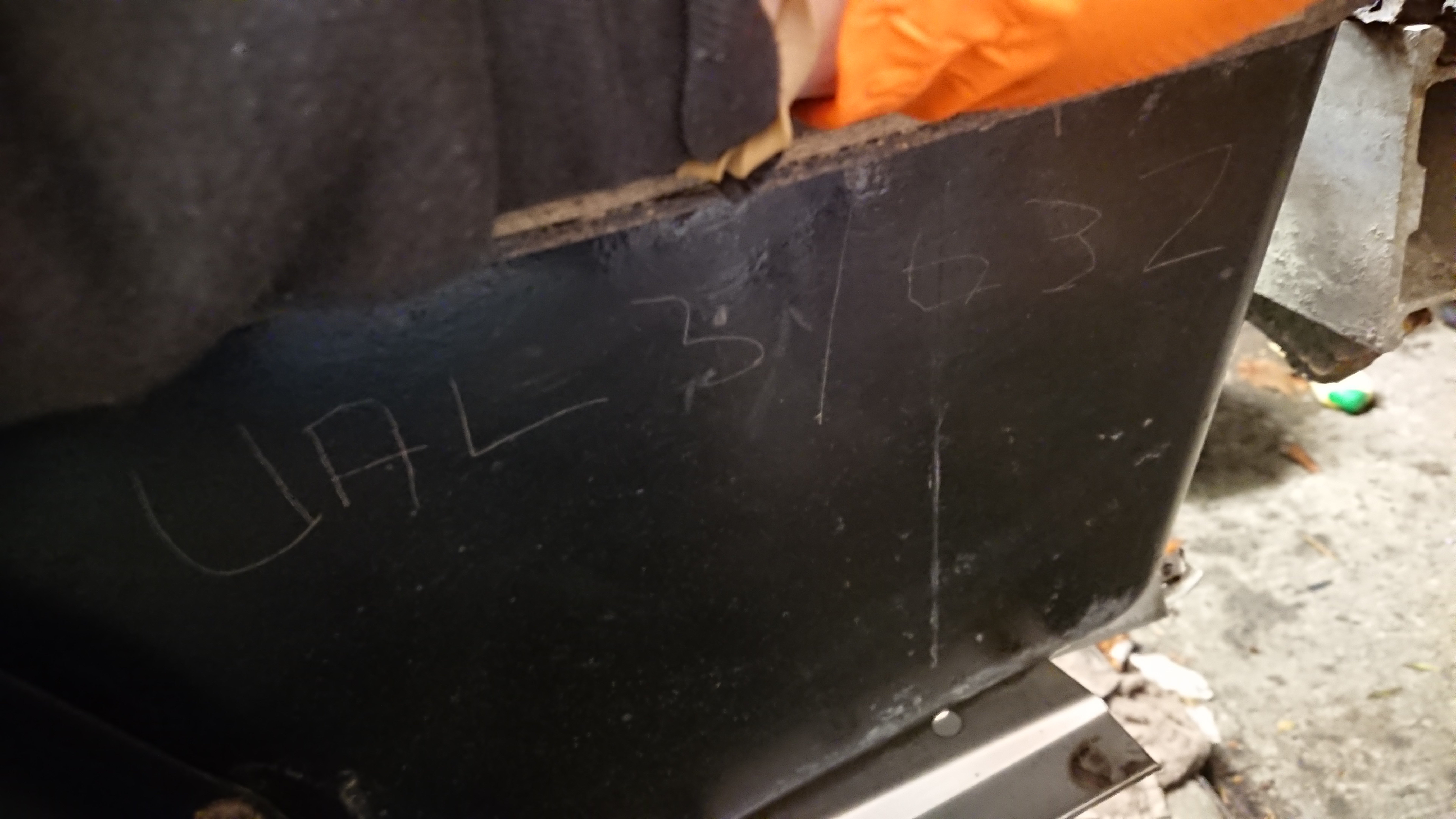

Found these markings on the drivers side after cleaning all the dust and debris off.. It's from the vari mould s I've been told.
The number denotes which vari body tub mold was used.
Did not know about that before, very interesting

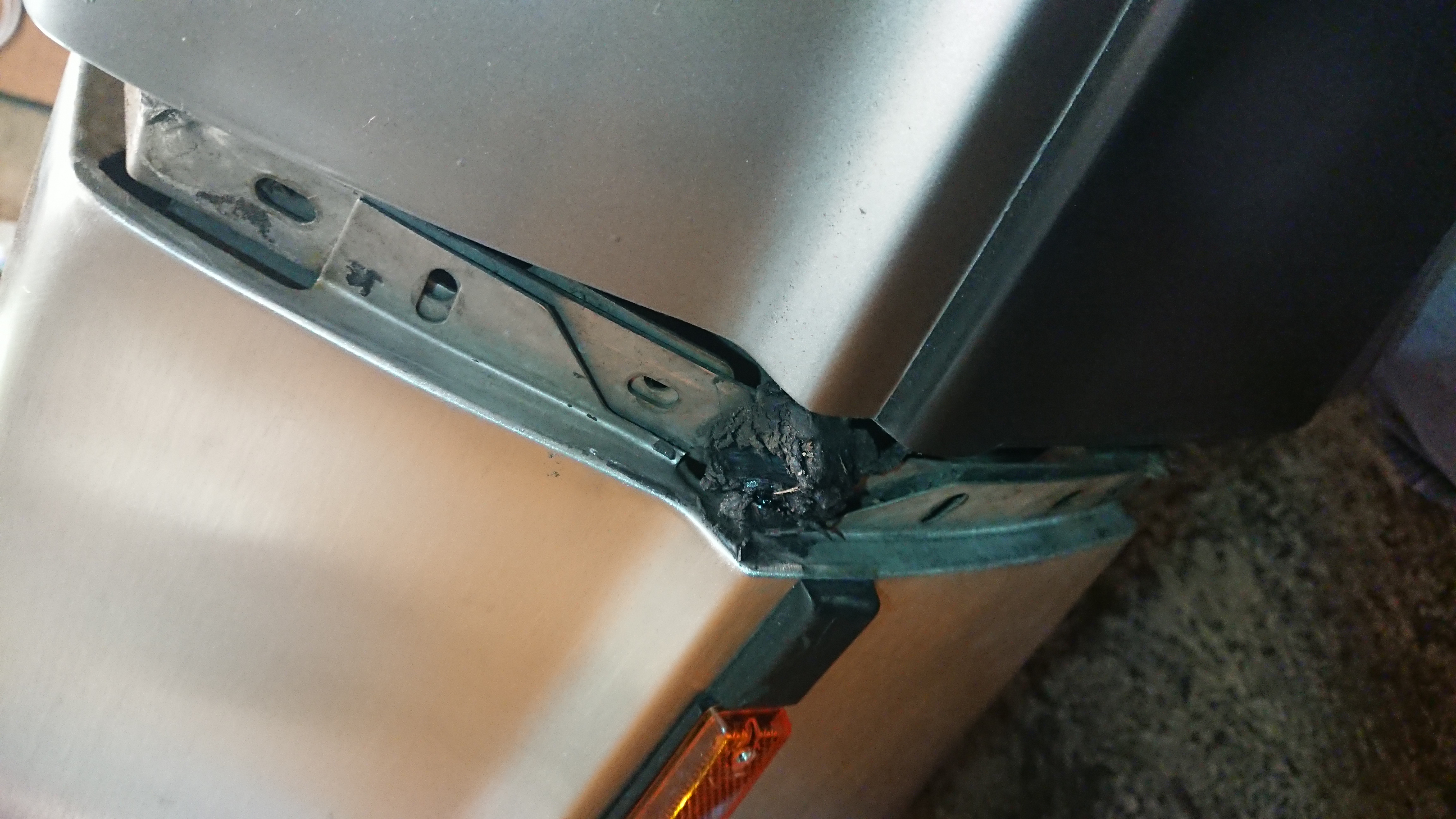

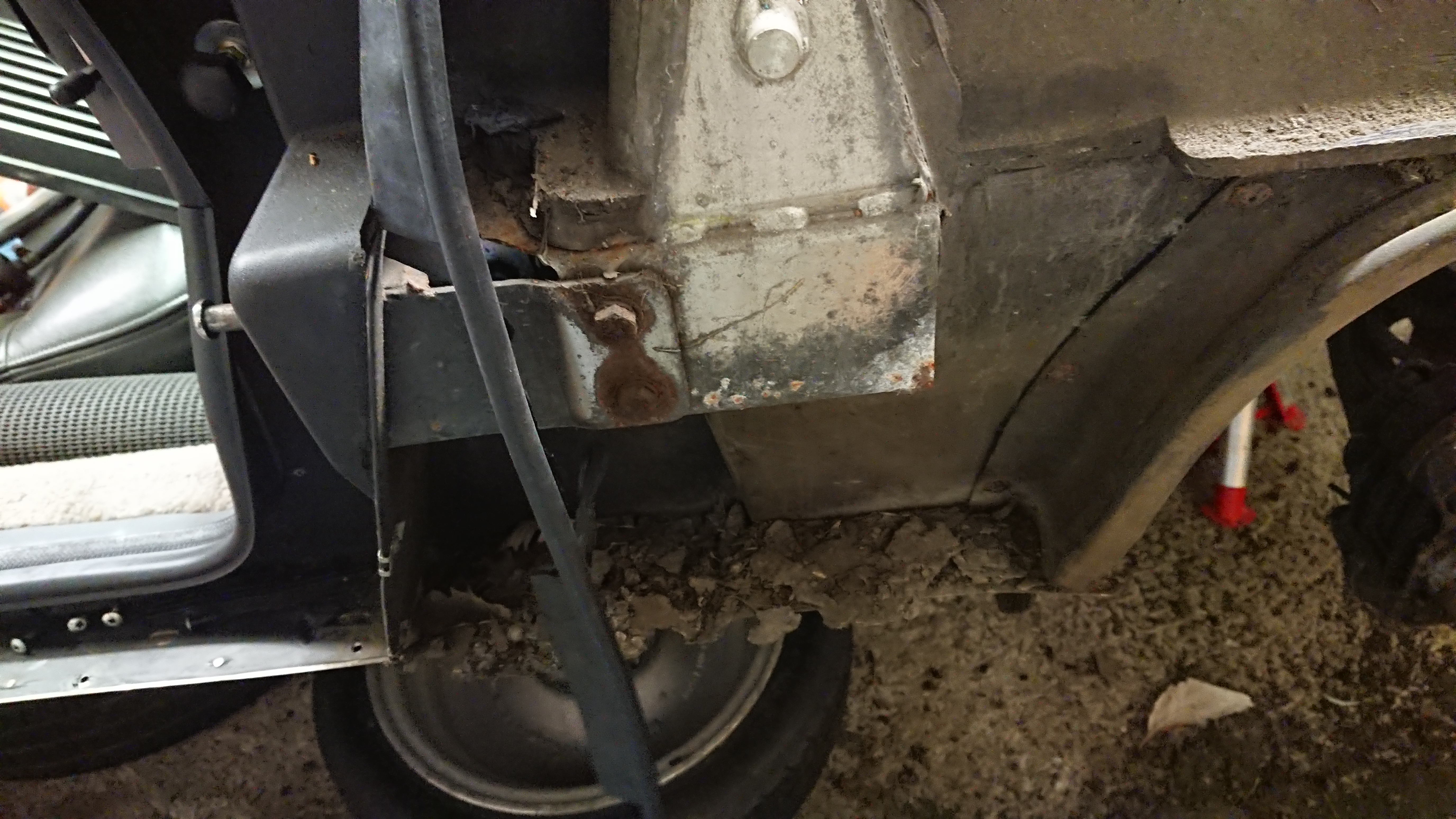

Postby cis6409 » Thu Dec 27, 2018 10:54 pm

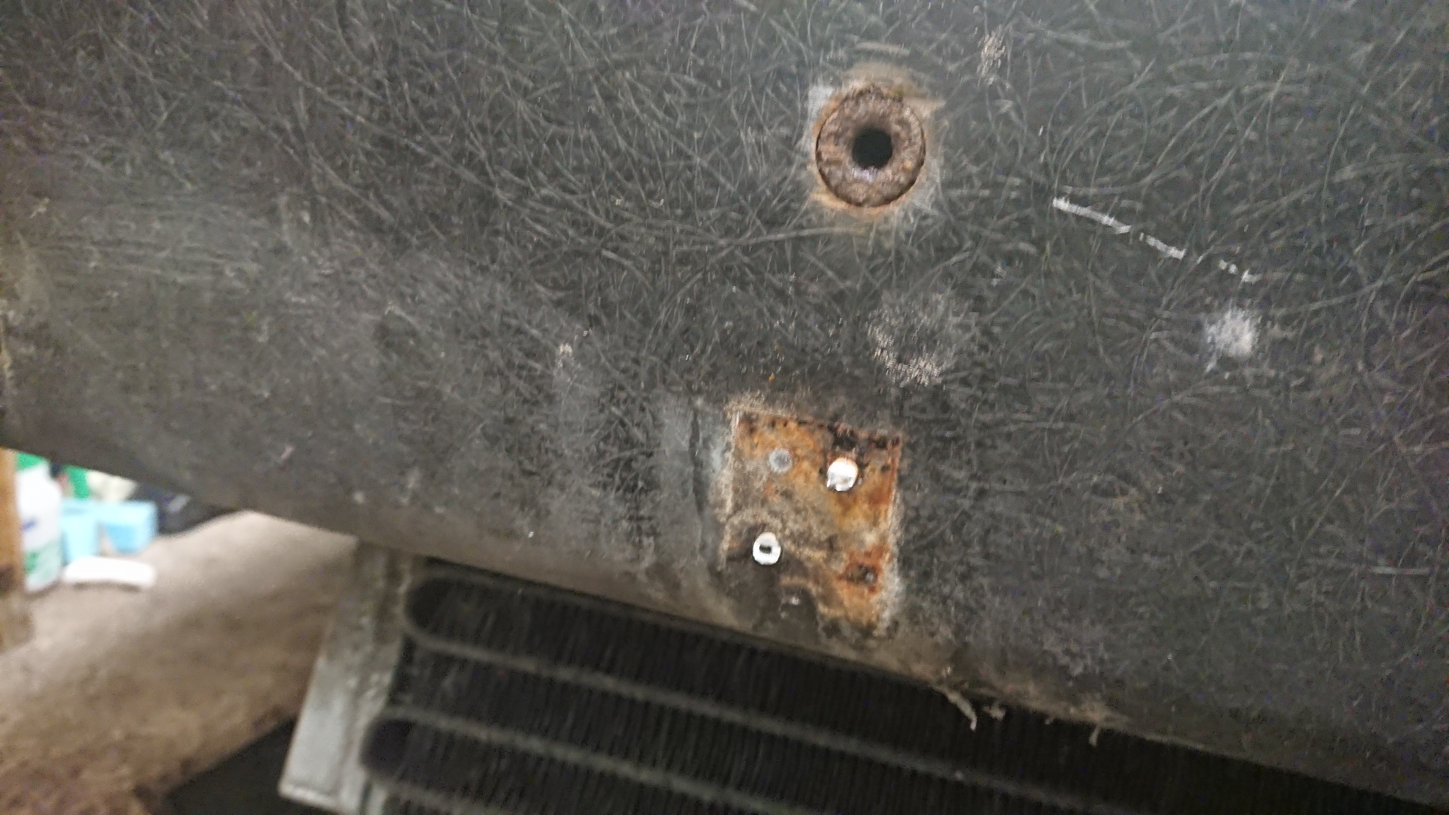

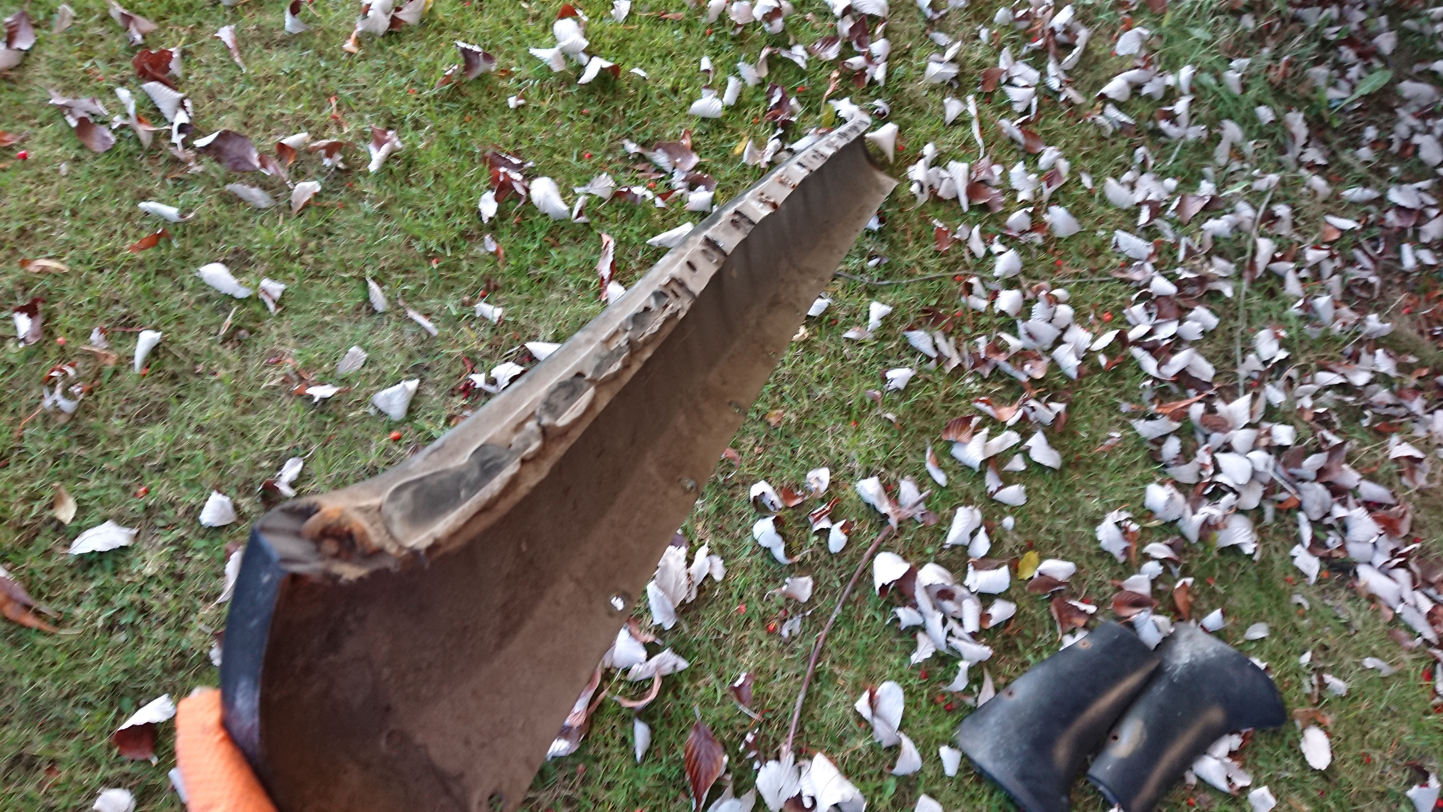

The infill panel on the driver side is damaged not sure how

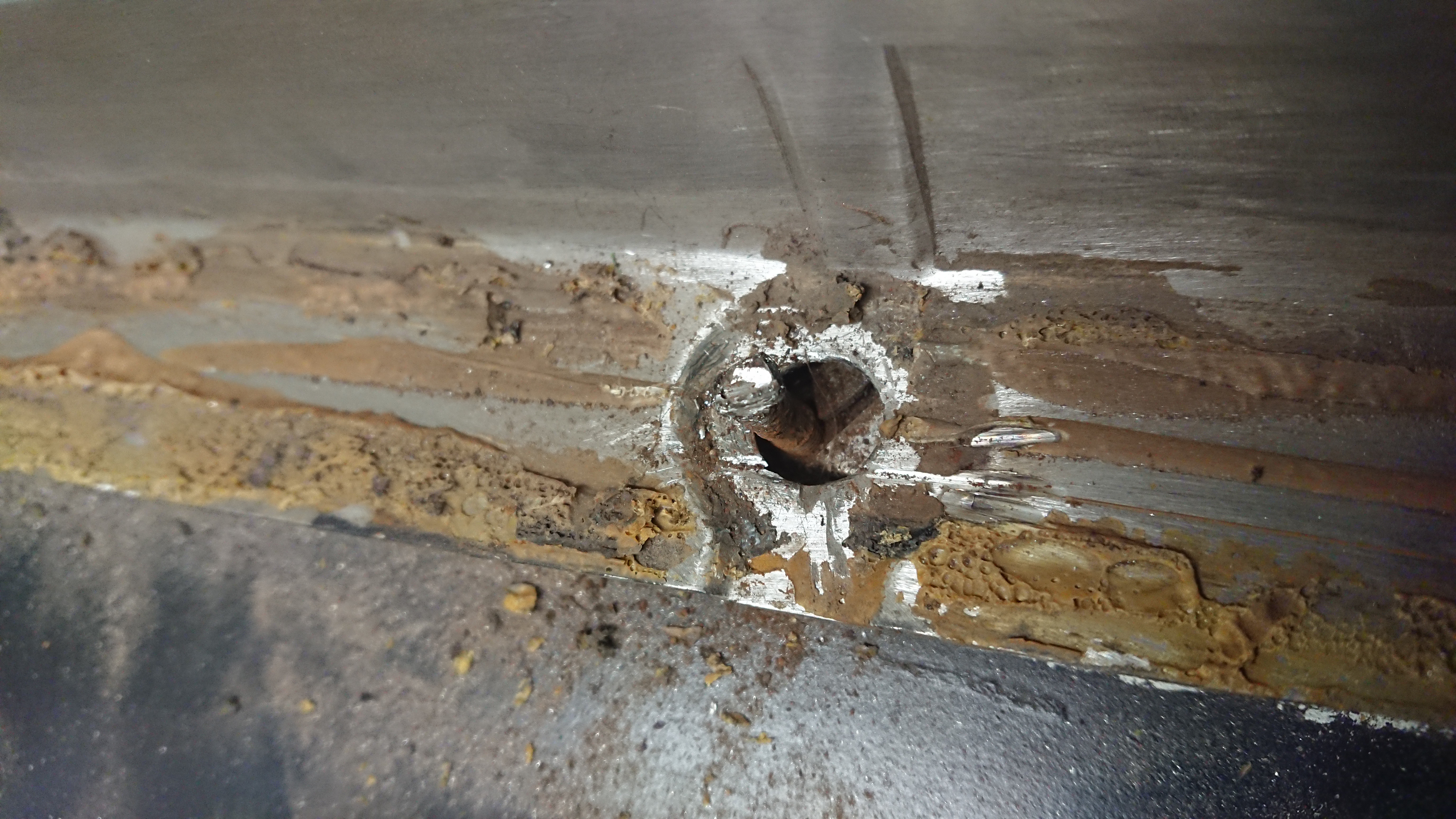

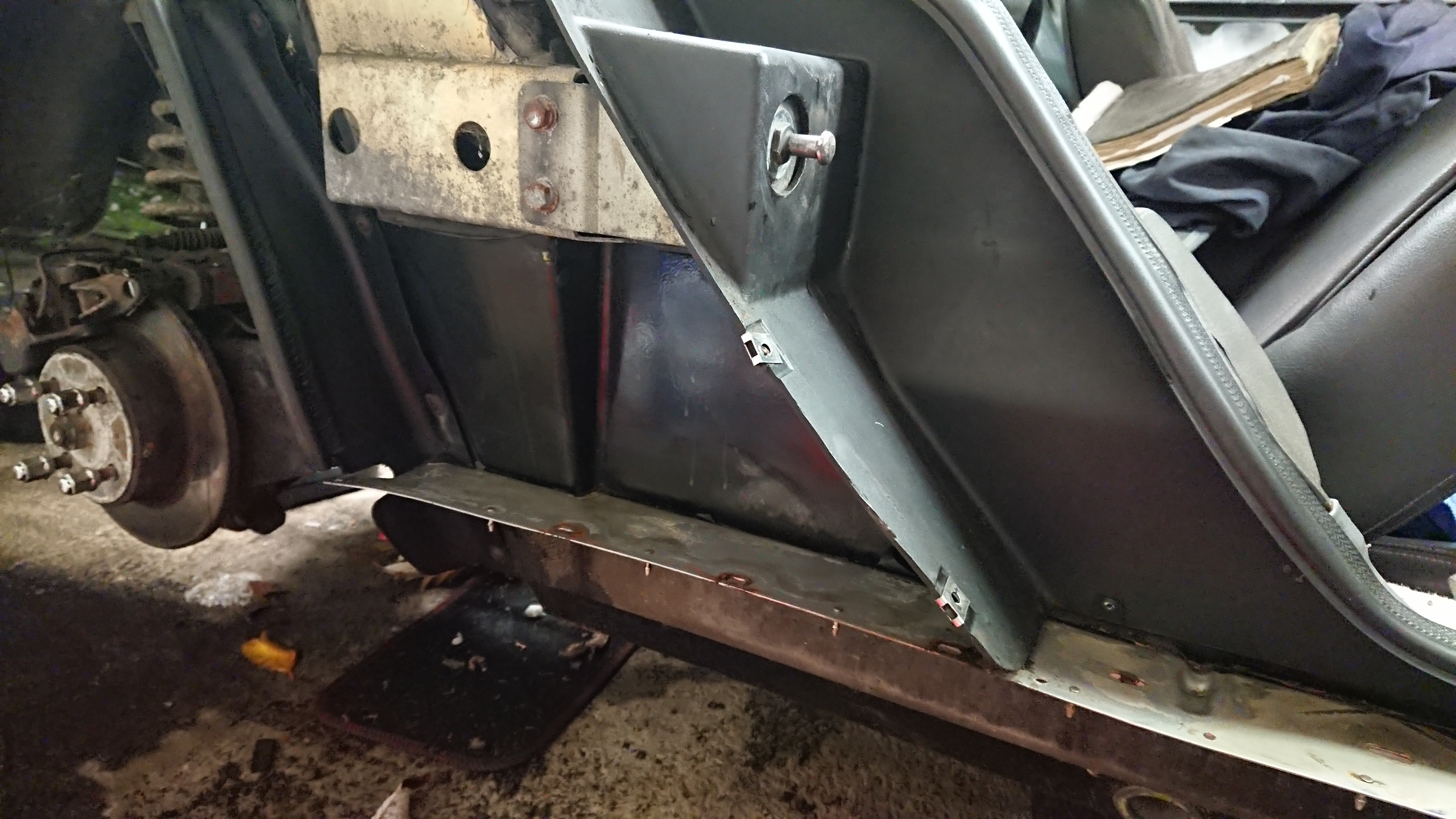

Postby cis6409 » Thu Dec 27, 2018 11:06 pm

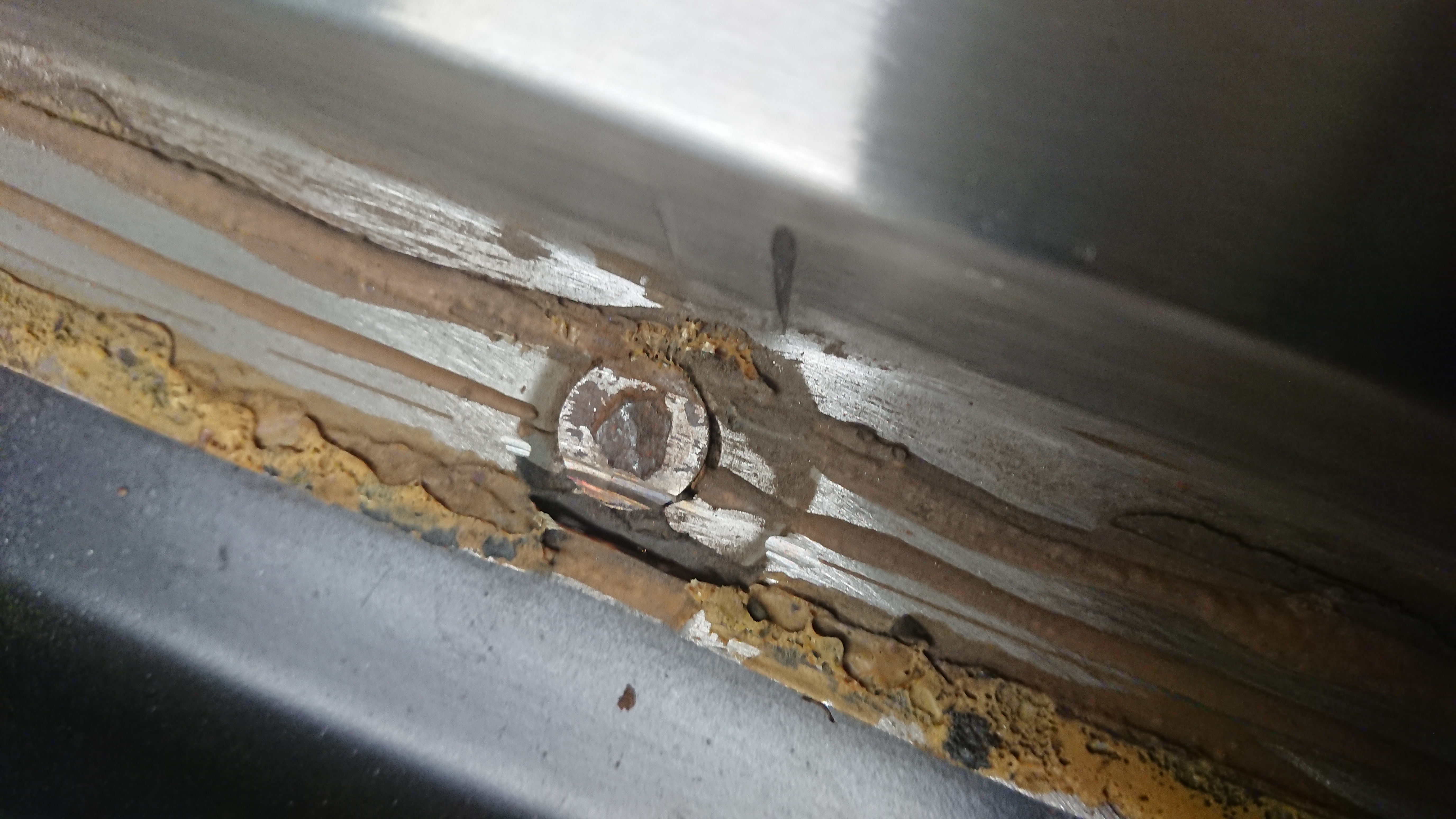

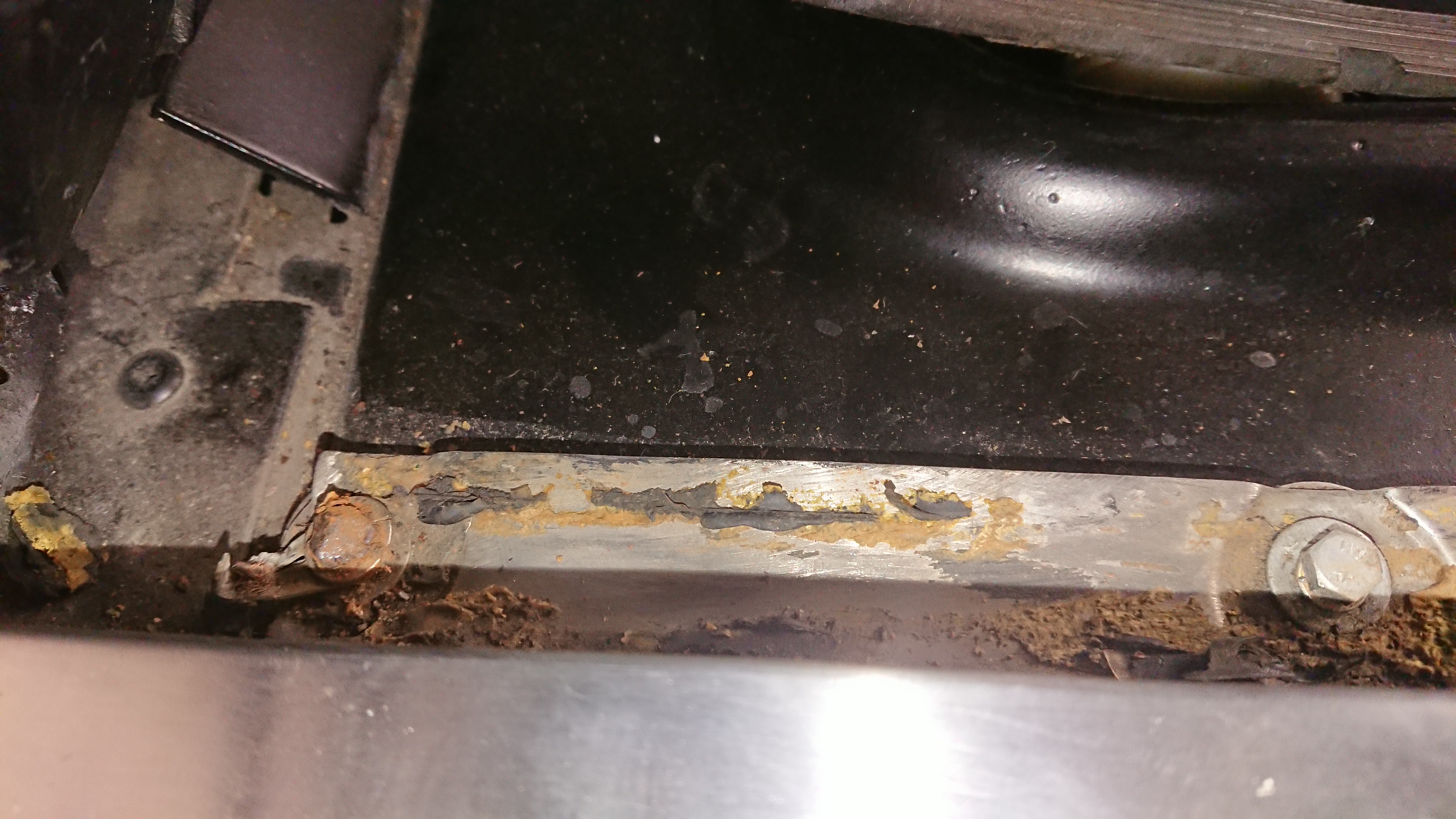

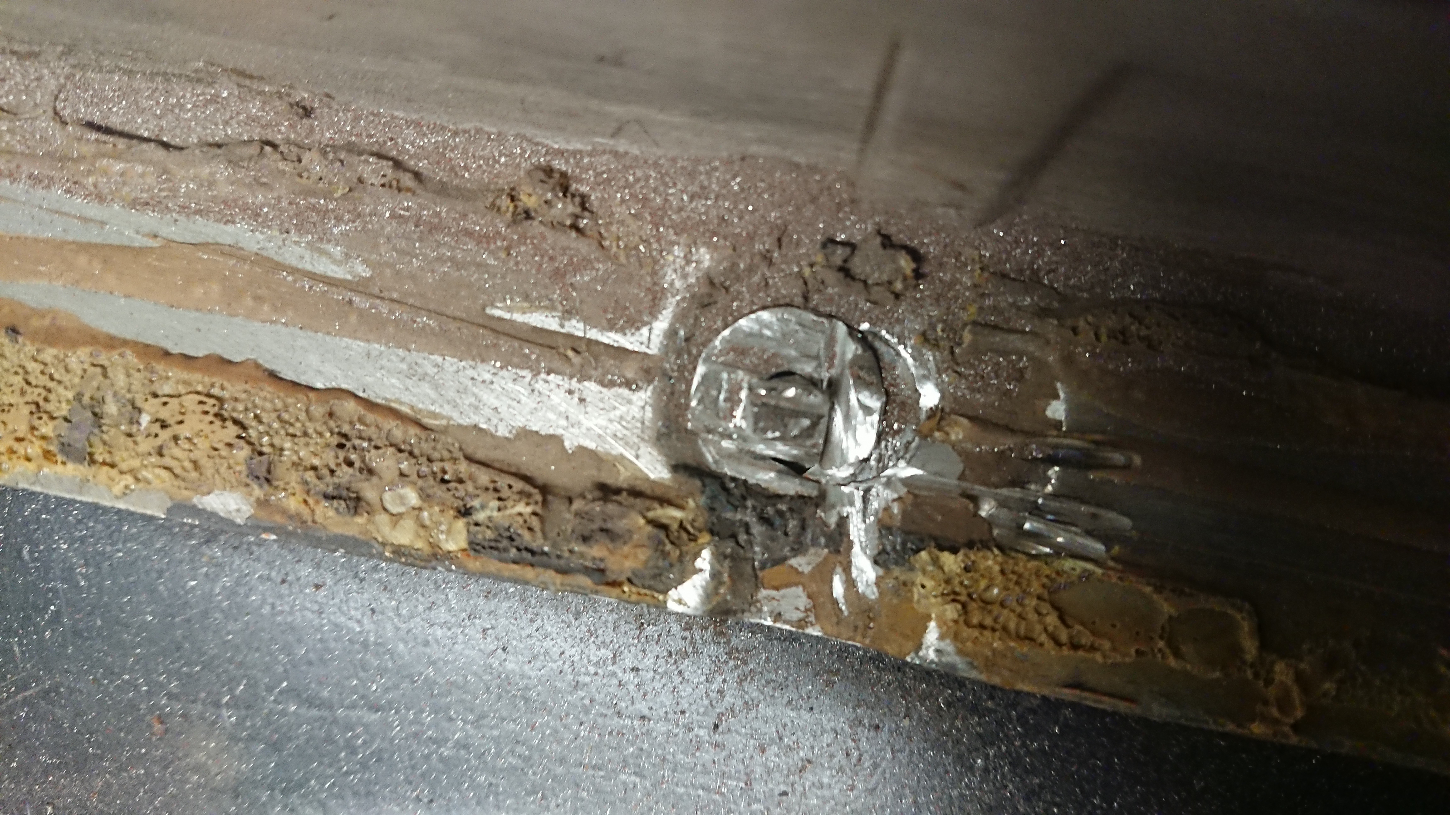

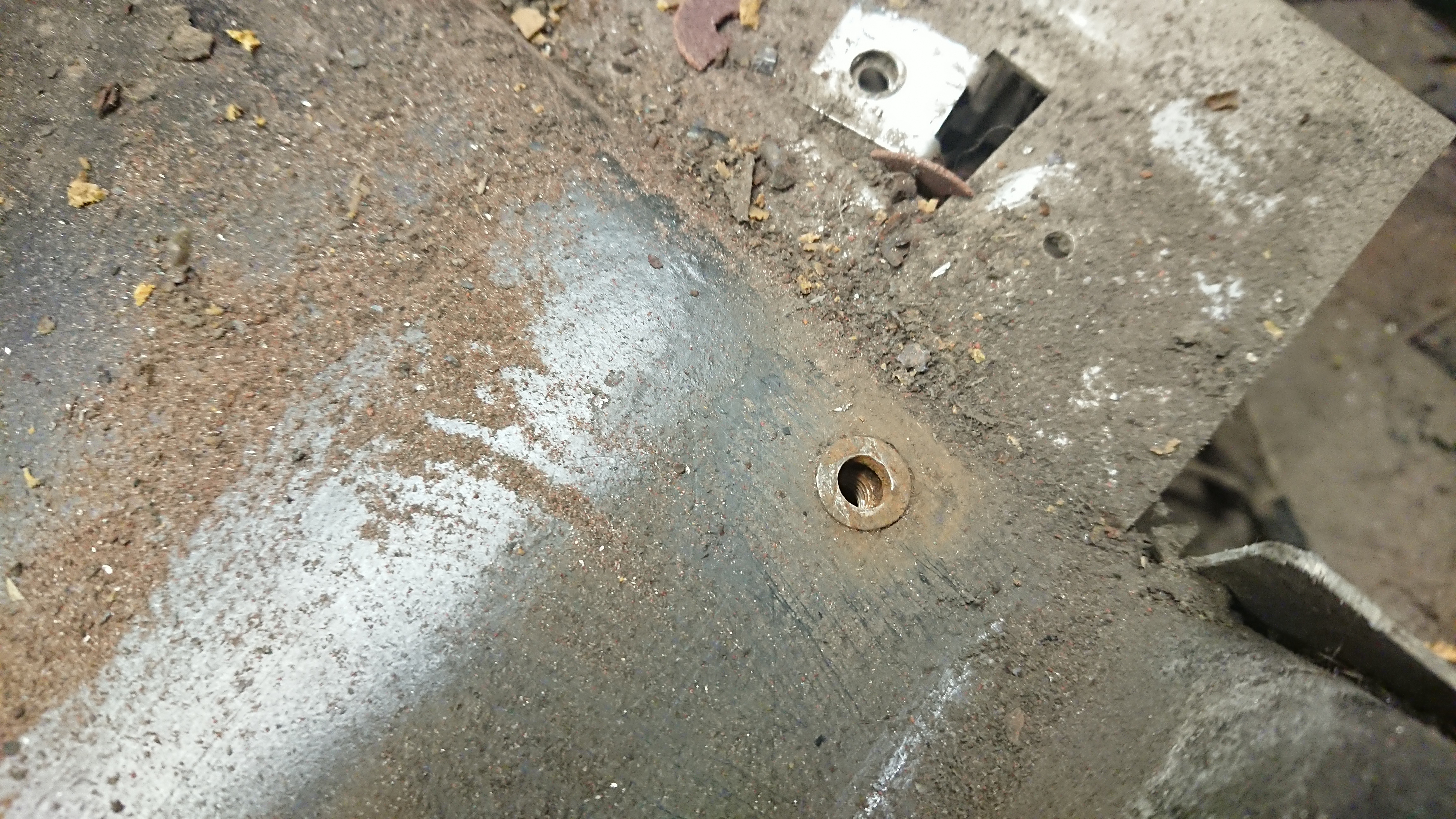

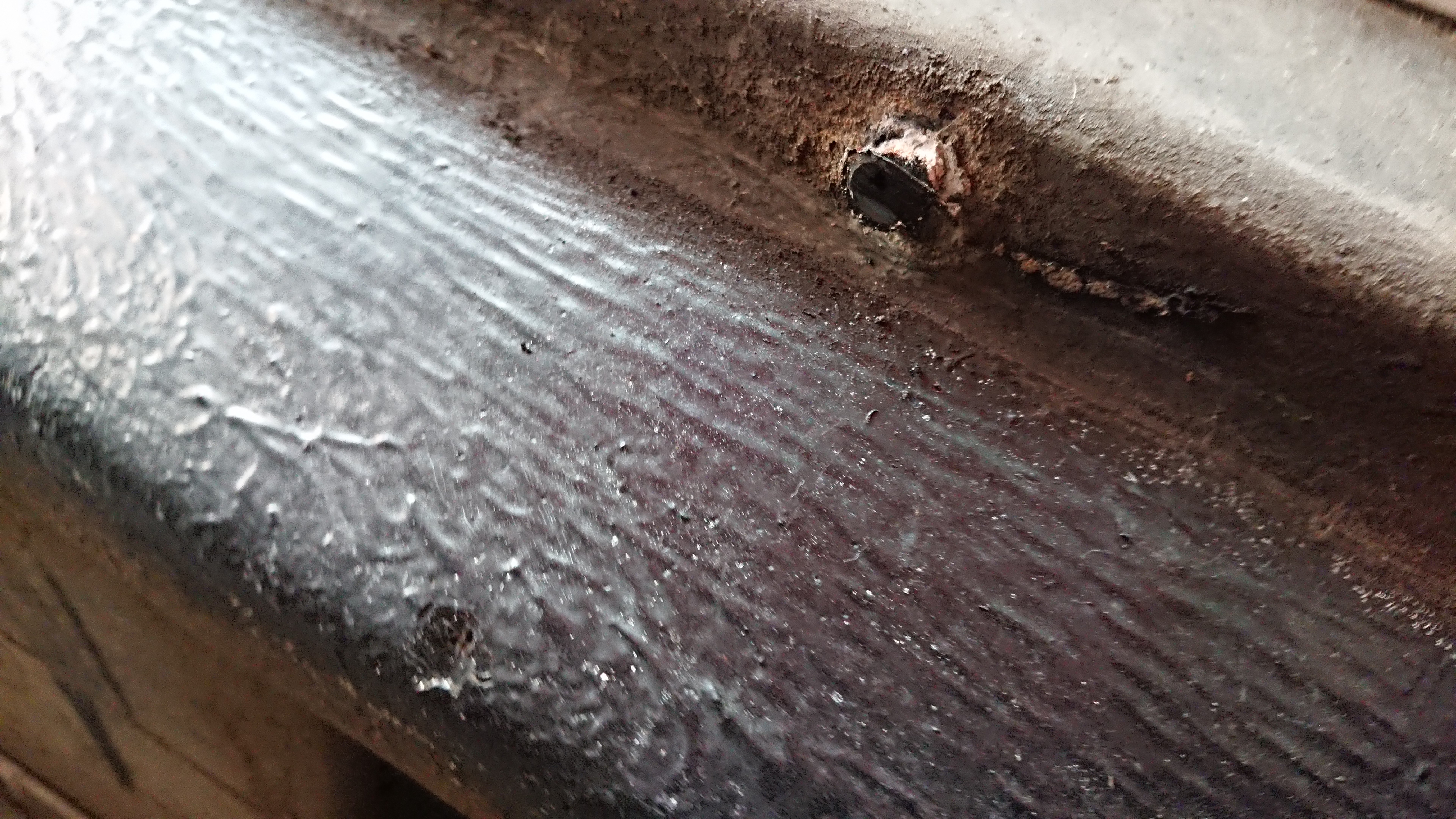

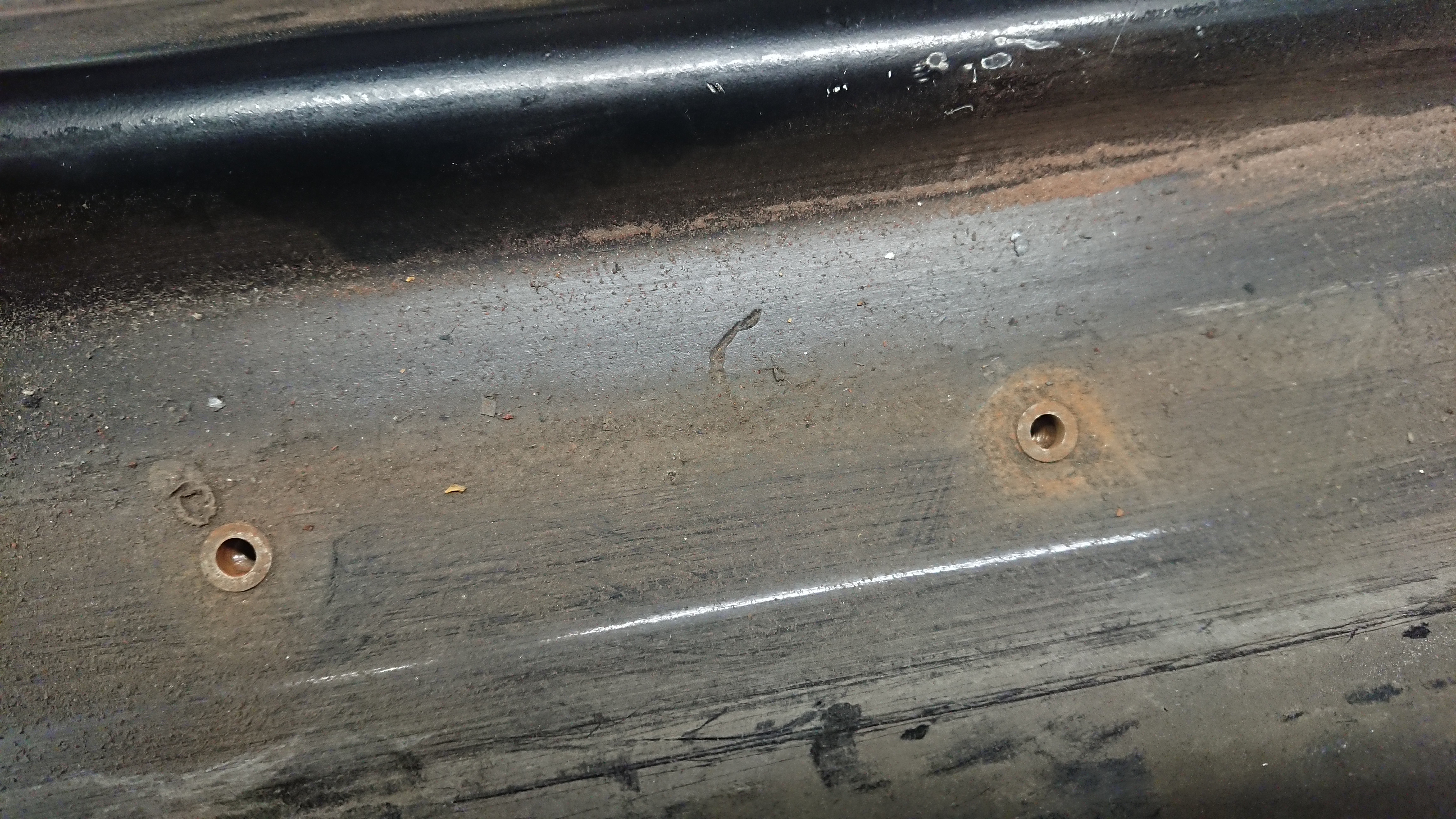

On to the rocker panels these will all be replaced but man those sill rockers were welded on! Nearly all of them are seized into the rivnut. Not sure how I gonna get them out without any of them spinning :doh:
Welcome to any suggestions, drill them I presume?
Sill panel seized screws

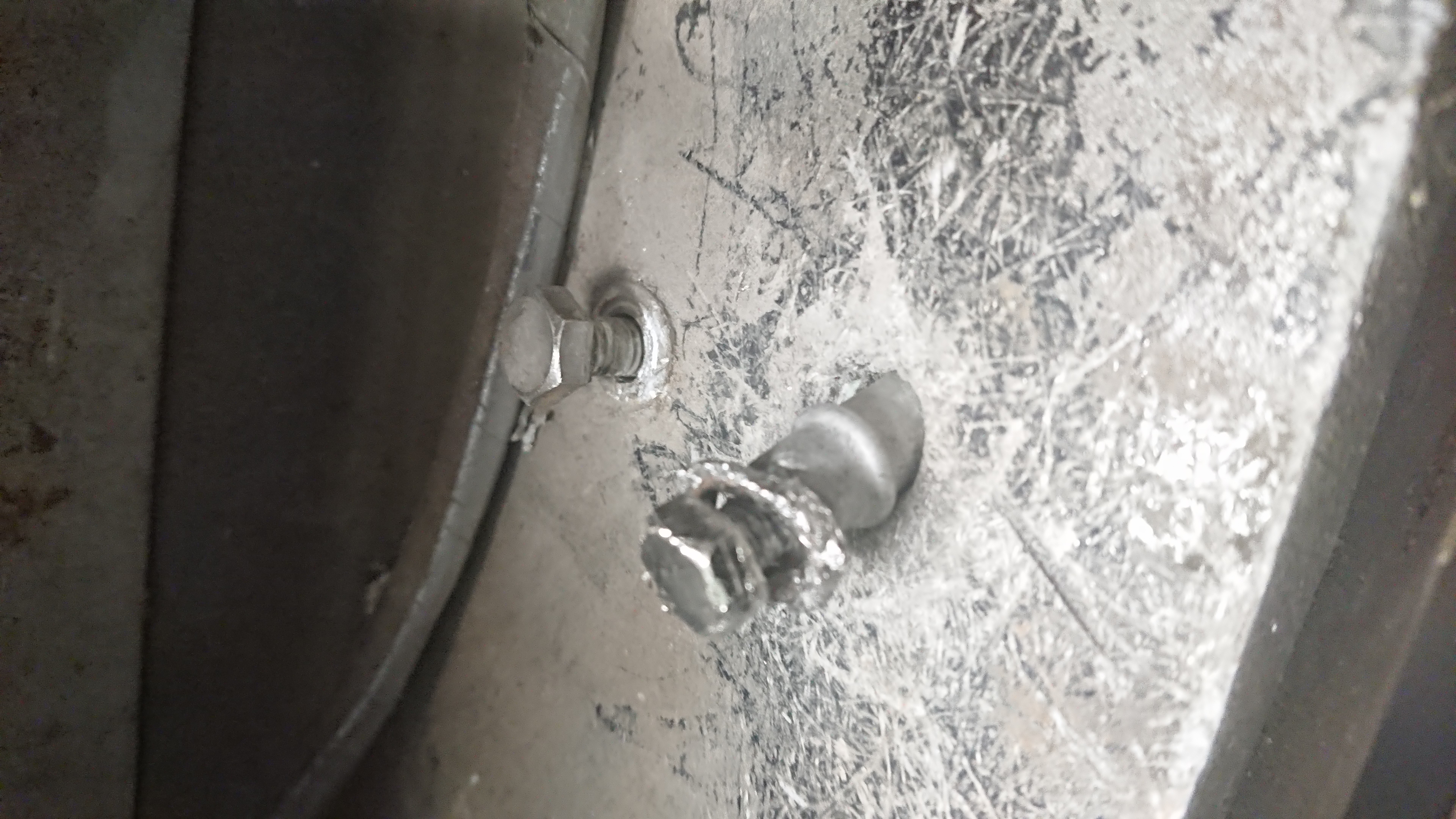

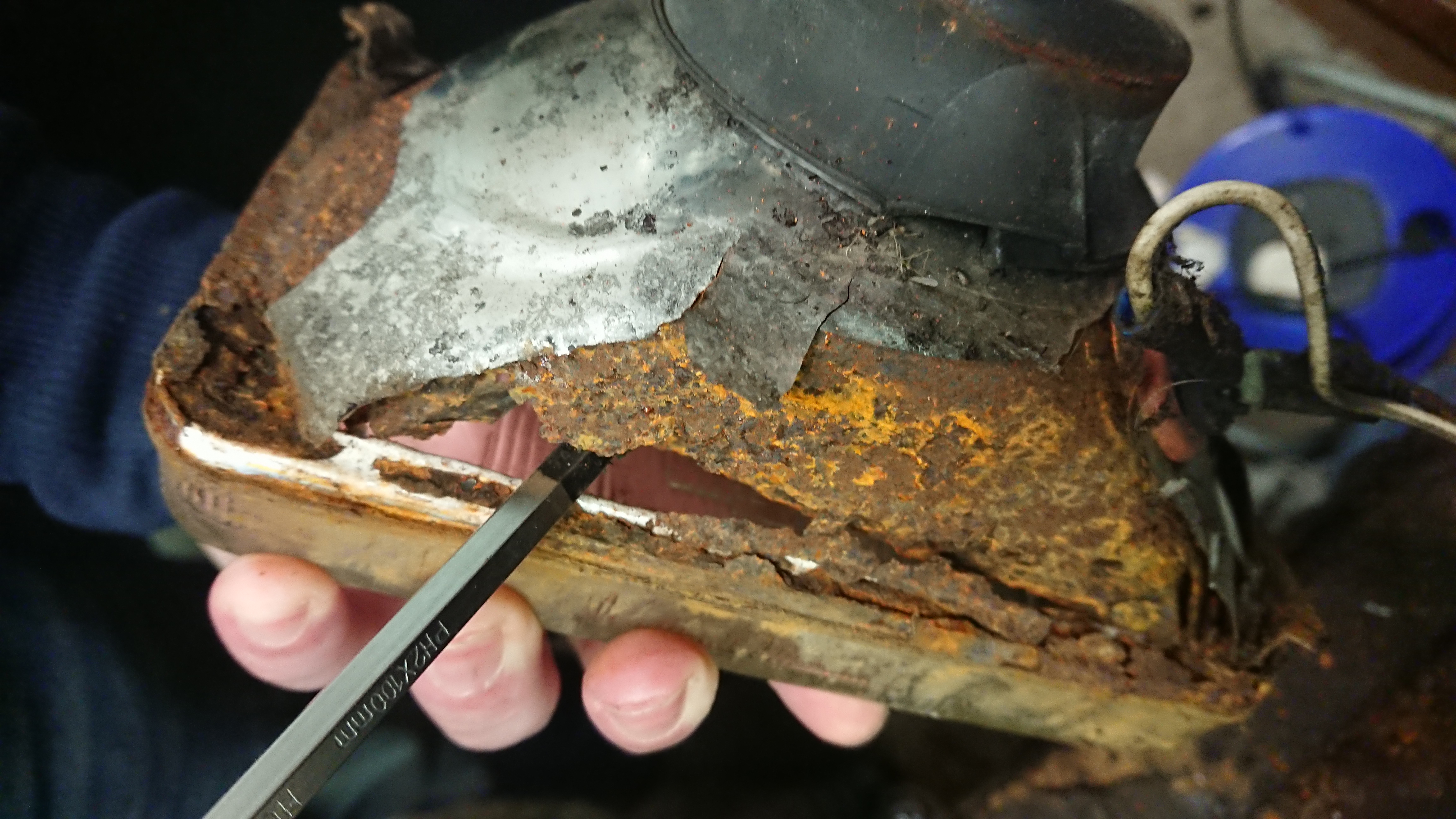

Postby cis6409 » Thu Dec 27, 2018 11:16 pm

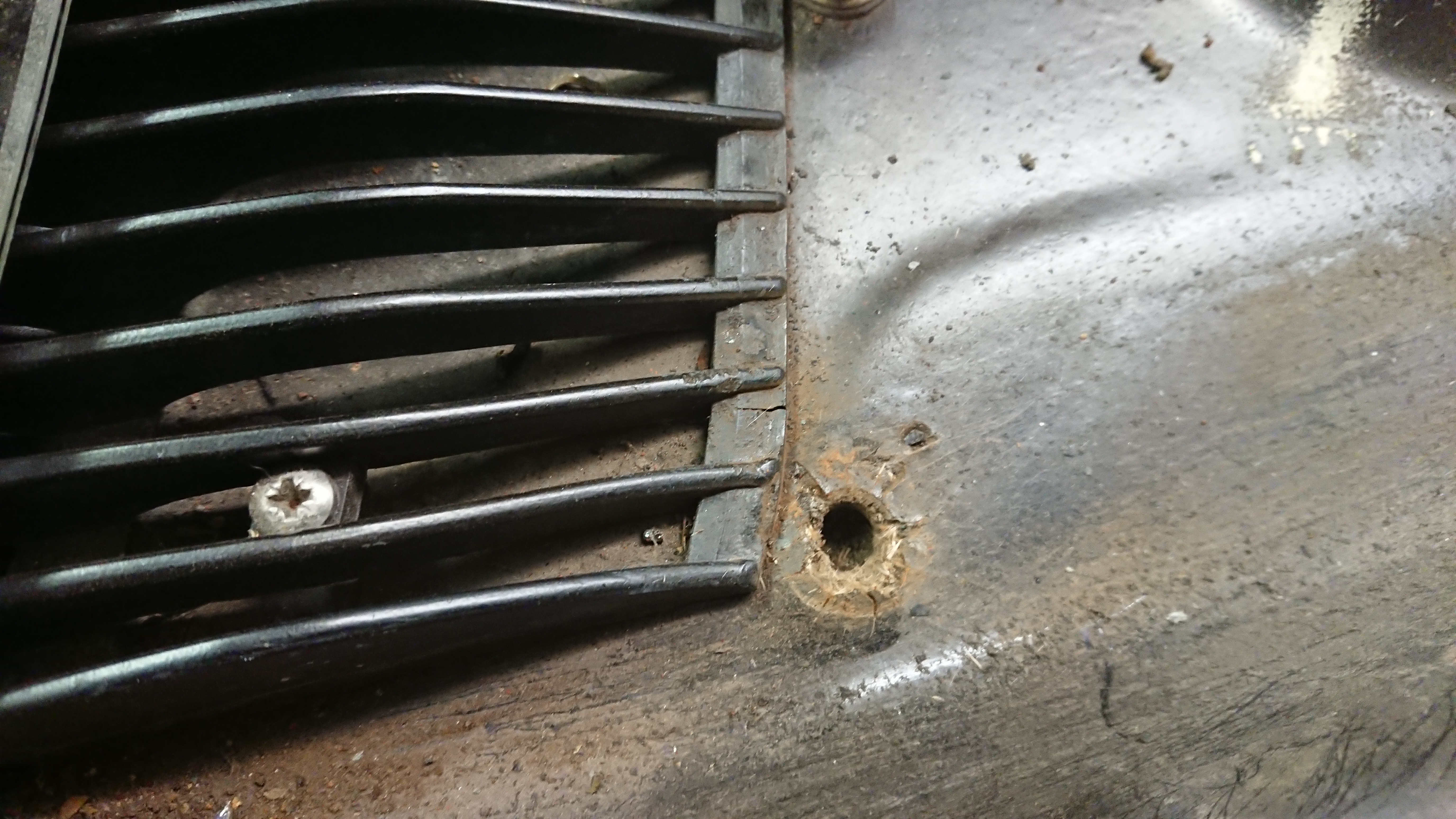

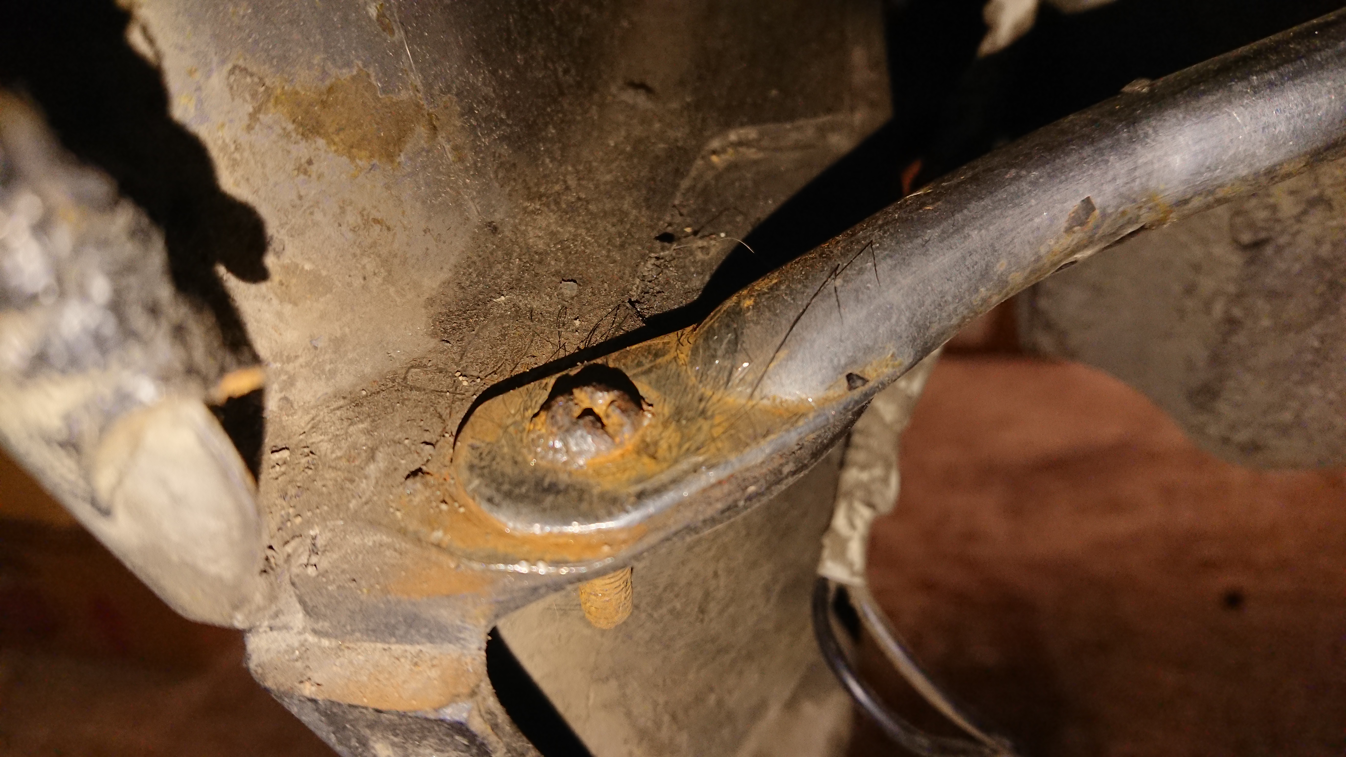

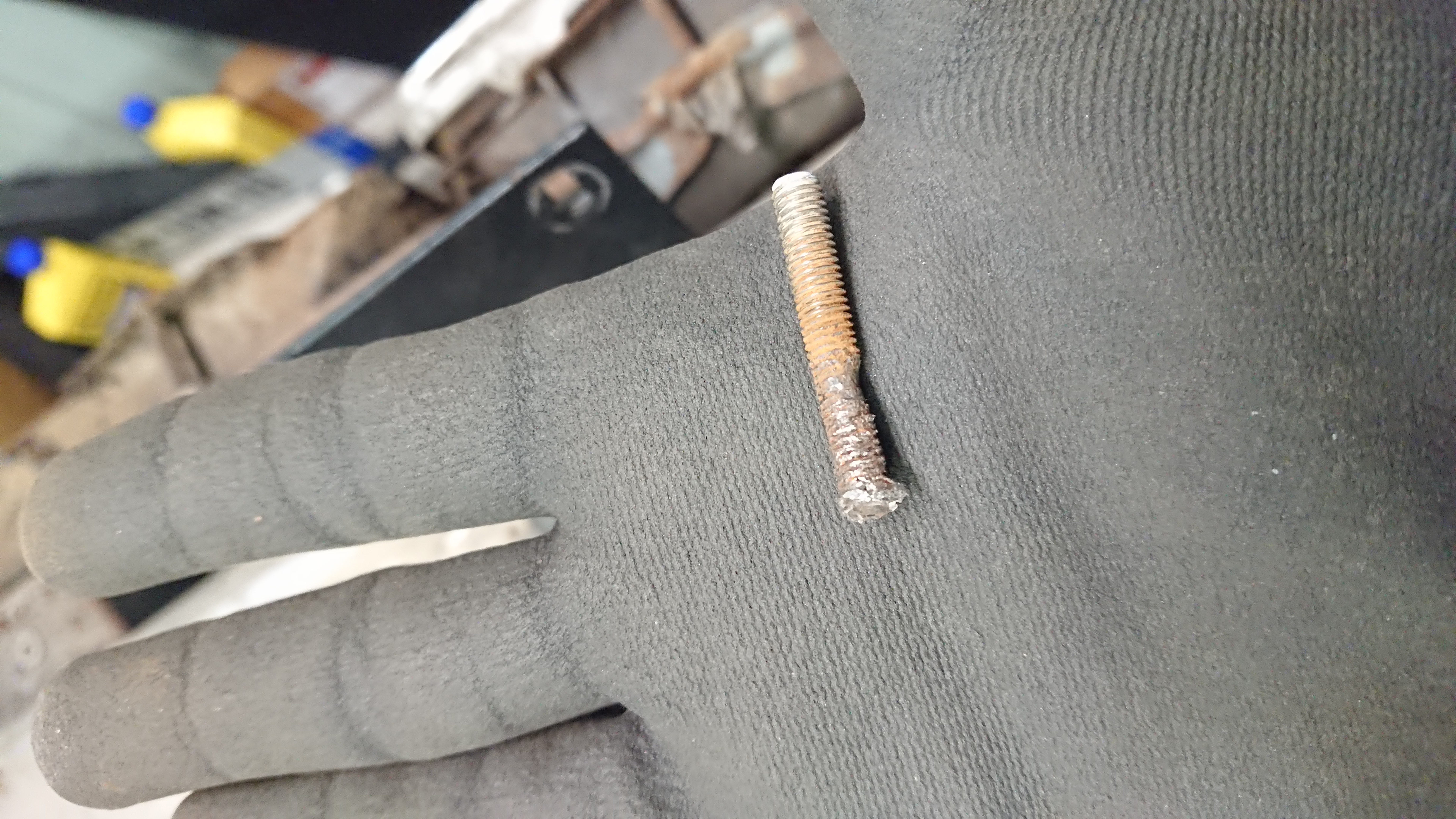

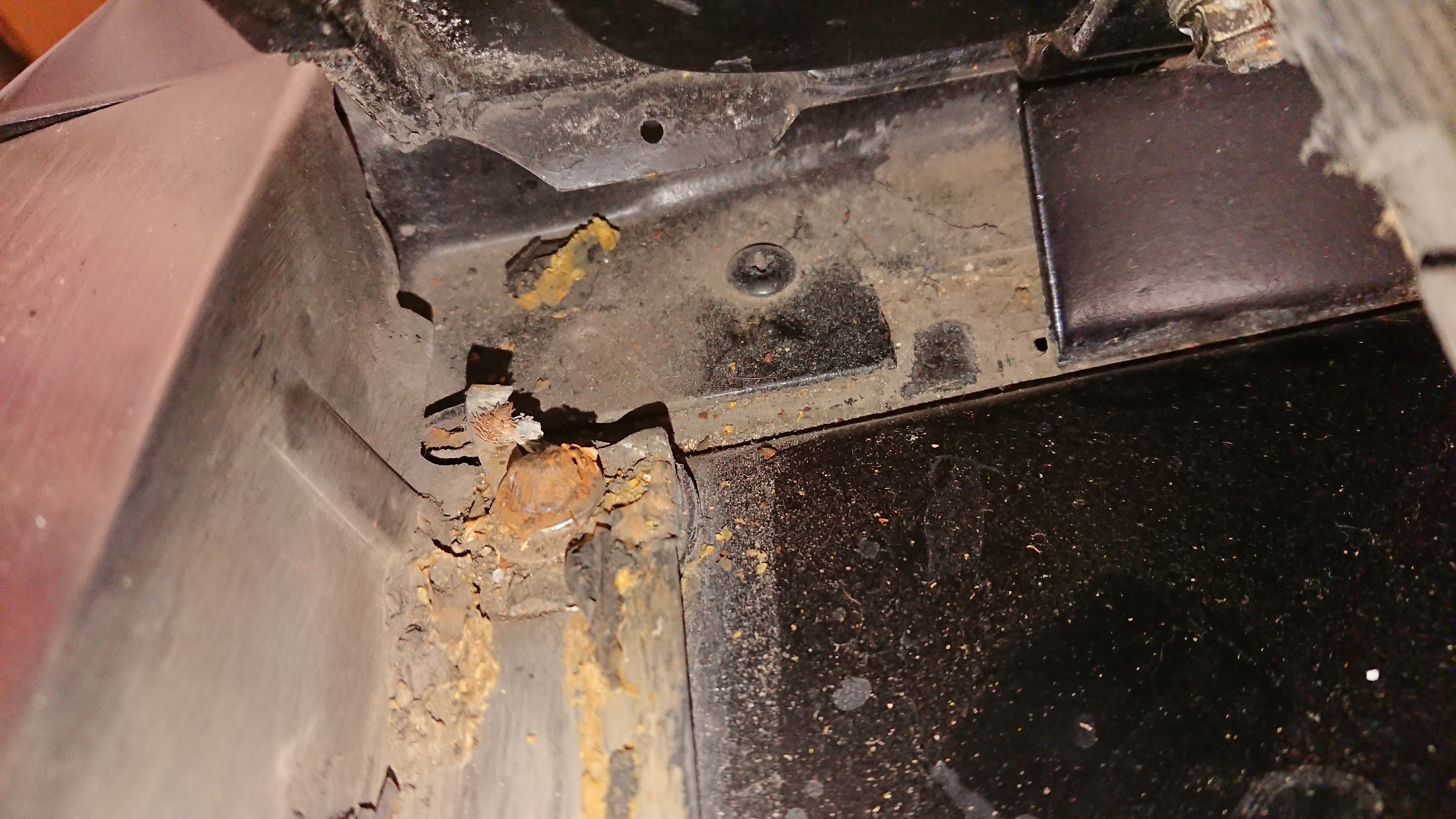

More seized and rusted mutated screws and bolts as I worked my way up to the front facia, spoiler and wings
This wing bolt is hardly recognisable! It's the one with the earth connection for that panel

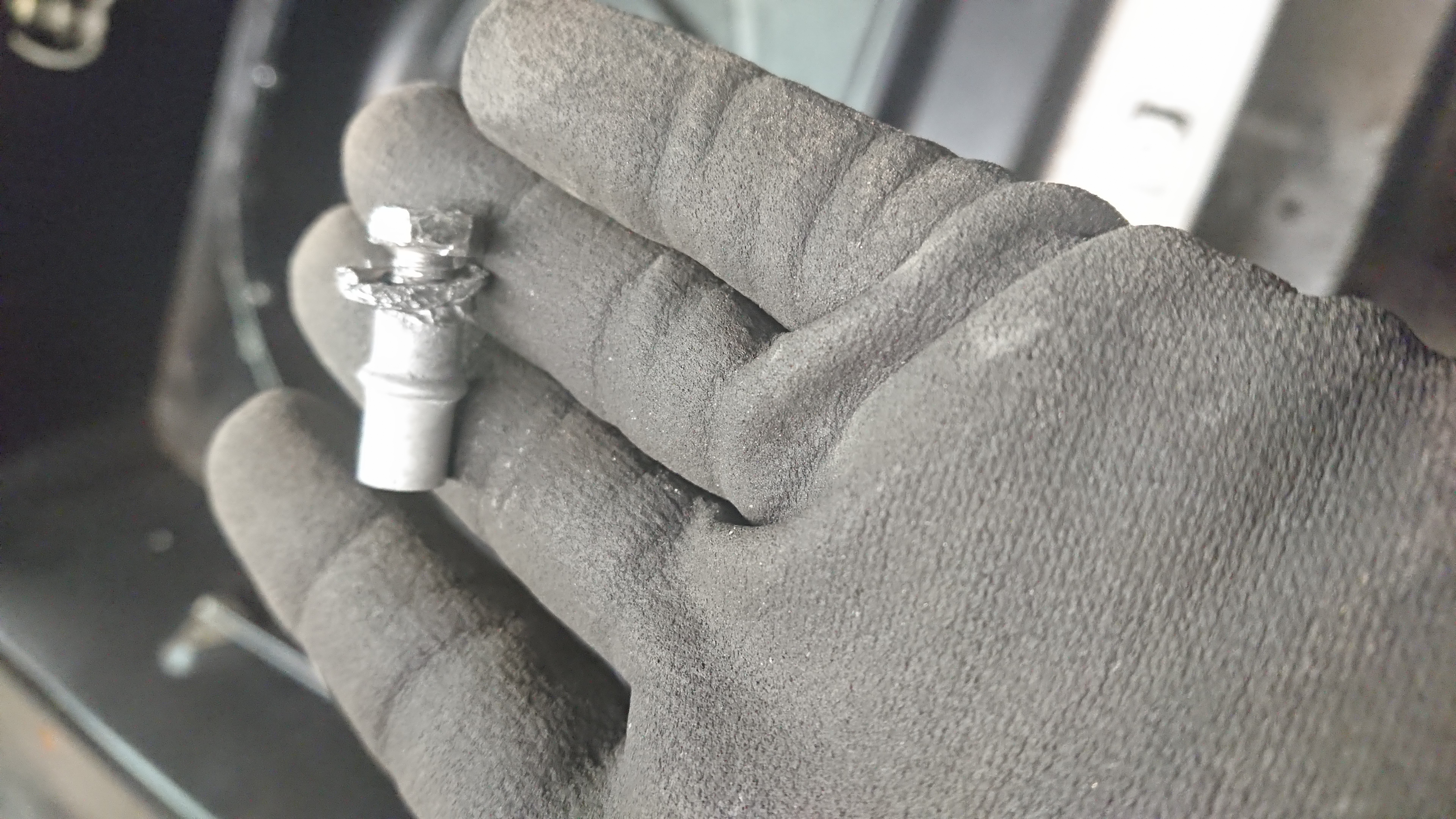

This m5 eventually lost its battle to me but only after half a day of continuous gentle persuasion!

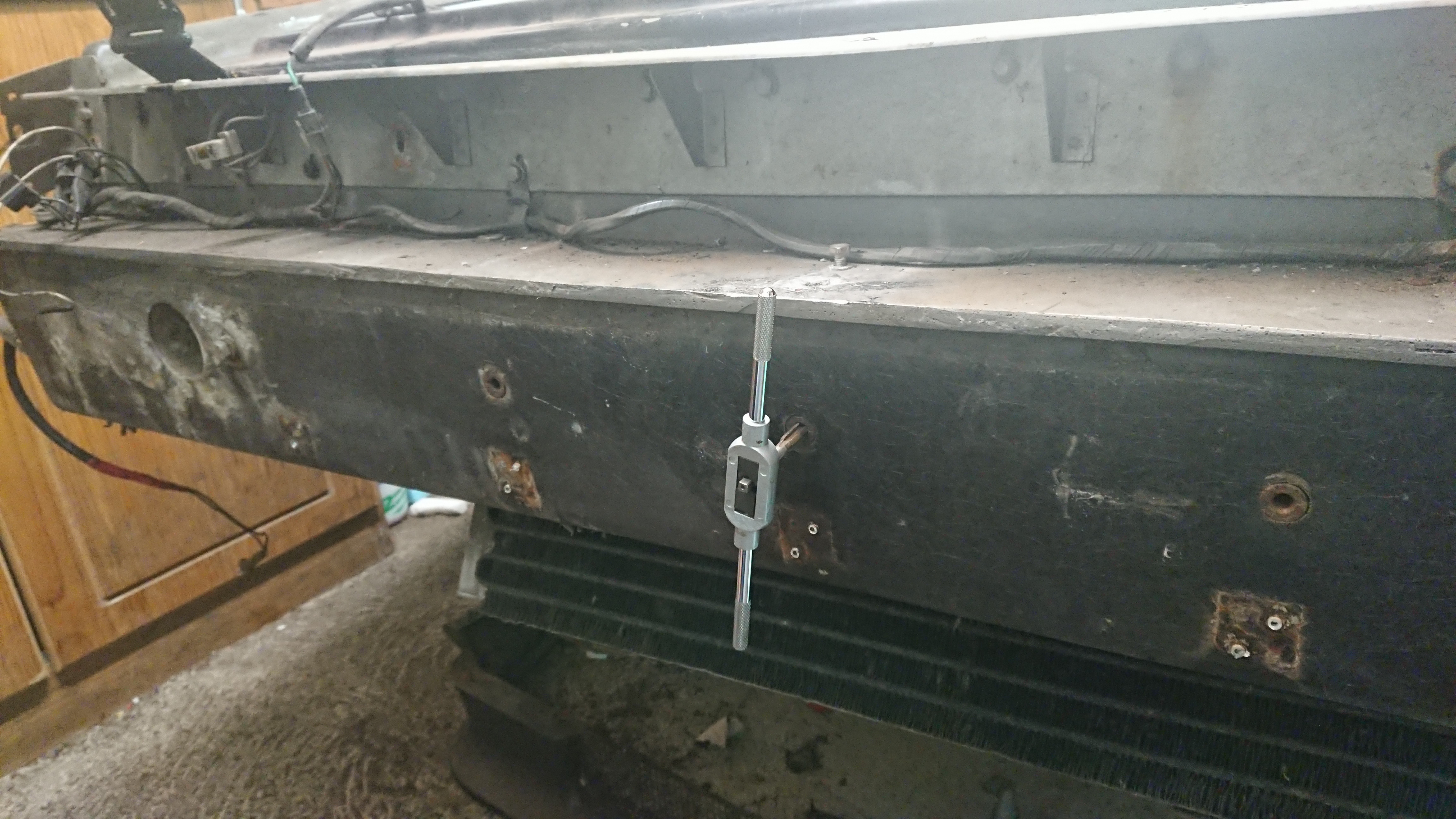

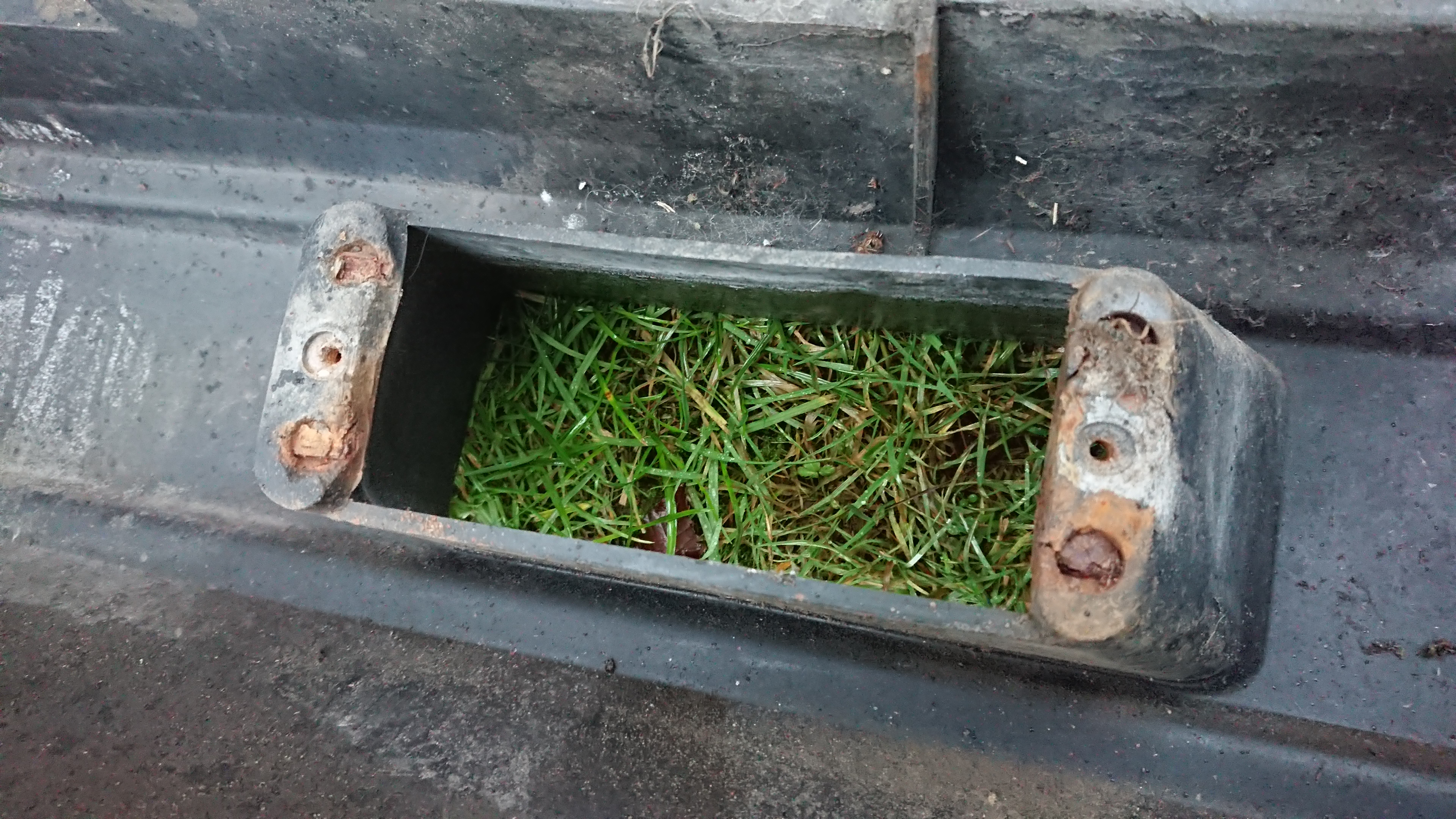

Front crash foam only held on by 2 bolts other mounting holes need to be cleaned and thread chased m8 x1. 25

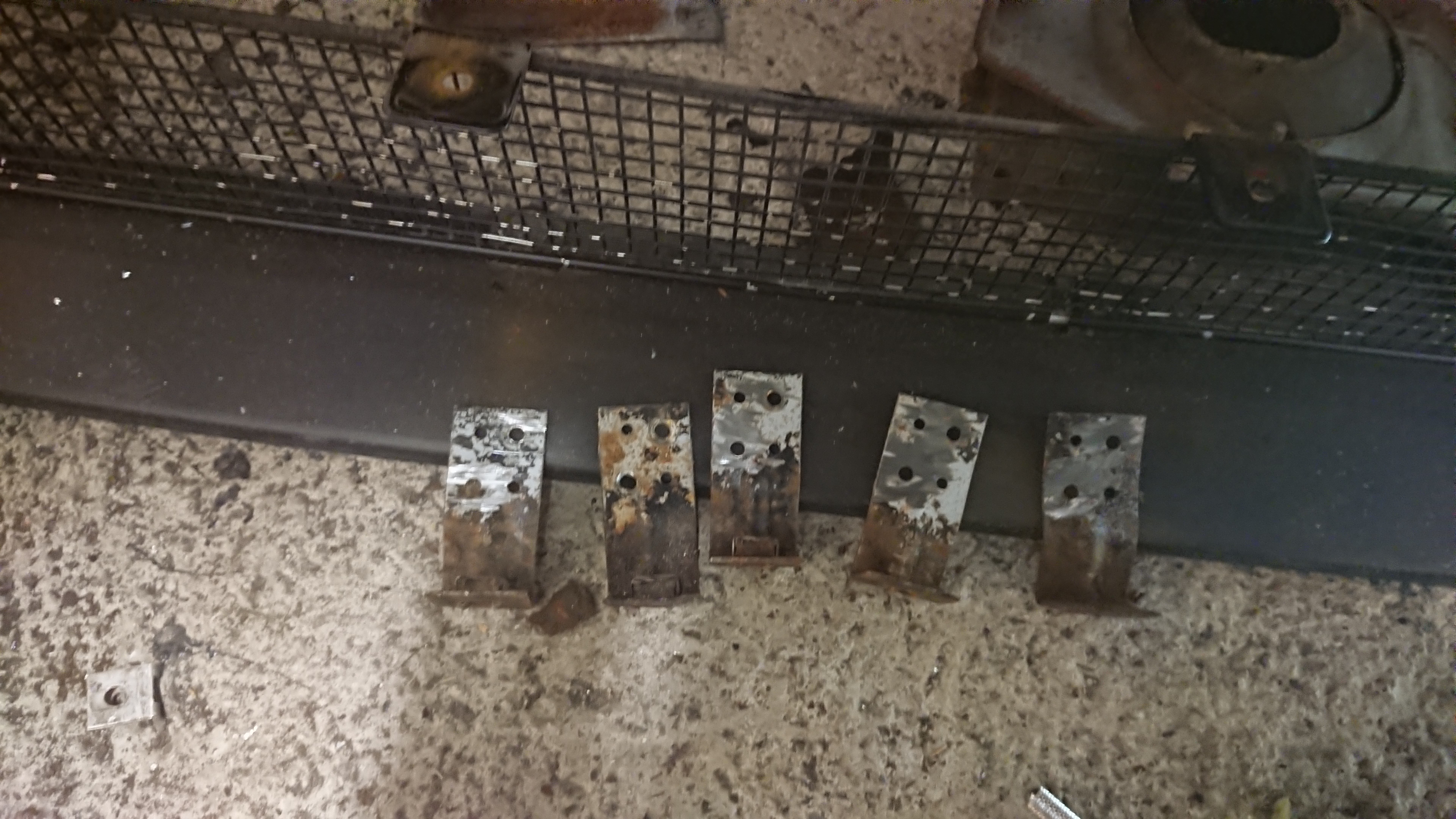

More rusty brackets to replace

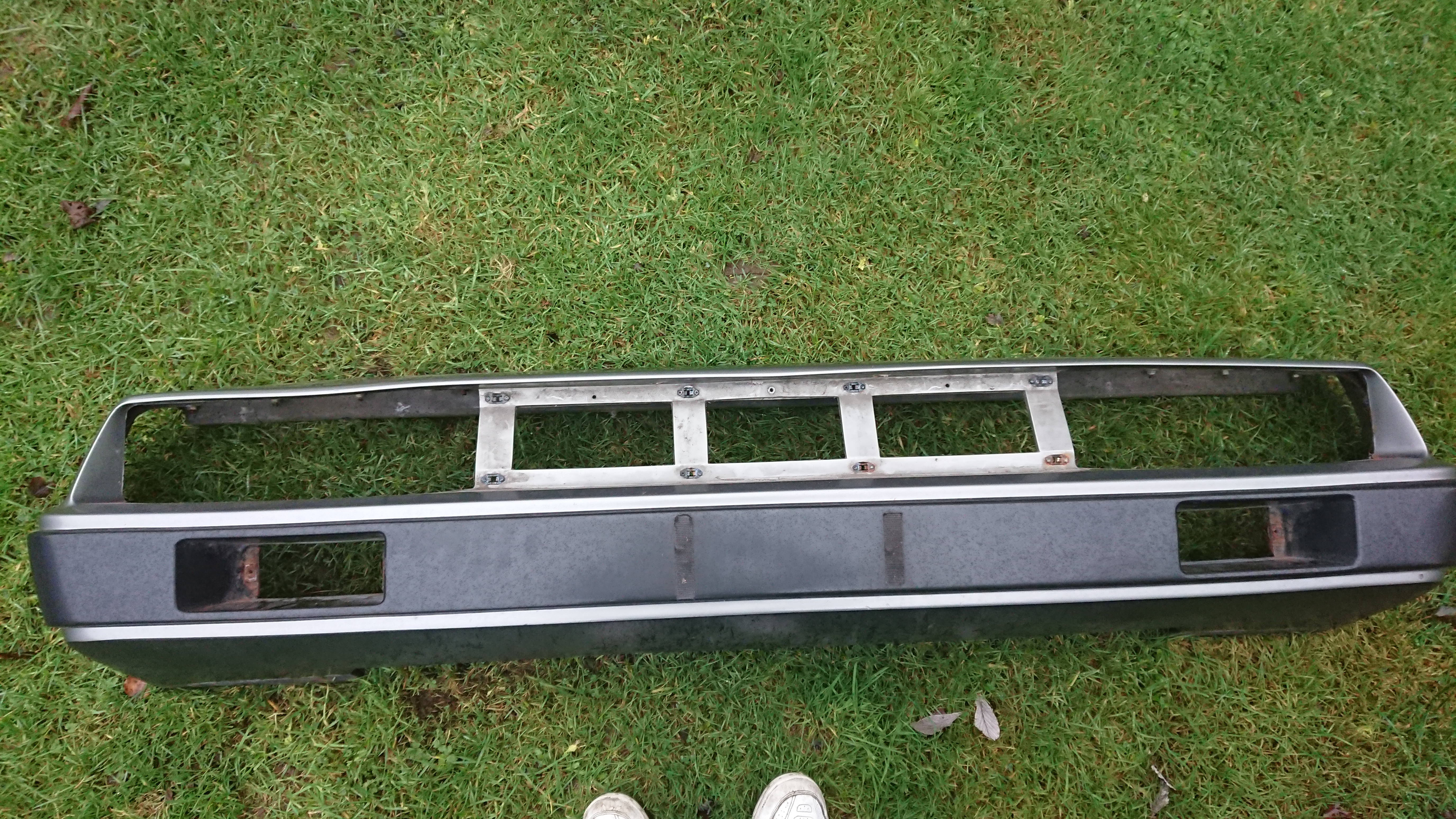

Re: One thing leads to another

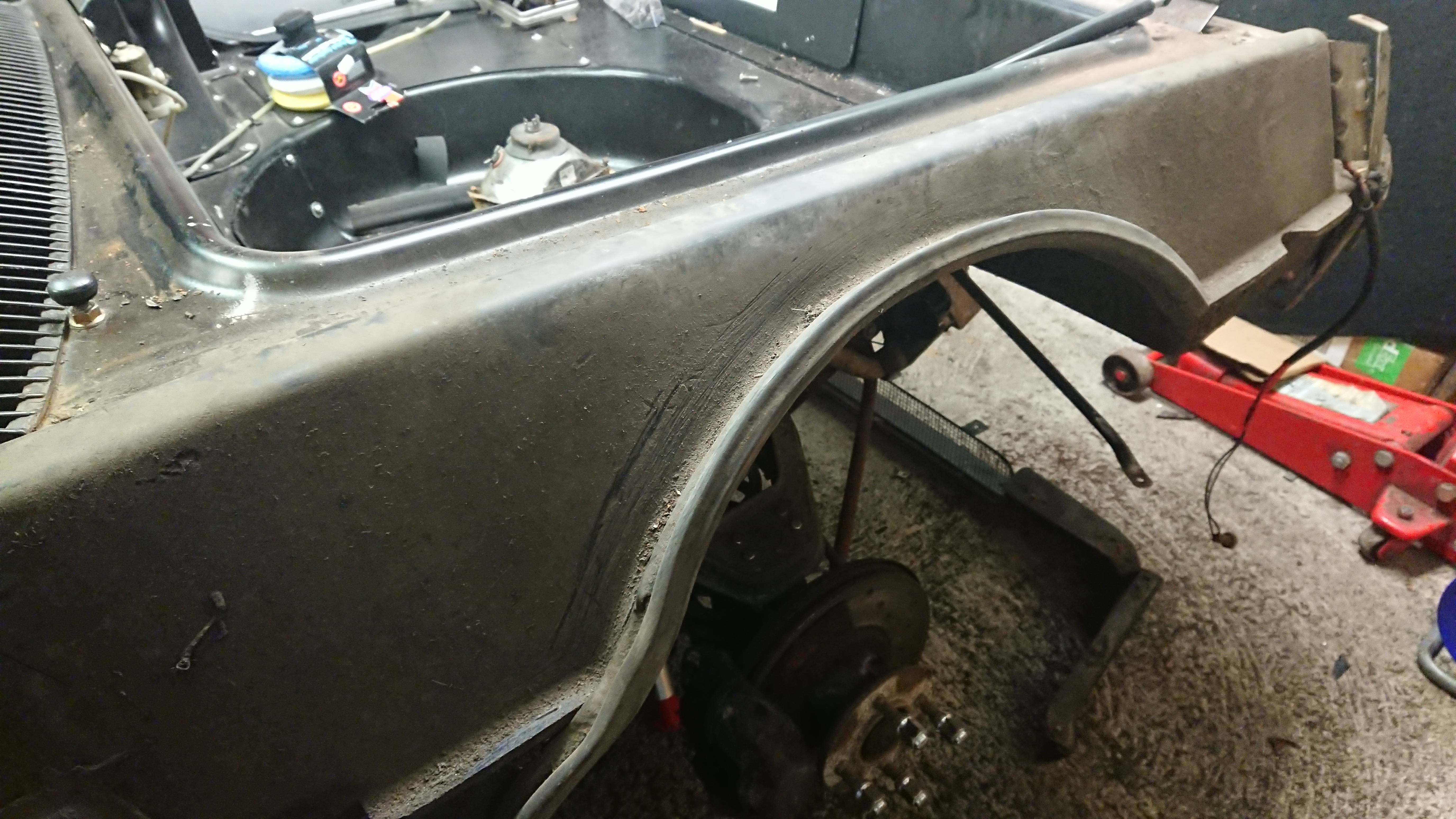

Postby cis6409 » Thu Dec 27, 2018 11:58 pm

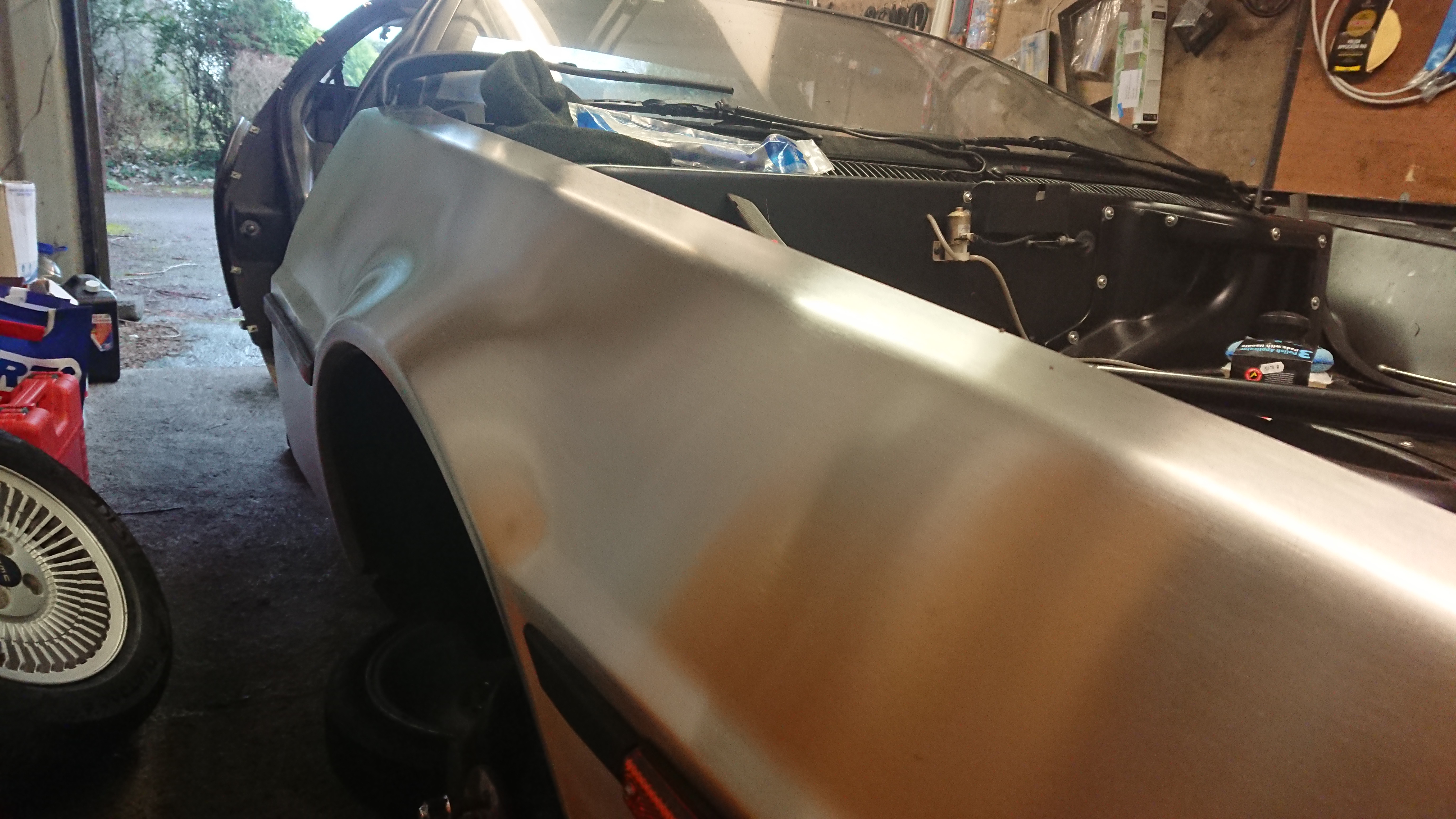

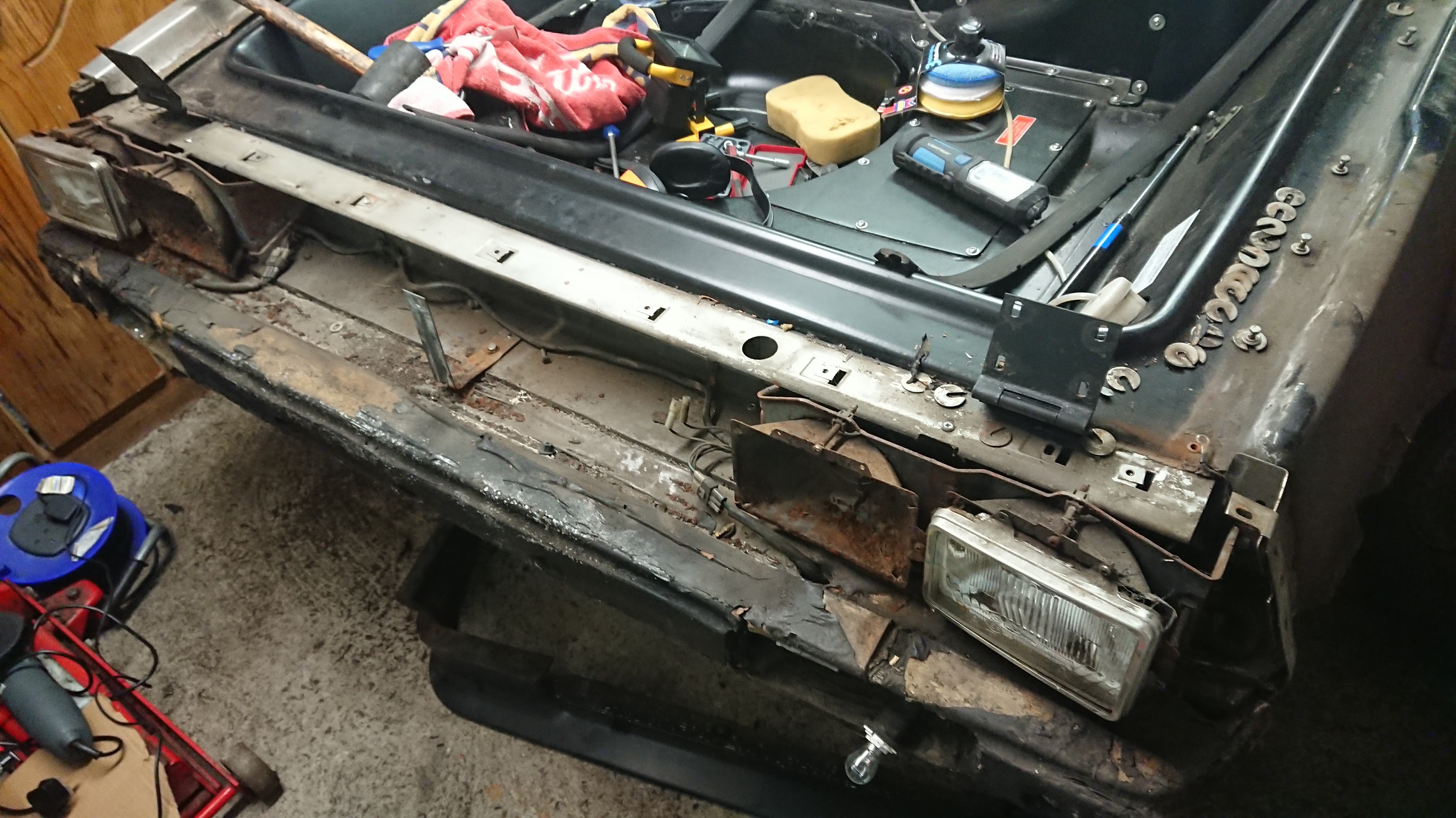

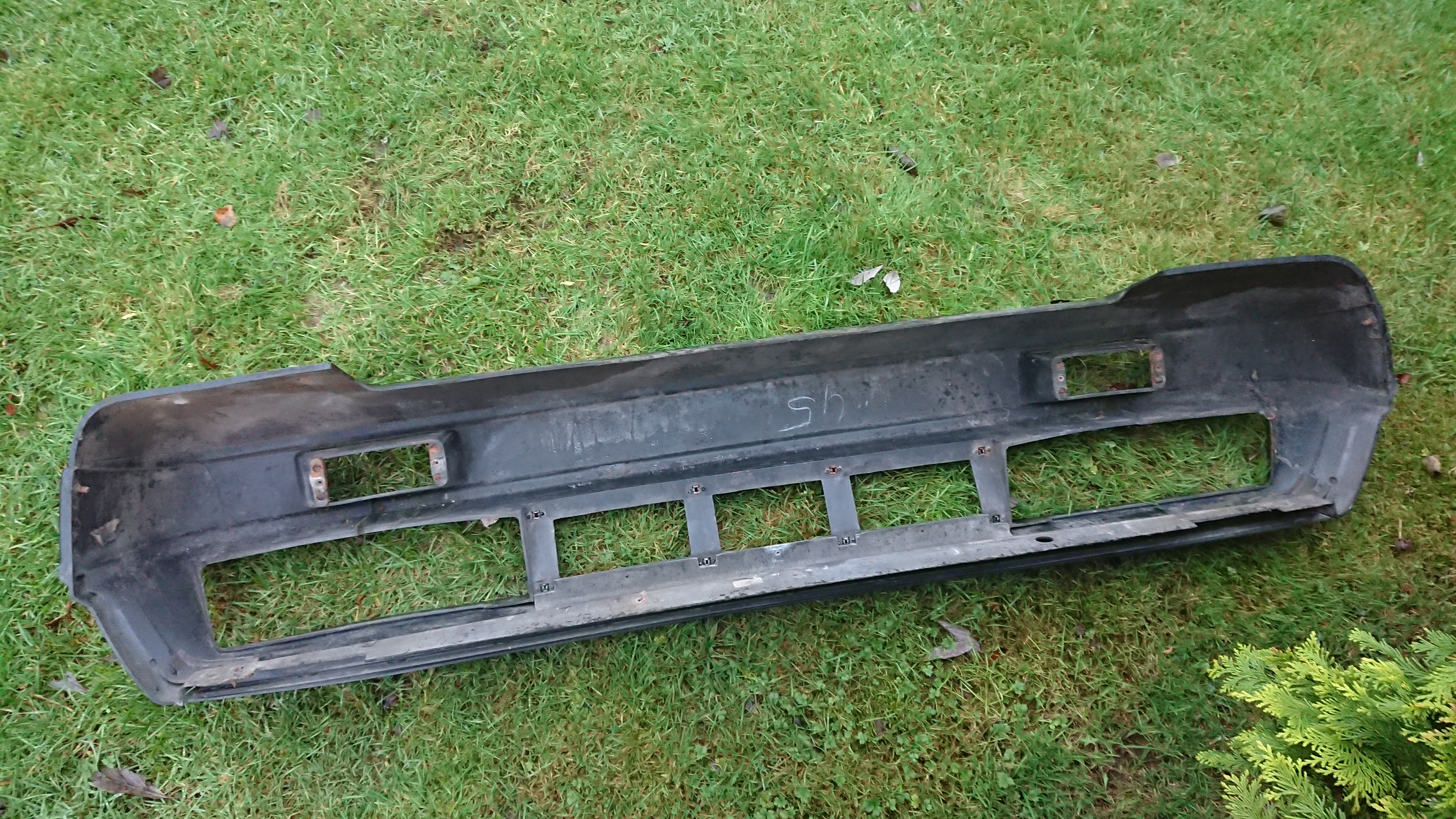

Facia and passenger Wing starting to come away

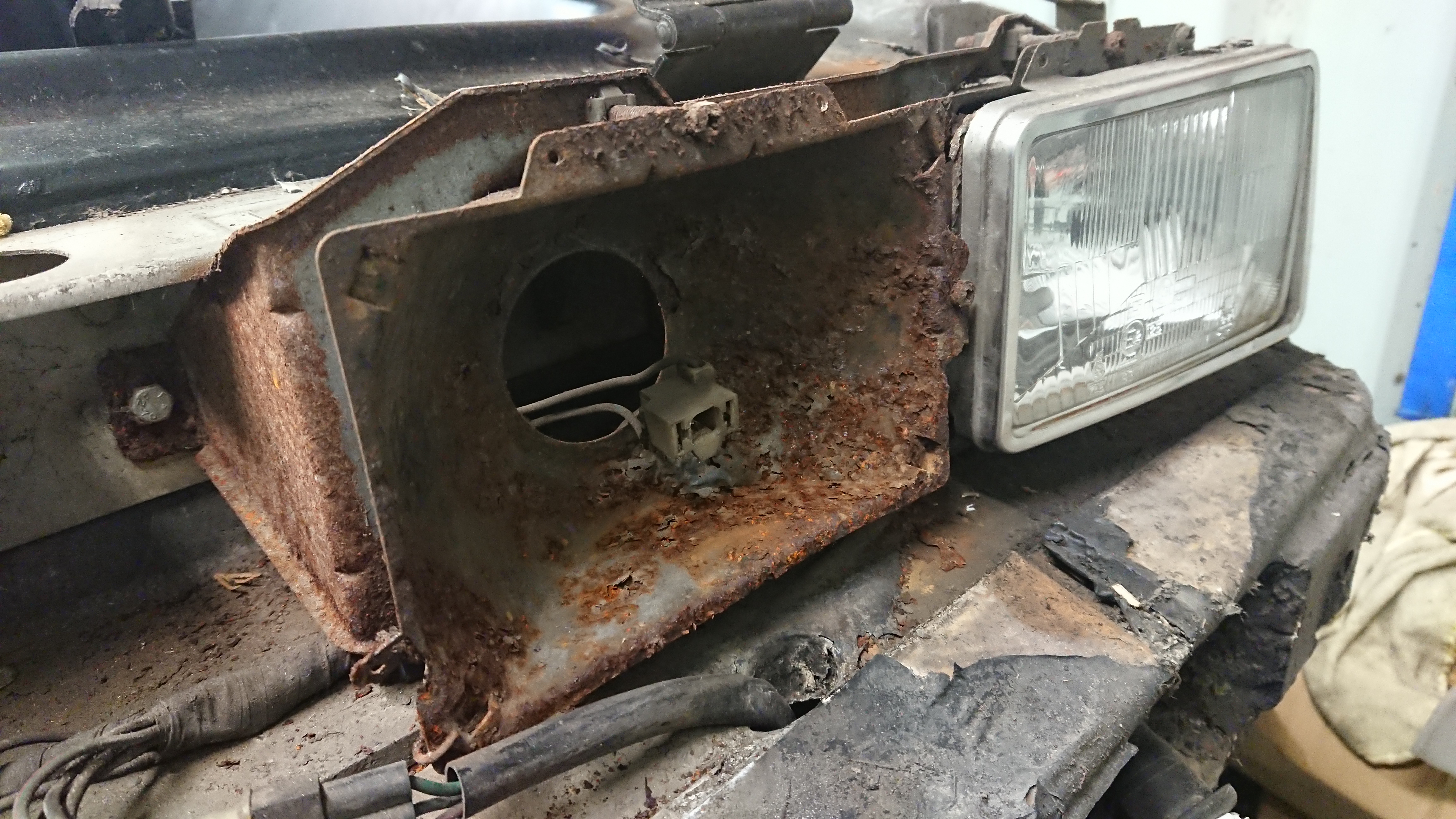

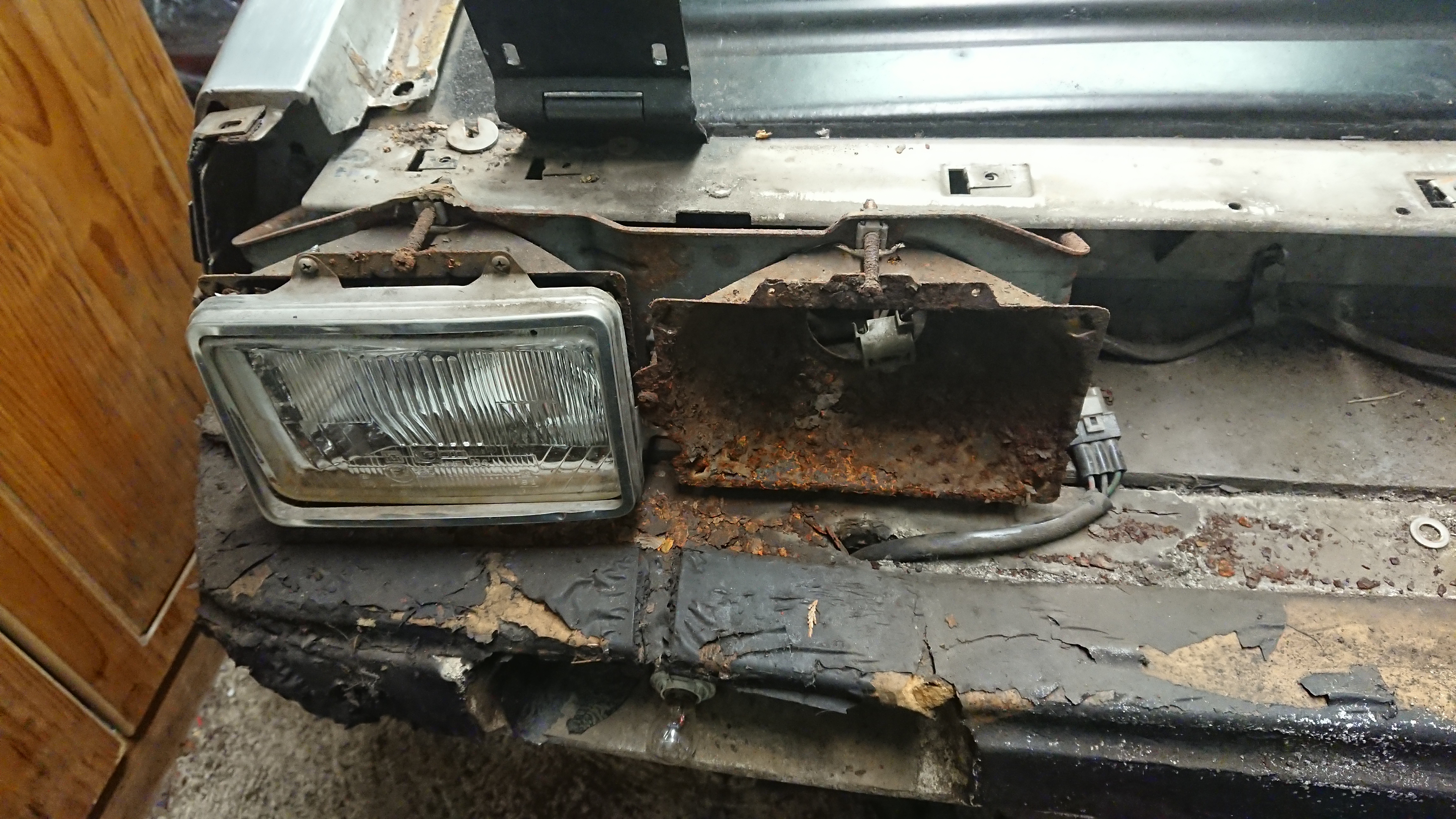

Headlight buckets in all their glory
They're bolts Jim, but not as we know it!
All the passenger wing bolts were like this, this wing has never been off safe to say
The offending bolt in all its glory.. urghh!

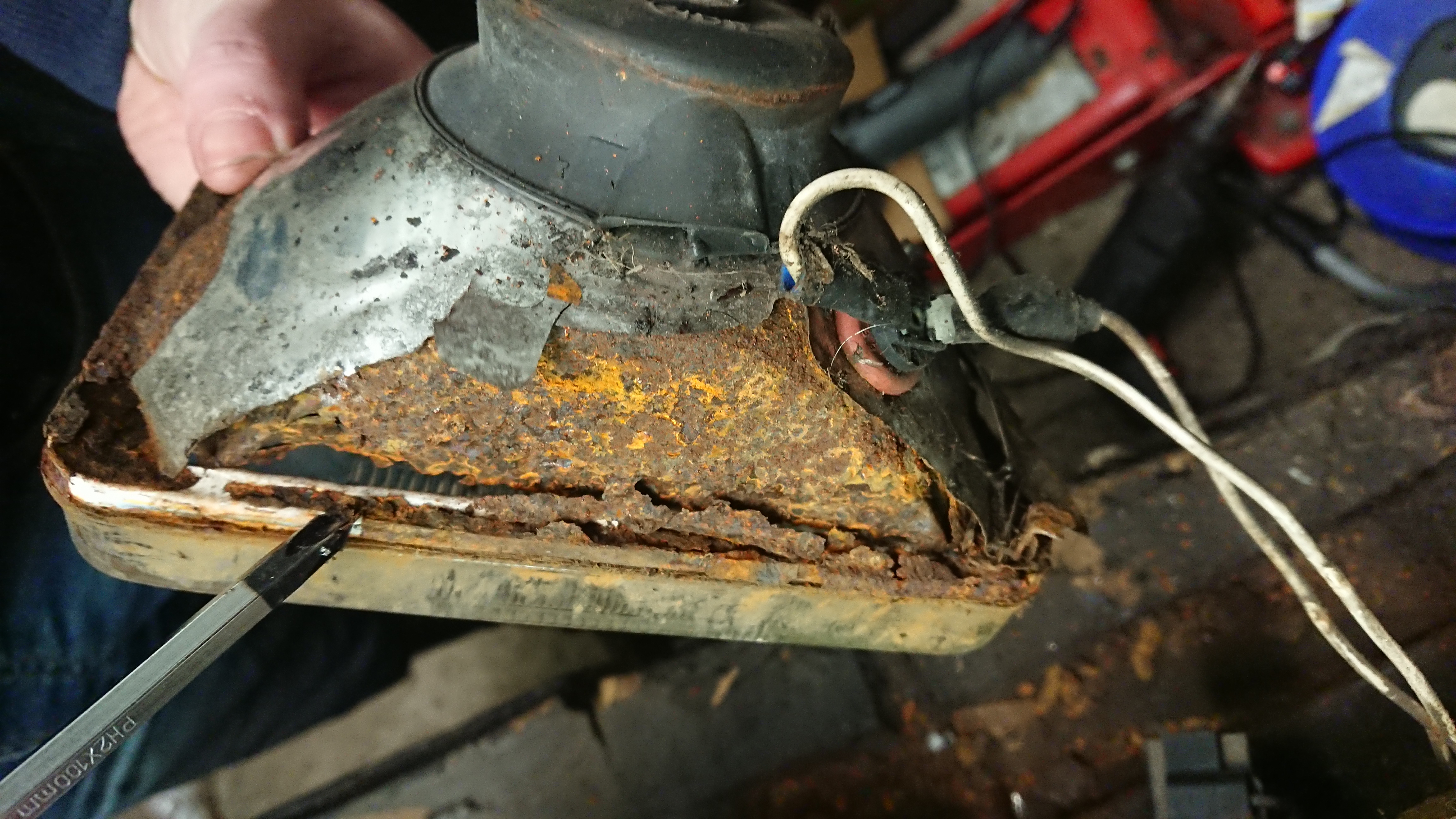

Dmc lights not known as great but no wonder I couldn't see anything on dips! .. Bought these new in 2005/2006
finally off

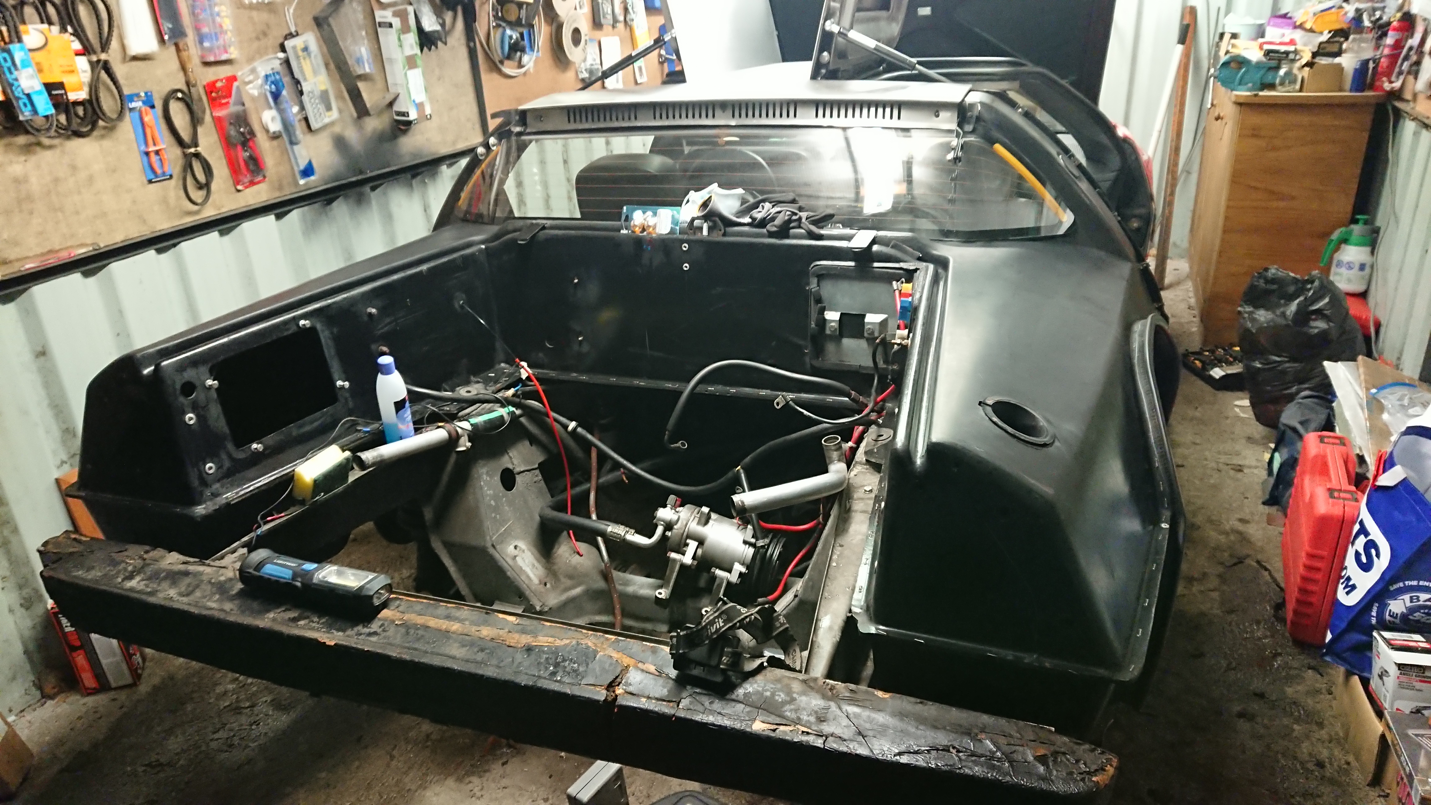

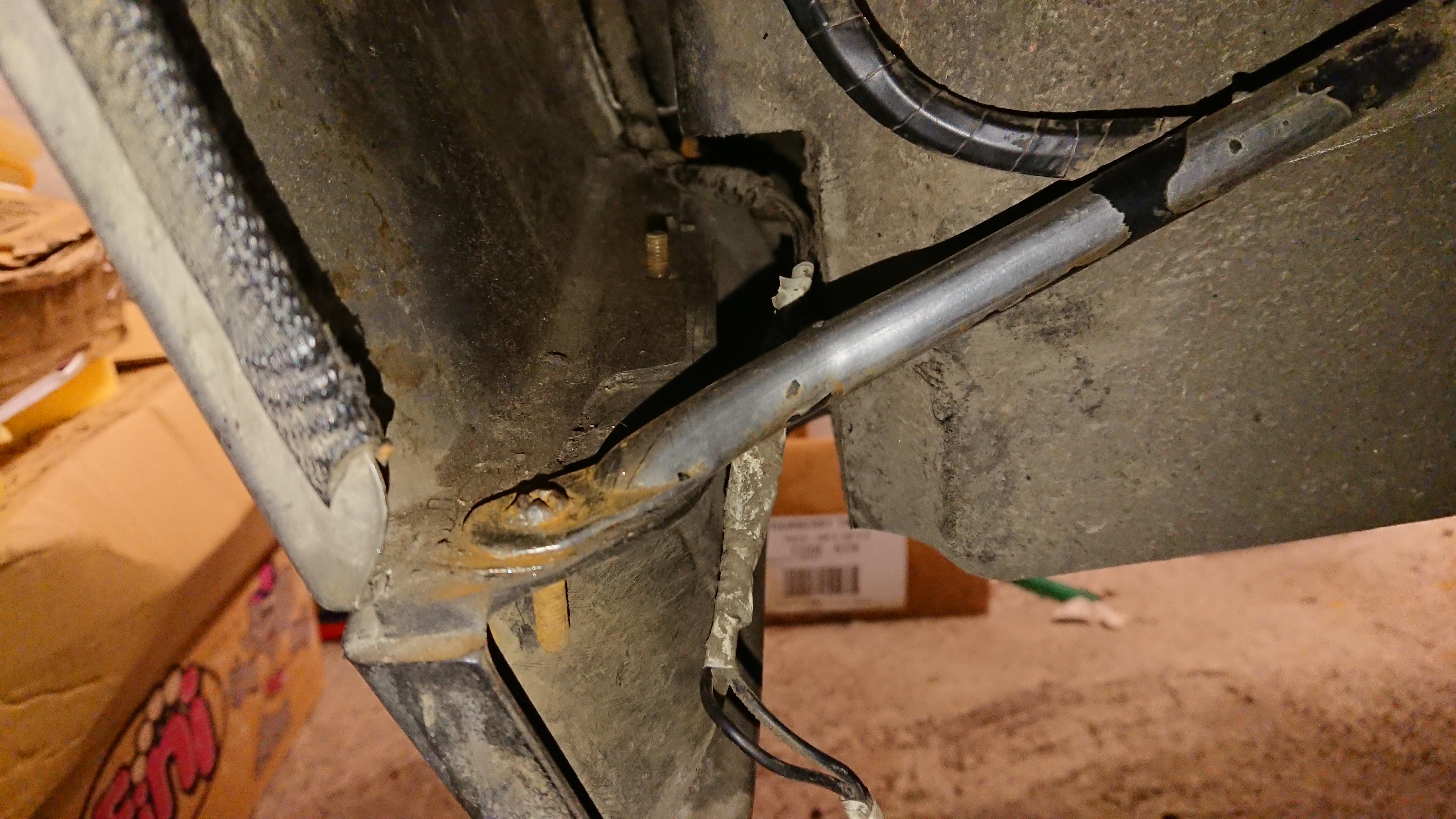

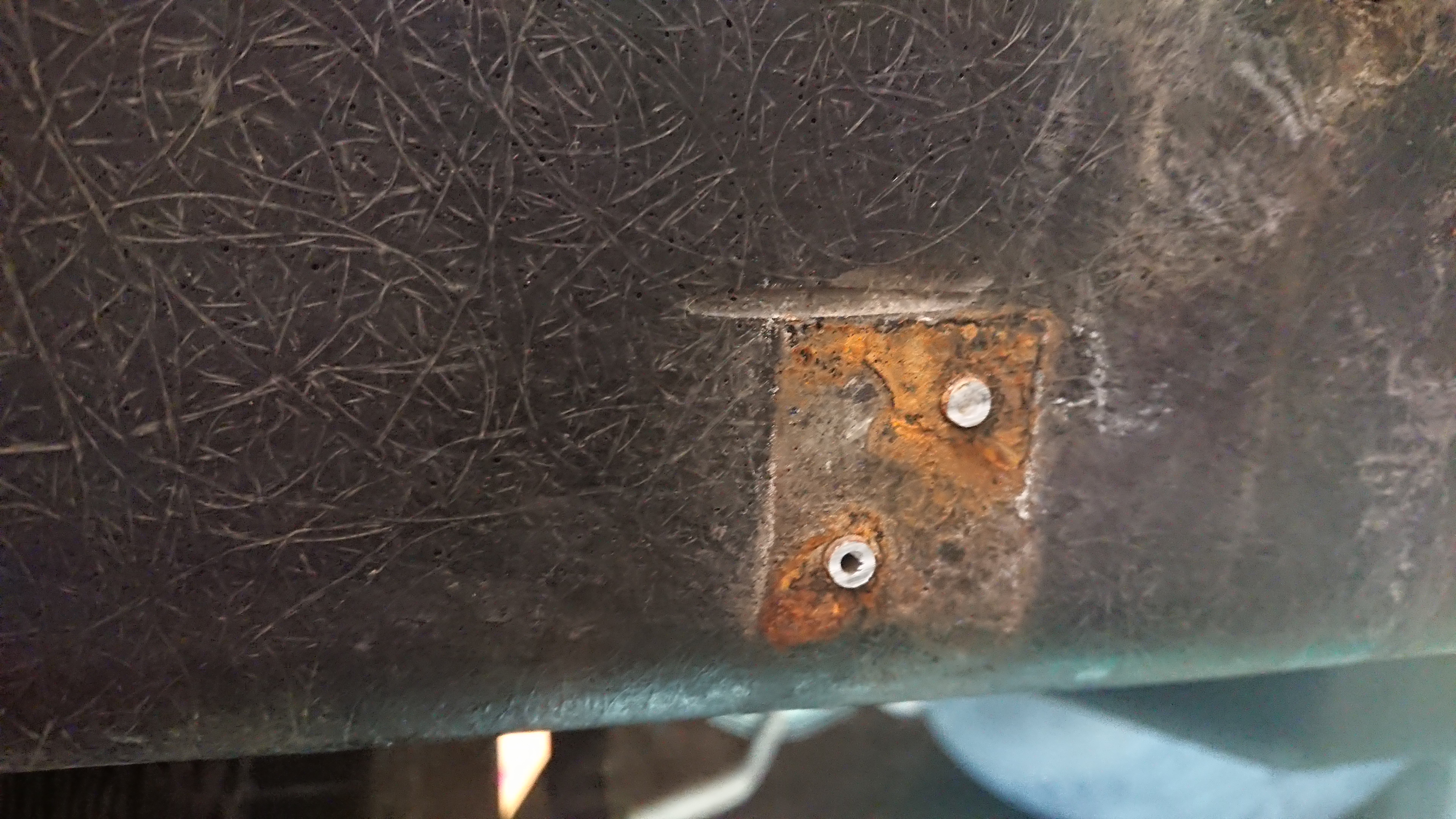

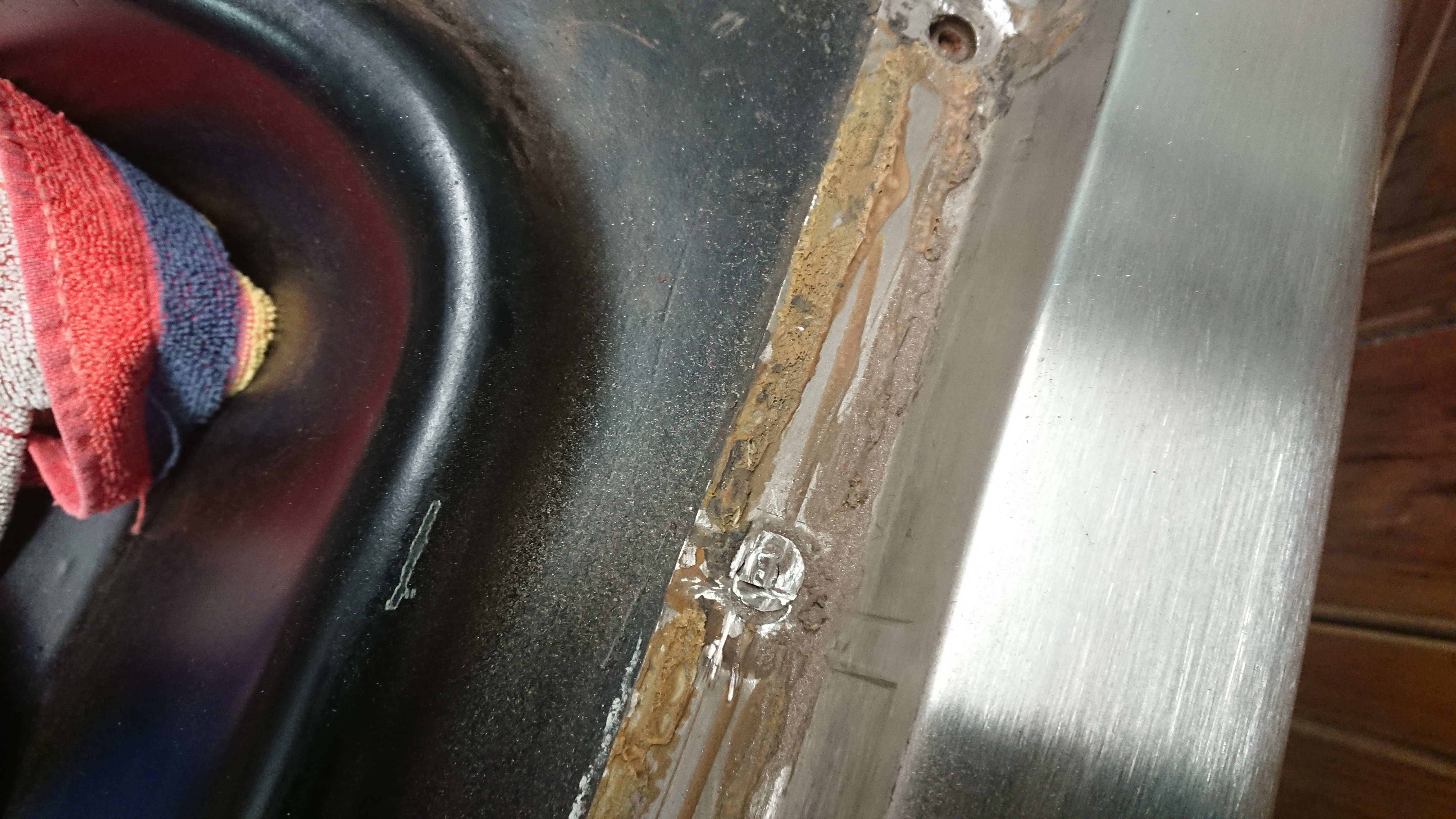

Postby cis6409 » Sat Dec 29, 2018 10:41 pm
Got a little more done today, but small progress. sprained ankle and back issues made it a bit of a pain to get more done..
Got to clean up the front end a bit more and make it a little more respectable at least..
2 more of the impact absorber bolts retapped, 2 more to go

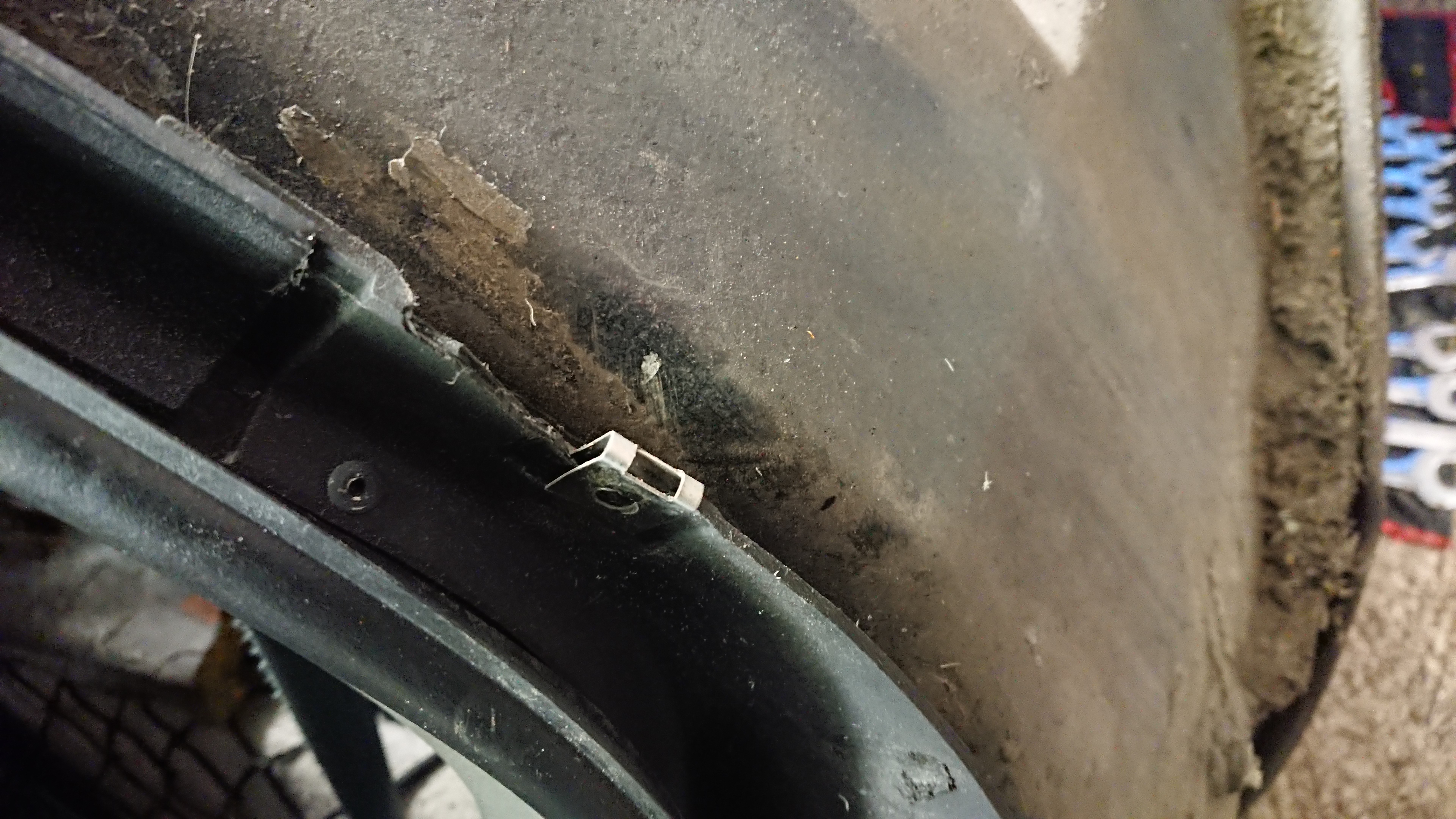

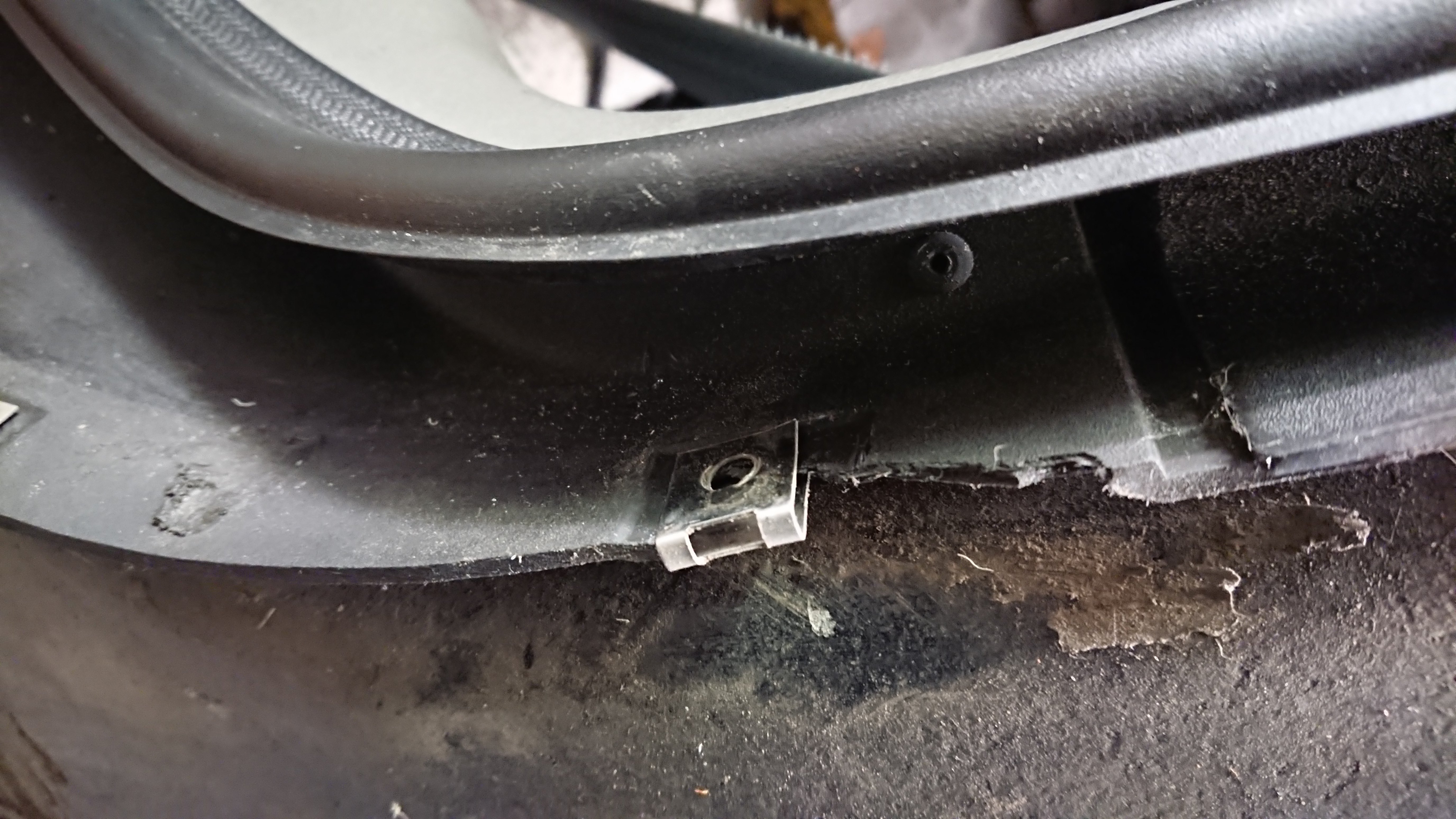

Wing rivets all need replacing or thread cleaning m5x 0.8 thread
