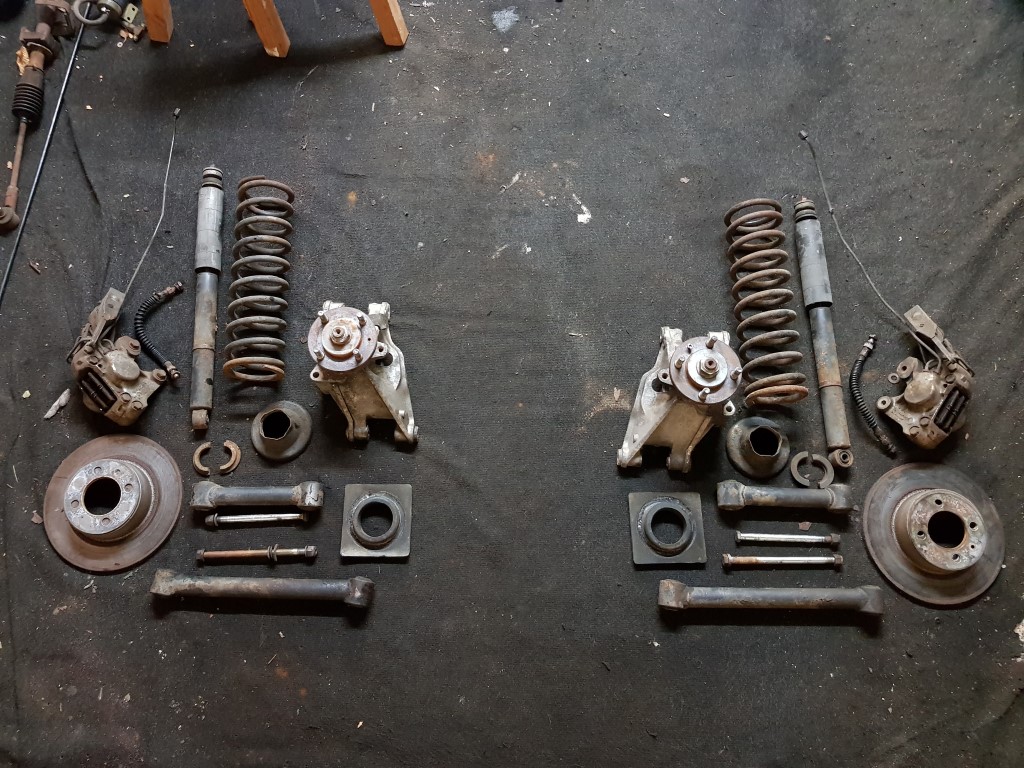

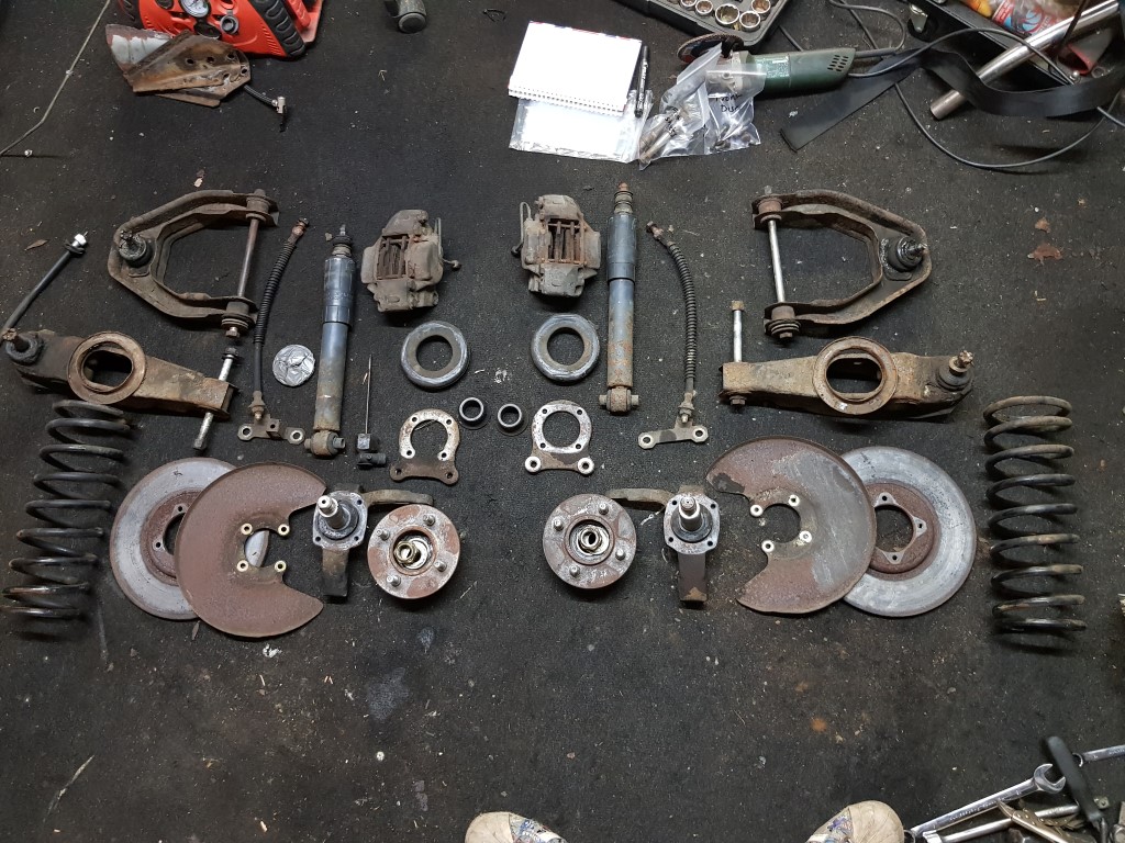

not loads but progress none the less, i got all the front and rear suspension blown apart ...
20181008_211007 (Medium).jpg (298.91 KiB) Viewed 4862 times
20181009_132744 (Medium).jpg (312.83 KiB) Viewed 4862 times

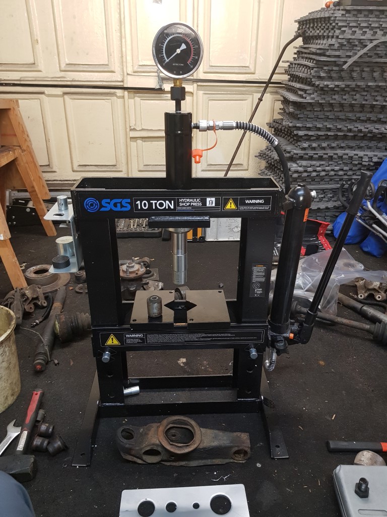

needless to say all the ball joints have had it and the bushes aren't great, i then got a new tool to make things easier...
20181015_233055 (Medium).jpg (279.8 KiB) Viewed 4862 times

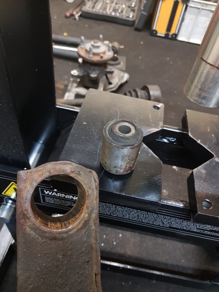

so all the bushes came out ..
20181015_233116 (Medium).jpg (225.49 KiB) Viewed 4862 times

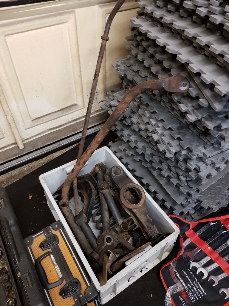

So now I'm getting quite a collection to be blasted and powder coated ...
20181018_105119 (Medium).jpg (312.47 KiB) Viewed 4862 times
and that's where I'm up to at the moment, got to go through a few more parts then off to the powder coaters

Re: MEC'S EPIC RESTORATION
Postby Dan 6511 » Thu Oct 18, 2018 11:55 am
Looking good mec :thumbsup:
Looking at your pics, are those wheel spacers you had on the back? Proper essex :thumbsup:
Postby mec » Thu Oct 18, 2018 11:59 am
Dunno mate, they look original ? .. I think Arran sells em, not sure why they are there
