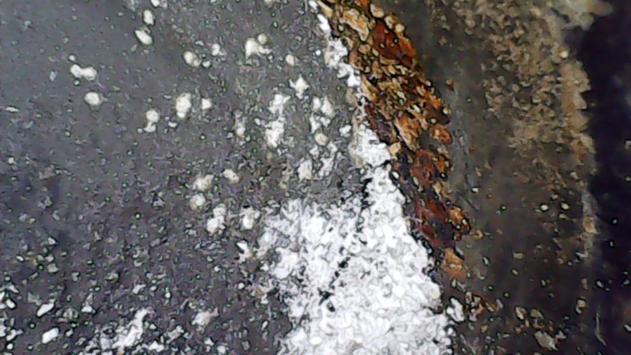

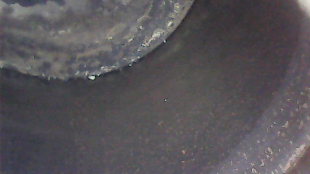

Finally got the 6th plug out today/ pumped Seafoam and wd40 in and out of the bores and tubes are yuk! The stuff that has come out is not nice. Couple of pics below. All bores full of wd40 tonight to get a good soak before I try to hand spin the motor. Is that best via the flywheel?
0_U4Dg2UTnqv9d0nr2edIA 2.jpg (159.34 KiB) Viewed 10753 times
jVuxIVfZQqiQIGzyhk1sqA 2.jpg (79.93 KiB) Viewed 10753 times

I would get a 35mm ring spanner on the crank pulley. You could use a socket but you would need to remove the muffler to do it that way.
What is that in the 2nd picture?
