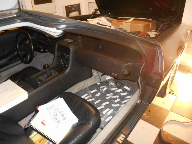

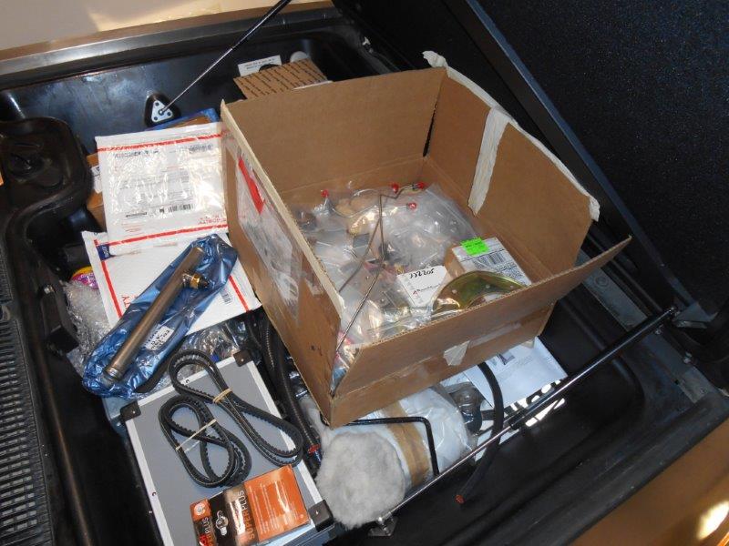

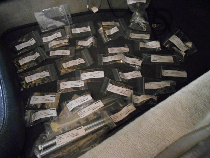

Postby Domi » Mon Jan 04, 2016 8:32 pm

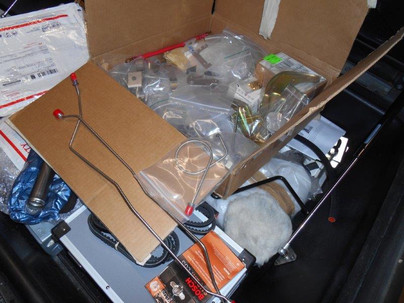

Some parts from all the vendors in DMC world

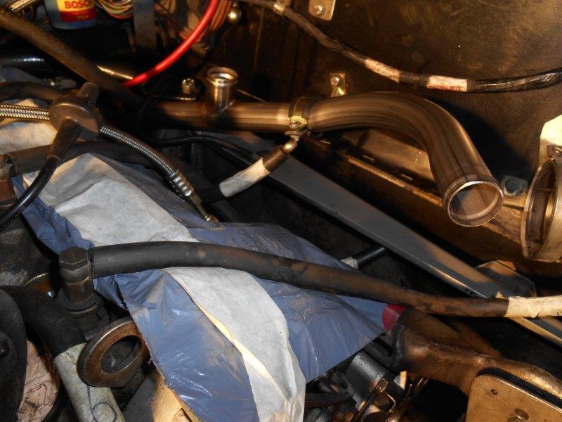

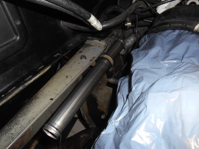

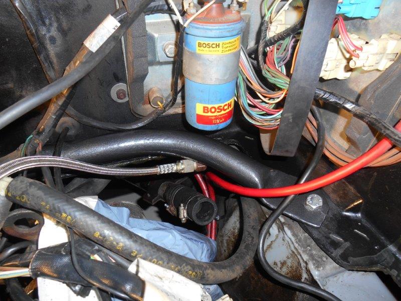

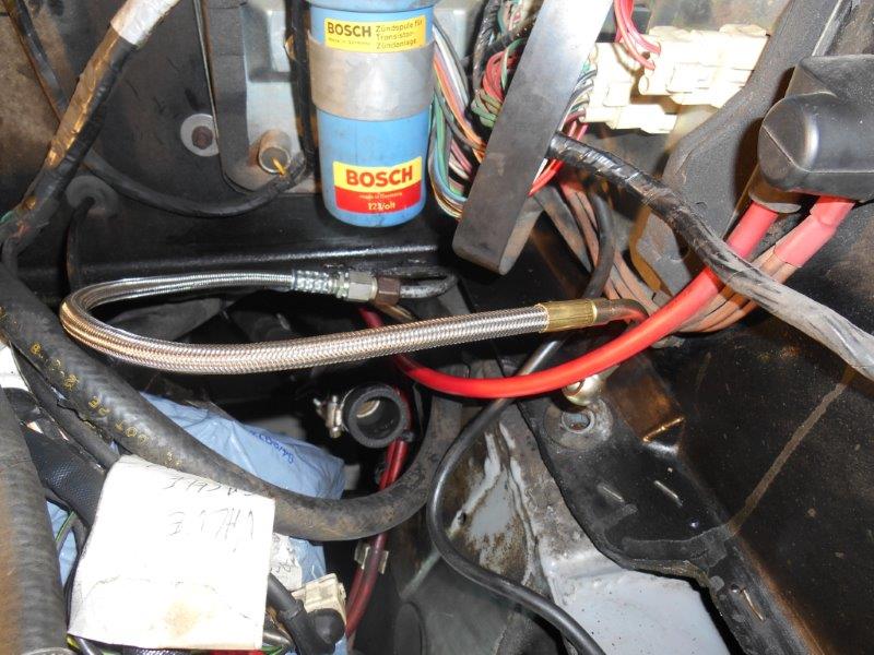

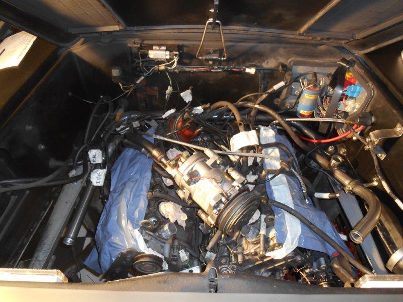

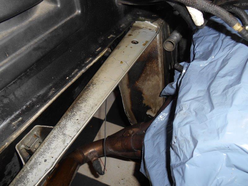

Postby Domi » Sun Jan 10, 2016 6:49 pm
Stainless steel fuel line to replace the old one

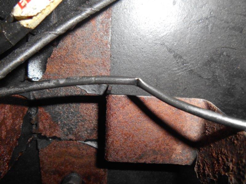

Cross brace back in place after 3 layers of paint. Worth the pain to remove it to repair it.

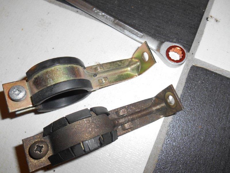

Stainless hook
Old bracket VS new one

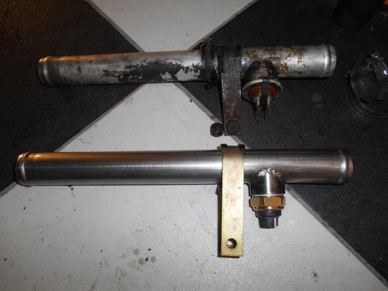

Stainless steel water pipes to replace the old one

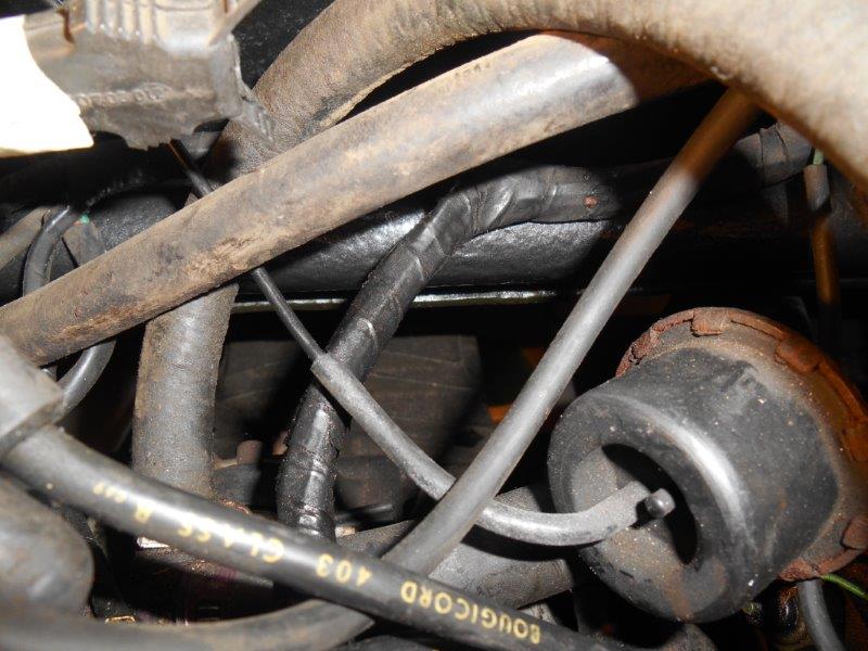

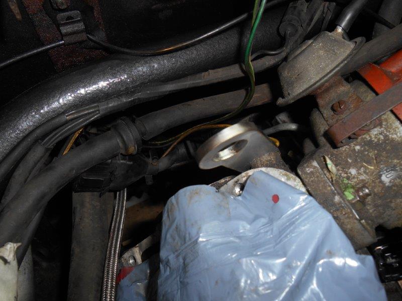

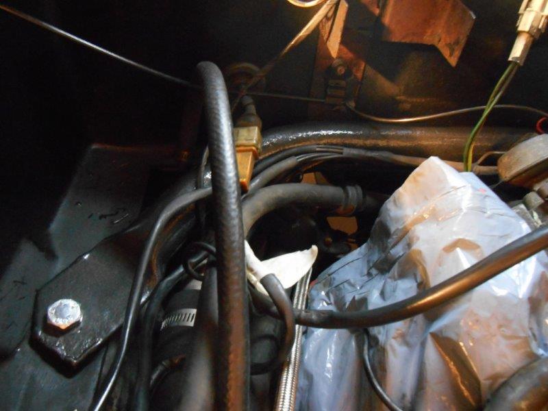

Postby Domi » Sun Jan 10, 2016 9:11 pm

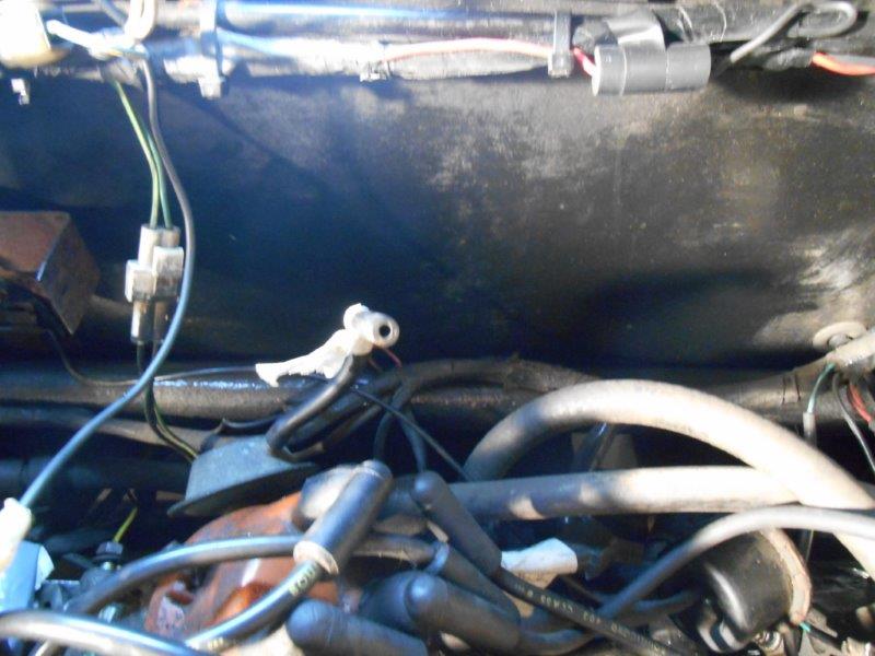

On the other hand, looks like I damaged the small pipe from the Hot Water Valve
However, I can’t see it on the drawing?
https://store.delorean.com/c-363-7-1-3- ... ystem.aspx
Any idea how to replace it?
Postby Admin-bloke » Sun Jan 10, 2016 9:20 pm
If it's the thin plastic vacuum line to the hot water (interior heater matrix) valve, I'd just cut the kink out and use some vacuum pipe to connect the two pieces back together for a repair, rather than re feed a complete new pipe through the car to the mode switch
Postby Domi » Sun Jan 10, 2016 9:22 pm
Good idea, but I need to find it.
Maybe on eBay, I will find something?
Postby Admin-bloke » Sun Jan 10, 2016 9:28 pm
You could remove the rubber vacuum pipe that is currently on your hot water valve for reference and get some from your local car parts shop.
If you're stuck I'll gladly post you some, but it may take a while to get to Italy !
