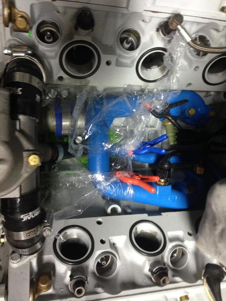

Anybody ever removed the water pump knows what those hieroglyphics stand for....

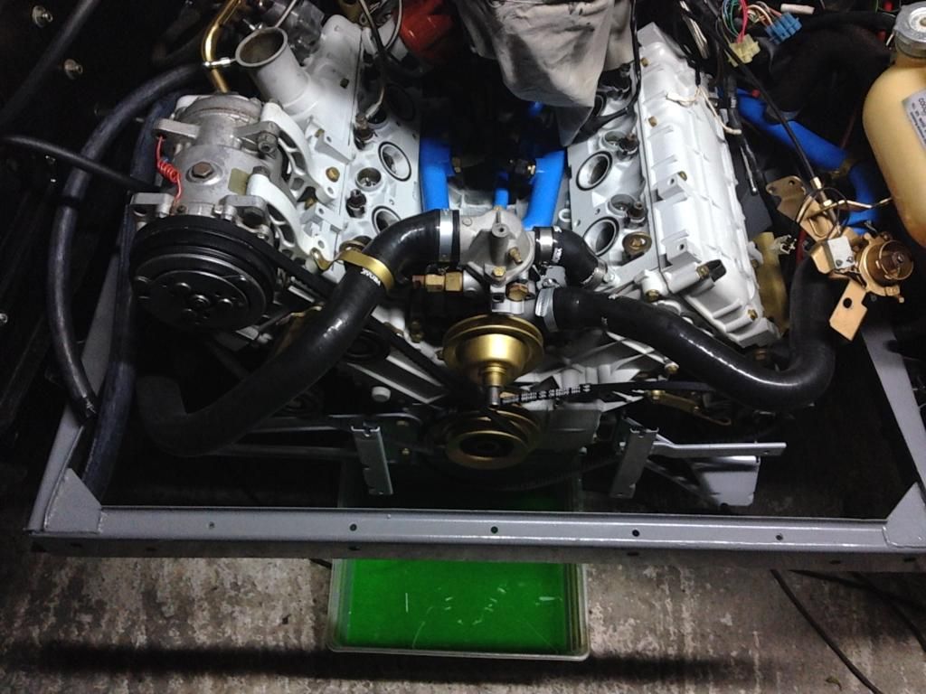

This time I covered the VOD so I don't have to collect the coolant from all the little wholes...
And the coolant ran into a container in the front

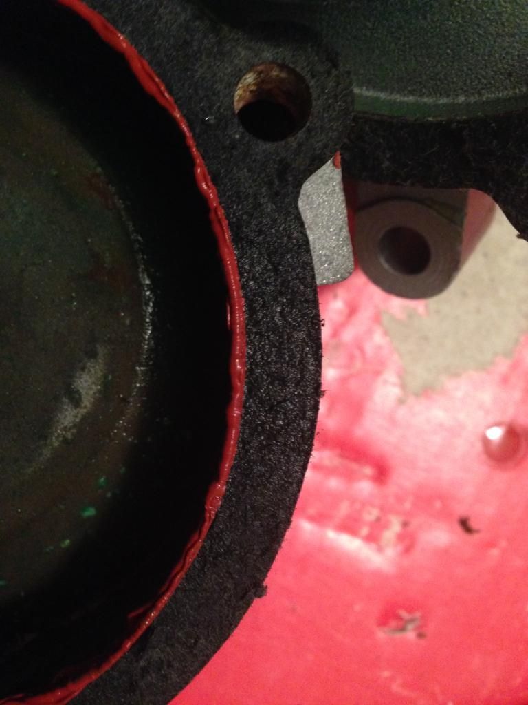

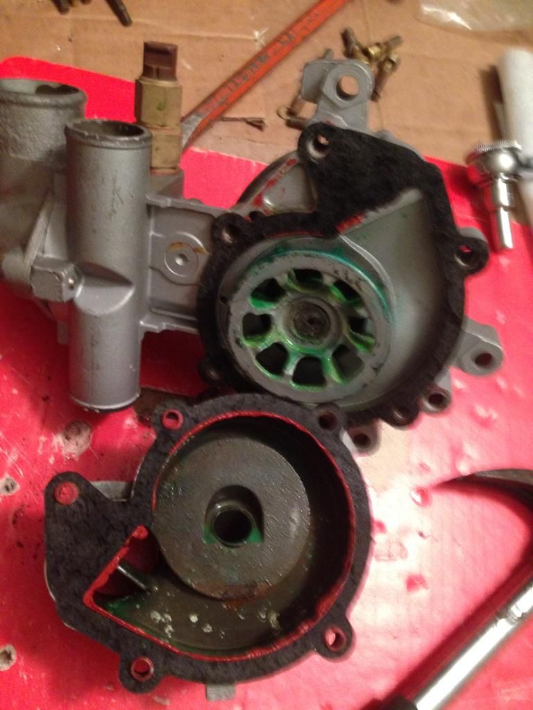

On opening the pump, the gasket was tightly glued still in the lips and came apart splitting in half.
Looking closer I realized it was the gasket its self that failed. The slight leakage derived from a slight spot where the gasket probably had come apart. Note this was a brand new gasket....
Notice the wet area of the gasket and the rest is dry.

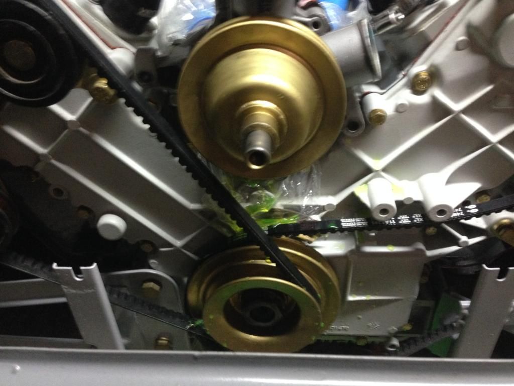

On assembly I chose to just use gasket silicone that is special for coolant components.
Back on the engine with this the rascal...
If that pump fails again.... I'll get a complete new engine before I think of removing it again.... :s
