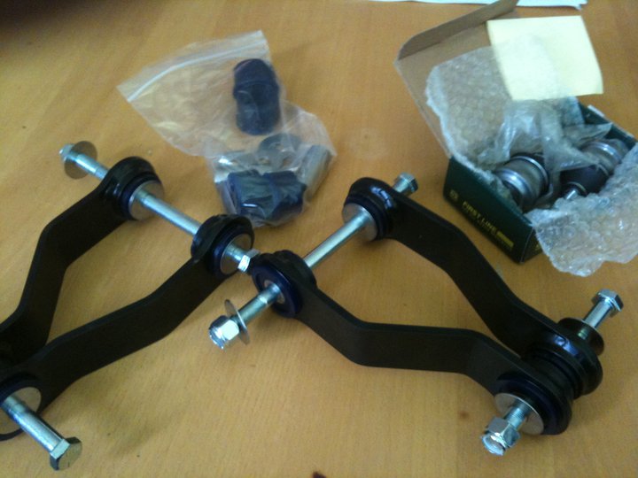

Parts came in! Christmas surely has come early this year!

Footwell lighting and LCA support brackets installed. Ball joints and bushing set aside for winter maintenance. I might need to tackle the rear suspension by then.. I wonder if it will ever be finished! :mrgreen:

Yesterday I took the D for a spin to check out the LCA supports. The difference under braking and cornering is amazing.
But I seriously need to take them out again to fix the instability with the other bits. I need to change the regular LCA bushings and the lower ball joint on the LH side. Check tyre pressure, and possible a realign on the front. Parts are in-da-house, just need to find time to install.
