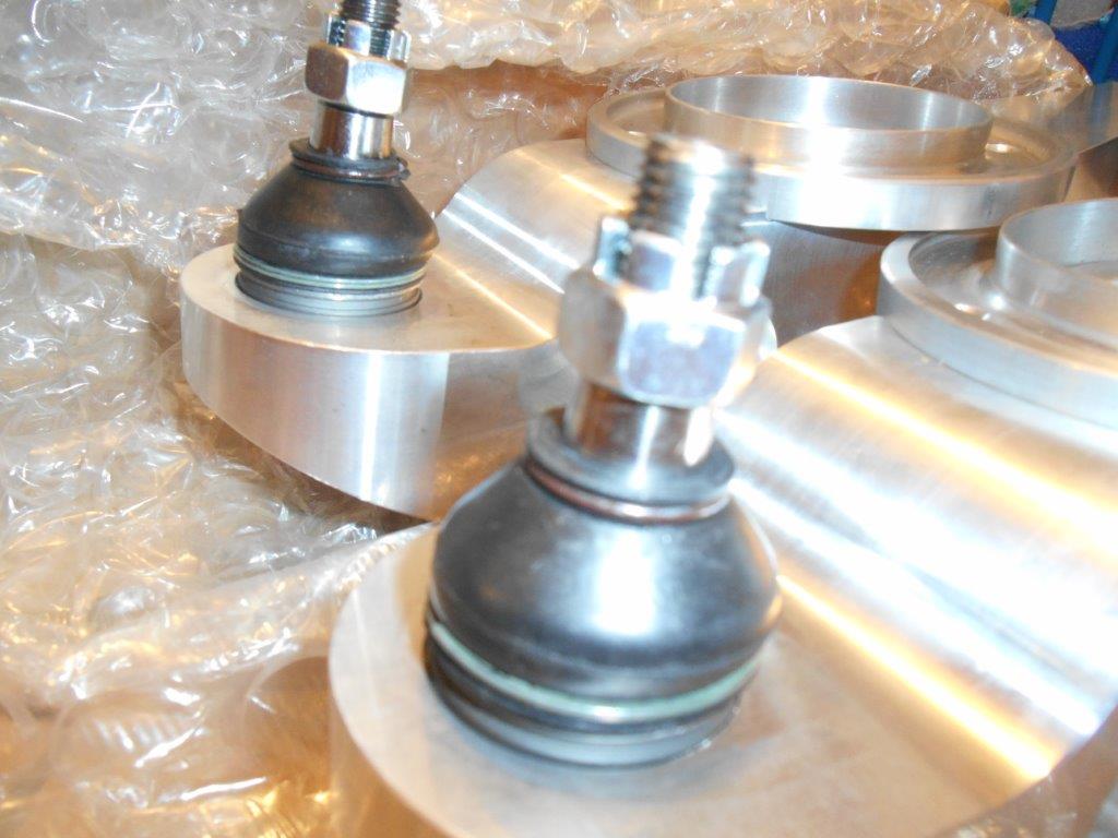

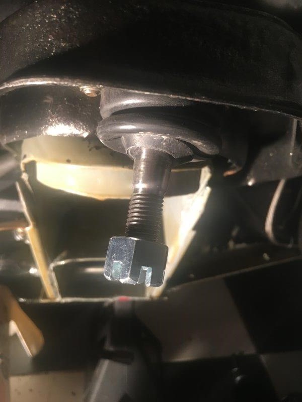

I've tried the castle nut on the upper arm and it doesn't fit.
The wrench was an 19 and it looks like the castle nut is 18? (Exactly 17.5)
https://www.deloreango.com/fr/castle-nu ... r-set.html
So, I won't be able to use it. On the other hand, I think the pin will fit under the nut?
Otherwise, I will need another upper ball like this one,
https://www.deloreango.com/fr/delorean- ... joint.html

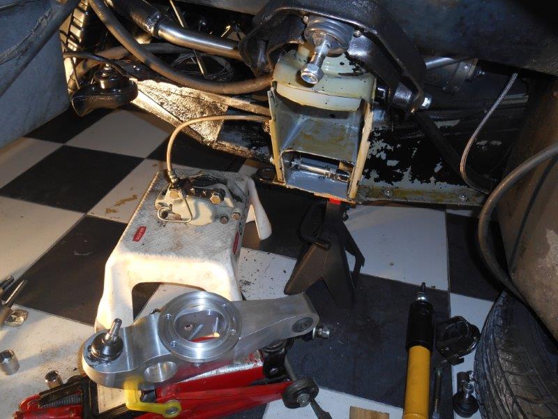

This afternoon, I disassemble the driver's side

The castle nuts you have there are factory original ones - they are UNF threads - our upper balljoints use this correct original thread.
Ed uses a metric M12 thread, but he also says you have to modify the steering knuckle...? Have you done this? It might make it difficult to use the original part afterwards if you have drilled the steering knuckle:

No - sorry, M12 isn't an original thread. But the castle nut in your first picture should be one.....?
This one.... It's an M12 thread:
