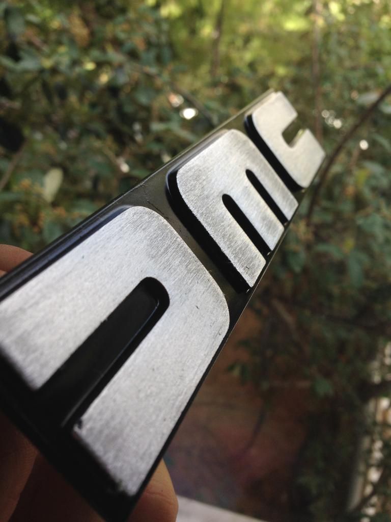

A proud moment, slash, nice photo....
Refurbished and regained the front emblem

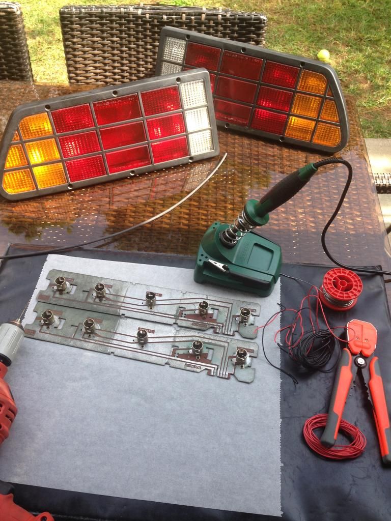

Postby ALEXAKOS » Tue Oct 07, 2014 3:25 pm

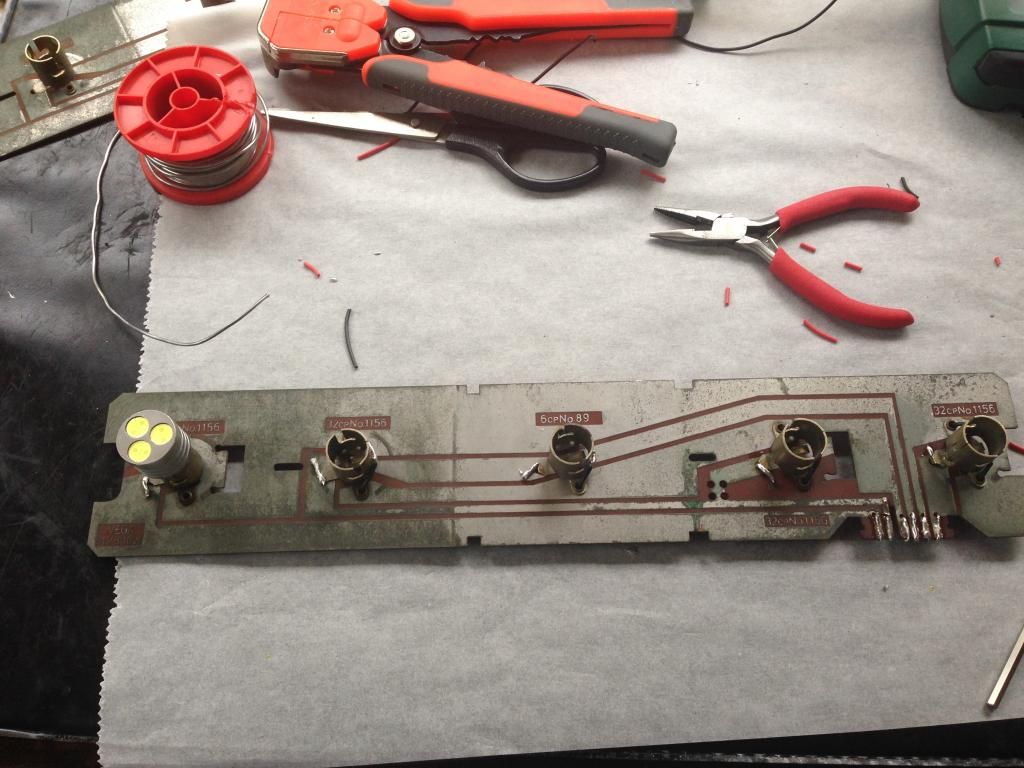

unLEDaded?
Not my Delorean :)

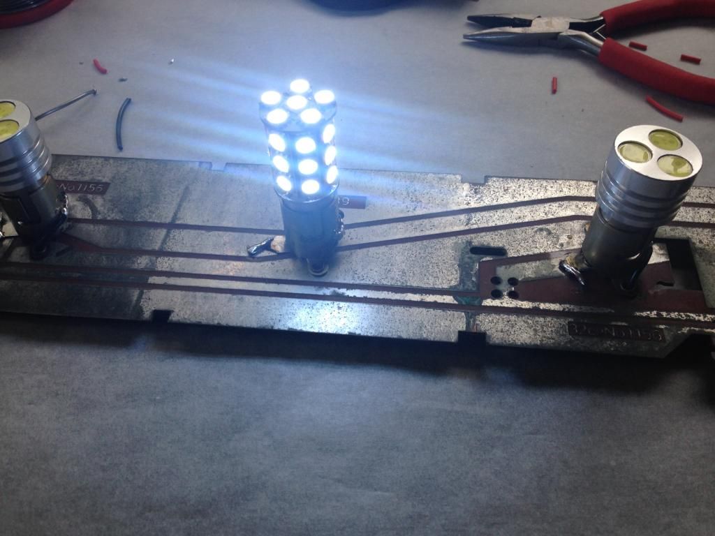

Tried my LEDs on my read lights and they were getting a lazy light out. Some were even shimmering like stars...

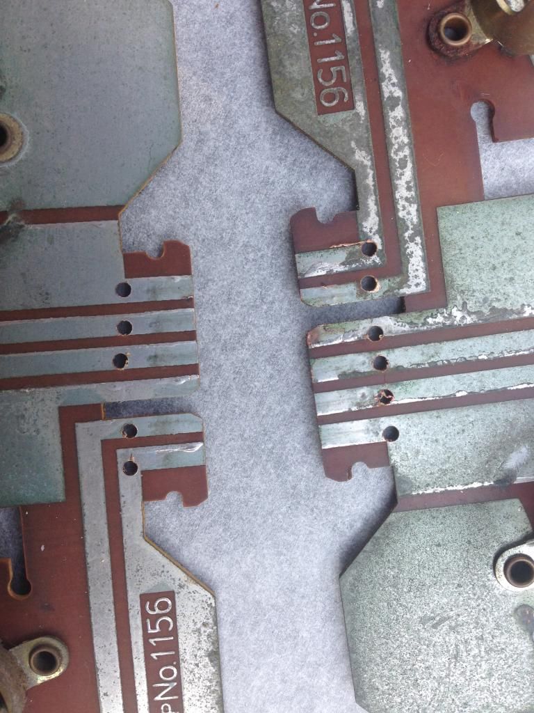

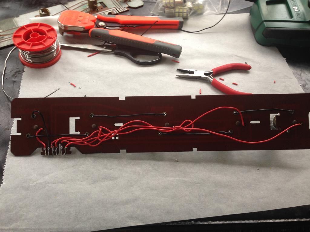

Time to refurbish those tail lights and revive the circuit boards
First drilled tiny holes right over the point the harness connector clips on

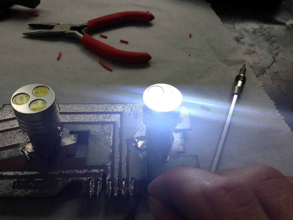

Then welded the wire edges onto the corresponding connection..

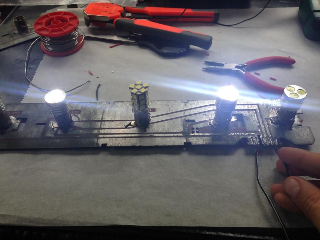

Wiring for the rear
the end effect....
Full blast clean light
Stop
Tail light
and reverse
Postby RobvdVeer » Tue Oct 07, 2014 3:34 pm
Good job. Easily saves you €100 this way.
