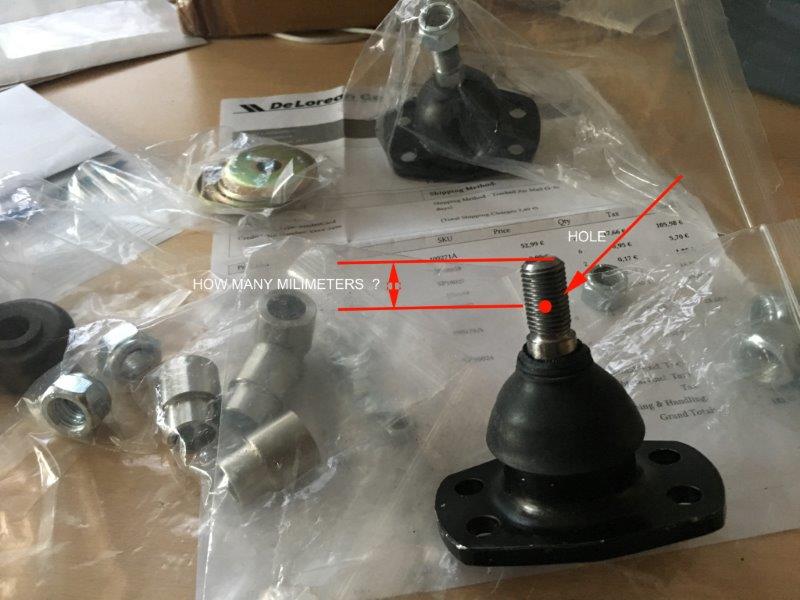

Postby Domi » Thu Oct 05, 2017 6:20 pm
I received my parts, thank you very much.
The new ball joint match perfectly on the arm, I didn't drill much I think.
Can you please tell me where to drill the hole for the pin?
I guess it is a 3mm hole?
Postby arranj » Thu Oct 05, 2017 7:23 pm
It's a 3.2mm hole (1/8inch), as for where, personally I don't know (does anyone else?). I think you will need to attach it to the car first - as per the original instructions - download/file.php?id=9688 - which do say you should drill the hole after the ball joint is on the car and the nut is on tight.

As for the hole, I thought you might be able to measure it on the original one?

Postby arranj » Thu Oct 05, 2017 8:06 pm
The originals didn't have a hole... that's why the this document was released as a recall, which told the dealers to drill a hole.
I have updated the picture on the original ball joint now - no hole: https://www.deloreango.com/fr/upper-bal ... ginal.html
