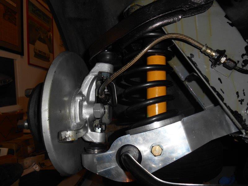

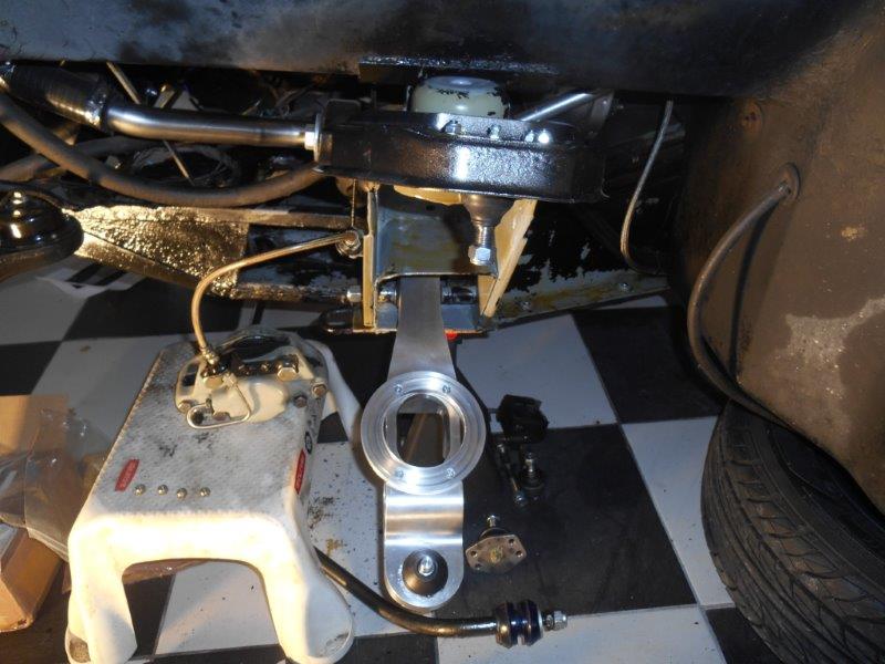

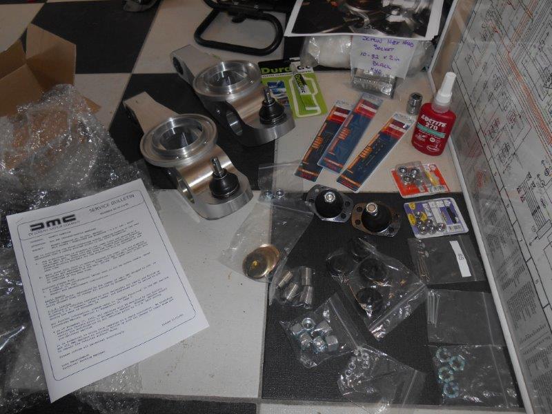

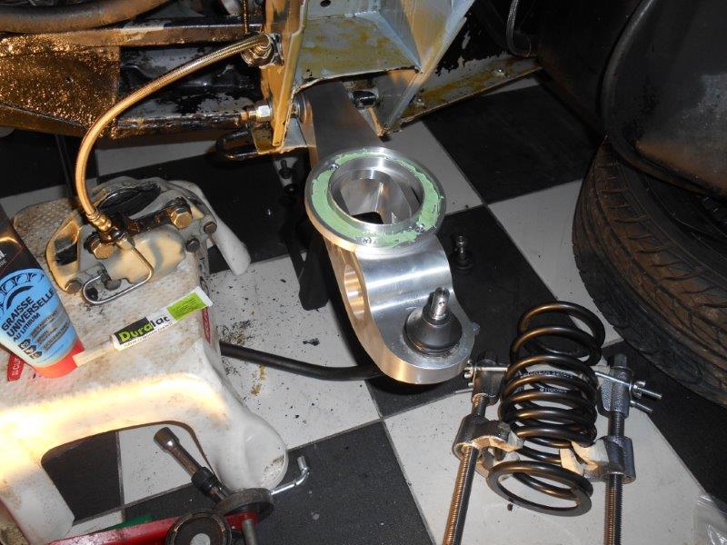

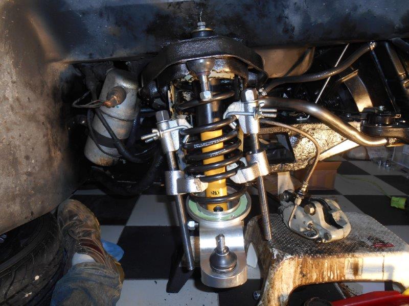

I have most of the part to rebuild the front now.

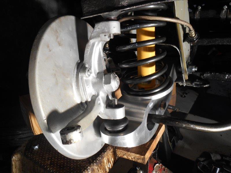

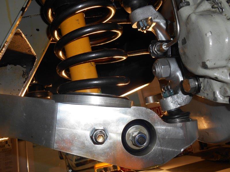

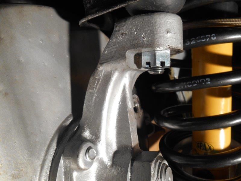

This morning, I went to the garage to mount the lower ball joint on the arm.
I didn't forget the Duralac :mrgreen:
Just did this so far.

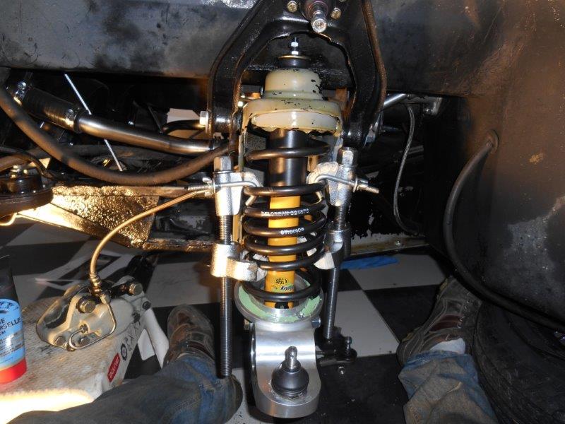

Postby Domi » Sat Oct 14, 2017 1:28 pm

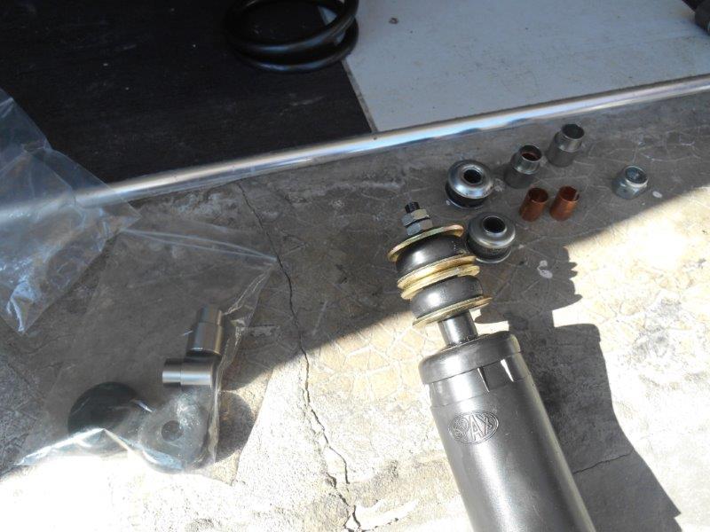

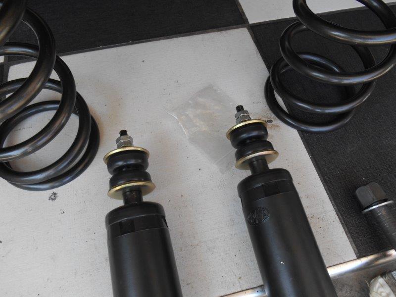

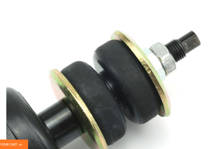

I think I made a mistake on my last order?
I have ordered 4 Spax Top Washer (see pic below)
Nevertheless I think I need 8 of them, 4 by shock.
Can you please confirm this? Thanks!
Postby Domi » Sat Oct 14, 2017 1:37 pm
I just check the store page, and it looks like it does mount like this:
Sans titre-2.jpg (145.09 KiB) Viewed 5254 times
So, it it does I have everything I need.
I thought it was like the old one. 4 by shock.
Postby arranj » Sat Oct 14, 2017 2:41 pm
Yes, 2 per shock, it’s the same as the rear ones now, these are much larger bushings.

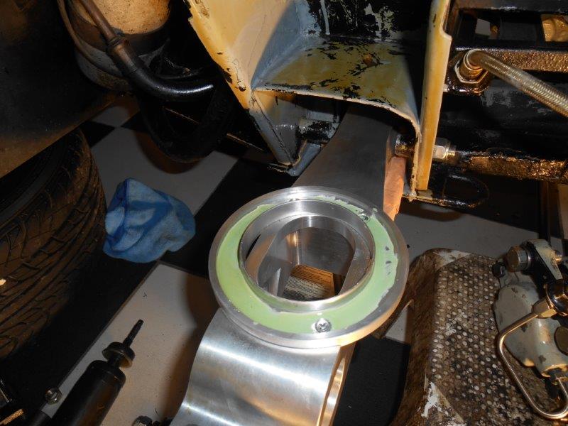

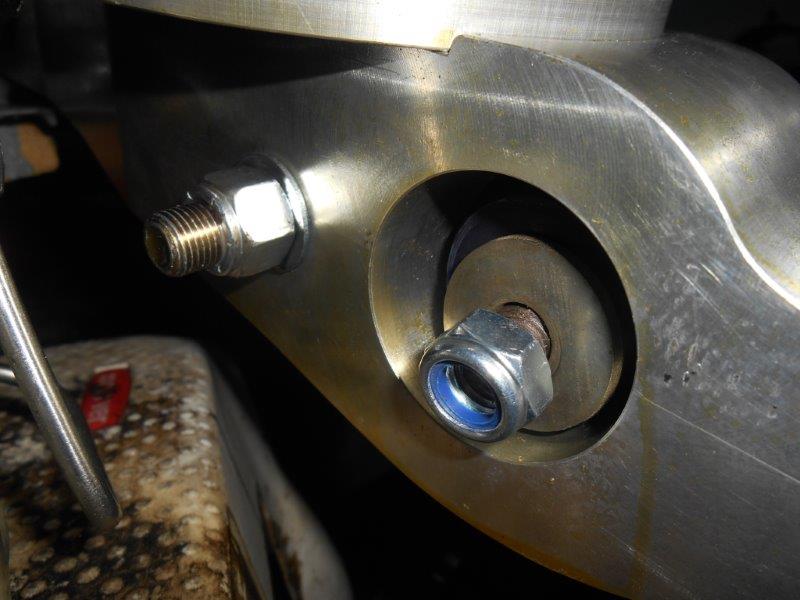

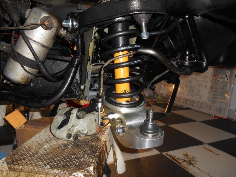

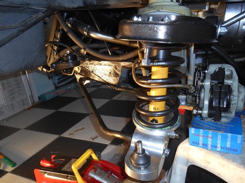

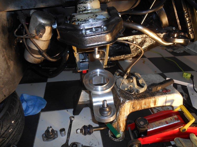

Here are the progress today:

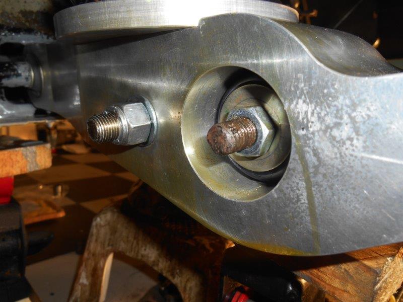

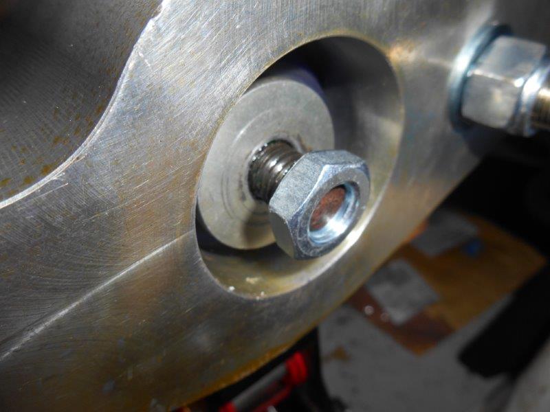

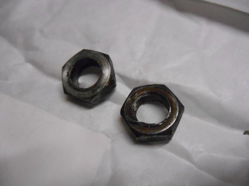

The bolt behind the nyloc is dead (Torque to 60Nm)
I thought I might replace it with this one:
https://www.deloreango.com/fr/stainless ... cknut.html
Do you know if ot will fit on the roll bar?
Thanks again :)
Postby arranj » Sun Oct 15, 2017 2:53 pm
That nut is only suitable for the idler pulley - it is the wrong thread for the anti-roll bar.
For the anti-roll bar you need a normal pitch M12 nut - i.e. M12x1.75mm. It should just be one nylok nut - SP10027. But if you wanted to match the recall - http://www.dmcnews.com/bulletins/SC-01-11.81.pdf - then instead you need:
2 x SP10050 - https://www.deloreango.com/fr/stabilize ... -thin.html
2 x SP10330 - https://www.deloreango.com/fr/stabilize ... thick.html
Postby Domi » Sun Oct 15, 2017 3:39 pm
All right, thanks again.
On my car, I had the thin one and nylok only.

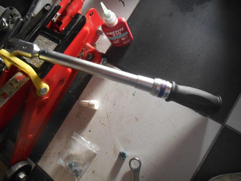

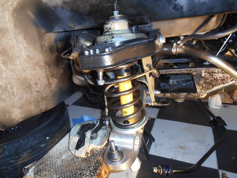

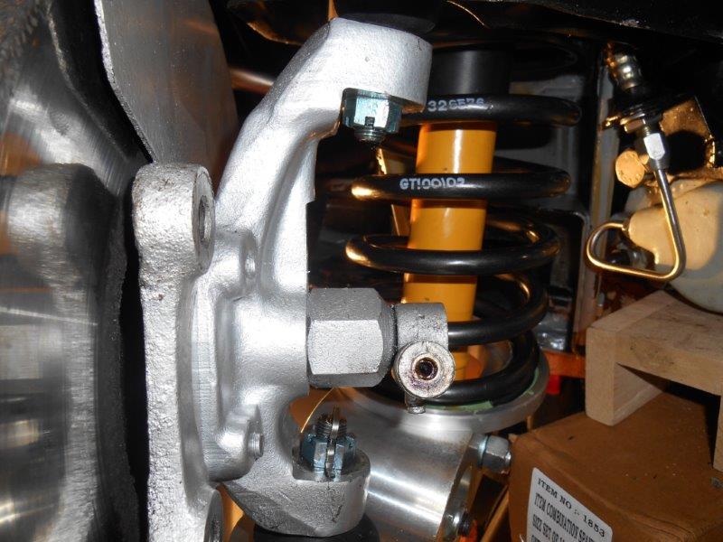

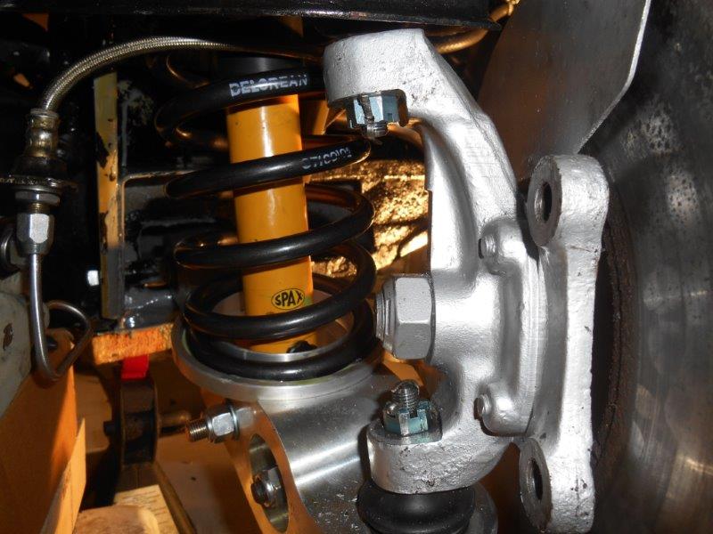

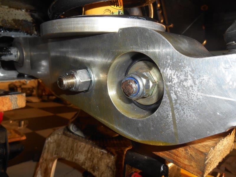

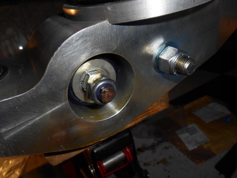

Postby Domi » Thu Oct 19, 2017 6:16 pm
I received my order, thanks again for the fast shipping :)

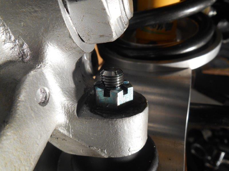

Stabilizer bar is done. Torque done & Loctite 270 :mrgreen: It won't move!!
Postby Domi » Sun Oct 29, 2017 5:32 pm

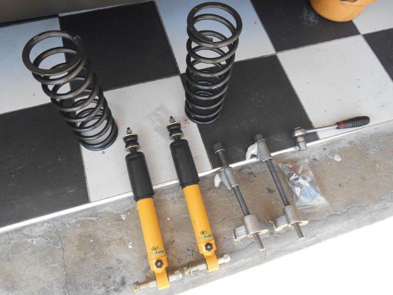

Next:
New torque wrench:
Stuck here for now, my two drill have passed away ...
