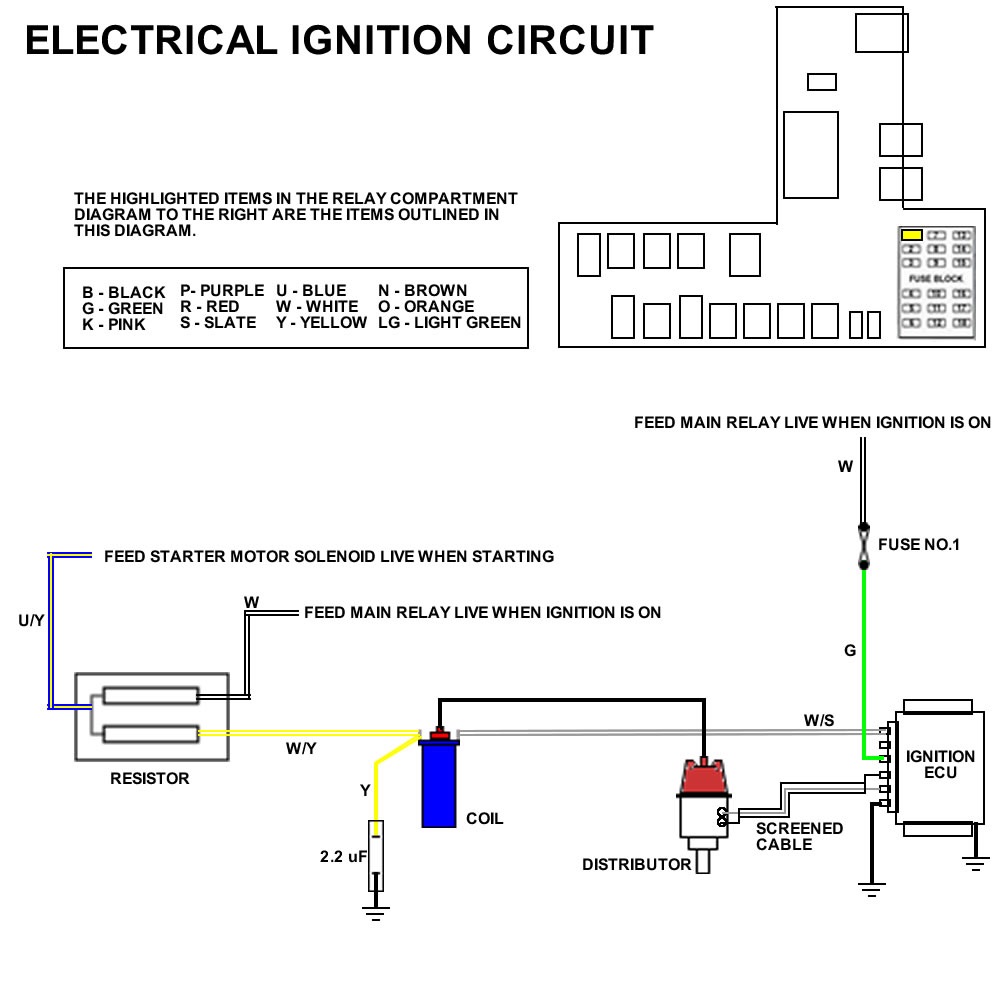

Postby RobvdVeer » Wed Oct 15, 2014 7:51 am
Check this

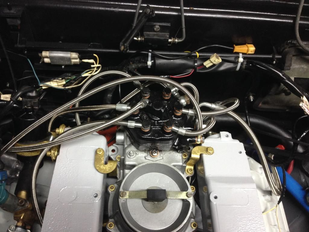

Postby ALEXAKOS » Wed Oct 15, 2014 7:55 am
Admin-bloke wrote:The lead I pointer out needs to run to the left of the firewall, not the right where it is now.
The plug it should connect to is the lead from the distributor base, as this is where the electronic pick up is (from the reluctor) inside the distributor. Think of this as a replacement if contact basket points.
Have you got a black lead that comes out if your distributor?
The fuel distributor is a Volvo head.
The spark distributor has that black lead that I can't find where it connects to.
Postby ALEXAKOS » Wed Oct 15, 2014 11:17 am
Silence? Haha confusing am I?
Okay took a shot of the distributor and the question is " where to I connect this??
Postby Admin-bloke » Wed Oct 15, 2014 12:01 pm
Admin-bloke wrote:
ALEXAKOS wrote:Went on and installed my stainless fuel lines.
Don't forget to plug that orange plug (top right of the photo) to the electrical plug of the distributor or the engine won't even make a spark ;)
Postby ALEXAKOS » Wed Oct 15, 2014 12:08 pm
Admin-bloke wrote:
Yes yes yes!!! I read that but.... Where is that???:(
Postby Admin-bloke » Wed Oct 15, 2014 12:11 pm
If you're holding the same plug, it should connect to the plug that comes from the hole in the fire wall that is about 10-15cm below and to the left of the ceramic resistors. This then connects to the ignition "ecu"/ amplifier.
Postby ALEXAKOS » Wed Oct 15, 2014 12:24 pm
Admin-bloke wrote:If you're holding the same plug, it should connect to the plug that comes from the hole in the fire wall that is about 10-15cm below and to the left of the ceramic resistors. This then connects to the ignition "ecu"/ amplifier.
Ahh the ecu;)
Thanx AB! I'll start digging;)
Postby Admin-bloke » Wed Oct 15, 2014 2:18 pm
RobvdVeer wrote:Check this
Look at the diagram Rob attached. This is the "screened cable". The diagram doesn't show the multi plug that is about half way. This is the plug you're holding.
Postby ALEXAKOS » Wed Oct 15, 2014 2:29 pm
Cheers,
I totally missed robs post! Damn :s sorry buddy, and thank you;)
