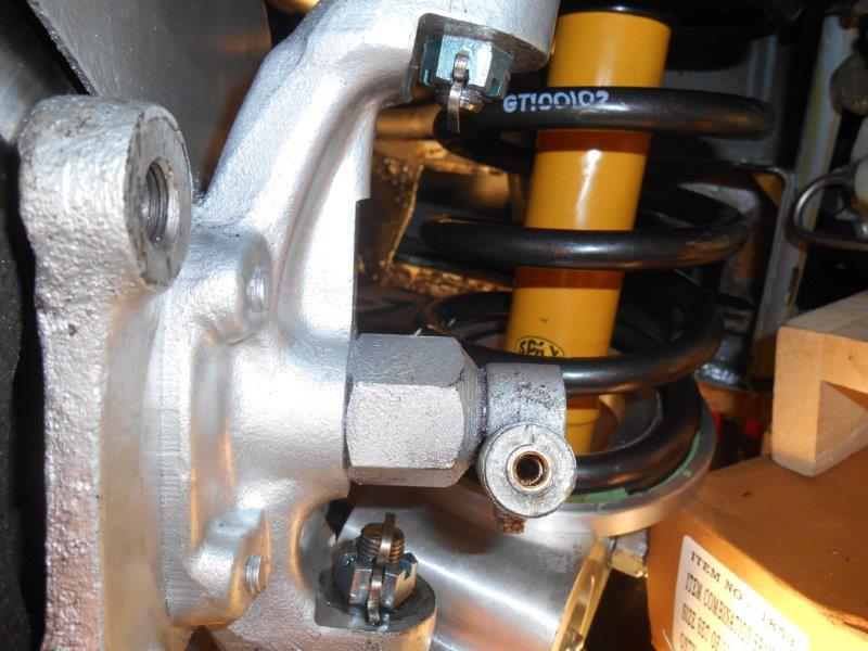

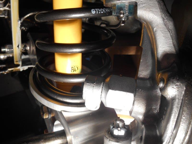

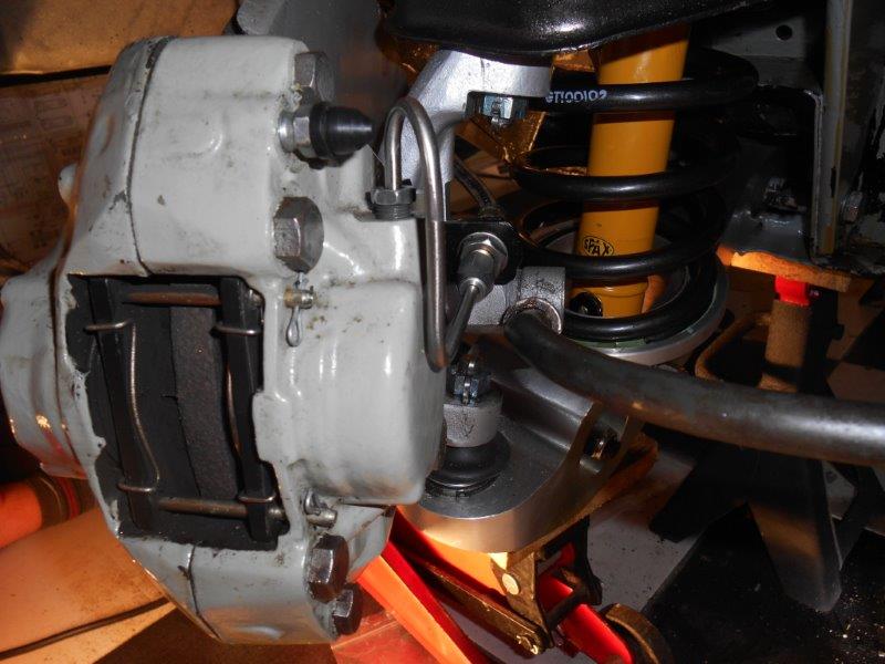

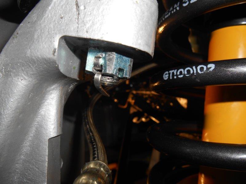

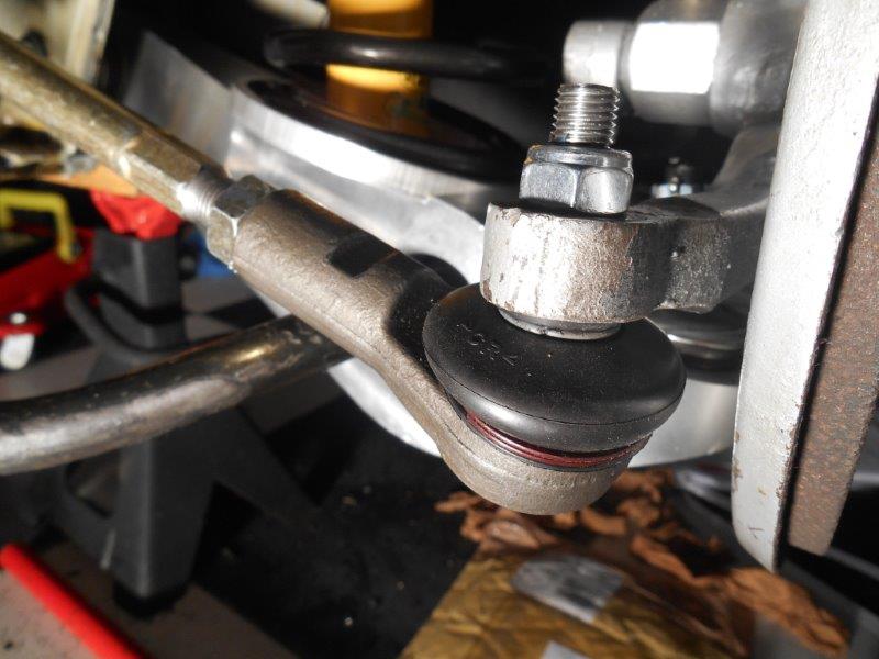

Postby Domi » Mon Oct 30, 2017 7:10 pm
Other side is done
I broke a small part of the pin, do you think its important?
Otherwise, I will replace it.
Posts: 1004
Postby arranj » Mon Oct 30, 2017 7:15 pm
Domi wrote:I broke a small part of the pin, do you think its important?
No - it's not important :) - looking good 8-)
Postby Domi » Mon Oct 30, 2017 7:21 pm
Ok thanks, only the half is cut, this way I don't think the bolt will come off now.
Torque to 50nm + Loctite 270 :mrgreen:
Next step, the steering rack...

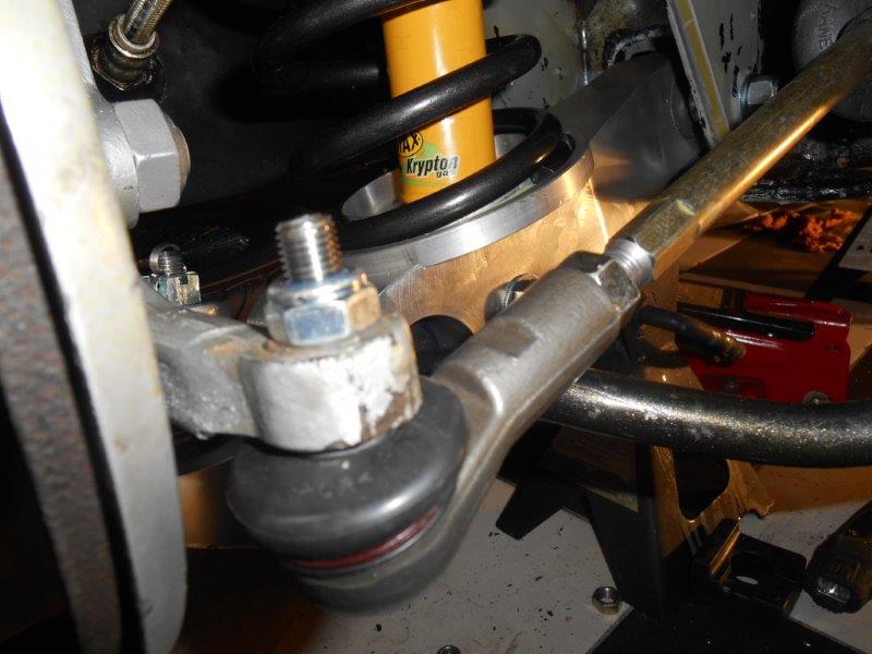

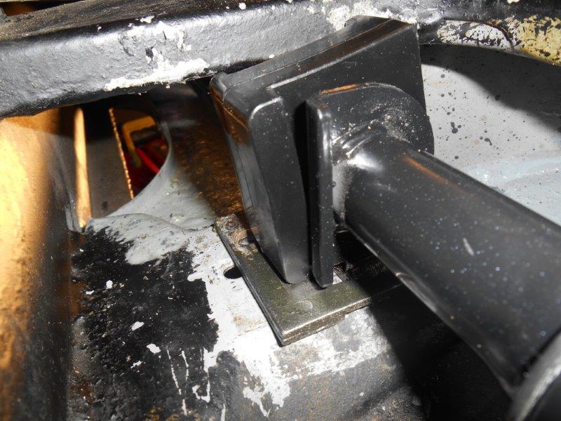

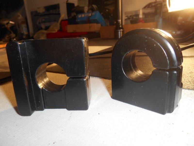

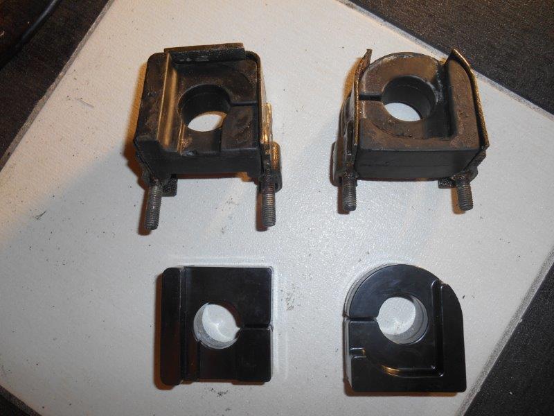

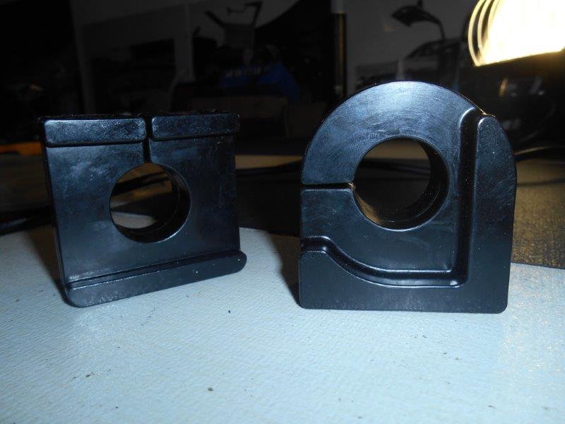

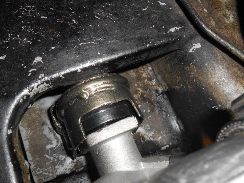

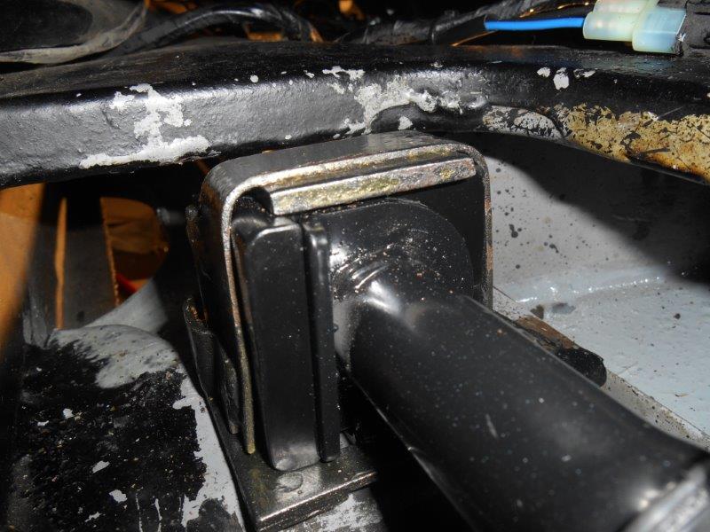

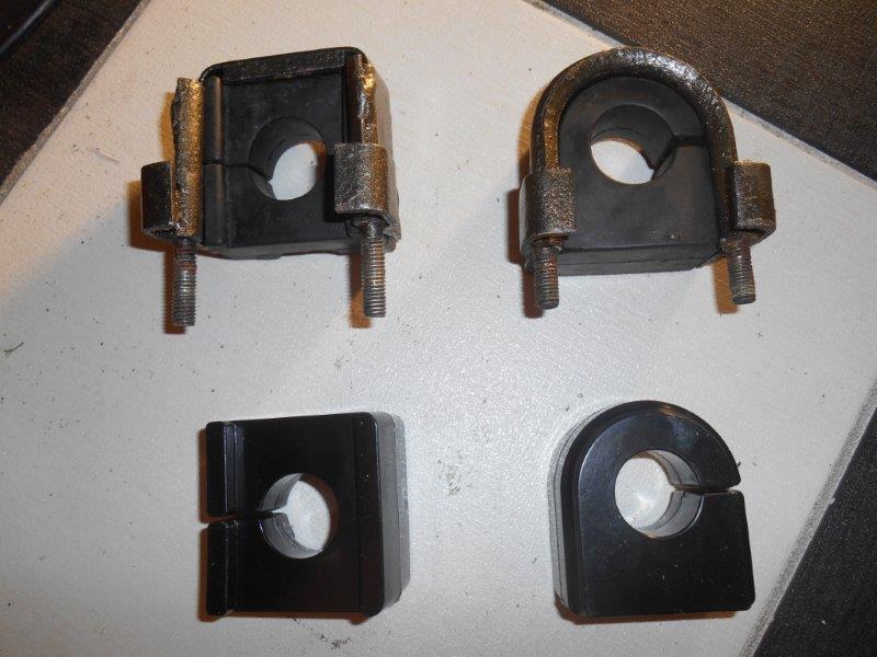

Postby Domi » Sun Nov 12, 2017 7:16 pm
I’ve tried to mount the steering rack this afternoon, but after spend more than3 hours; it’s not finished yet…
Replace the little pin anyway; I thought the other one was too short.
New poly for the steering rack from Ed Uding

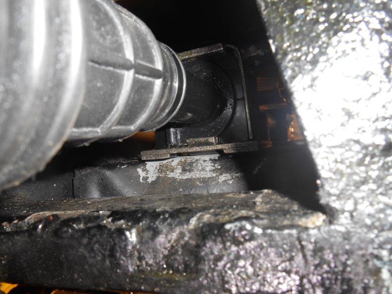

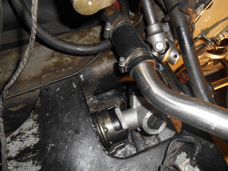

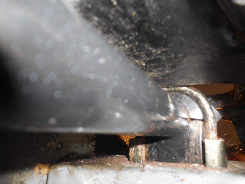

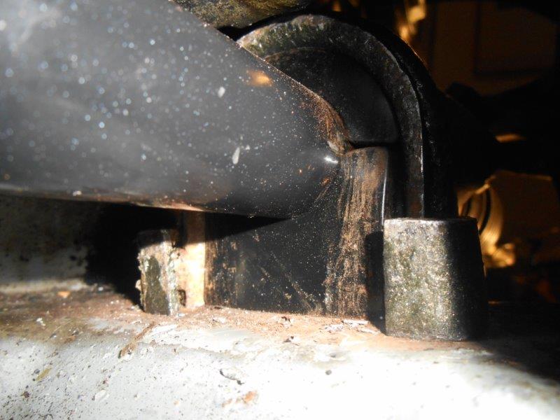

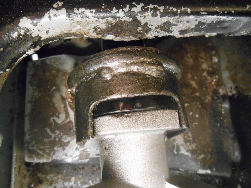

The other side isn’t aligned to the holes
However the driver’s side looks good, so decided to remove the bolt
And this is much better
Unfortunately, now the driver’s side doesn’t want to get beck inside.
Posts: 1004

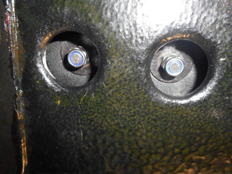

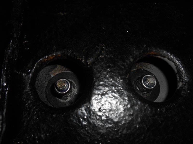

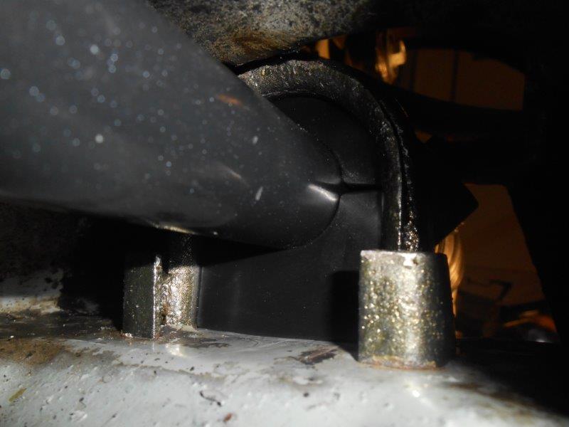

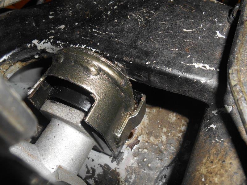

Postby Domi » Tue Nov 14, 2017 9:06 pm
Success, but not so easy with the new poly!
Double bolt to avoid any trouble in the future :mrgreen:
Didn't see if there is any value of torque for this?
Thanks for your help :)
Posts: 1004
Postby Domi » Wed Nov 15, 2017 7:09 pm
Raphael gave me the torque for the steering, don't take time to look for it.
