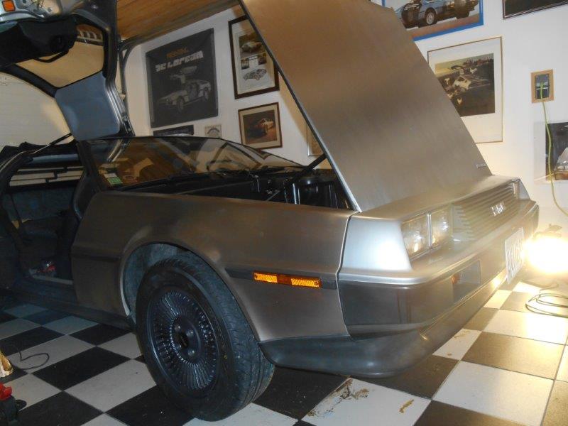

Tonight's work
Let's hope she will start again after all this time :whistle:

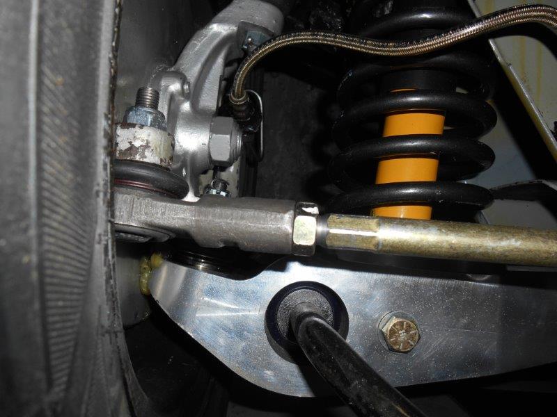

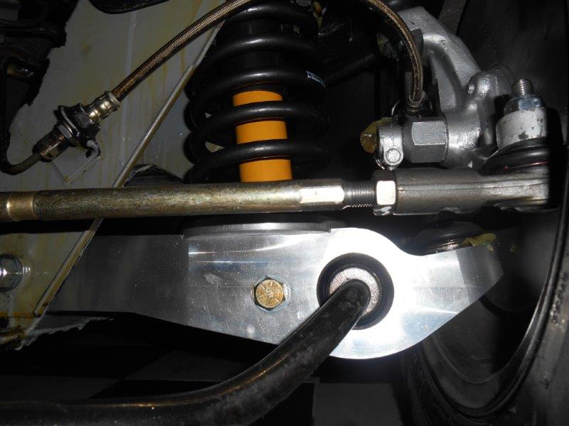

Next, redone the wheels alignment and cross finger I won't have any more bad surprise on the car...

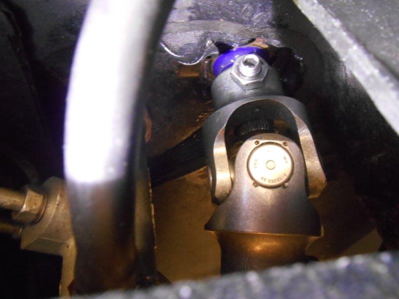

I have these Tie Rod End from Ed, and I need to change the nylok because i need to adjust my wheels and I can't use it anymore.
https://www.deloreango.com/fr/tie-rod-end.html
I bought some nylok at my local store and it doesn't fit, I guess its not the same thread.
i was wondering if you had them in spare, because I don't know which one to choose in the store?
Could you please give me link to order them?
Thanks again for your help :)
Postby arranj » Tue Nov 21, 2017 3:34 pm
I'm pretty sure it is this one - https://www.deloreango.com/fr/nylok-nut ... joint.html - but I will check before sending it out if you order. I have Ed's tie rods ends here too so I can use new nyloks straight from them so they will fit.
Postby Domi » Tue Nov 21, 2017 7:43 pm
All right, thanks.
if you can check them if they will fit before sending, that will be nice :)
Postby Domi » Tue Nov 28, 2017 7:08 pm
Order received today, I've tried the nuts on another tie rod I have on spare and looks like it fits perfectly, thanks again :thumbsup:

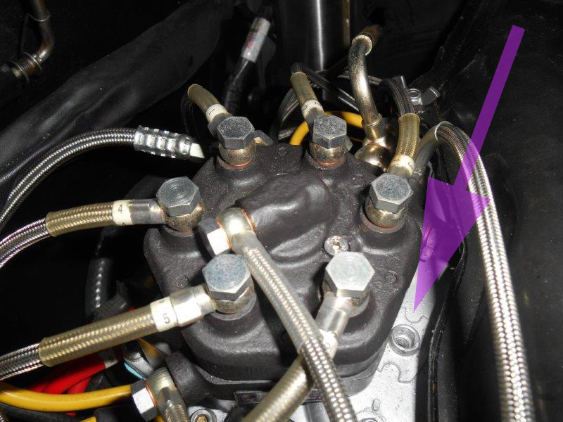

On the other hand, the garage adjust the CO2 of the car and remove my little screw on the kjet?
I don't understand why because I always had this screw.
Same thing on the French forum, everyone is agree to keep the screw to avoid air leak
Postby Admin-bloke » Tue Apr 17, 2018 10:23 pm
Yes, keep the screw/ make sure that hole is blocked
Postby arranj » Tue Apr 17, 2018 11:12 pm
Yes, that's what this this thing is for: https://www.deloreango.com/fr/removeable-co-plug.html
Originally that hole is filled with an "anti-tamper plug", which you need to remove to adjust the mixture. Normally this won't go back in afterwards, and you must fill that hole with something else otherwise the car won't run correctly.

Thanks for the advice, the screw is back on position.

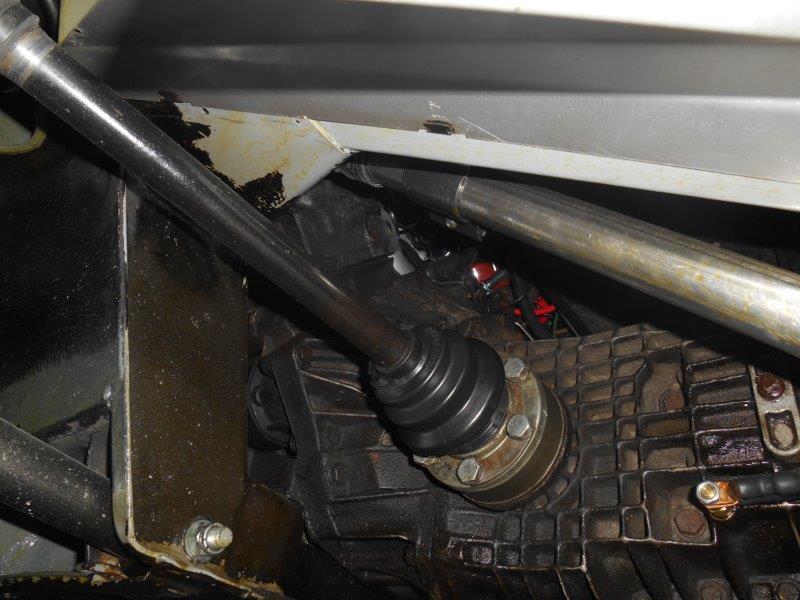

When I was driving, at around 5000 rpm, I was unable to change gear.
I locked the second gear to reach home, then no more first gear or reverse.
I think my clutch is dead, it smell burn...

Make sure your clutch has free play at the pedal at rest, and your gear linkage and cross gate cable have not simply worked loose? Even without a clutch, you should still probably be able to change gears (badly!) once you are rolling??
And if you have to, you can remove the gearbox to change the clutch with the car on axle stands. I did- you can too, for sure. Its not so hard! A busy weekend would see it done if you have all the parts??
