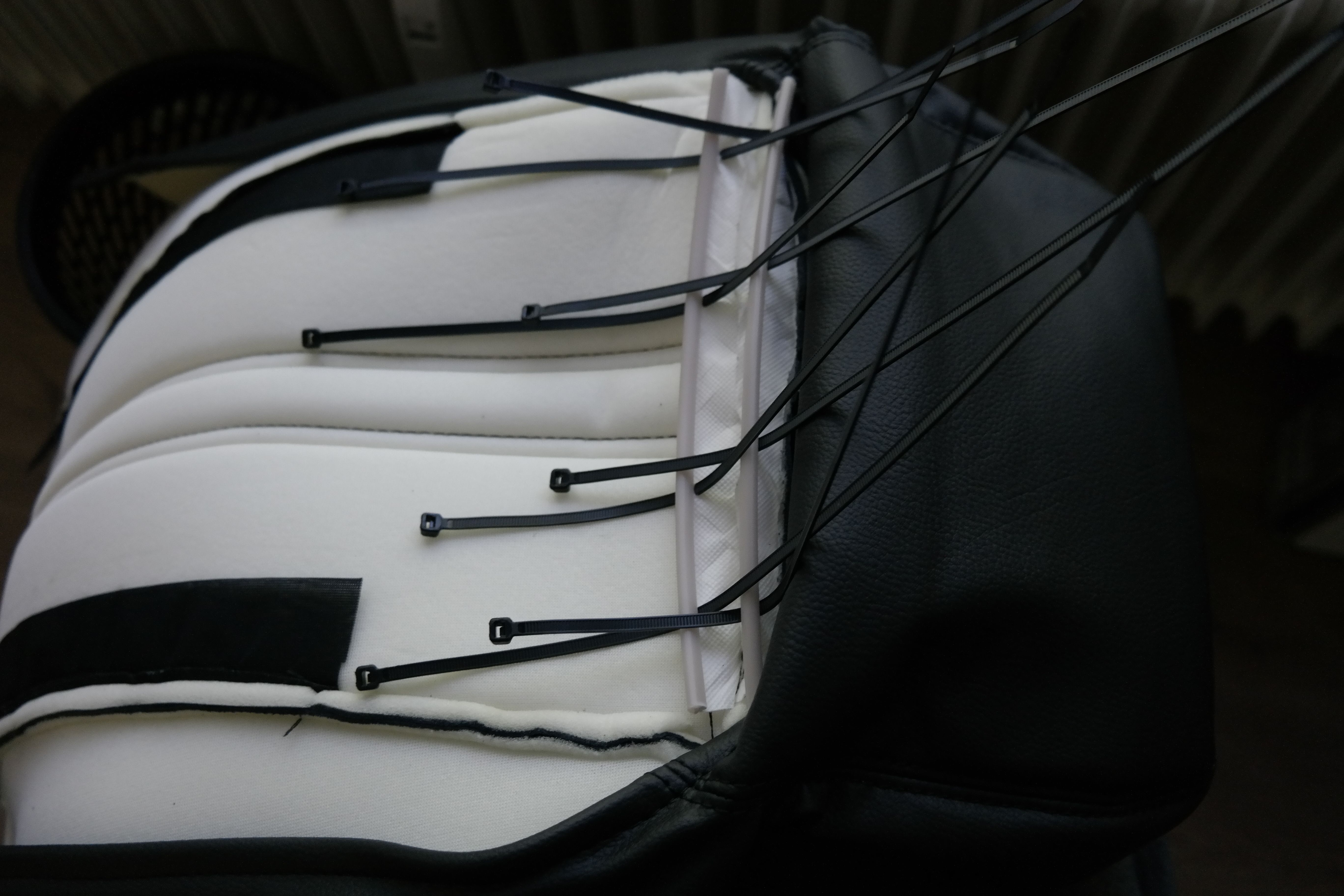

Here's a little progress on the installation of the first seat cover. I managed to find the energy to get the headrest bit on. I used a sheet of plastic to 'slide' the tight bit over the foam, as Ed suggested to me. Instead of using hog rings, i decided to fix the headrest ribs with tie-raps.
prepping
Here you see how they are inserted on the chair, before pulling them tight (top row first of course)

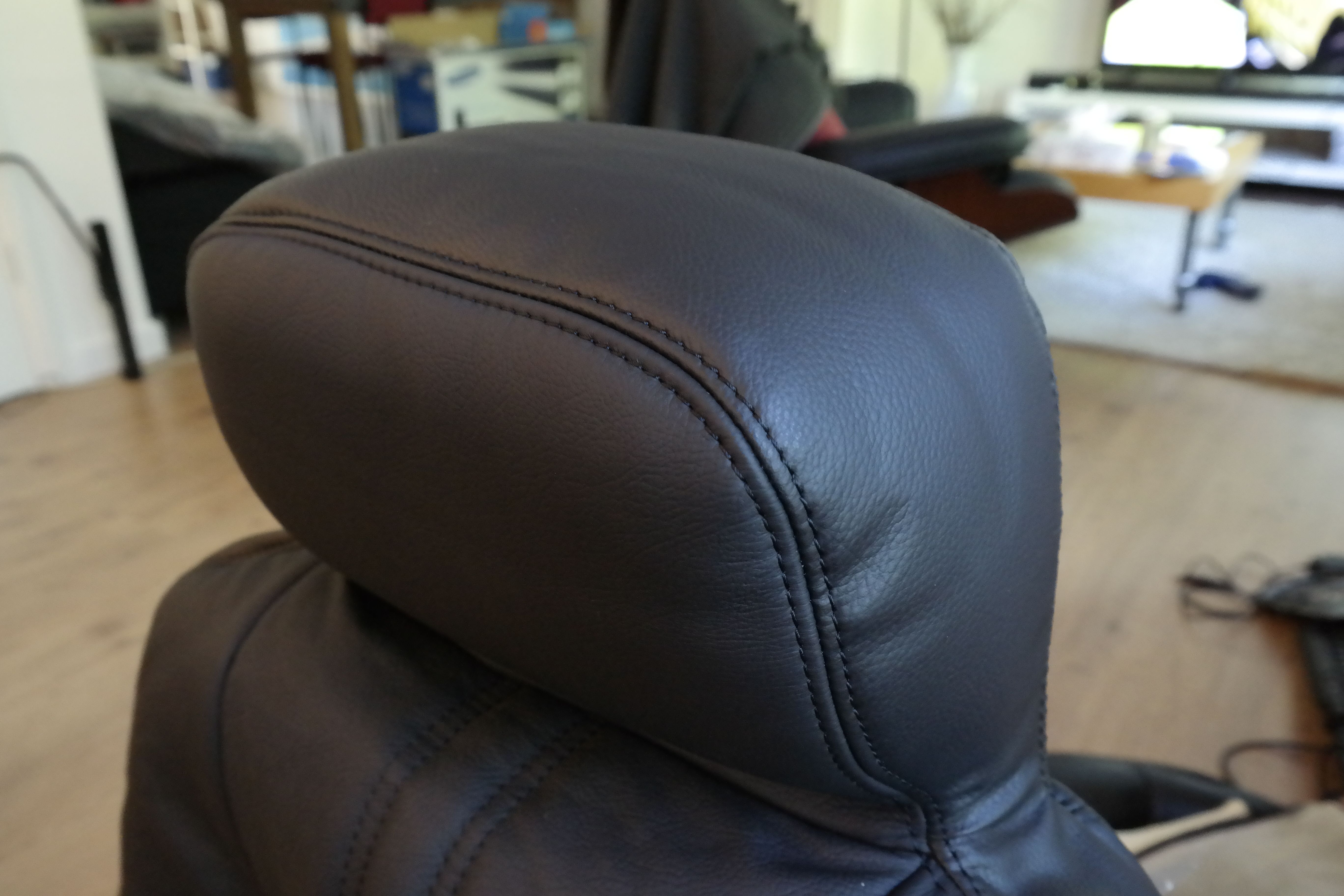

headrest ready for tightning
And here's the result so far.
Headrest!
I thing it's time to call it a day.

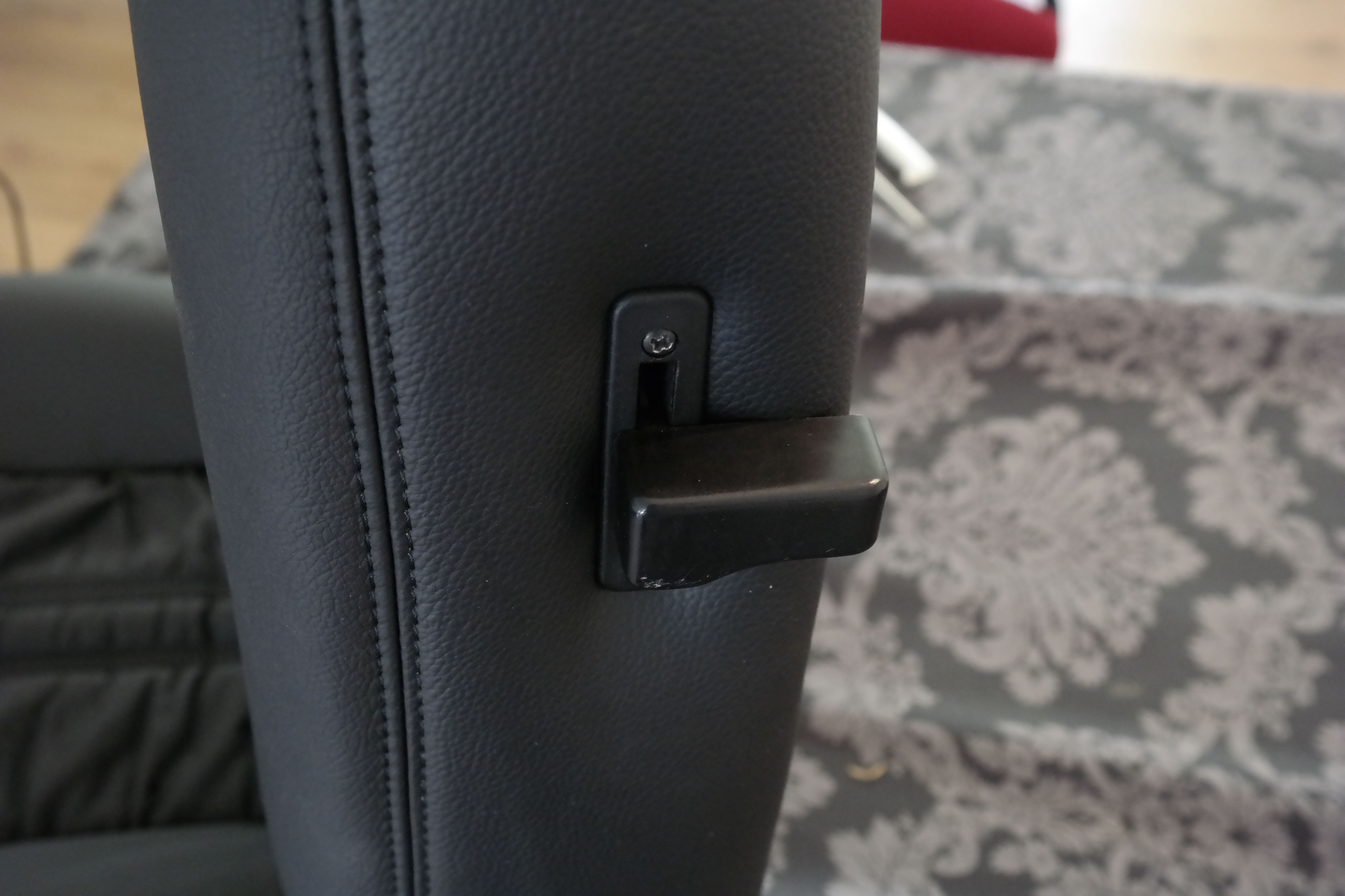

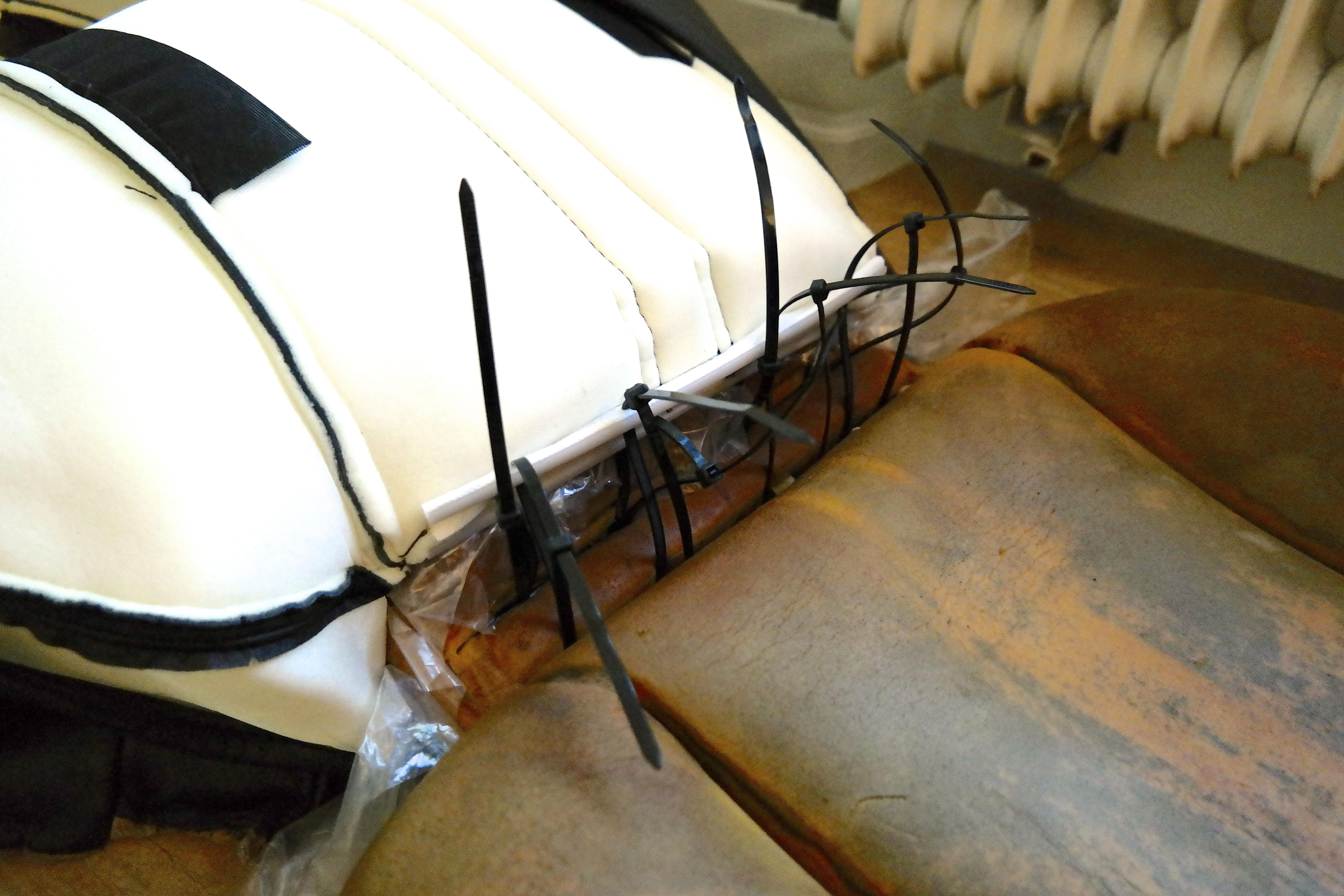

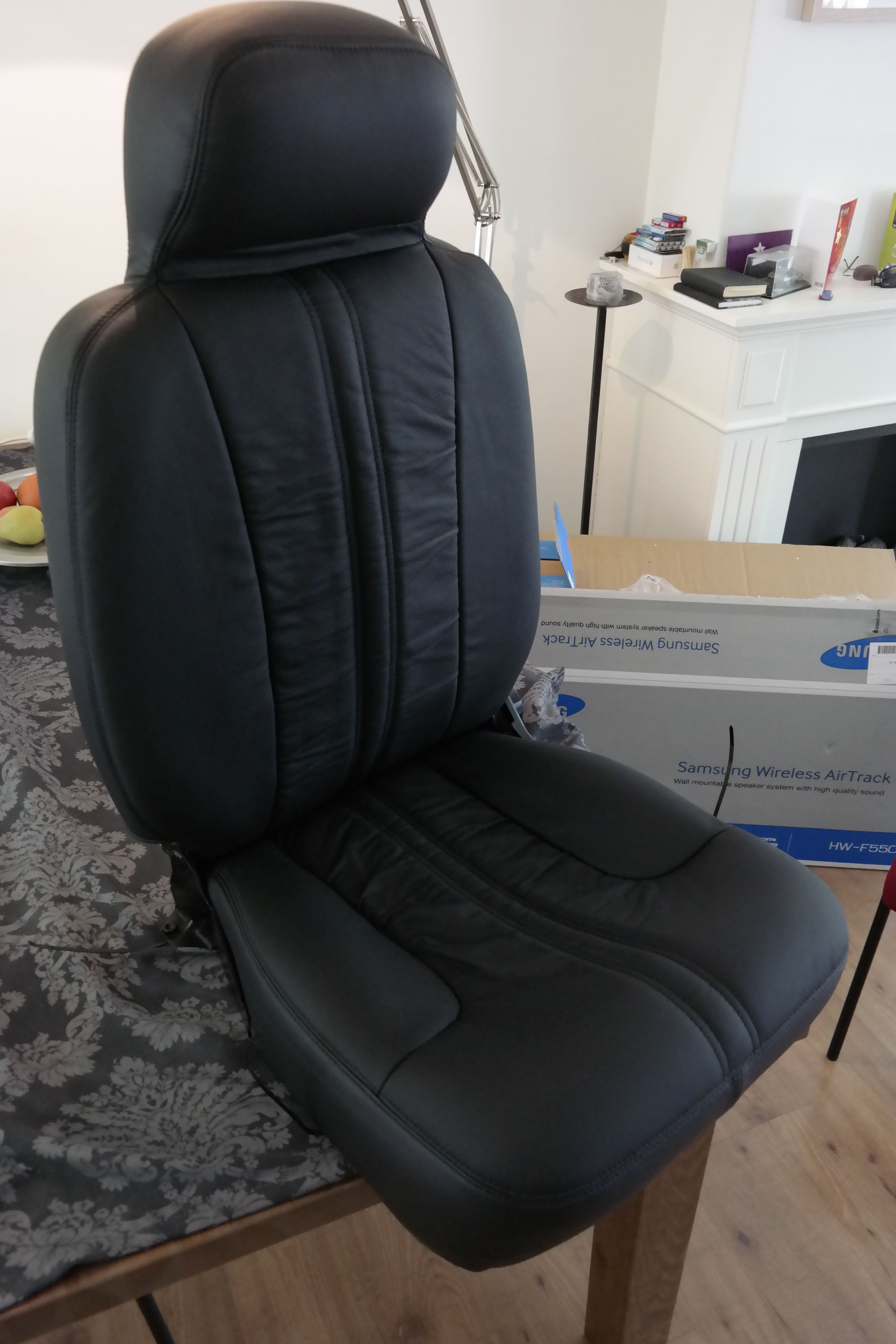

Below is what was accomplished during the weekend. Almost did one chair. I still need to tighten the backseat ribs (should've used tie raps, i'd be done by now), so the back cover can be reinstalled.
chair
Thanks to the warning/advice on cutting the hole for the seat handle, i did a perfect job on that bit.
detail
