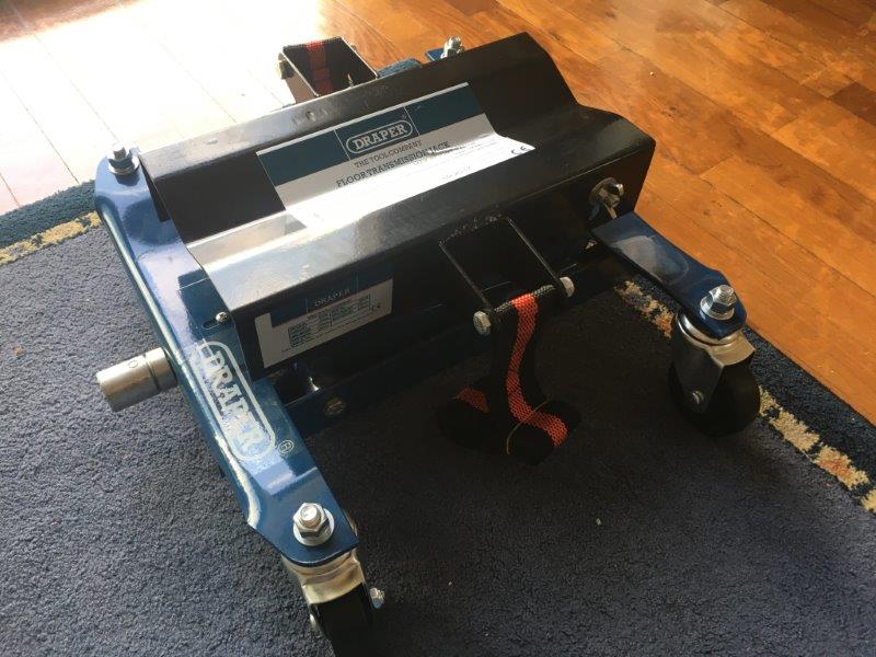

Postby Domi » Mon May 07, 2018 7:08 pm
My new best friend :mrgreen:

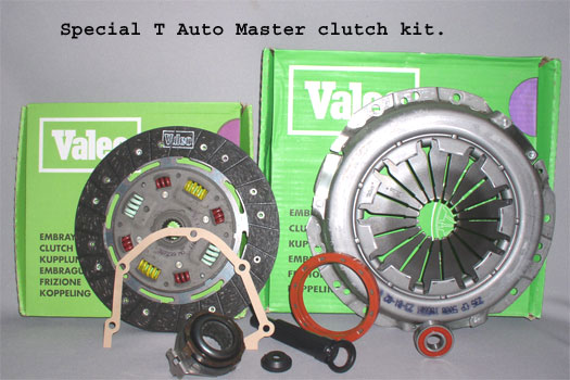

Hello everyone, it’s already been a long time since my last message.
I was working on my house, so the car had to wait until now…
I would like to order a kit like this one from J. Hervey but here.
I need your help to tell me if everything in the picture above is in my list?
https://www.deloreango.com/fr/complete-clutch-kit.html
K102512 Valeo Clutch Kit
221,99 €
102024 Crankshaft Rear Main Seal (double lipped)
12,99 €
102022 Rear Seal Gasket
1,25 €
102569 Flywheel Pilot Bearing (SKF)
15,99 €
https://www.deloreango.com/fr/clutch-al ... -tool.html
Clutch Alignment Tool
21,99 €
I will be on holidays in the next few weeks, so I'll be able to order soon.
Once again, thank you very much for your kind help.
Postby arranj » Tue Jul 10, 2018 7:11 pm
In your picture, but not on your list, is this:
https://www.deloreango.com/fr/clutch-re ... l-cap.html
Otherwise - yes, that's it.
Postby Domi » Tue Jul 10, 2018 7:20 pm
Thanks again, I will order when I will be back at home.
Postby Slammer » Tue Jul 10, 2018 8:06 pm
And even a throwout bearing.

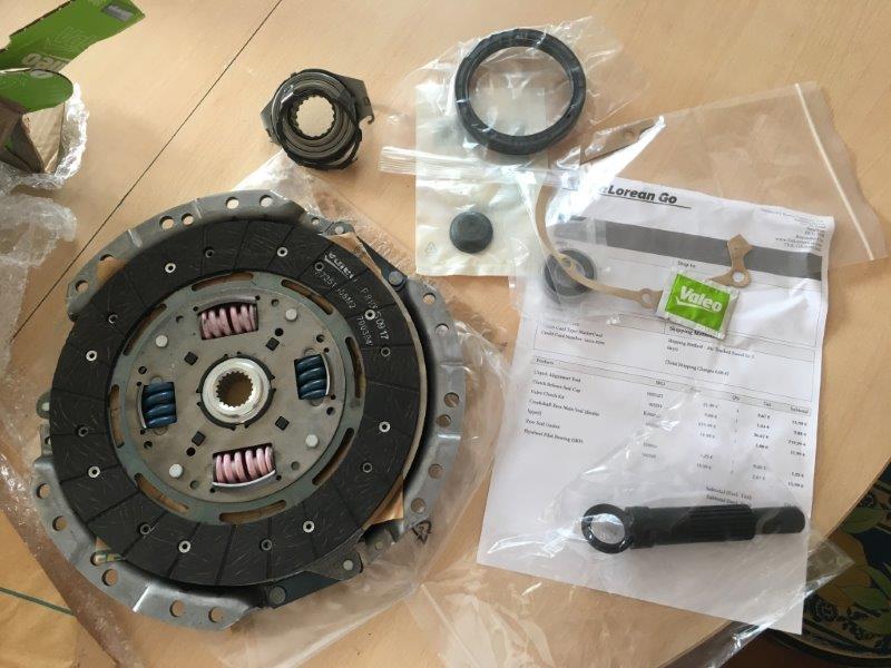

Postby Domi » Wed Jul 25, 2018 4:33 pm
Hello, order done just today :)
Postby Domi » Sat Jul 28, 2018 11:21 am
Parts received today, that was really fast!!!
All I need now is to find some free time to begin the job...
