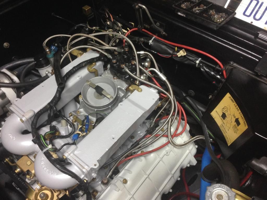

Installed the t panel aligned it.
Fitted the Renault alpine spark plugs and set up the engine intake and fuel components ( for the 4th time)

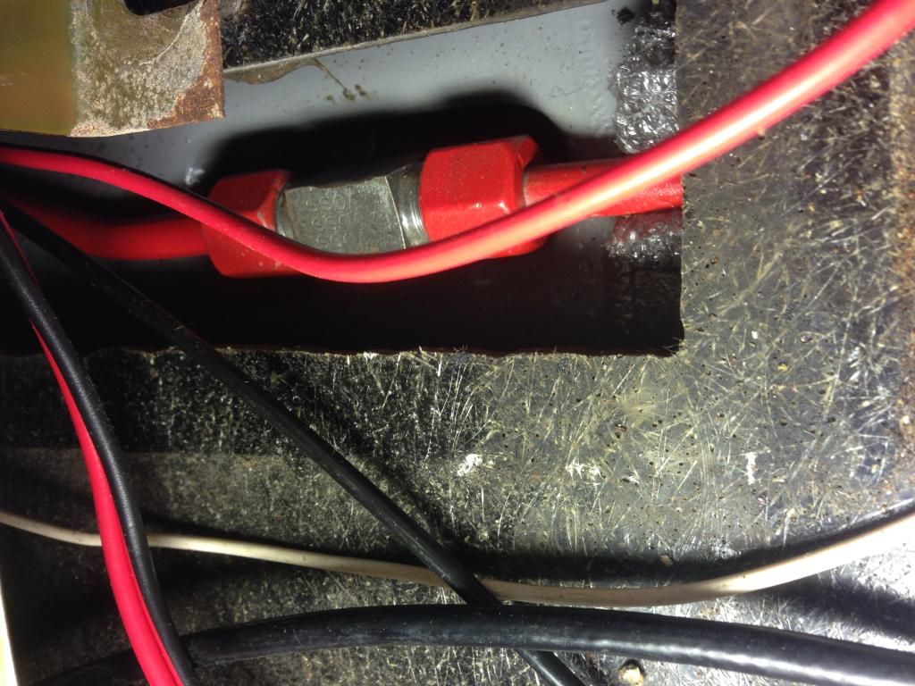

Battery negative lead goes through body tub to the chassis. Check all earth points of wiring loom connect to the battery.
The connections to the chassis and from chassis to engine at the rear must have a good electrical connection. If you have painted your engine, you must clean the flex cable connection back to bare metal. ..

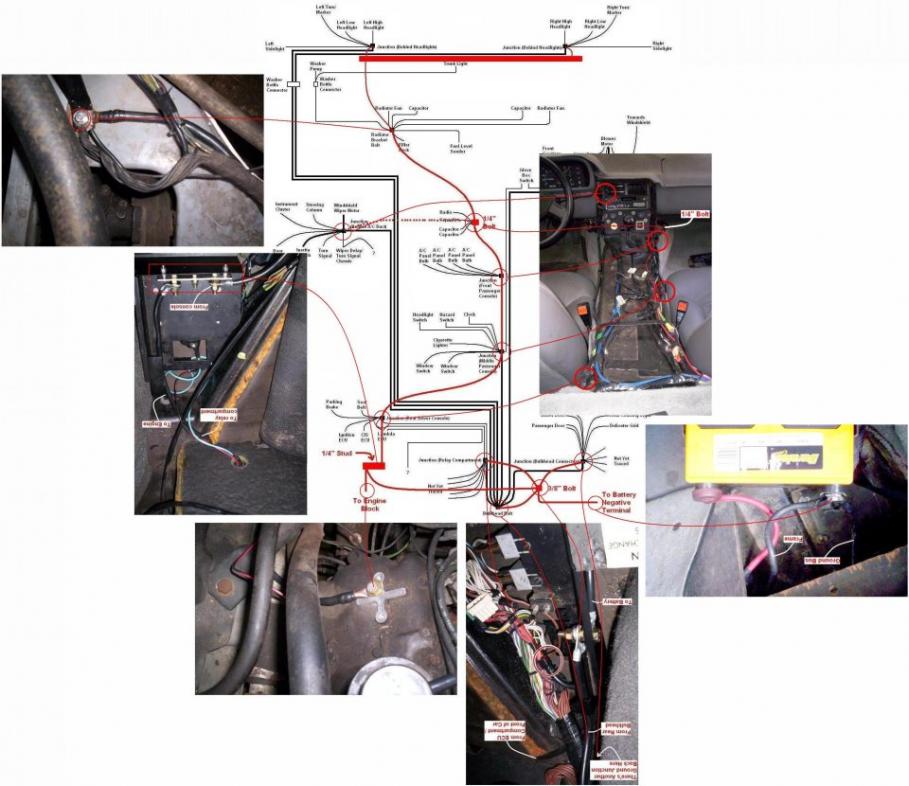

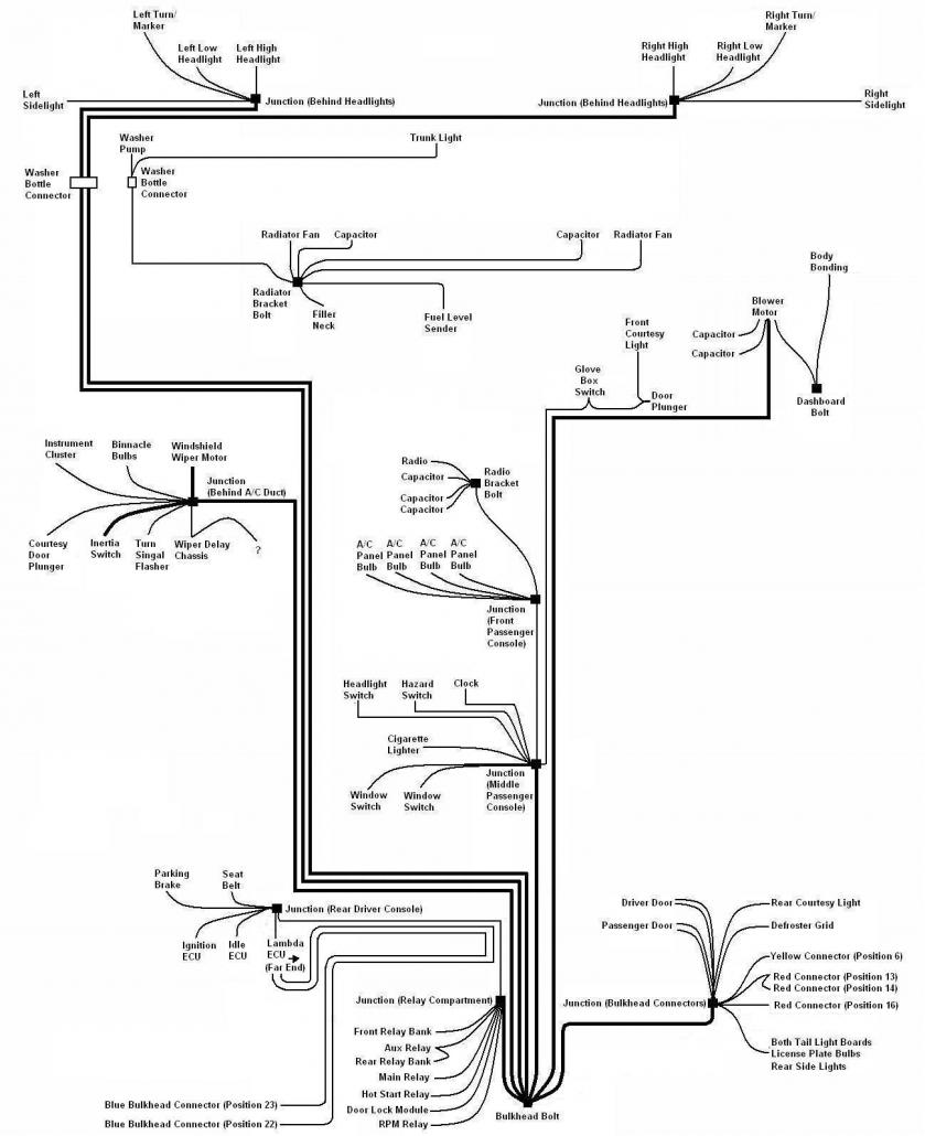

I'm not sure if can help you with this, but checking the ground point for the instrument panel/cluster is what comes to mind. So I grabbed these from DMCTalk:
Postby ALEXAKOS » Thu Oct 23, 2014 6:01 pm
Thank you rob! Yes I see the front harness ground points are mentioned too. Maybe I need to set those up and o from there;)
