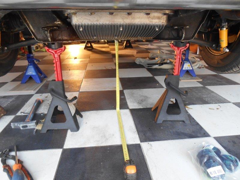

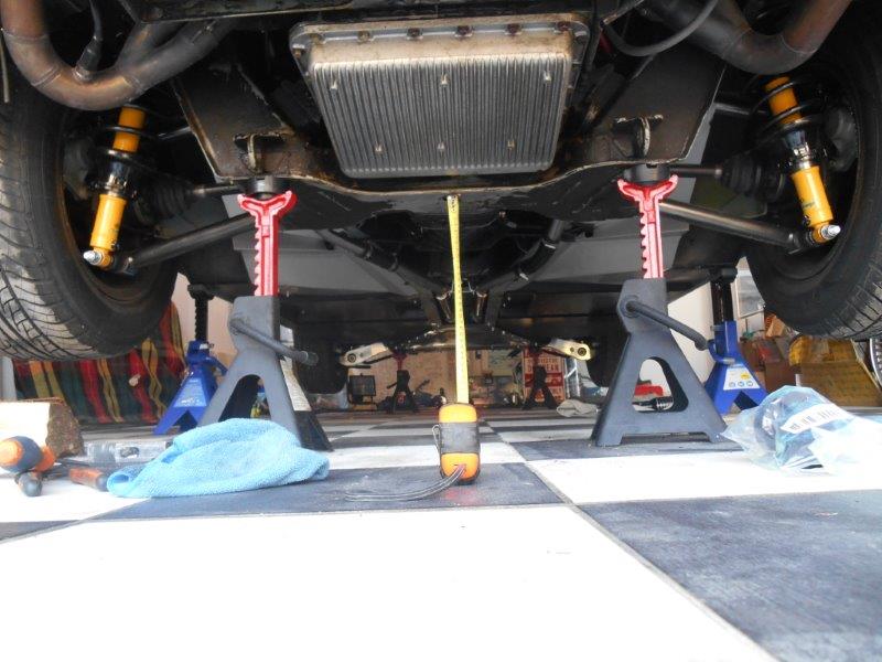

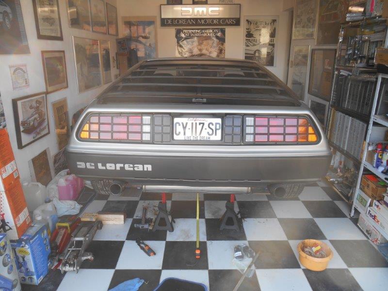

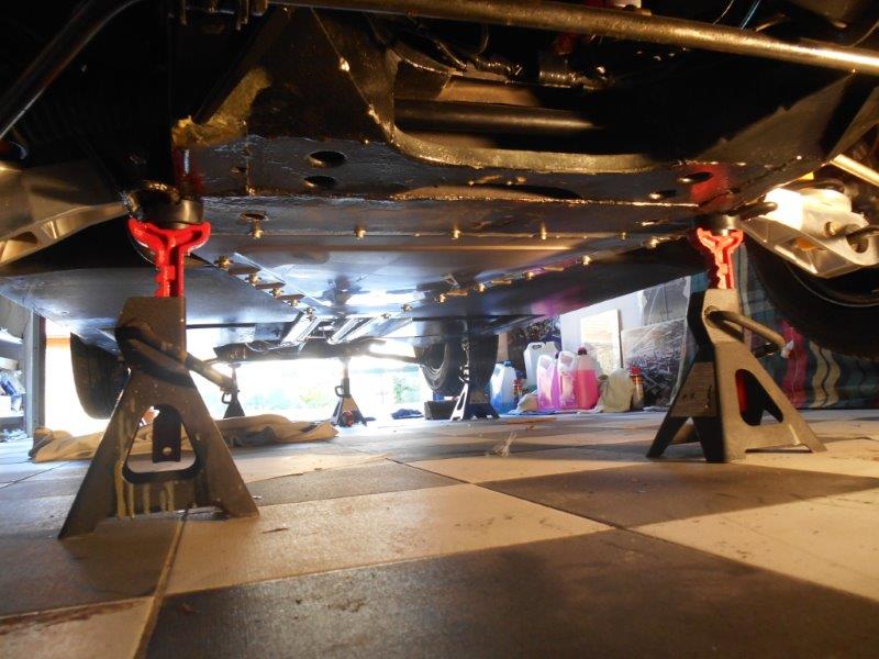

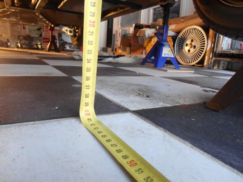

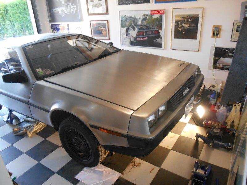

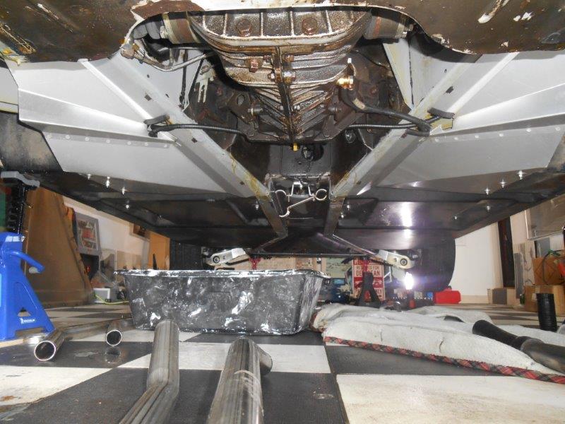

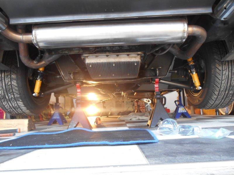

A few news from today, I just lift the car on jacks
For now it is 40 cm away from the ground, I don't know if it will be enough to get out the gear box on my little cart...
Postby andyd » Sun Sep 30, 2018 9:00 pm
Probably ok Domi?
I had wheels, driveshafts, brakes and shocks off when I had my box out, which may have been easier...
Good luck! The box doesnt sit perfectly on the jack, and thd engine will tilt when you remove the box, so you need to re-level it with another jack to get the box back in. But thats a little way down the road. Glad you ard able to start working on it again!

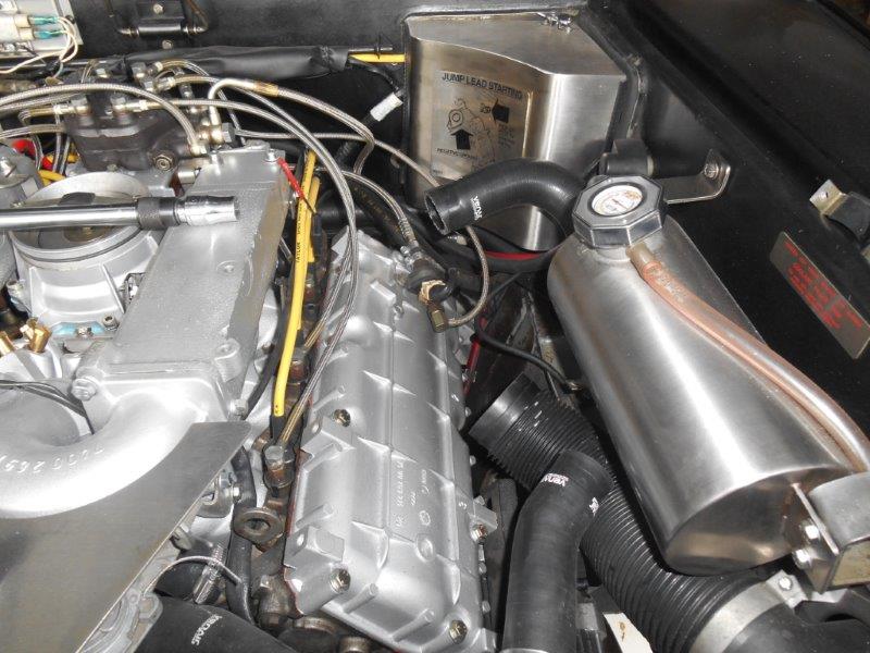

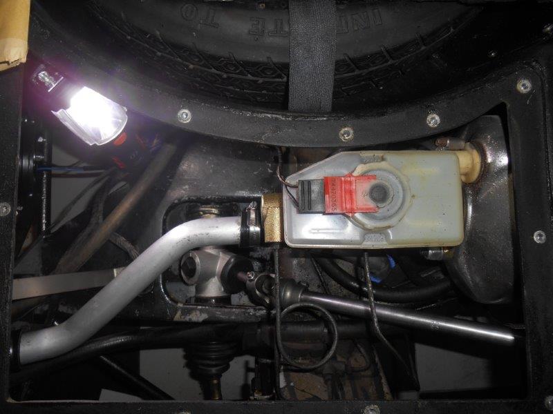

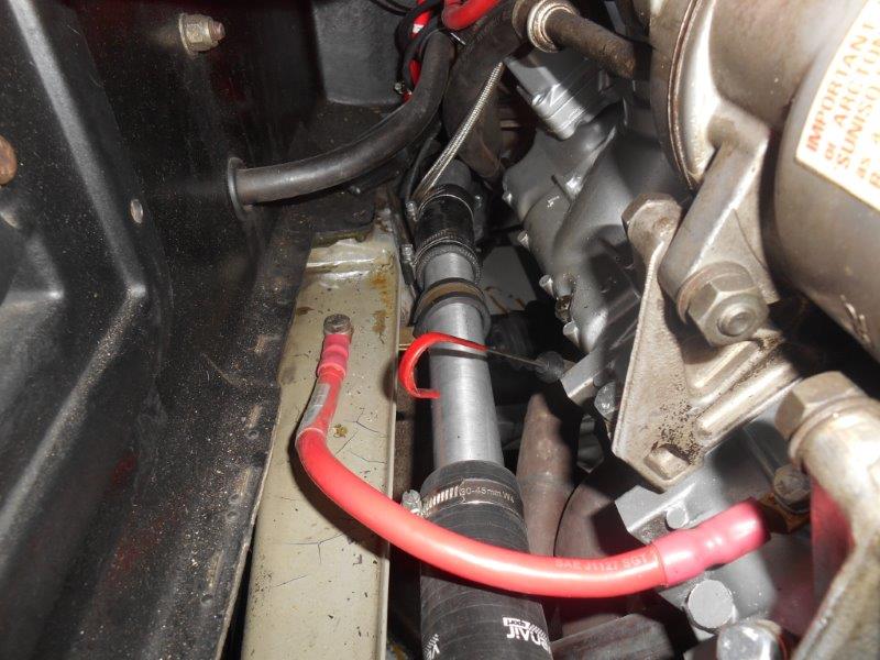

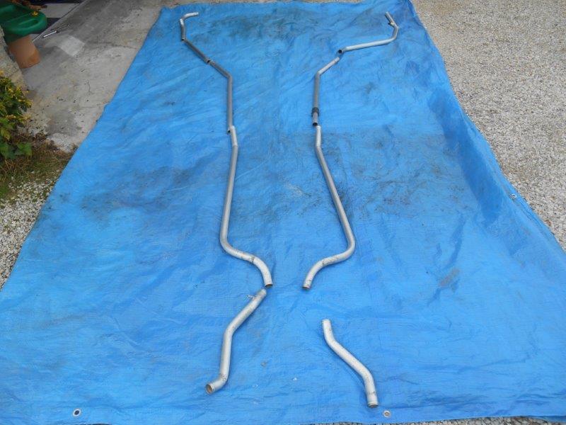

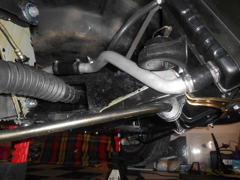

Postby Domi » Sat Oct 06, 2018 6:10 pm

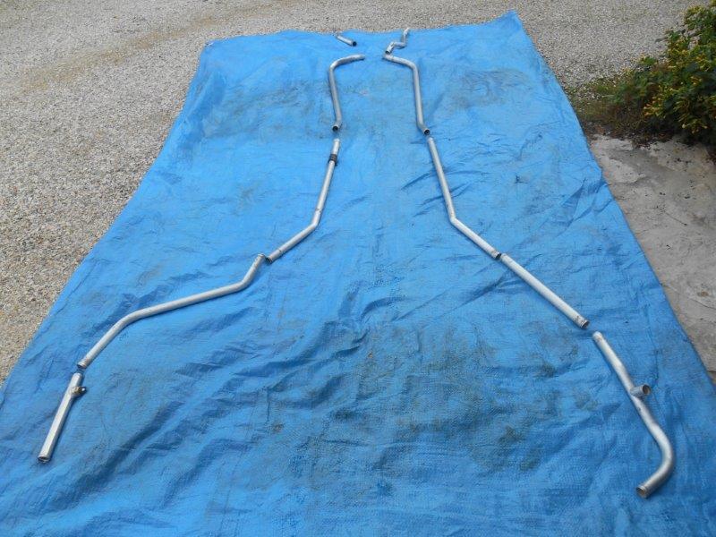

First of all, I'm going to replace my pipes and get back to the original after a good cleaning
Postby cis6409 » Mon Oct 08, 2018 2:48 pm
Tedious job but will be well worth it in the end.. Amazing the dirt that gets baked on to them pipes!
Posts: 747
Postby Domi » Mon Oct 08, 2018 5:27 pm
Yes, they will be nicer after a good cleaning (I hope so)

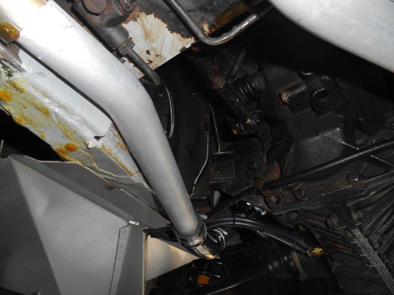

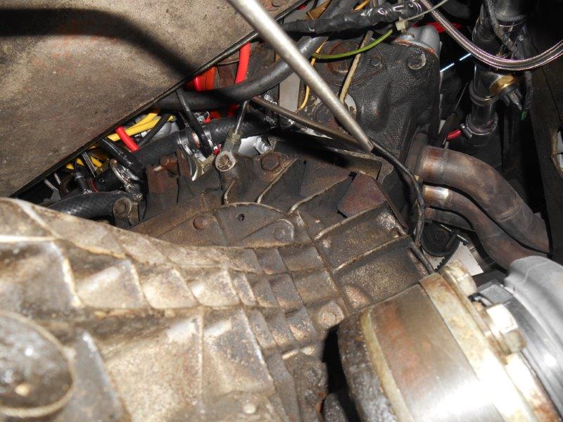

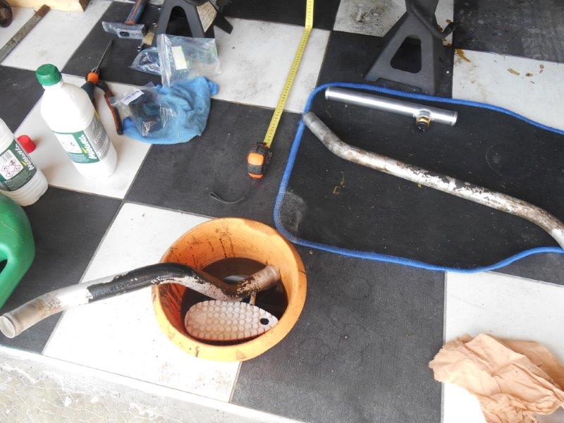

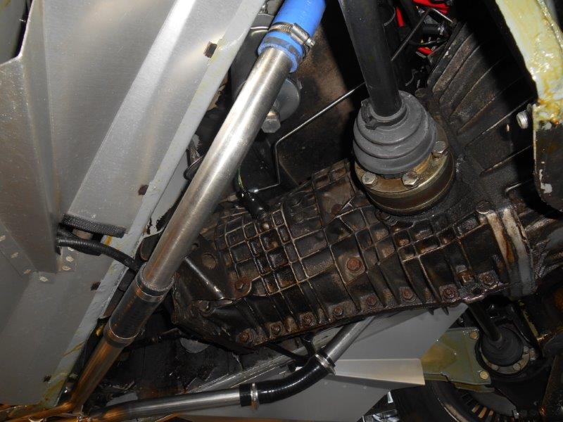

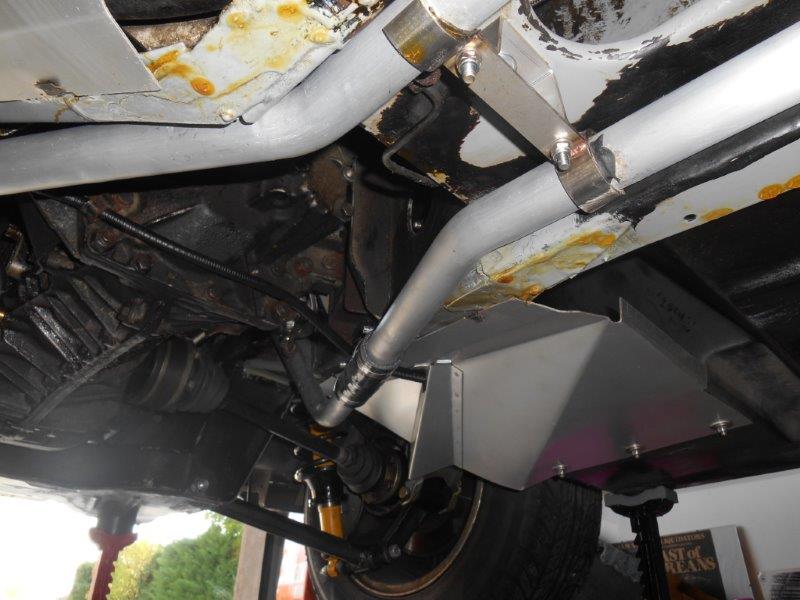

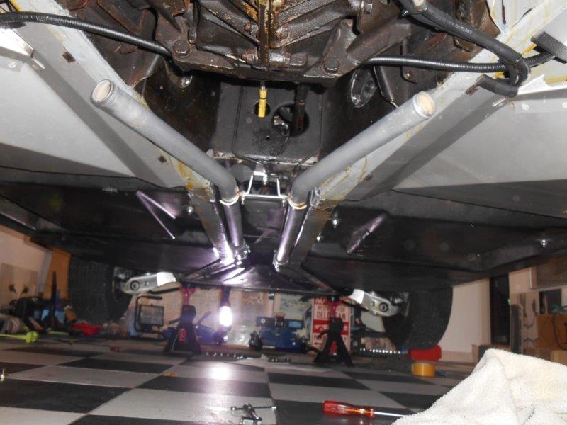

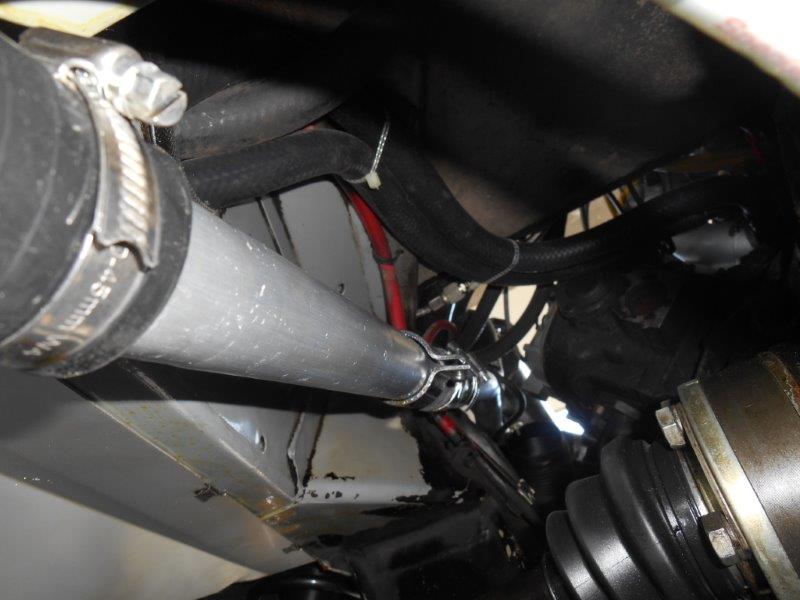

Postby Domi » Sun Oct 14, 2018 8:30 pm
Today I have finished of dismantling the old pipes to get back to the original ones which solved my steering problem.
Still four left pipes to mount and the job will be done, just flush of liquid.

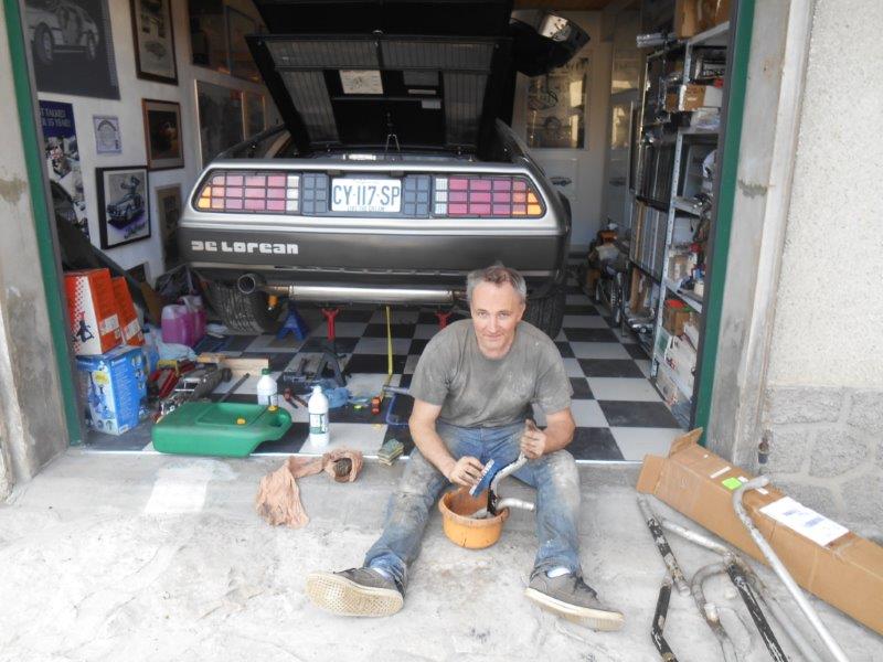

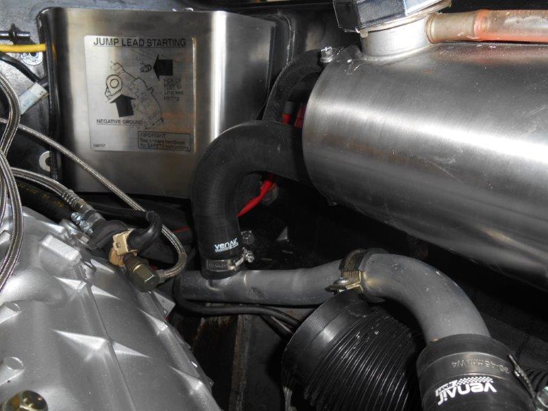

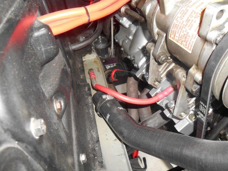

Postby Domi » Sun Oct 21, 2018 4:55 pm
All pipes are now back in the car, just need to put some water in the tank and it will be fine

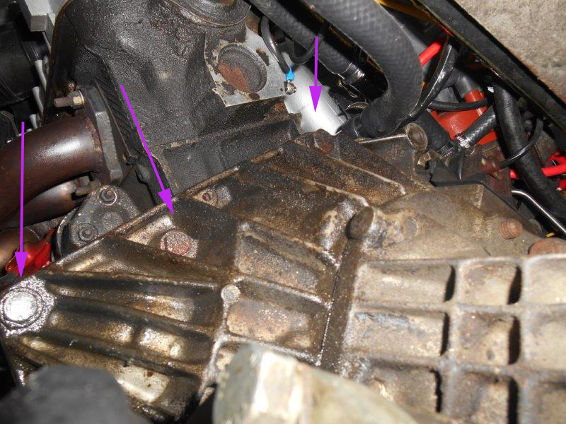

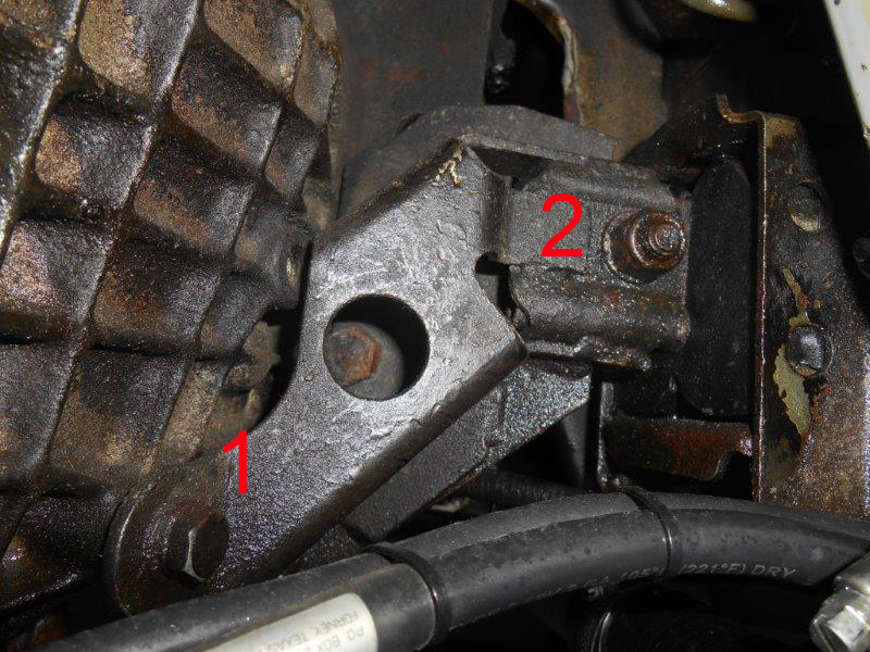

Next step, the gear box…

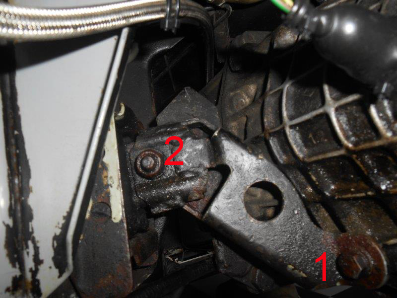

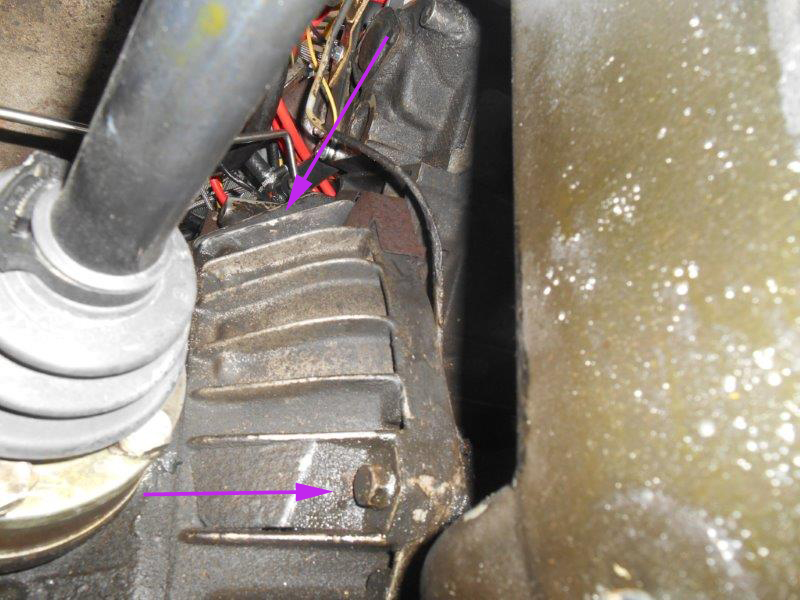

If I see correctly, there is only 4 rear bolt to remove?

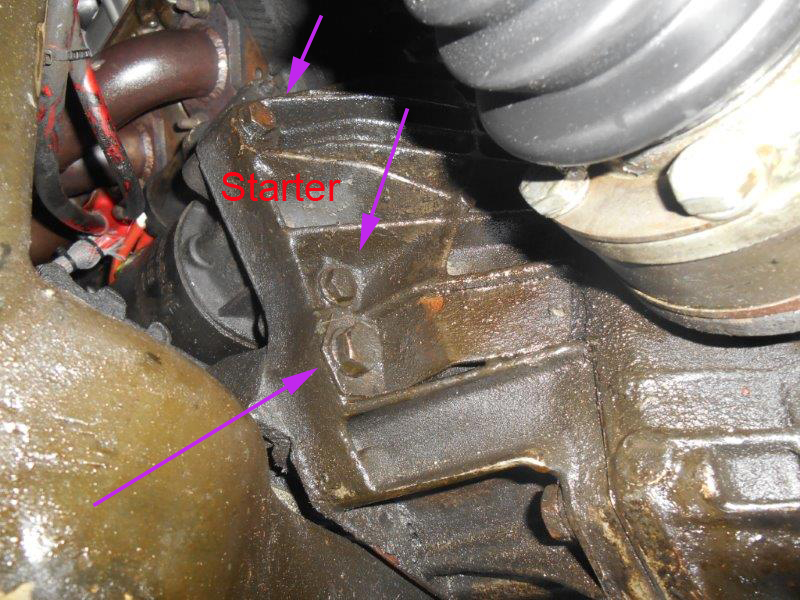

Apparently, 2 more for the starter?
And for the bracket, screw number 1 or number 2?
And of course the manual shifting

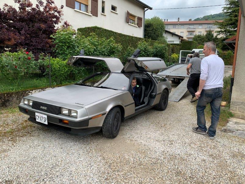

Postby Domi » Sat May 18, 2019 6:36 pm
Can't do the job alone, so the car is going to a mechanic...
Postby cis6409 » Mon May 20, 2019 3:17 pm
Sometimes it comes to that domi, but hopefully it ll be sorted in no time... With a mechanic and lift it should be sooo much easier
Best of luck with it!
