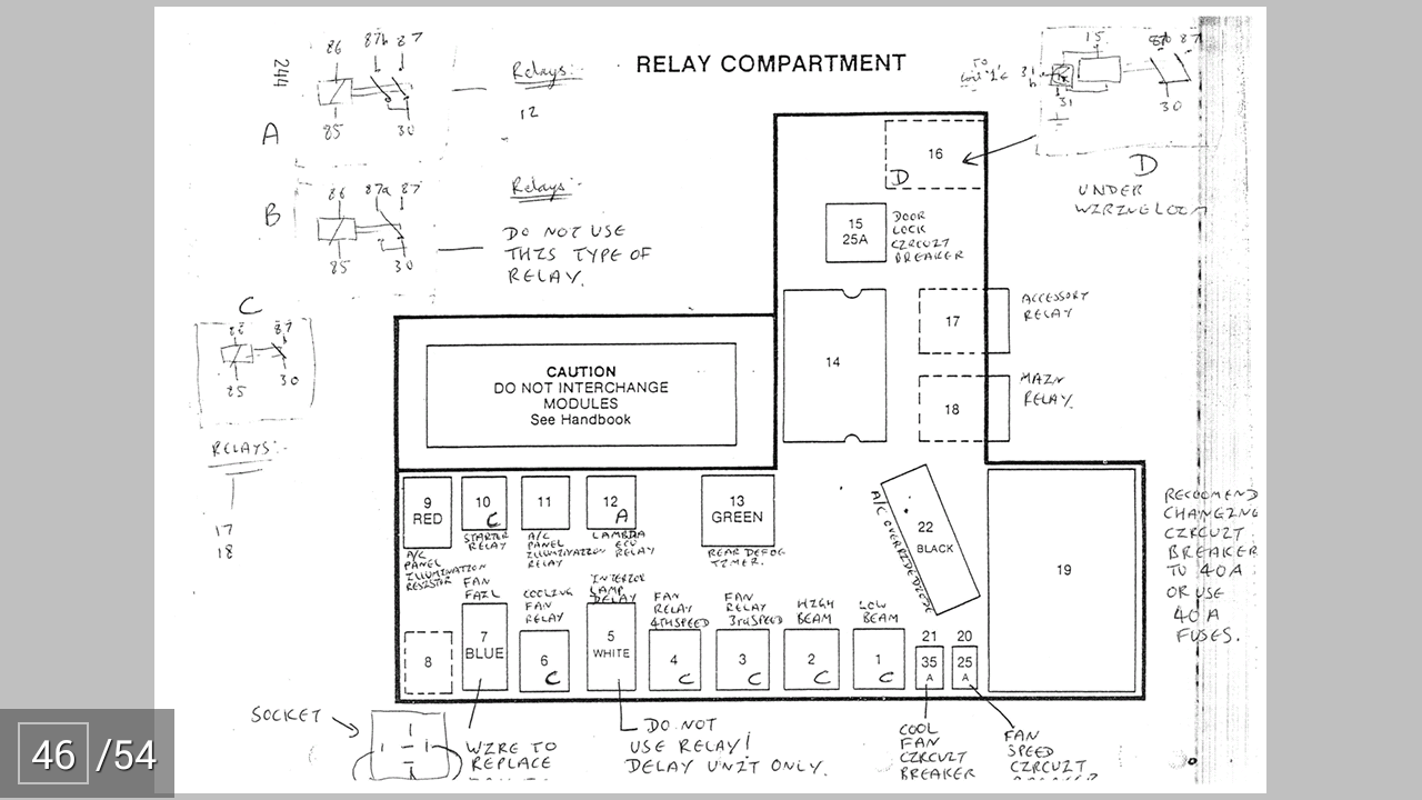

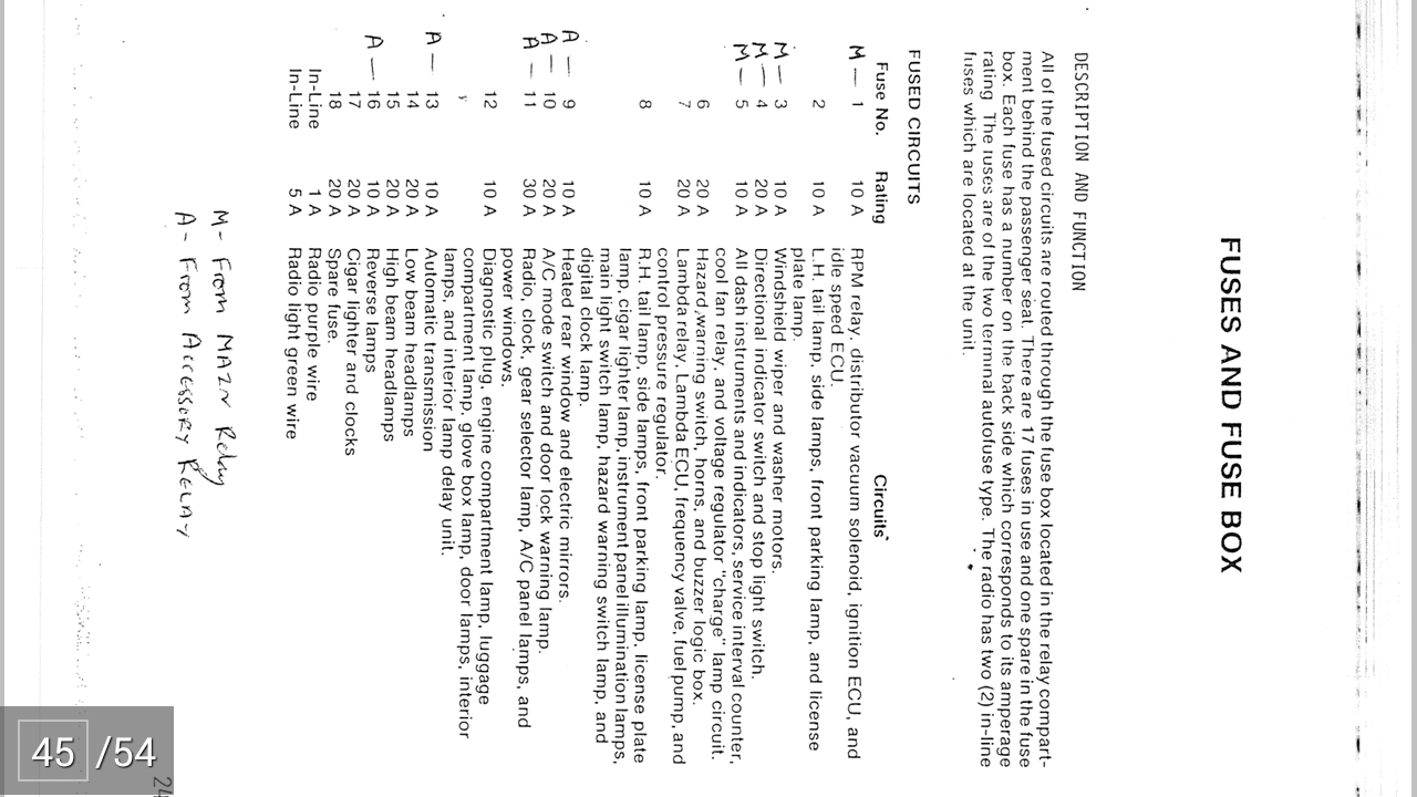

Postby Admin-bloke » Thu Oct 23, 2014 7:14 pm
Not finished yet...
These are my notes for relay types and locations including what fuses are powered by which relays. .....
Enjoy.
(C) Deloreanclub - pen notes by NickT

Postby ALEXAKOS » Fri Oct 24, 2014 9:17 am
There they are
And this is the wiring.... Checking...
Postby ALEXAKOS » Fri Oct 24, 2014 9:42 am
Fukinell! Relays look nothing like the one on the diagram... Wires are different... For one I had not altered any wiring to begin with. Tested relays. One transmits power, the other doesn't (I assume and hope it's the starter relay when in position 2)
