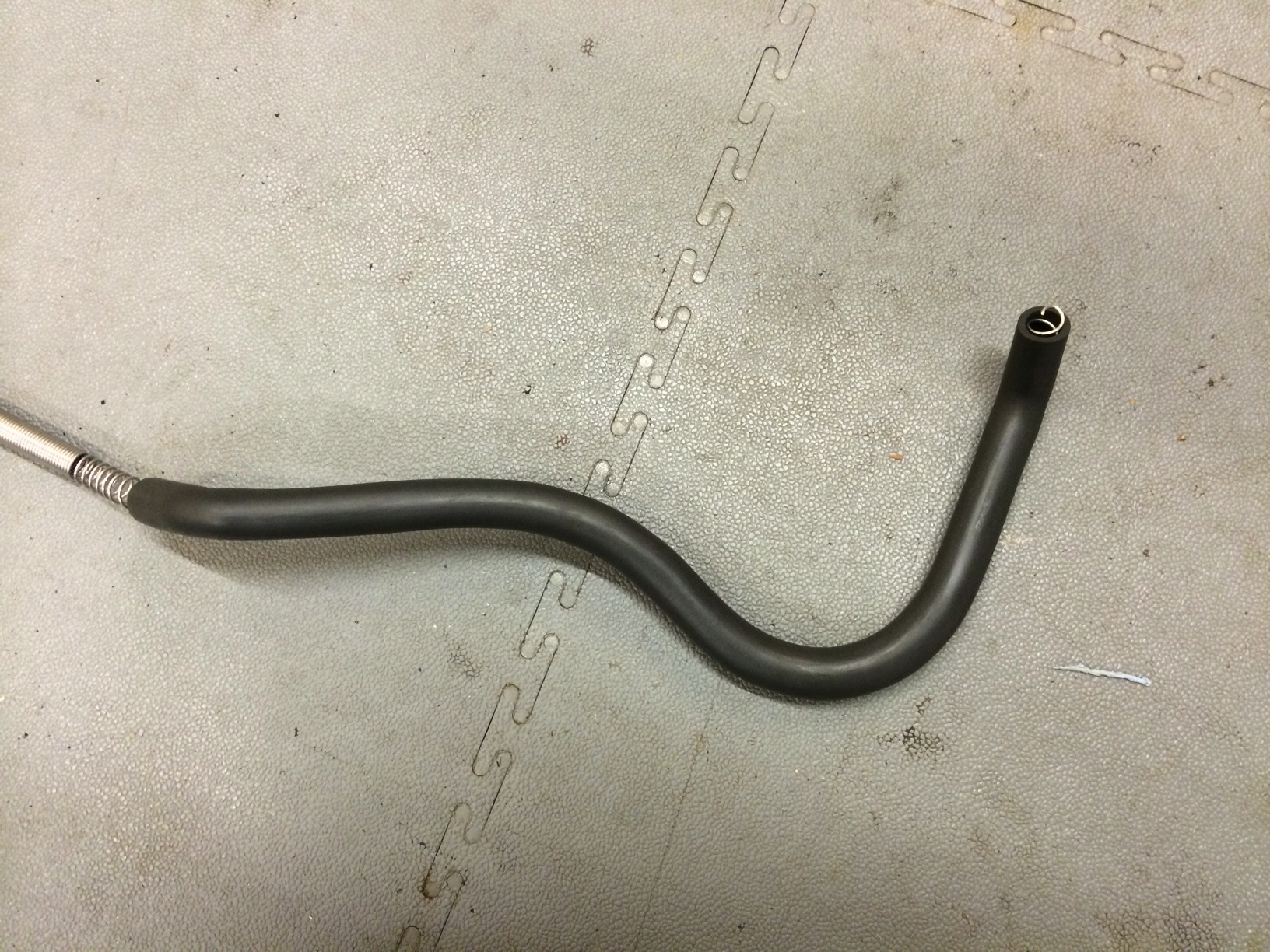

Turned out the flexi hose had rotted out and just fell apart in my hand. Renewed the hose with some new injection pipe.

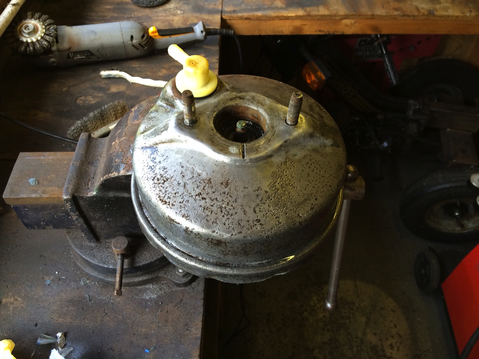

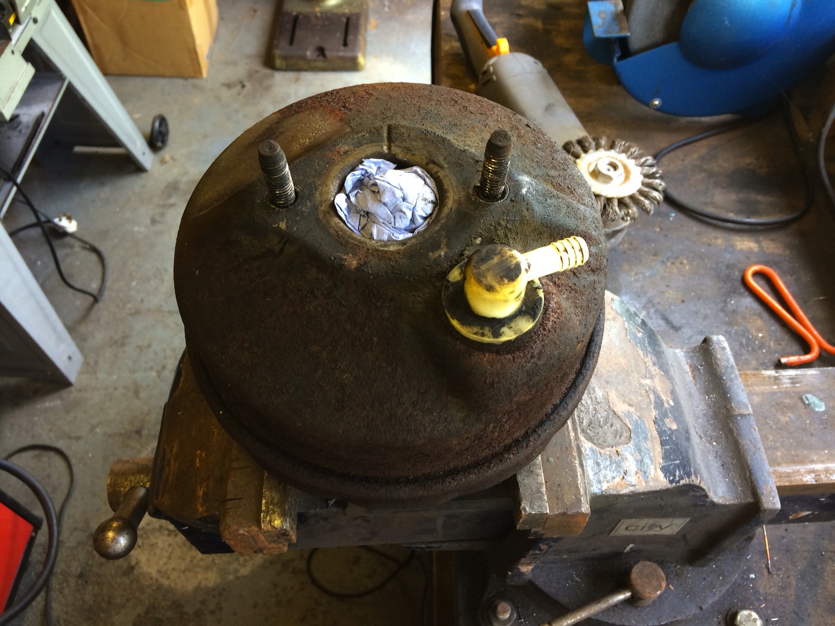

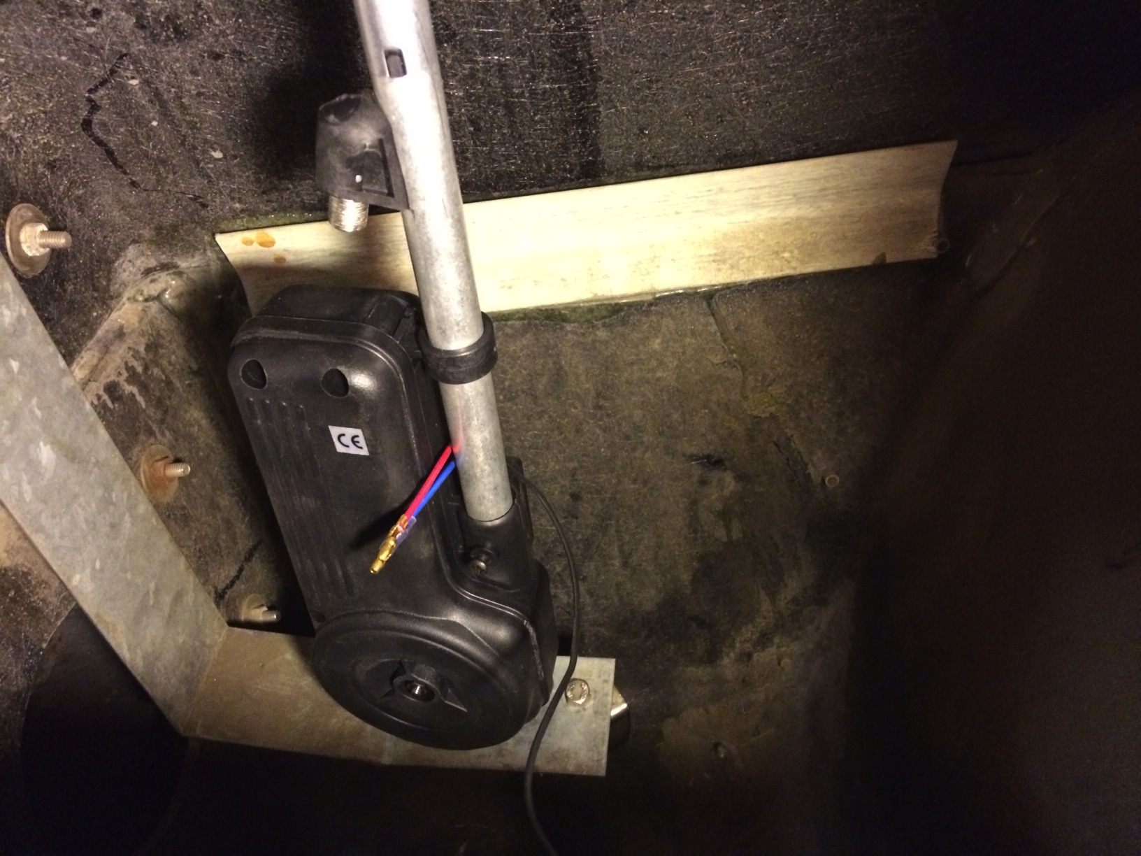

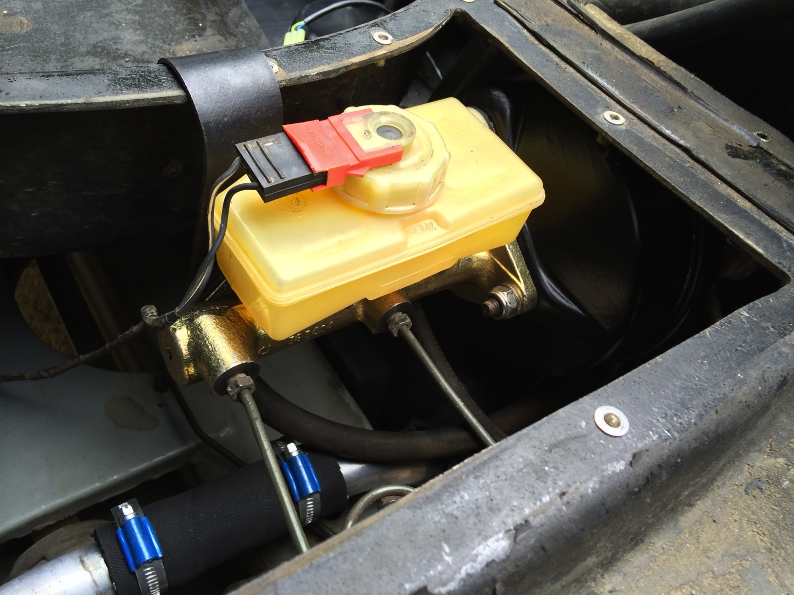

Also changed the brake master cylinder and stripped and painted the brake servo, and fitted a new electric antenna.
