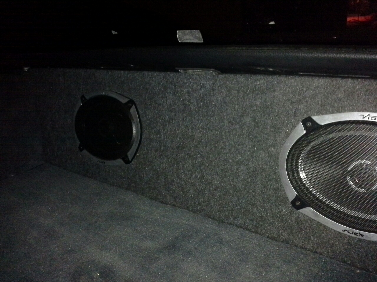

Postby andyd » Sat Feb 20, 2016 9:57 pm
Rear panel fitted with speakers, will post some pics tomorrow. Colour of the felt I bought turned out to be spot on.

Postby andyd » Wed Feb 24, 2016 12:18 am
Terrible pic.
Shite speakers.
And I am delighted with the result!
I'm not a stereo snob, and the D is never going to be very good for this, but I can play banal rock music reasonably loud.
May do the fronts at some point but will need to make boxes to fit the foot wells.
Tho I now have the MDF and covering so if nothing else breaks then you never know! :dance:

Postby jerzybondov » Wed Feb 24, 2016 12:25 am
That's a good job Andy! How much depth have you lost off the shelf do you reckon?
Are you still running the original fronts? You can do a straight swap to modern 4" speakers which is relatively straightforward and a worthwhile improvement. Did you disconnect your original rears?
I've gone for the sub in the cubby solution, was a bit of a faff with amps and shit but it makes a big difference.
