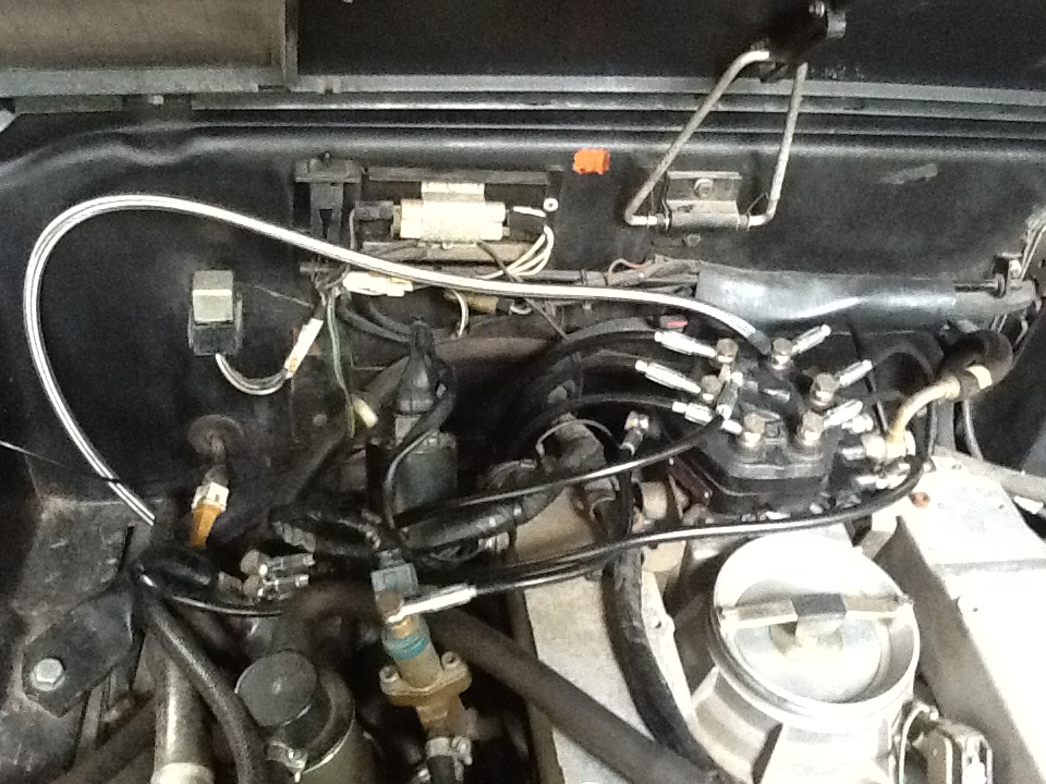

Got the stainless injector lines installed last weekend. Got them from Ed. Happy with how it turned out.
I never did get a replacement return fuel line from the club or hell for the one that did not fit.
Anyone has an update on that? Bandit maybe?

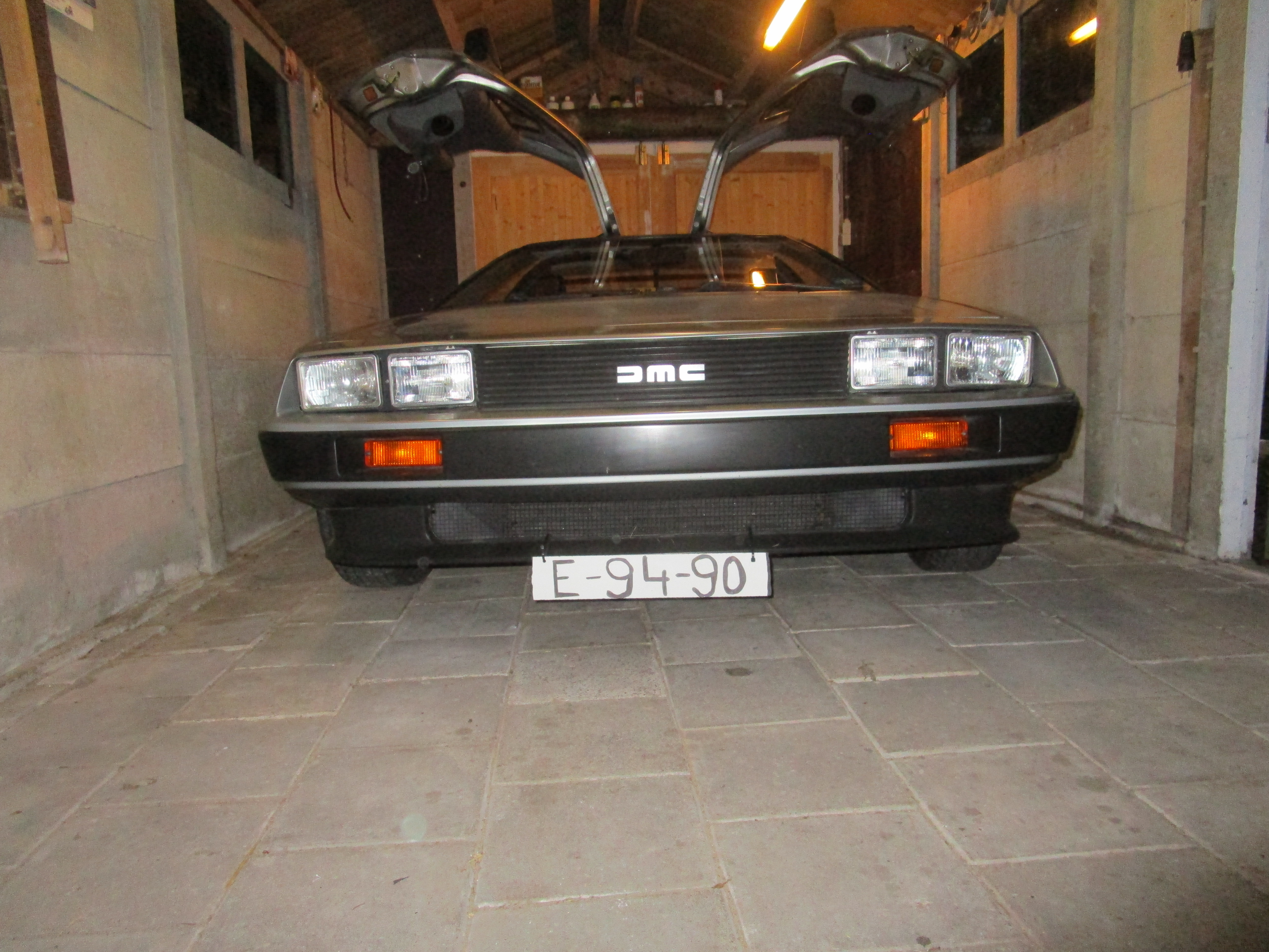

Here is a pic of the car with the temporary tag on it. Need to find a way to get the new plate on the front. I am getting the Usa style (size) plates. Don't want to make any holes in the bumper. Who has a good picture on how to put the licence plate on the front?

Postby arranj » Sun Jul 17, 2016 12:39 pm
http://www.deloreanclub.uk/stainless-fr ... acket.html
This ingeniously designed, stainless steel, bracket mounts between the rock screen and fascia using the existing bolts that hold the top of the rock screen to the fascia.
Supports all sizes of plate, with no changes to the car. It is mounted in a way so that the plate is in the "normal" position of on the black bumper, just below the "dmc"

Postby Delta Delorean » Sun Jul 17, 2016 6:09 pm
Ordered!
Seen it before on a car in the Usa. Had no idea it came from the club. Maybe a good idea to have the stainless parts together in one section like Ed has on his website?

Postby jamesrguk » Wed Jul 20, 2016 9:54 pm
Also self adhesive black Velcro is perfect for the front plate, easy to remove if needs be and no holes drilled.
Done ok for the past 16years on my car
James
Re: Vin 5823 arrived in The Netherlands today.
Postby RobvdVeer » Wed Jul 20, 2016 10:53 pm
If i recall correctly, Velcro was designed by NASA during the Apollo era (probably Gemini project). I absolutely trust the velcro, but not the glue that sticks the velcro to the plate, which is probably some Chinese 3M ripoff. :shock:
