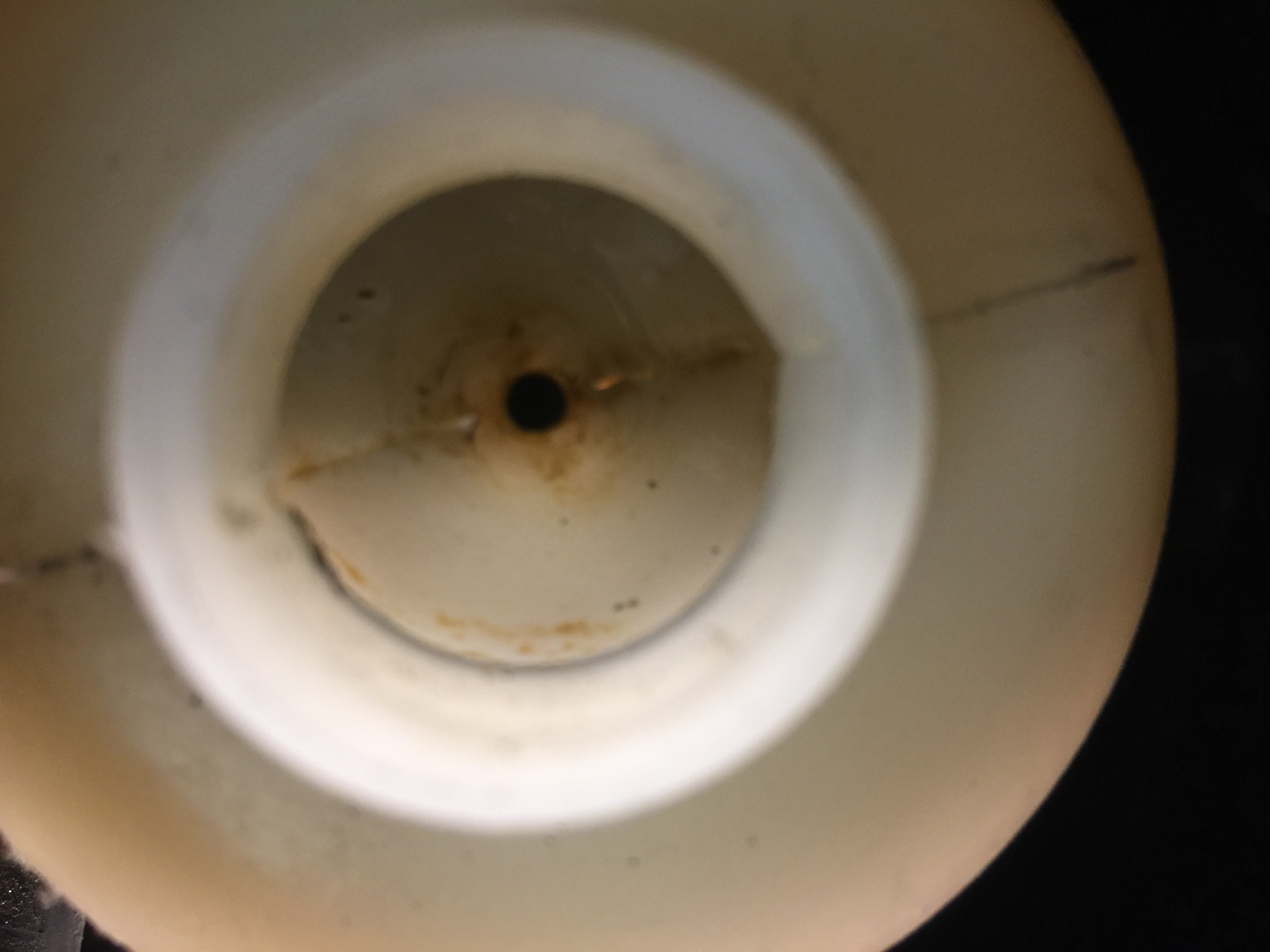

gruffalo wrote:I would like to clean out the brake fluid reservoir better. I tried using acetone but not all the gunk dissolved. Any suggestions?
Run it through the dishwasher :thumbsup:

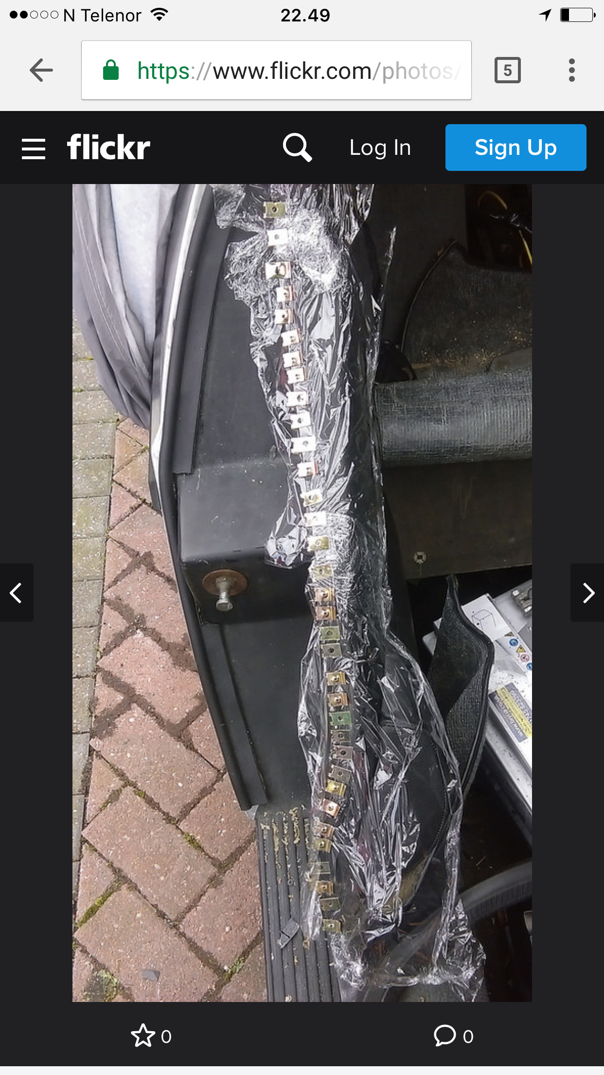

Btw what's going on in this photo?
Mystery job...

Postby InoX » Tue Sep 05, 2017 10:00 pm
I'm reattachingthe rear speaker card. I've used a polyurethane adhesive and used the clips to hold the vinyl to the underbody. The cling film is to prevent the clips from sticking to the adhesive and vinyl.

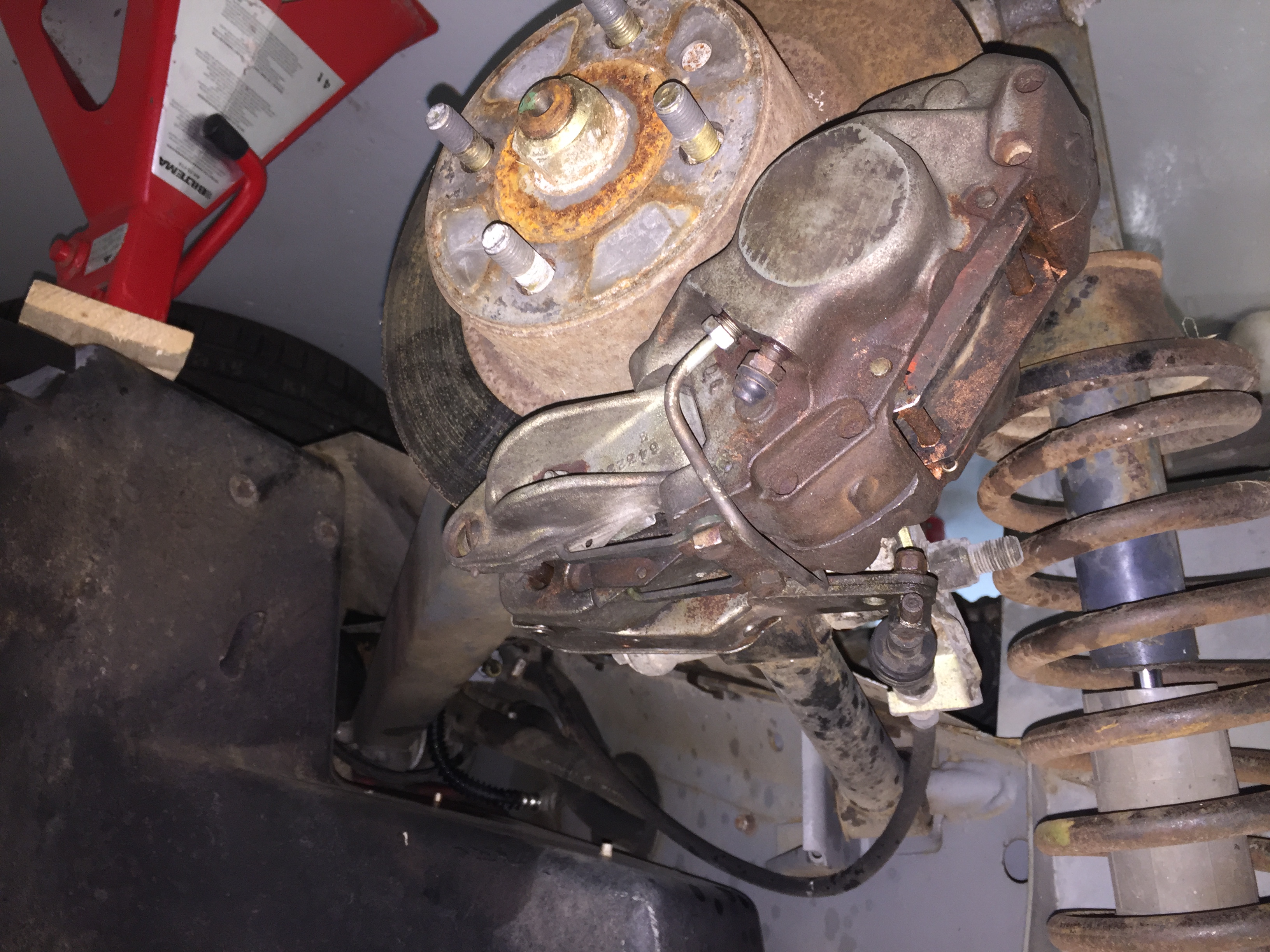

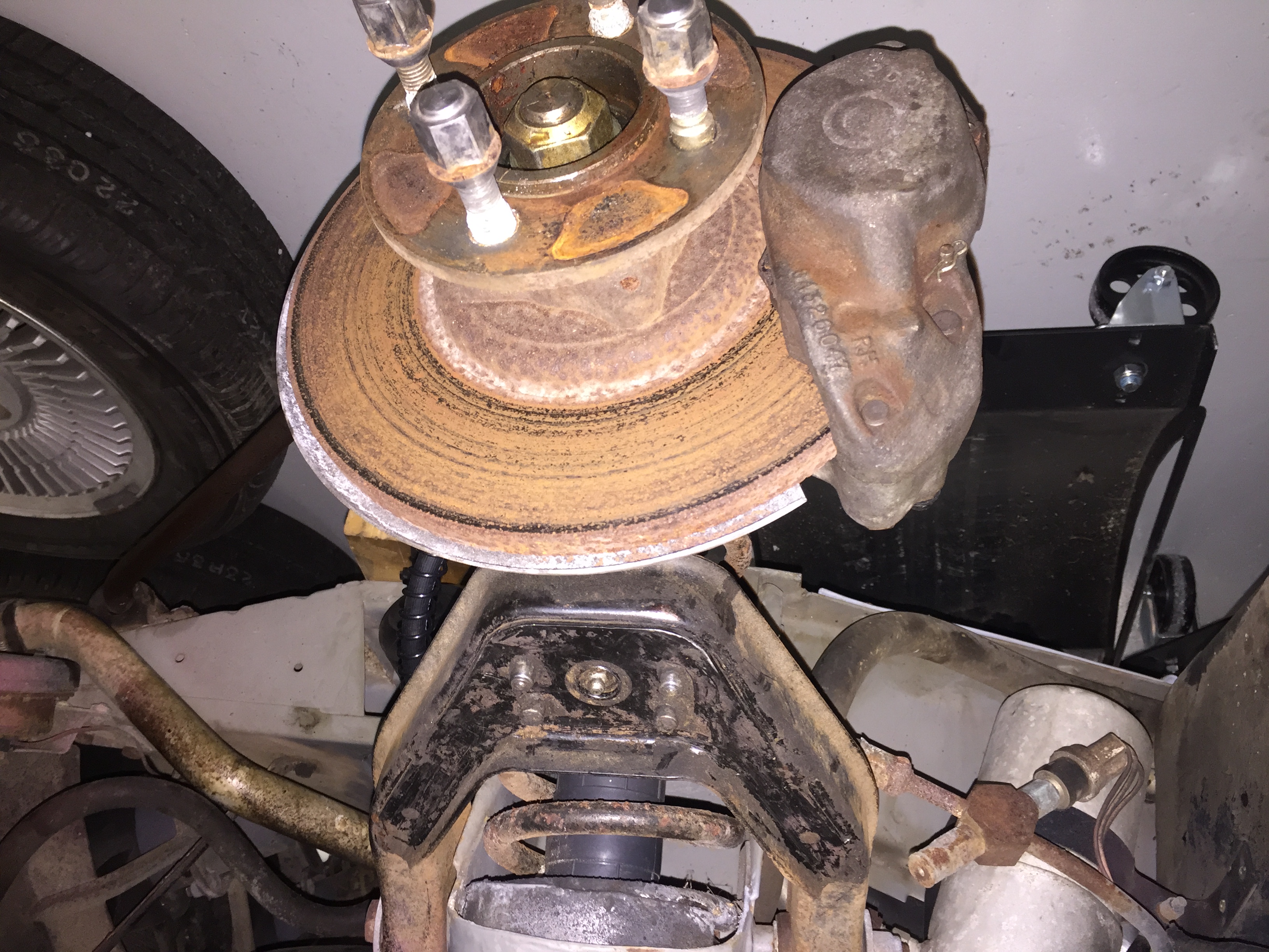

Got a short work session in today as well. Fitted the front right caliper and flex hose.
In addition I completed the last of the rear calipers, since I got another shipment of parts today. :)
I also installed the rear right caliper. The last caliper has got some fouled threads so I need to run a threading tap through them before I fit the hard line. The necessary bits are in the mail.
Rear Right all done
FR. Thin coat of rust cosmetic problem only

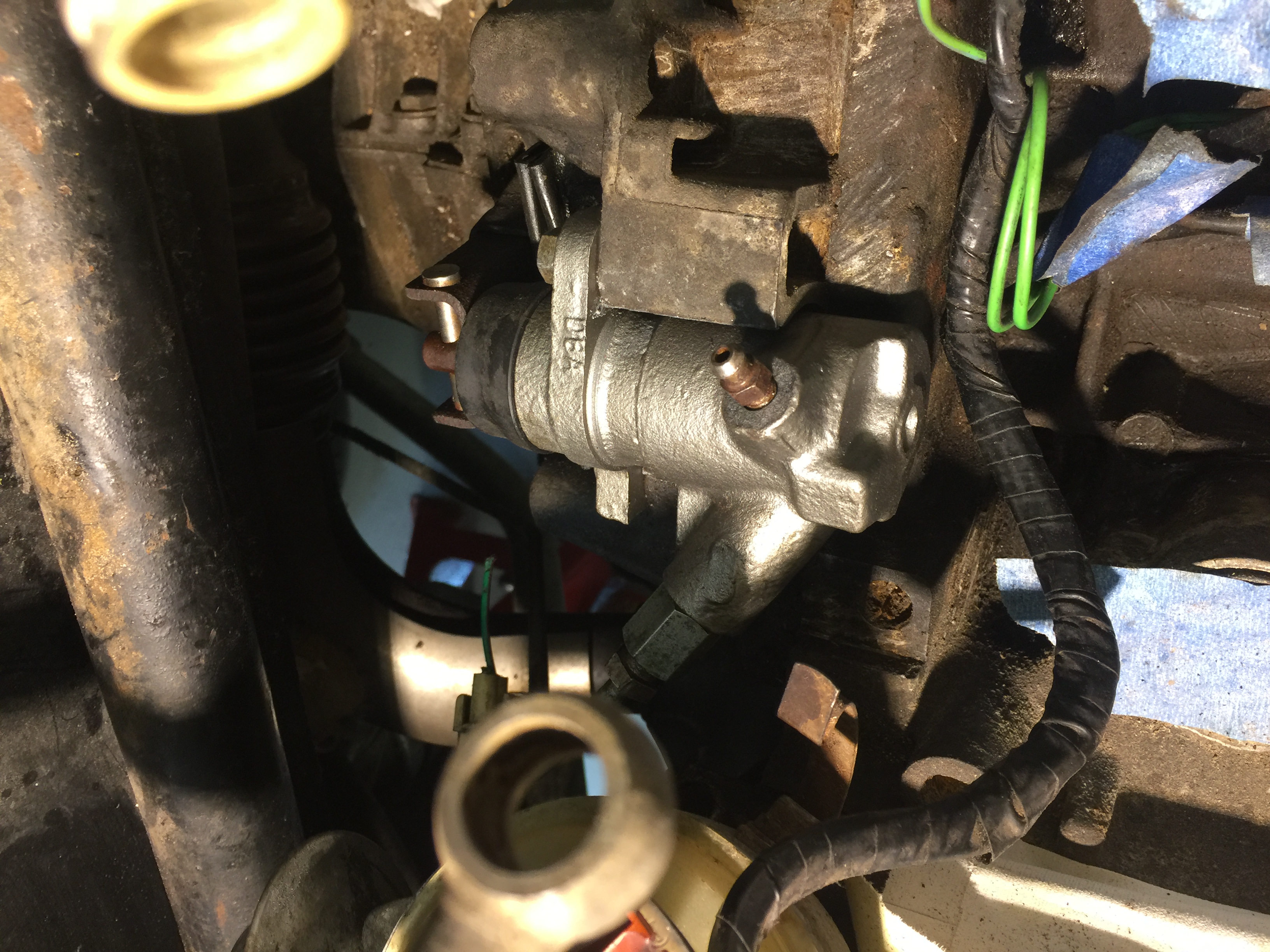

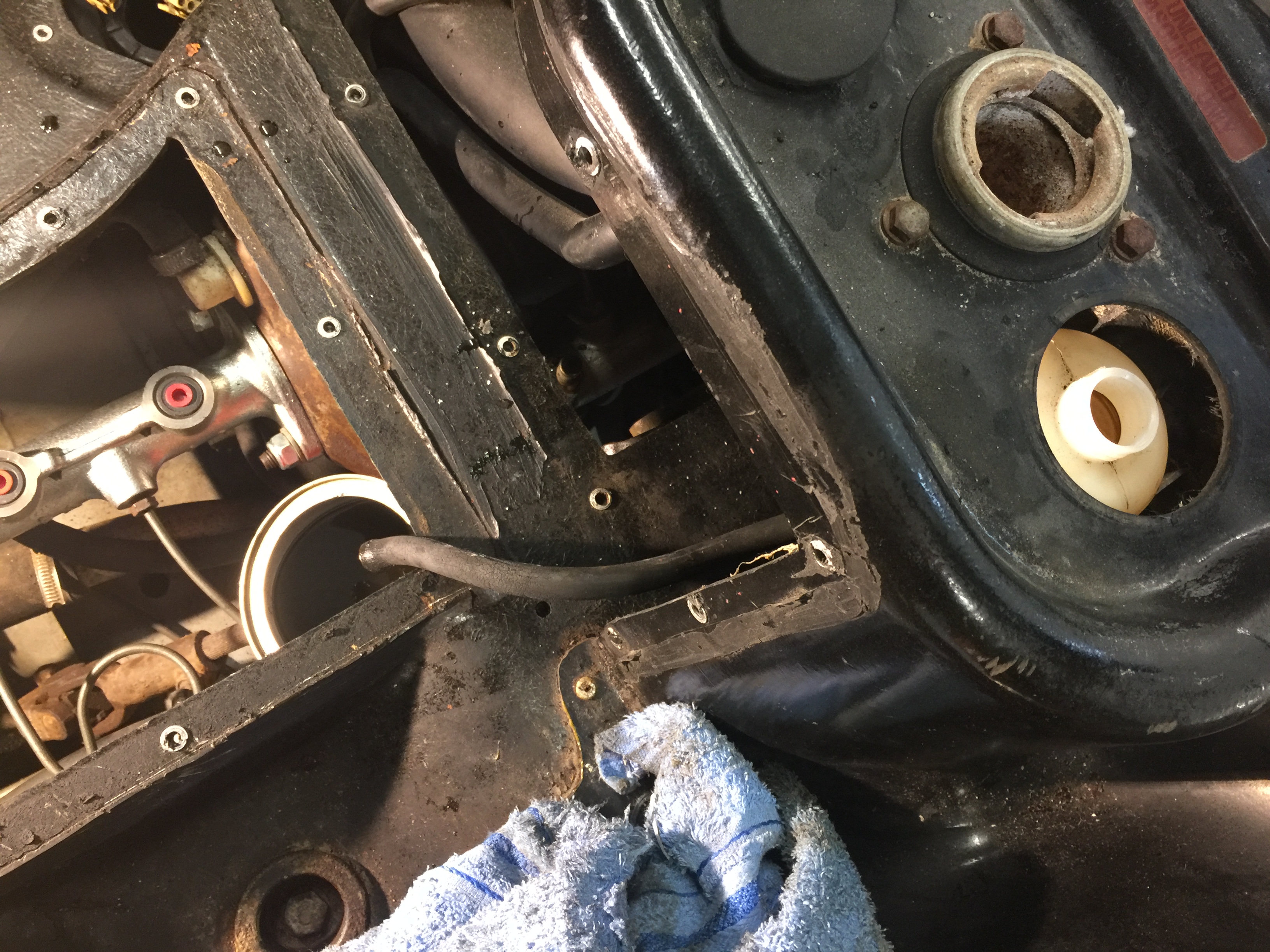

Got the clutch slave installed without any issues. Also cleaned out the clutch fluid reservoir. Paint thinner and a homemade giant q-tip did it.
Slave found its new home
Cleaned out ... good enough
Reservoir flushing rig
