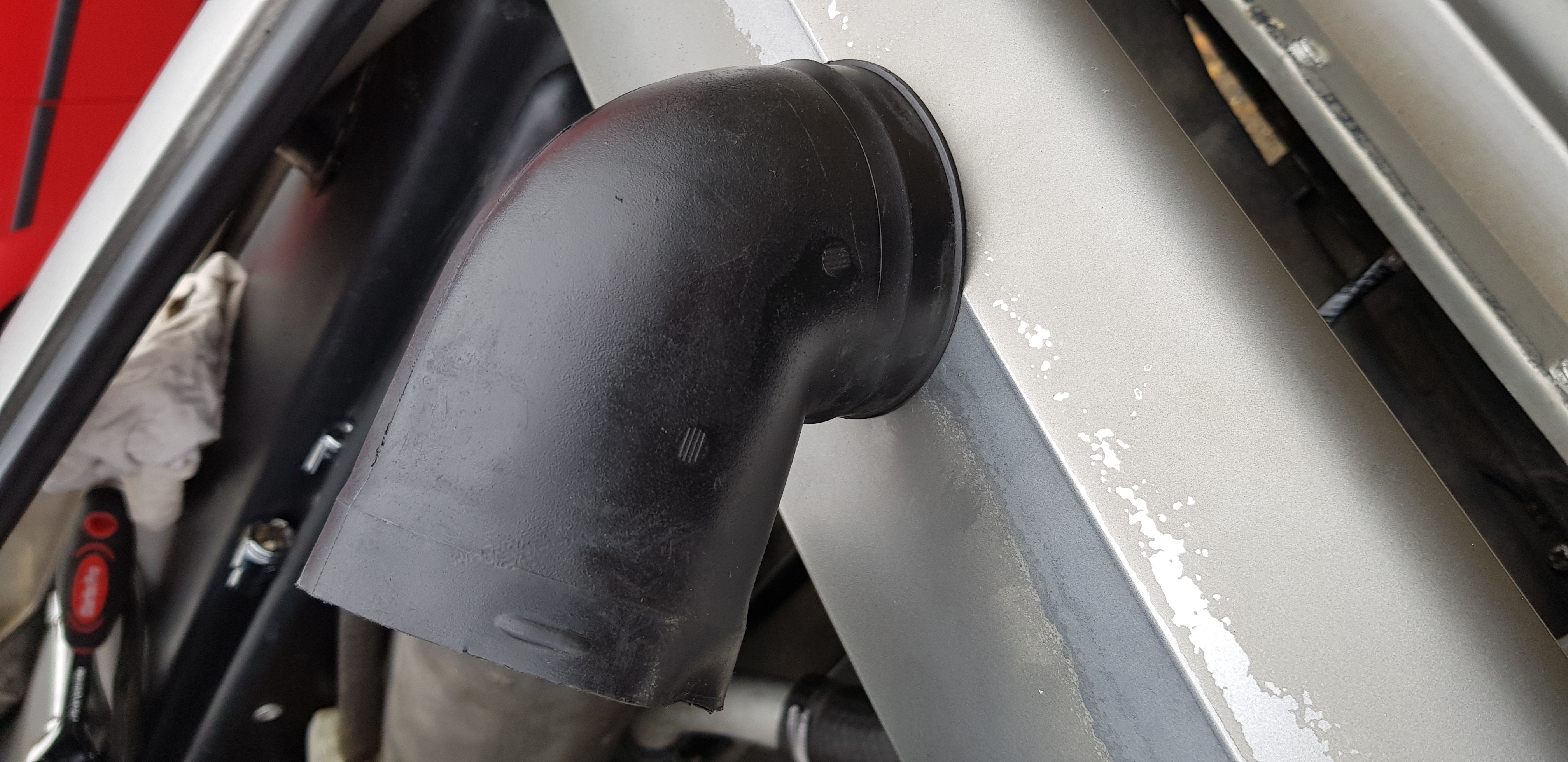

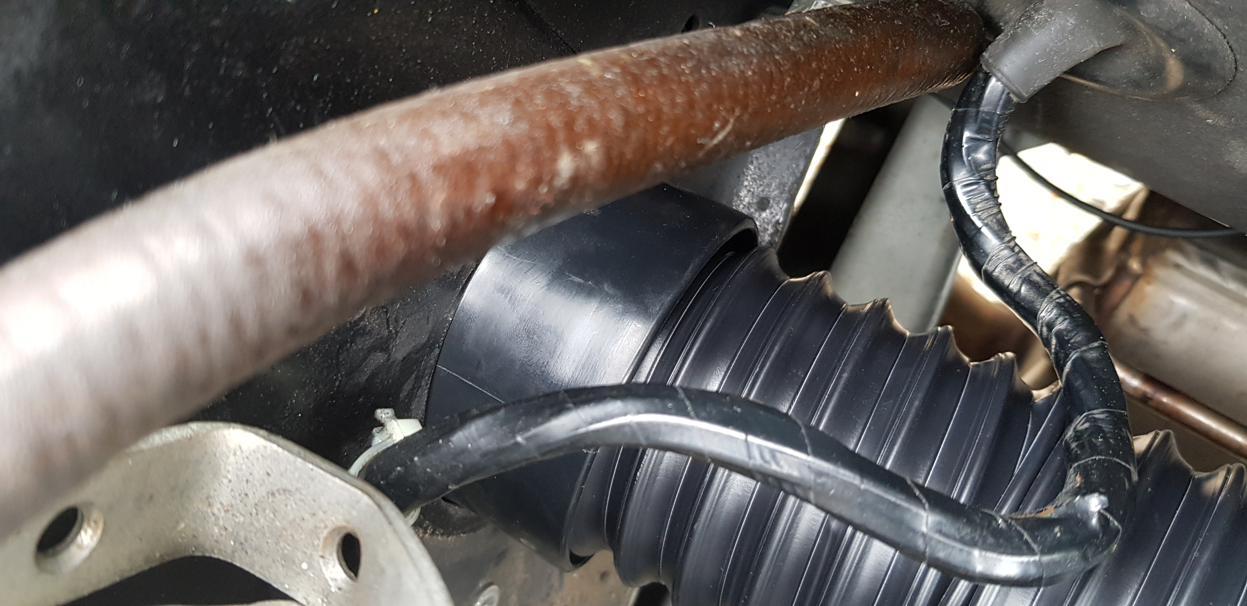

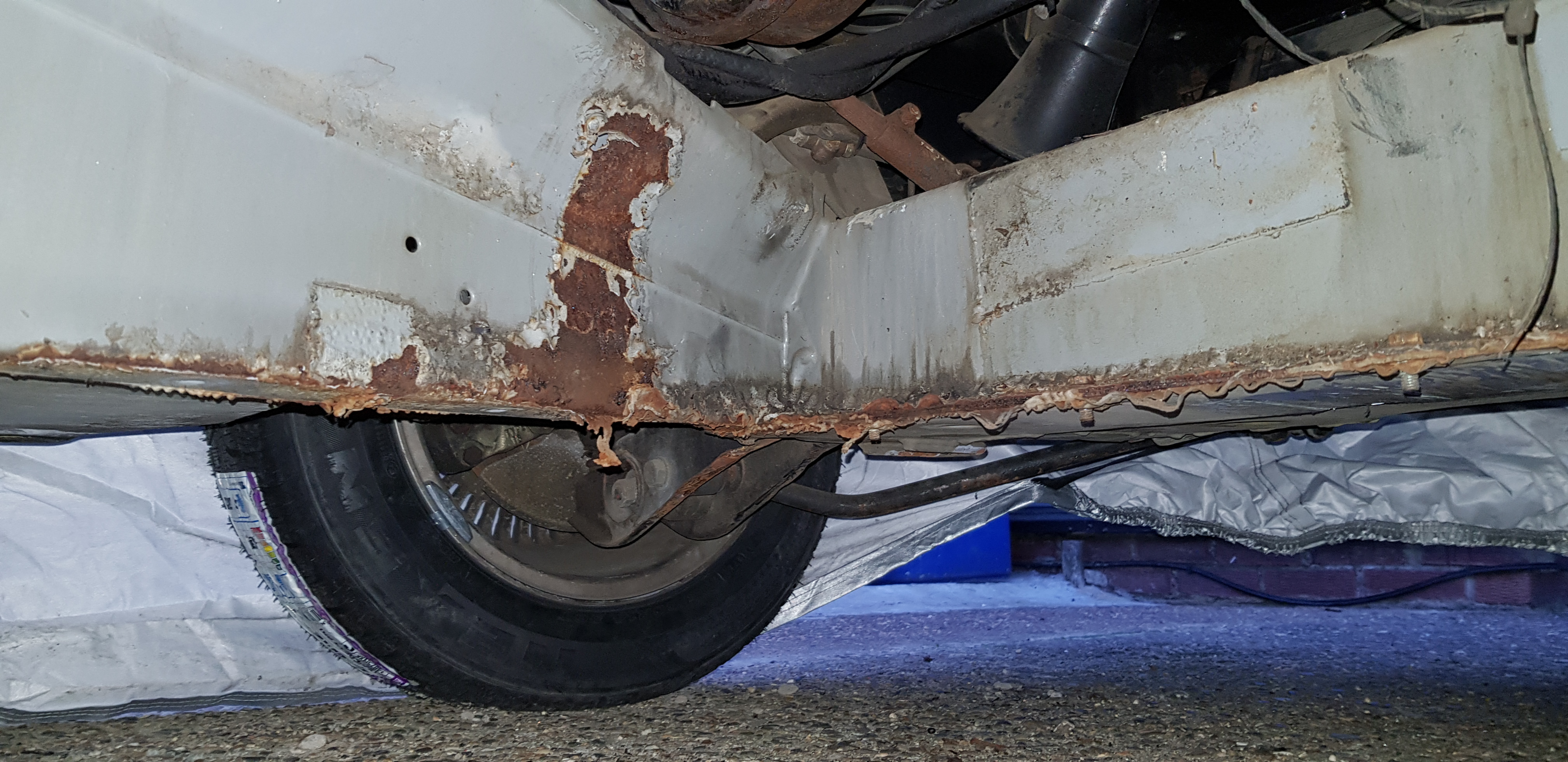

So what I thought would be a 10min job wasnt. The air intake, should it be secured to the tube inside the pontoon or can it just sit around it? Does it need to be "sealed" so theres a vacuum? Or is it best to attach it to the curved piece that was originally there (pic2)? Even that piece im sure wasnt actually attached on the inside either. At the moment, the new intake is just sat over the inside pontoon place
Re: VIN 5219
Postby arranj » Mon Apr 08, 2019 9:29 pm
Doesn't need to be sealed, it does nearly nothing at all anyway, and you can either leave the angled piece in, or remove it.

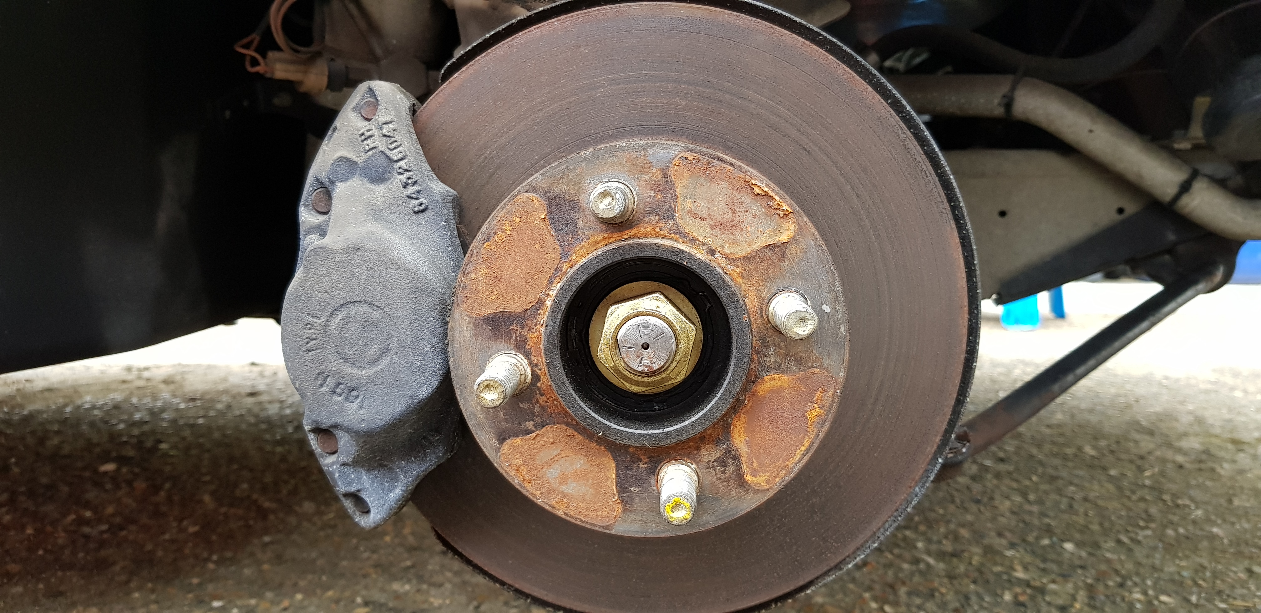

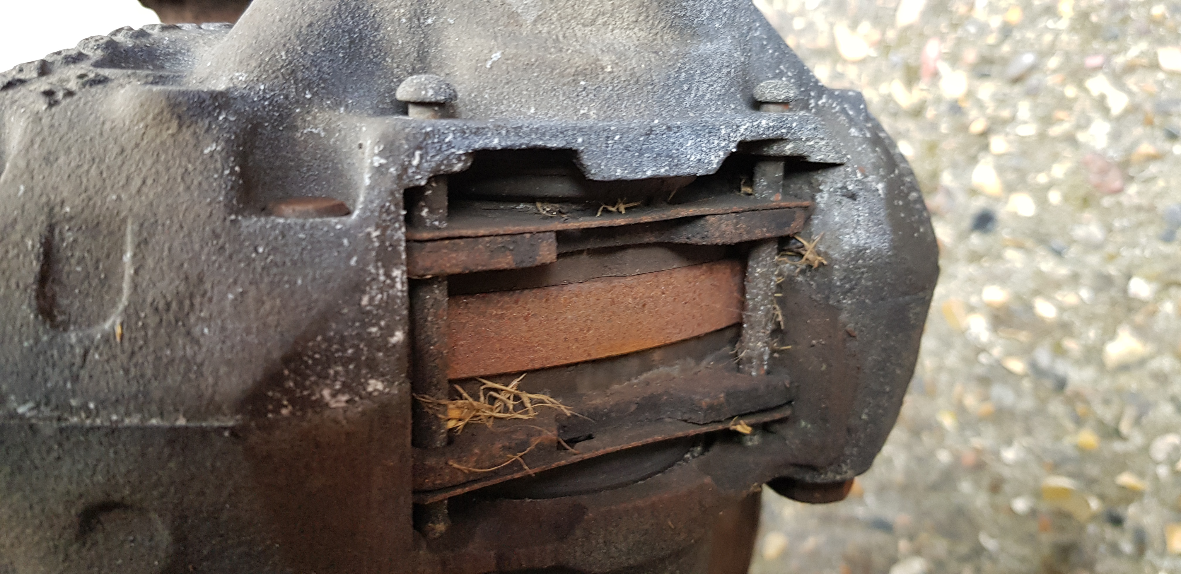

Postby DMC1983 » Fri Apr 12, 2019 8:16 pm
Fuel tank is now out. What a royal pain that was. Good thing i did really as it appears as though a leak has occurred at some point. It looks to be surface rust so i will try some rust removing paste then prime and paint, the rest of the chassis is in great shape.

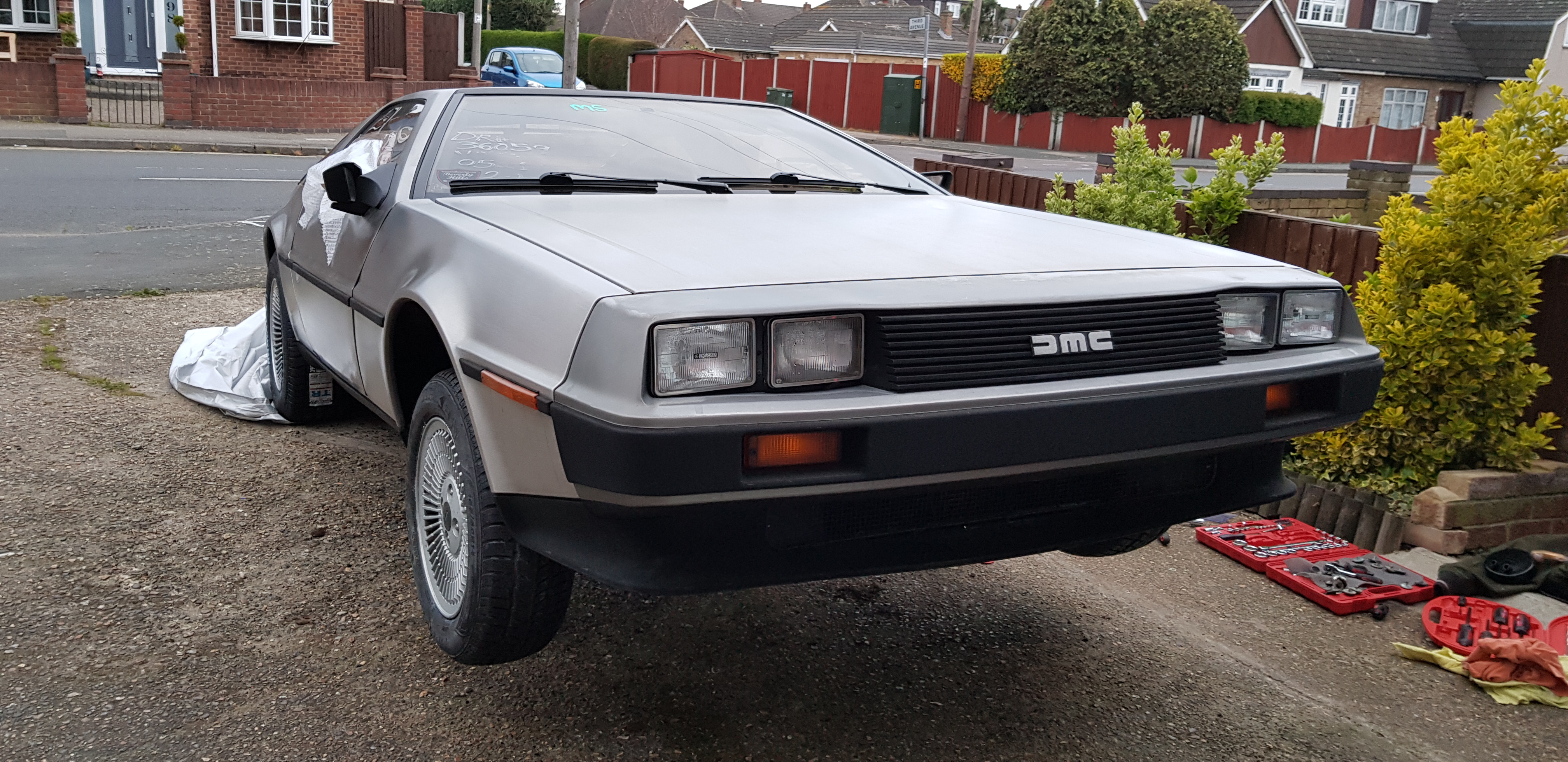

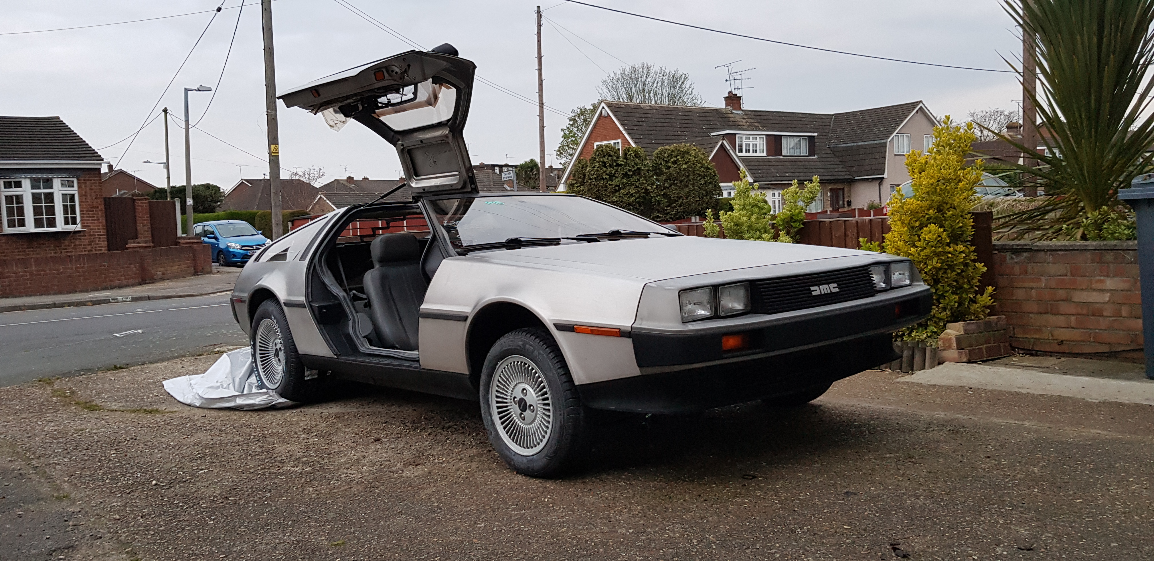

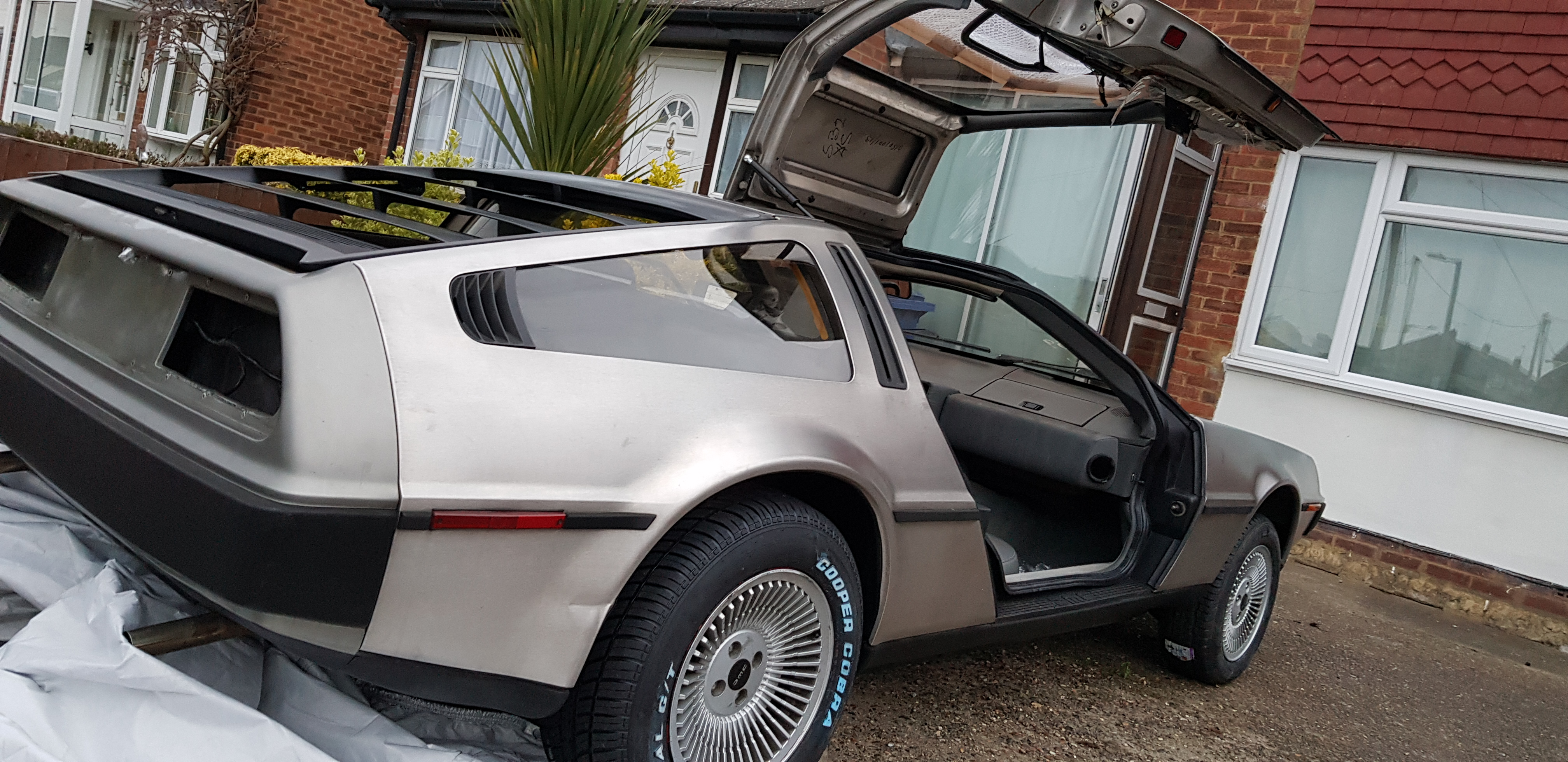

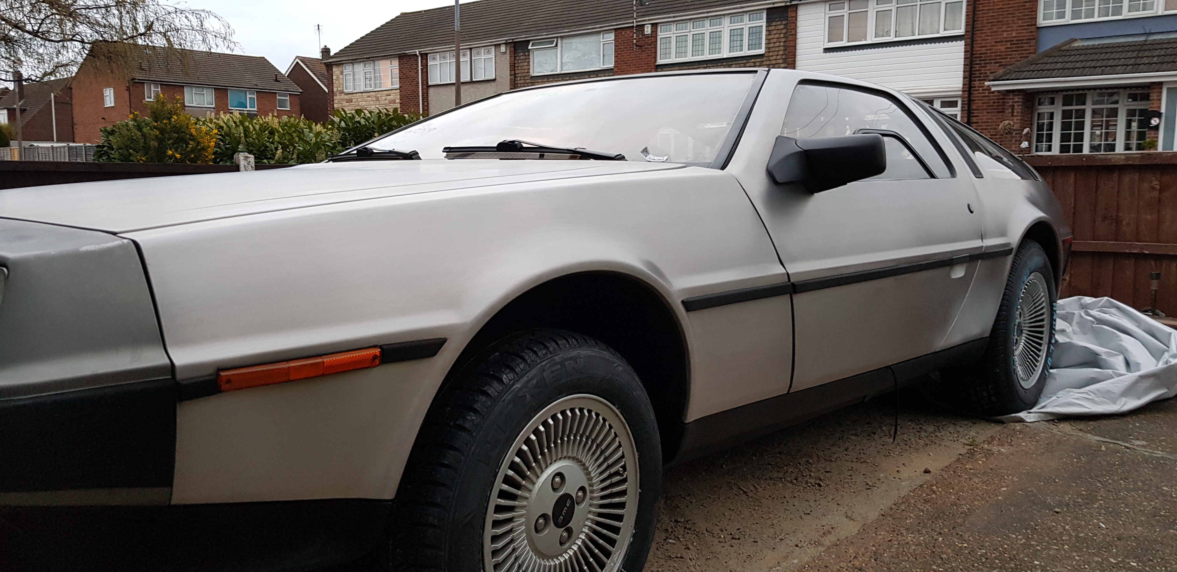

Ive also now installed the hover conversion to the front of the car. Initial test has proved very promising
Just some quick pics. Ive now added new tyres
Brakes need some tlc :lol:
This is rather fun but I'm beginning to think that even if my car is ready for the june meet i doubt it will be attending as it still needs to be registered which can take some time i believe. Either way, I'm planning on coming along for the friday and saturday.
